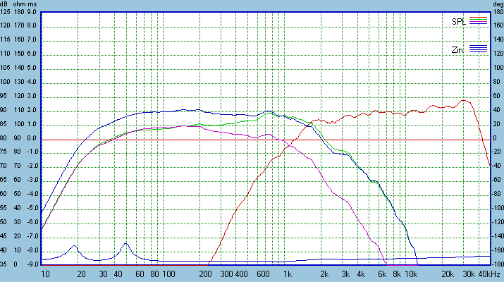

If you look at the response of the individual drivers at Zaph's website you can see that the upper woofer has a peak around 800 hz. If the lower woofer phase were backwards it would cancel progressively more as frequency goes down producing quite an overall peak at around 800 hz. This fits with the lack of bass the speaker is producing. This however does not explain what is going on at higher frequencies.
This is what I would do. While your crossovers are gone hook up your two woofers in parallel (mounted in box with tweeter also) just to see how much bass they can produce. Should be lots.
Then afterwords you could hook up your tweeter in series with around 2.2 ohms in series for level (R0 in Zaph crossover) and ALSO a capacitor in series (around 4 uF for an F3 of around 6000 hz at 4 ohms). Do not play this loud.
With the tweeter and two woofers hooked up the speaker should sound reasonably ok and not irritating. If you use the auto equalize it should sound pretty good.

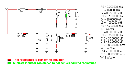

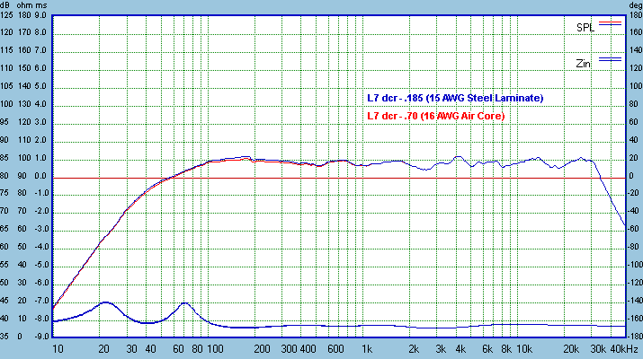

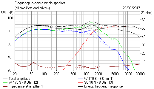

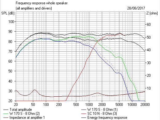

I just had a look at possible causes of a midrange spike at around 1.2kHz.
In fact the circuit does look about 2dB high at this frequency. Fitting a 0.7mH instead of 0.5mH was a possible cure. First FR plot.
If the 5R/60uF shunt is open circuit, it all gets very poor indeed. Second plot.
Here is a rough idea of what I am looking at. This is what the auto eq wants to do to achieve a flat response. 1khz is at least 6db louder than the midrange and 9db louder than the upper treble?
Assuming that is reasonably accurate, it looks very much like a connection/phase issue. Is it possible the upper mid-woofer is out of phase? Perhaps try flipping the mid-woofer polarity and run the eq again with the mic roughly 1m distance and on-axis with the tweeter. Double check that the upper and lower woofer connections aren't switched (sometimes they aren't clearly marked on the crossover). The high frequency roll-off could just be the mic position/angle.

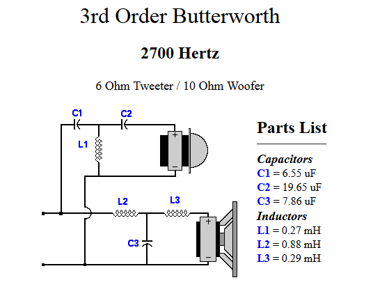

TBH, I've always hated the 6" plus soft-dome combination. Terrible time-alignment problems especially in LR2.
How they laughed about 5 years ago when I said that soft-domes sounded spitty and harsh. They are not laughing now! Ring-radiators get a much better press these days. Even Troels Gravesen goes for them by preference.
However this disastrous sounding project turns out, I think it is recoverable. Anybody who crosses a 1" tweeter at 1.7kHz is just asking for distortion. I mean 16uF and 0.25mH second-order is just plain silly on a 1" tweeter! 🙄
IMO, almost everybody gets this combination wrong. My own opinion is that a BW3 alignment works incredibly well. Heybrook did it well enough back in the day with the HB2. We turn the time-alignment problem into a FEATURE with 90 degree BW3. I did some BBC-style passive bafflestep correction just because I enjoy this stuff. Impedance to die for. 😎

Is a laminate core inductor acceptable for the .5 way filter (L14)? I don't understand at what point cored inductors can cause issues or if they are ever a good idea really. Madisound uses one of their sledgehammer inductors in that location. All other inductors are air core.
Look at the resistance of the two woofer inductors. Note that the air-core has one third the inductance, but one fifth more resistance. Look up the resistance and physical size of air-cored 3mh coils. You would have to redesign your crossover to use one. But consider the primary complaint against iron-core inductors- saturation at high power. Well, you would burn your voicecoils before you got to that point, and what happens if you do? The inductance becomes less(not non) linear at these levels you will never reach safely. PA crossovers have traditionally used iron-core inductors because they are needing tremendous volume, and do not want the extra heat producing resistance as they put hundreds and thousands of watts through their crossovers.
Also you will lose damping, and raise the Qt, which is why I said you would need a redesign.
If you are starting from scratch, at normal sub 120db levels, use what you want, it will sound fine either way, if your crossover is good.
