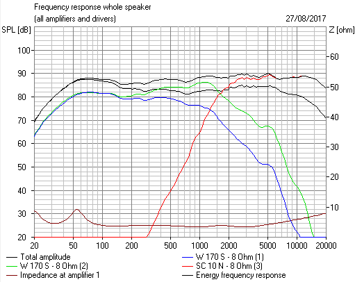

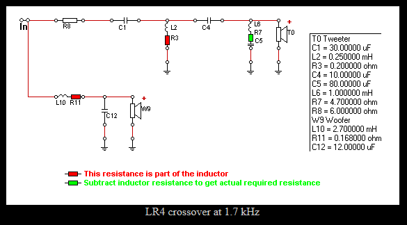

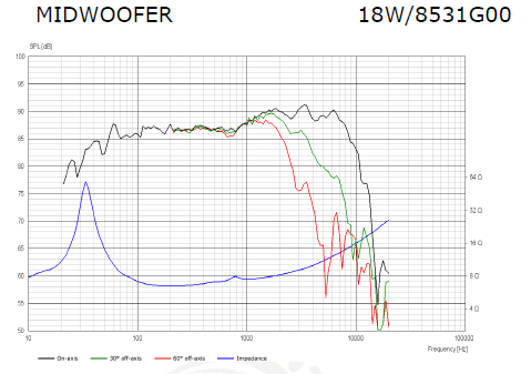

The AirCirc's pretty good also...
Zaph's own measurements, widely used, widely respected, widely found accurate / representative.
The AirCirc could do with a bit more linear excursion, but it overloads reasonably gracefully, and LR4 @ 1.7KHz? Narry a problem, assuming you're not trying to outdo the SPLs generated by your mate down the road with the Altec VOTT A5s. 😉

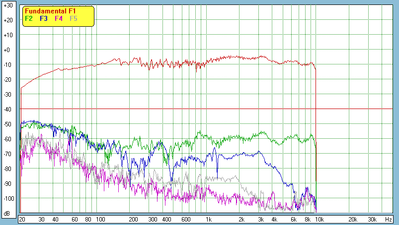

Zaph's measurements of the drivers in the box...
Based on this (and personal experience with the drivers), I suggest a more reasonable conclusion than the ZRT being 'a woeful design' (which it isn't) is that something is awry elsewhere, either with the components or the construction. Triple-checking the wiring might be an idea; it's also certainly possible that some drivers or components are out of spec., which unfortunately does happen from time to time. The AirCirc tweeter for e.g. did go through a period where consistency was an issue. This is all speculation though unfortunately; you really need to measure them to know for sure. It's good Madisound are assisting; they do try to help when they can.

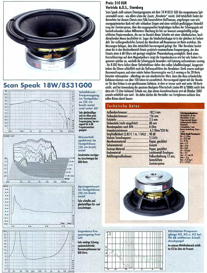

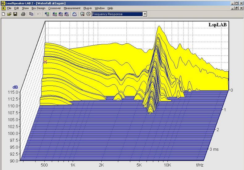

Another set of data for the 8531G00 -FR & CSD track John's well & are consistent with other measurements I've seen (apart from the LspLab plot shown a few posts ago, which I suspect is a different driver, presumably mislabelled).

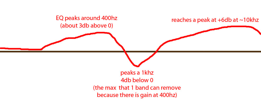

That's still a possibility i guess. For both rooms to have the same issue though? It sounds very much the same as it did at my previous living room. There is a large area rug between the speakers and my seat. They auto eq looks surprisingly similar in both rooms and the only difference between the left speaker and right speaker is mostly in the midbass+upper bass regions.
The measurement microphone tells me there is a sharp 6db peak at 1khz in both living rooms. The difference from 1khz to 10khz is 9db!!!
Here is a rough idea of what I am looking at. This is what the auto eq wants to do to achieve a flat response. 1khz is at least 6db louder than the midrange and 9db louder than the upper treble?
It's WOEFUL! 😀

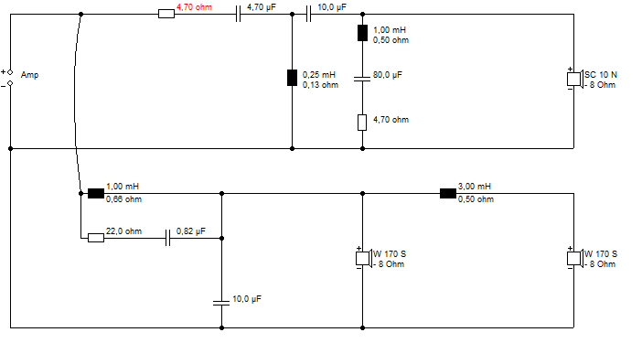

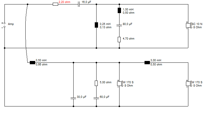

I had a little play with the 2.5 circuit today. Very low impedance around 3.5R, which might be part of the problem here. 2.5 way boomy bass just comes with the design.
Quite easy to modify for a 2.7kHz crossover. All worked very well. And actually, the cone breakup is no worse.
It's WOEFUL! 😀
Many people do find it has slightly elevated bass. It probably does. If you look at my auto eq, the bass needs no gain and the midrange + treble regions (other than the 1khz craziness) mostly needs a boost of 3db to 6db relative to the bass region. That is not something that bothers me since I prefer slightly elevated bass anyway.
You keep going on about how it has to be the low crossover point. If you go to Troels Gravessen's site (just for an example), he has designed probably 100 speakers and has many (including some 3 ways even in his latest designs) that use as low as 2nd order 1.7khz and I have even seen 1.5khz on his site. Everything is a compromise but 1.7khz tweeter compromise is not what I am hearing here. A low tweeter XO can be rather charming in its own way in my experience. At just a couple watts of output (or less), the tweeter is not straining by any stretch of the imagination. It also seems like the problem is still there when I disconnect the tweeter altogether anyway.
The low impedance I could see being a problem if I needed to push the amp loud to get problems but this sounds bad at even low volume.
I just tried listening to it nearfield which I realize it is not designed for, but still sounds peaky in that 1khz region to me. Damn I hope Madisound can find something incorrect in the crossover. Otherwise I might just need to amputate my ears.
The severe dip at ~ 1kHz means to me that you may have the tweeter connected IN PHASE, which is likely incorrect......
