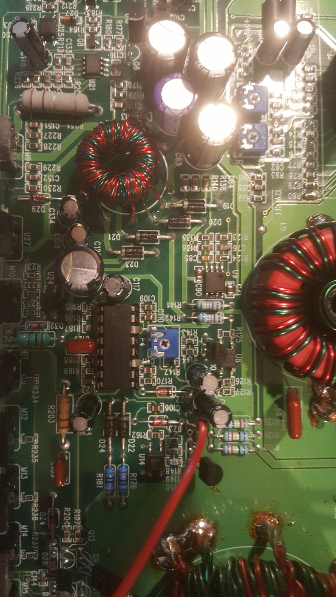

I put the new 4565 in place of the 4560 and no change. The power supply is still producing +12 and -10 V rails when the 3525 is powered externally.
Before I shorted neg rail (-68 V) to V+ (pin 8) of the 4560 I had ~ + and - 70 V rails.

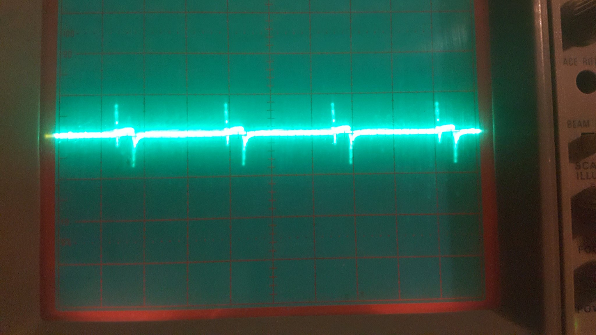

All the readings from the pins look good on the 3525, except the outputs 11 and 14 read 0.0078 and 0.0085 respectively.

0.1V 5uS

It is close. This has the small transformer that produces the secondary supplies.
I believe: Image = schematic
U8 = U16
R141 and R142 = R112 and R109
This is where I shorted the -rail (R141) to pin 8 of the opamp U9 in the image
For R141 and R142 the side opposite the connection to the optocoupler goes to the small transformer.
Yes, I think the meter is correct. I believe I got the same thing with the scope. When I reconnect both outputs I will check again with both the scope and meter.
With pins 11 and 14 lifted the rails are zero.
Should I reconnect the all the pins of the 3525?
