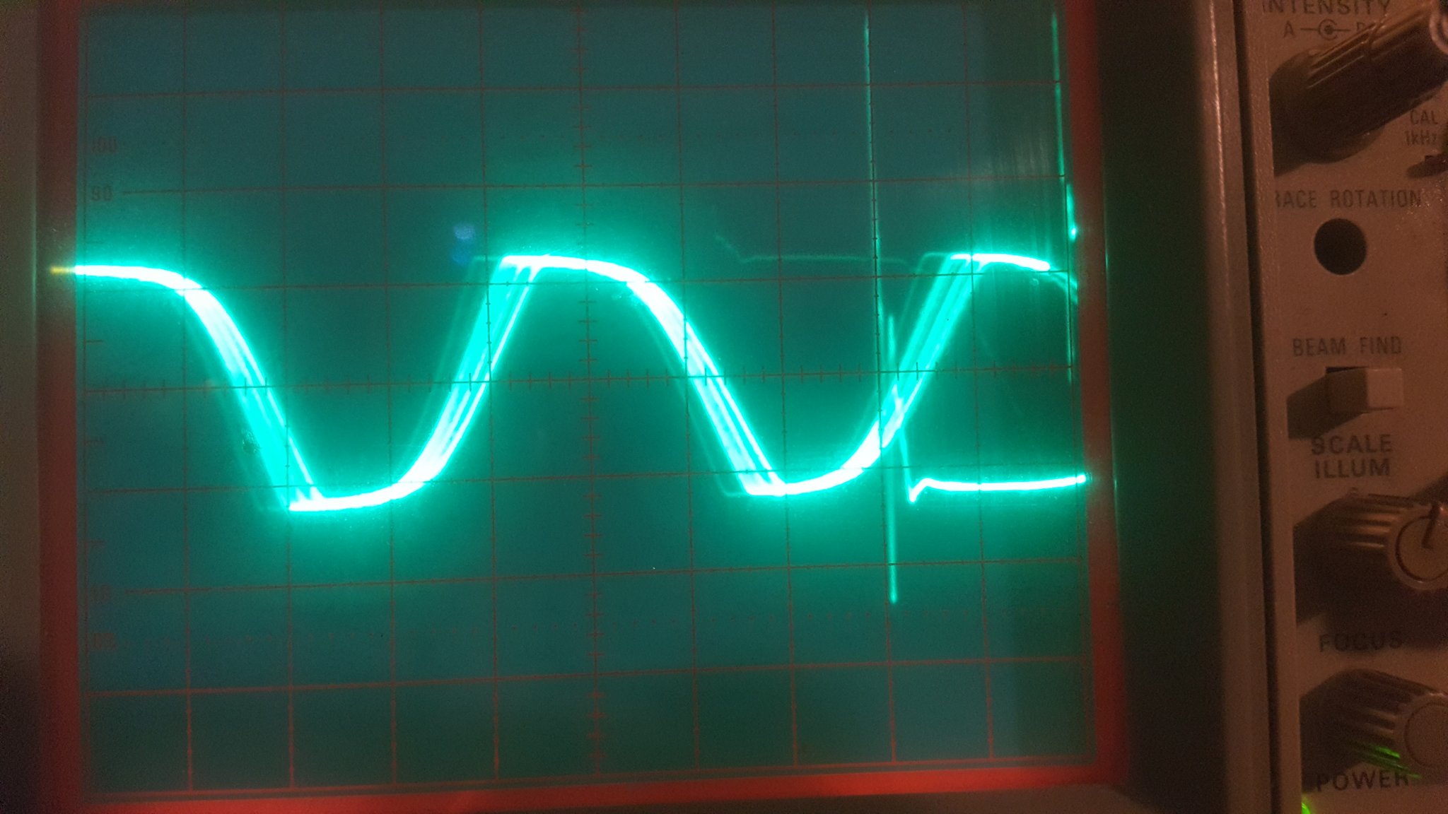

Attached is the image of the signal at the gate of the P.S. FET. 0.5 V/div and 5 uS/div
It is producing rail voltage of "V+amp" at 69.6 V and "V-amp" at -67.7 V

I haven't found any reason why it is shutting down.
Speaker terminals have 150 mV and 125 mV. This amp has pots to adjust dc offset, but moving them through there full range doesn't change anything.
