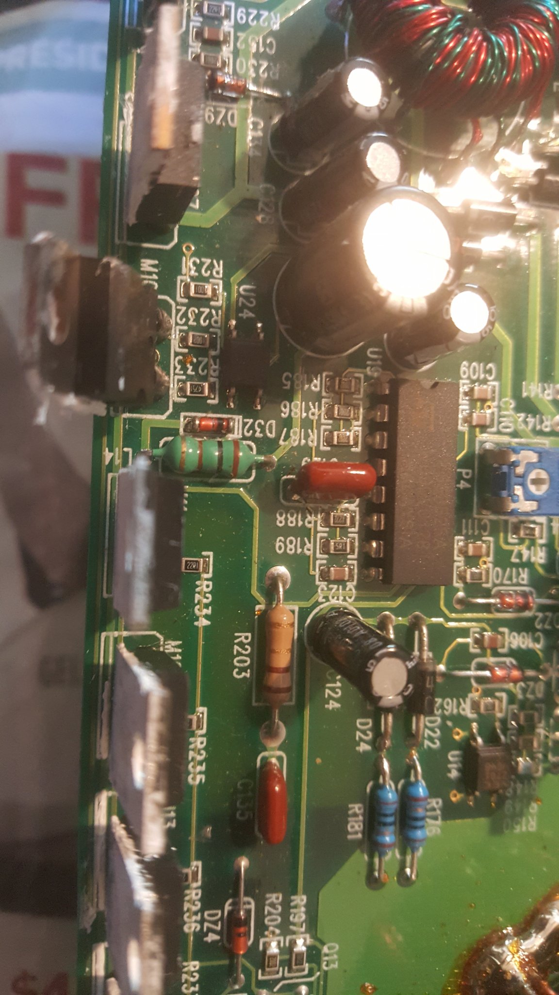

This isn’t the ta0104a but it’s a Ra0105a/tda2500 which we’re the upgrades to the ta0104a. It might not be the exact same thing size wise but it’s most likely an idea of what it is under them. I will see if I can find what you are looking forDoes anybody know, definitively, what is under the 3 black epoxy blobs?
This is a TA104A Tripath chip.
Thanks.This isn’t the ta0104a but it’s a Ra0105a/tda2500 which we’re the upgrades to the ta0104a. It might not be the exact same thing size wise but it’s most likely an idea of what it is under them. I will see if I can find what you are looking for View attachment 1103334View attachment 1103335
Well technically I meant to write more so resolute audio made this which from my understanding they bought the inventory out from tripath after they went bankrupt or they made their own I forget which but they can’t be that much different in design possibly some slight changes since the ta0105a tda2500 doubled the voltage allowance and they are able to emulate the ta0104a and ta0103a so they should be very precise similaritiesThanks.
I think I am going to have admit defeat on this one. Unless I come across a working tripath chip one of these days.
I can ground the H-Mute pin 35 of the TA0104A and get the amp out of protect and producing +/- rail voltage and also follow a signal from the RCAs to the inputs of the TA0104A module but get nothing out of the tripath module. So, I am assuming it is one or more of the ICs on the module that are bad.

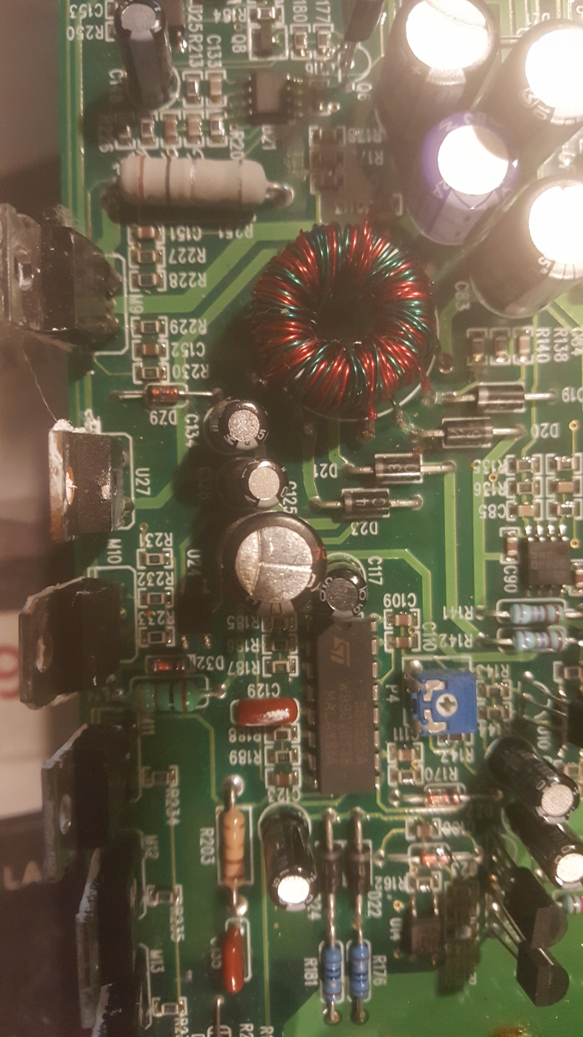

I got this amp back for another try at it.
I've got the left channel working properly, at least for now.
The right channel will work some of the time but will randomly send DC to the right speaker terminal, which results in a loud pop through the speaker and then that channel is muted on the tripath chip. I can cycle the input power and sometimes the right channel will work again and sometimes not. I have pushed all over all the boards and components with a non-conduvtive probe and also twisted and moved inductors with no luck of reproducing it.
Also I don't think I have the power supply just right. When I first got the amp last year it had +/- 70V rails. Now the maximum rail voltage is +/- 60V.
This amp has a pot to adjust the rails, depending on if the TA0103A or TA0104A chip is used. Both measurements taken with a 13.6 V B+.
I slipped early on when messing with the power supply and damaged a few parts that have been replaced but I must not have found everything.
