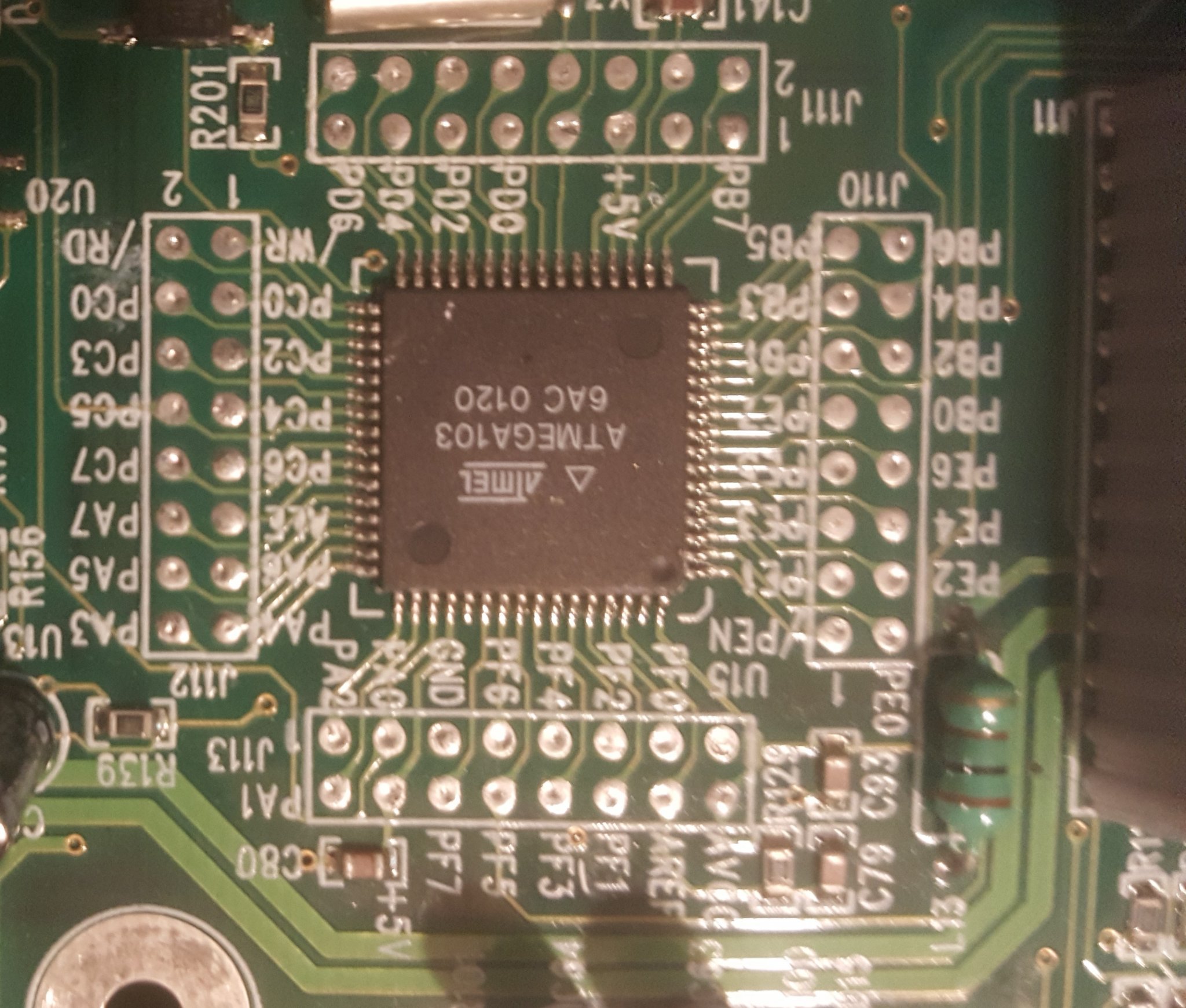

Doing some tracing and best I can tell HMUTE (pin 35) goes to a 1K resistor then to PA1 (pin 50) of the ATmega103 microcontroller. I can not find any optocoupler that it is tied to, at least on the module side of the microcontroller, like in the Clarion schematic.
Same with MUTE (pin 4), it goes to a 1K resistor then to PC4 (pin 39) of the micro controller.
