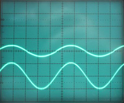

I think I have the DC offset under control at this stage. With the OpAmp disconnected I can set it to near zero (2-3 mV), and with the servo in place, it stays put over time.
My current issue is actually a low level oscillation. It is fixed in amplitude (about 100-300 mV), and seems to be related to the input signal. At the zero crossing of the input there is no oscillation, and at the peaks (positive or negative) it it at its peak. It is very high in frequency.
I see it in the output signal, on the supply lines and also at the input of the amp. It goes away when I turn off the amp, or if I turn off the signal generator creating the input signal. I am not sure if it is the amp by itself reacting to the input signal, or some weird interaction between the signal generator and the amp.

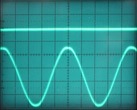

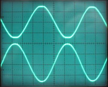

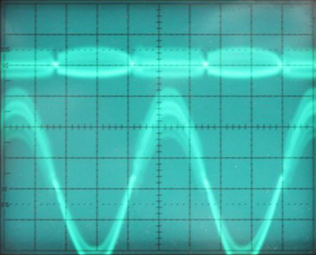

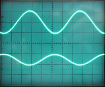

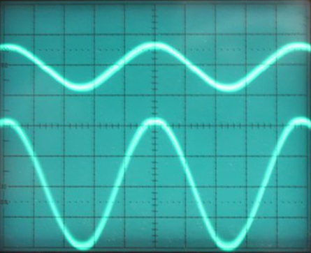

Here are some pics.

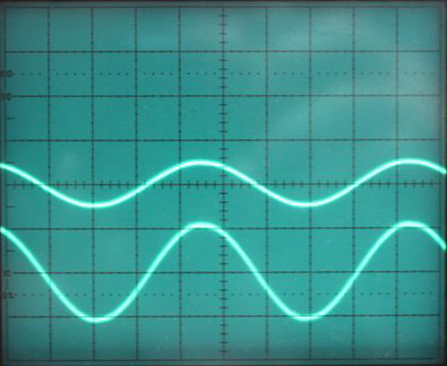

Input signal with the amp off. The top trace is the amp output, and the bottom is the input signal at 1 volt/division
High signal level. Top trace is the output at 50 volts/division (into 8 ohms), bottom signal is the input at 0.5 volt/division.
Here are the input and output at a lower signal level The bottom trace is the input signal at 0.2 volt/div. The top is the output signal (forgot the scale).
Obviously something odd going on here.

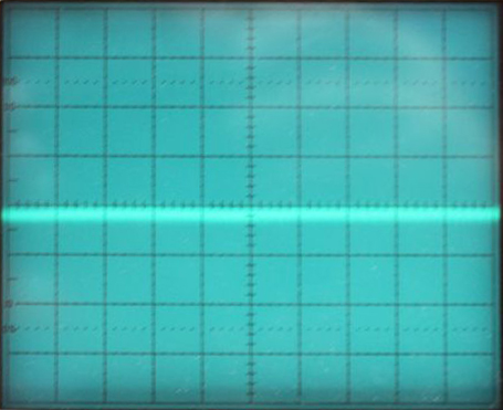

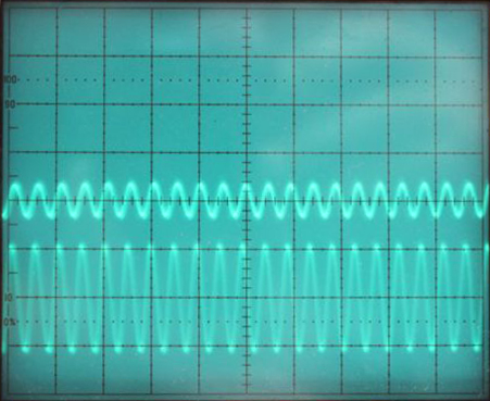

Here is same input signal (bottom) and the positive rail at the big filter cap (at 0.1 volt/div)
And here is the ground at the same cap.
This oscillation only occurs when the output stages are connected. If I run the control board open loop wight he leads tot he output stages shunted by resistors (680 ohms), I get nice big clean signals.
I am thinking this is either something in the output stage, or possibly some parasitic oscillation in the rectifier. I changed the rectifier, but I have not tried shunting the legs with an RC circuit.
As you can see, the frequency is very high (for reference, the input signal is 1KHz), and that actually may point to rectifier oscillation. Under lighter load, the rectifier may not do this, or may not do it as much.
I suppose one thing I could try would be to apply a low DC voltage to the input, on the other side of the blocking cap, and see if it oscillated with any sort of signal level. That would also tell me if this was some weird interaction between the amp and my signal generator. It is possible that the amp is somehow feeding signal over the AC lines to the signal generator and causing it to oscillate...

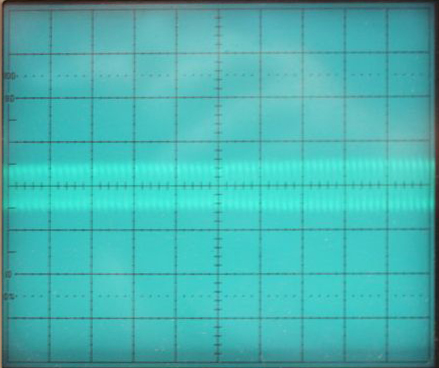

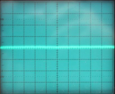

Here are a few additional traces, this time with no input signal.
This is the output of the amp DC coupled to the scope at 20 mV per division. You can see there is about 2-3 mV of negative DC offset. You can also see (at least I could on the live scope) a very low level oscillation.
You can see this better in this pic. This is the output at 20mV/div with nothing attached to the input. Same low level oscillation as above, but larger.
And here is the output at the same scale, with the input grounded.

Hi Scott,
Basically, when you have oscillation, it will show up everywhere. At those high frequencies, the filter capacitors are open circuit. Check the small capacitors that act as filters on the power supplies. Also check / replace the electrolytic capacitors on the output boards. Make absolutely certain the heat sinks are both securely grounded - a low resistance connection to the main chassis.
Are the output transistors the original parts? If not, you may have to adjust the compensation capacitor across the feedback resistor.

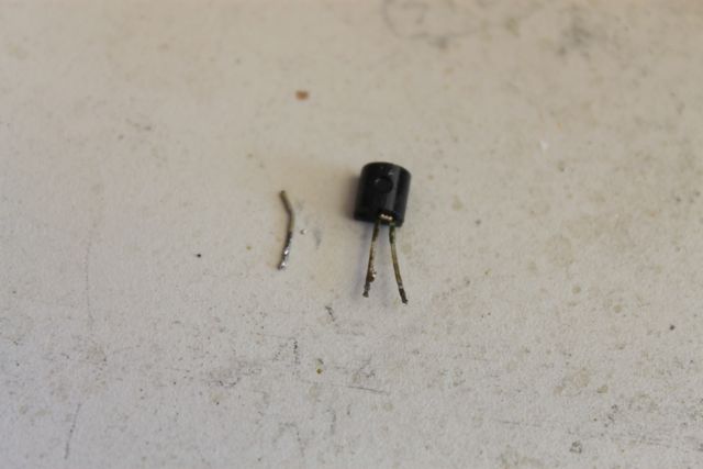

All good suggestions. I plan to go around the amp next and make certain everything is grounded properly. I'll also replace the caps and resistors on the small boards on top of the big filter caps.
I just determined, however, that the high frequency load resistor (R158) on the control board appears to be open. Seems like that's probably the culprit. According to the manual R158 and C121 (it looks like a typo, since is says C111, but that is unrelated) "provide a load for the amplifier at high frequencies". If that were open, then there would-be no high frequency load and the amplifier would probably be unstable.
So, back to Mouser for the umpteenth time!

Well, OK then.. The Adcom is finally working.
I replaced R158, the 3 watt resistor that provides a load to the amp at high frequencies (about 300 KHz). The original one was open circuited. That one took a little head scratching to home in on...That killed most of the oscillation. The rest was due to some bias errors that were a result of me tweaking the bias to try to manage the high frequency oscillation. Once I put in the replacement load resistor, I spent a little time little tweaking the diff amp currents, and the oscillations stopped. The result was the signal traces below.

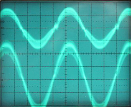

Here are the traces:
This is 1KHz around half rated input level into 8 ohms.
The bottom trace is the input signal at 1 volt/division. The top trace is the output at 50 volts/div. The output peak signal here looks to be about 25 volts, so that's about 80 watts into 8 ohms. I can run it hotter, but until I am sure everything is OK, I'd rather not push my luck!
This trace is at 0.1 volts/div on the input, and 5 volts/div on the output, so about 10 dBV lower input signal level.
This is the same scope and input settings as above, only at 10 KHz...
And, just for kicks, this is how it performs at 100KHz.. Dayumn!!
So, it has been a long hard road, but I think I have finally reached the end of it.

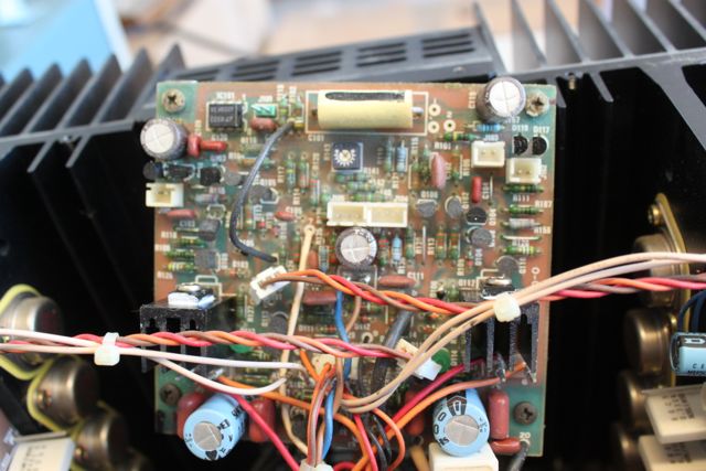

This amp had multiple issues when I got it. Fortunately I paid very little for it. I probably have about $250 in parts in it now (including a big pile for the big filter caps), but it seems to be stable and working very well. Now that I know the currents that work for the current sources, I'll probably measure my current source resistors and put in fixed resistors.
To catalog its ills:

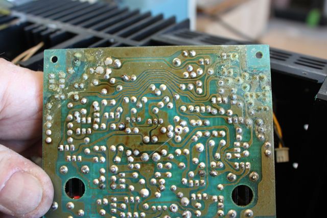

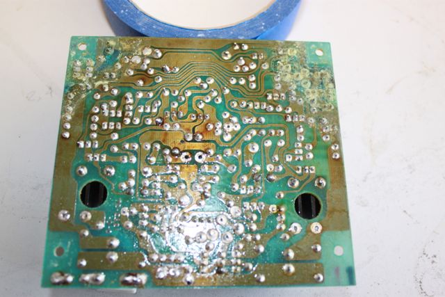

1. It had the well-known electrolyte issue. I found a good scrubbing with CRC 'Lectraclean, and Also CRC Air Intake cleaner (both very macho hydrocarbon cocktails) did a great job on the boards (see earlier posts for some pics of this).
2. It had multiple failed transistors, several bad dies and a couple of fried or otherwise open resistors. This made troubleshooting difficult, because until I managed to find all of the bad parts, it didn't work, and often replacing one bad part didn't work, because it had failed because of some other problem (like replacing blow fuse without fixing the short...)
3. There were several loopy "fixes" from some PO. There were those weird trim pots in place of the 1K load resistors on the diff pairs. not sure what the logic was behind those.
4. There were some quirky diode replacements. I went by the data sheets on the diodes, and found that in many cases the new replacements from Mouser and/or Dgikey did not match the data sheets (in terms of forward voltage drop). I actually need up with LEDs for one set of diodes (beyond the ones in the current sources), because these has the correct forward drop. The voltage drop on the diodes is critical to the proper bias set up of the driver stages. I suspect this is the key issue in most repairs (other than the electrolyte problem). If you just replace the diode and varistors with supposedly compatible parts, it may not work. SO pay special attention to the voltage drops, and check the parts you put in to be sure they perform correctly (vs just have the right numbering).
I now need to button it up, and install my cool fan arrangement.

Hi Scott,
Thank you for your kind words. You stuck with a difficult repair and saw it through to a successful completion. Many others would have given up.
As soon as you found the open zobel network, I knew that the amp would work as designed. The original repair attempt before you got it really didn't help you from a troubleshooting standpoint.

I have also shown in the figure two fault conditions that can arise in this amp. in the upper right side I show a situation where the positive and negative driver signals are offset in equal but opposite directions. The result of this is that the amp is in Class A (both banks conducting) over more of the signal cycle. This consumes a lot of power, since the banks are basically conducting higher current straight through from one bank to the other. My amp had this issue. When I bought it, the guy who sold it said "it hums". I though it had the 60 cycle hum typical of bad filter caps. No such luck. What he meant was that it physically hummed. When the output stages were connected the giant port transformer would buzz like a neon sign, the heat sinks would get hot, and the lights would dim a little.. YIKES!!!
The other situation is more typical Here the driver signals are offset in the same direction. This basically results in a DC offset at zero input.
Both of these situations can arise from the bias diode stacks being screwed up, or from the current sources being unbalanced. These two things play against each other as well, yielding some challenges when troubleshooting things.

I measured the current source pots as set for the performance in the pics above. They were within about 10% of the fixed resistor values on the schematic (one high, the other low). I replaced them with the proper 499 ohm resistors, and tested that. There was still a hint of oscillation, especially right after it was turned on. I traced this to the C103 and C104 filter caps that bypass the input stage load resistors (R106 and R107). After some fiddling, I tried a 10K pf cap instead of the 3800 pf cap. Worked like a charm!
I still had some lower frequency fuzz on the waveform, and I noticed that this changed when I touched the heat sinks, or covered the open unit with my hand.. So, I figured it was time to button the old girl up.. (I recall Chris had said that it was necessary to ground the heat sinks. I think this oscillation is what he was referring to. It looked to be around 100KHz...). I re-installed the control board, dressed the wires a bit, and replaced one of the 8.2K 2 watt resistors on the filter cap boards (I had noticed that the positive supply took about 5X longer to discharge than the negative supply, so I figured it might be the discharging resistor...). I put the top cover on, and replaced all the screws.
Here are the traces now. MUCH BETTER!!!
This one is a full rated power. The bottom trace is the input (2 volts/div), and the top is the output (50 volts/div). You can see that the amp is just starting to clip.
Here are the traces at my signaL generator's lowest signal level. Bottom is the input (.1 volt/div, top is the output at 2 volts/div.
I think it is working properly now. Time to connect it up to my system!!

However.. I then pulled out the control board and had a look at the bottom side.. FUGLY!!!
Here is the board as found...
And here it is flipped over...
As you can see, the caps have leaked and the electrolyte has corroded the circuits in the region of the caps. This is pretty much exactly what Anatech has described. My other amp must have had the caps replaced and the board cleaned, because it was nothing like this.
Here is a wider shot of the board too. You can see that the middle cap had also started to leak, but it had not gotten to the corrosion stage yet.
I removed the caps (what a sticky gooey mess!), and cleaned the board with my hydrocarbon cleaner (CRC carb cleaner), and most of the bad stuff came off. Here is the juice after cleaning! Remember, this stuff is clear to start...

Once the pads and the parts were cleaned, I re-installed the parts, and then reflowed every solder joint,and cleaned the board again.
One of the zener diodes fell apart as I removed it. I guess the lead was corroded through.. You can see how funky the part is..
I had an LM329 left over from the other amp, so I replaced this one with that.
It is all cleaned up now, but I need one more cap, so once I get that I'll re-install the board and give it a whirl.
