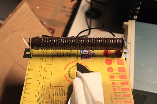

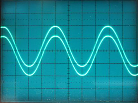

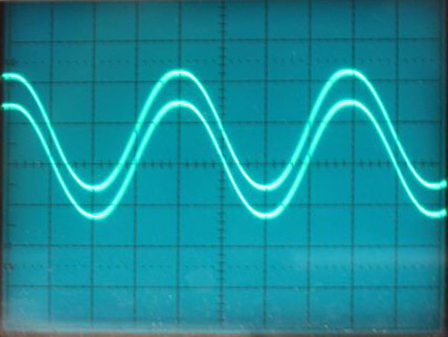

I spent a little more time with this amp today. after having everything in balance last night, I fired it up today and found it was again out of balance. Part of this was an obviously bad Q110 (probably stressed from the other issues prior to getting it all to work).
However, after trying to get it balance on its own, I resorted to putting in a pot at R144 (this is the resistor that sets the current source for the positive side diff pair. Note that yesterday my issue was the negative side overpowering the positive side. Today it was the opposite.
I thought for a while that maybe I had another bad transistor. To test this I jumpered a 6.8K resistor across R106 (the 1K load resistor on the Diff pair). this resistance value sets the voltage for Q111, and therefore sets the bias current for the Q109 and Q111 stack (the high gain driver stage).
By connecting and disconnecting this resistor I was able to shift the bias level at the input to Q109, and doing this I could see the collector voltage on Q111 change, so it was clear the transistors were alive.. Seeing this, and testing this on the negative side (R107, Q110, and Q112). Same behavior..
So, I finally put a 1K pot in place of R144, and fired it back up. Sure enough, by adjusting this pot I was able to completely null out the output offset!! As noted in one of my earlier posts, the net voltage changes from this at the Diff pair emitters was very small (a few tens of millivolts)...
I then checked the gain on both the positive and negative sides of the system. They look exactly the same (which they should since the gain is fixed by several precision resistors).

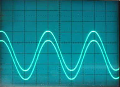

Here are the signals at terminals 3 and 4 of the board. I put a 680 ohm load across this point to emulate the input load presented by the output stages. This is at 20 volts per division, so you can see that each signal is running between 0 and +/-80 volts, This is the highest I can drive it without it clipping.
As you can see, the positive side signal starts at about 1.5 volts and goes to about 80 volts. and the negative side signal starts at about -1.5 volts and goes to -80 volts.
I see two serious issues with this image. First, each signal should be cutting off over about 1/2 the cycle. Otherwise each side is essentially operating in Class A.
More importantly, the fact that the two signals are 180 degrees out of phase seems odd since this puts the voltage peaks at the same time instead of anti phase. This explains why the amplifier has a huge hum from the transformer, since at the peaks it is basically passing current through BOTH output banks, and at the zero signal points both banks are cut off. Essentially in this mode the amplifier is a huge heater, but it delivers no power to the load...

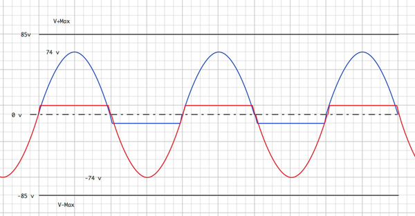

What we really want to see here is the following signal set:
So the signals should actually be in phase, and they should be 2X this signal level, only each one should represent only one half cycle. So the positive side should go from about -1.5 to +80, when the negative side is clipped at about 1.5 volts, and then the negative side should got from +1.5 to +80 while the positive side is at -1.5 volts.. At least that's how an AB amp is supposed to work...

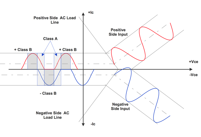

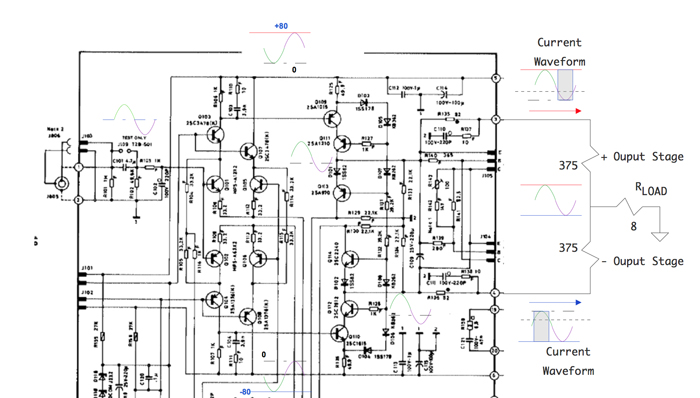

Here is an interesting diagram I generated based on the Class AB concept. It shows that the inputs to the output stages need to be IN PHASE. If they aren't then the amplifier will simply push current back and forth internally, and the potential on the load (i.e. the speaker) will be essentially zero at all times.
In practice the Class A region is actually pretty small. I have exaggerated it here to illustrate the idea.

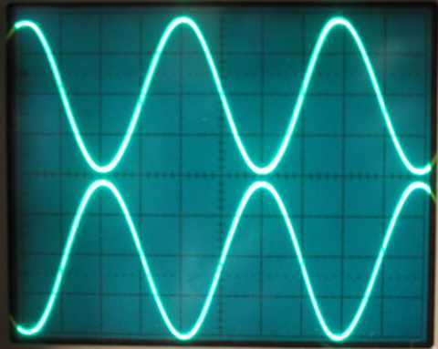

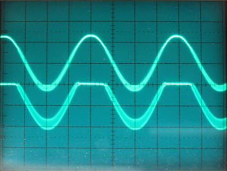

Now that I have the bias stuff squared away, I decided to have a look at what the waveforms are supposed to look like in the various parts of the amplifier.
Here is how I think they should look. Remember the service manual says that the control board gain stages are Class A. So taking that to heart, I am assuming that the Q109/Q111 and Q110/Q112 stages are biased to just turn on at zero input, and reach max current art max input wight he zero point somewhere in the middle (i.e. Class A).
Things get a little odd at the output, which I have simplified here to just resistor network, with zero current gain, since, as a current amplifier with push and pull stages, you really need to look at how the drivers are going to affect the currents through the load.
This morning I checked out the amp again with the setup as shown in the diagram above. As I suspected lying in bed this AM, I found that one channel of my new scope was on "invert".. so the waveform shown a couple of posts above is incorrect. Here is what the voltage signals at the "output resistors" looks like.
Zero volts is the middle of the display. This is at 5 volts/division.
And here is how these waveforms look tweaking the current source pot. As you can see the pot causes the displacement of the two waveforms up and down relative to the zero crossing, thereby adjusting the Class AB bias points. Because these circuits are linked by the output bias control network (that messy Q201/Q301 kludge) the two signals both change when the bias on one is adjusted. Using two pots (one on each current source), I will be able to adjust both the overall bias level AND the relative bias offsets, so then I can be sure the system is optimally set up.

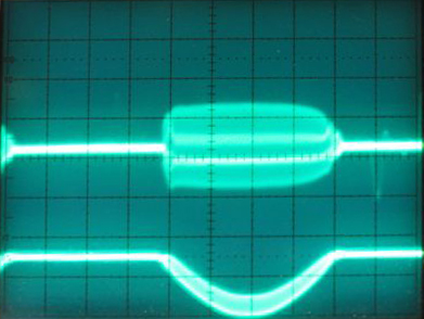

OK, so today I spent a few hours fiddling with the output stage.
There are no obvious shorts, so that's good.
I tried applying one control board output to the output board. The first observation is that since there are only positive and negative side currents at the output, you MUST have a load on the output. I had earlier gotten a big 350 watt wire would 8 ohm resistor...
so I hooked that up, and got the following result. This has the correct waveform shape, but there is obviously some oscillation...The upper trace is the output of the control board, and the lower trace is the output of the amplifier into an 8 Ohm load (it is a big 350 watt sucker!!).
I then hooked up the other side..and found it was the same. However, when I hook both sides up together, I get a single full wave form , but with a significant oscillation...
This gets MUCH worse when I connect the feedback line...
So now I need to figure what what is causing this oscillation...

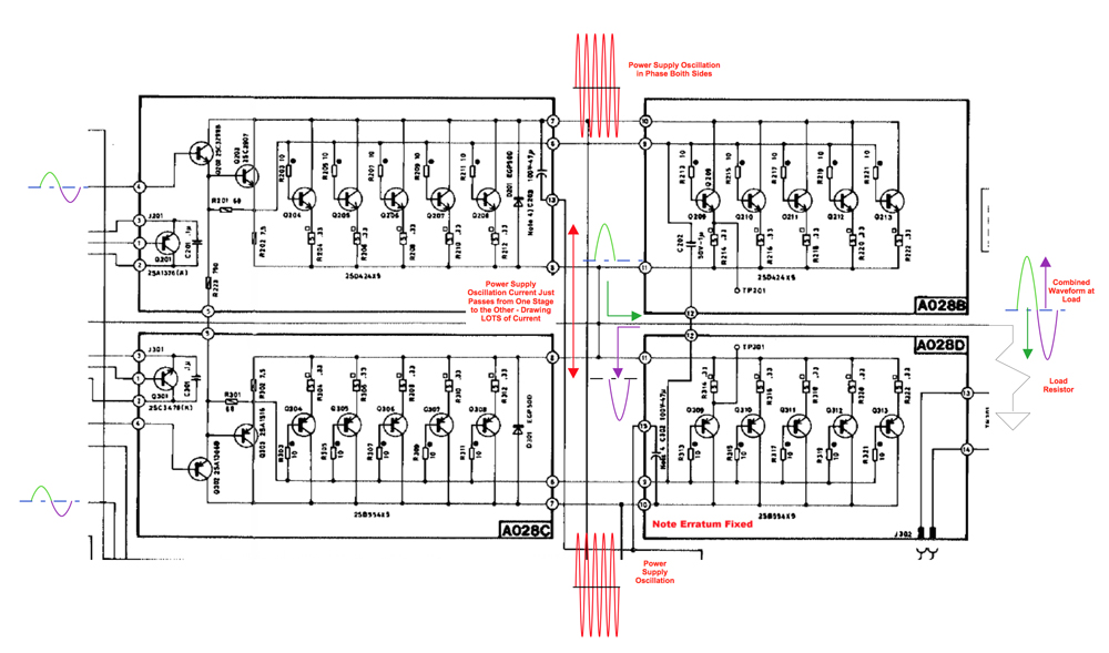

Given that this oscillation only occurs when the power stages are connected, and given that it gets worse when the feedback loop is closed, I think I can conclude that it is originating in the power stage. Also, since it is present on either side of the system (positive and negative) independently, I am thinking it may be a power supply issue.
What I can't figure out is why it would cause so much heating in the output stages. When I connect both sides the lights in my lab dim (yes, literally!), and you can feel the heatsinks warming up....I suppose it is possible that the oscillation is somehow out of phase between the two sides, and that is causing the transistors on both sides to come on at the same time. That would certainly cause this sort of power drain...
As I noted a couple of posts above, if both sides of the power stages are on at the same time, they will just pass current from one to the other. The load will just sort of watch this current go by, but, since the potential at the load will be essentially zero, very little of this current will pass through the load.
Here is the hypothesis in a diagram..
The audio input signal is shown in green and purple. When the green half cycle occurs, the positive side of the output stage conducts, Since the negative side is reverse biased at this point, it is not conducting (ignoring the oscillation), so the positive current flows to the load, causing the voltage to rise at the load. On the negative half cycle (shown in purple), the positive side is back biased and the negatives die conducts current the other way, causing the voltage at the load to swing the opposite direction. This is the classic "push pull " operation.
Now, if we introduce an oscillation in the power supply, AND if this oscillation is out of phase, so the negative side is swinging more negative when the positive side is swinging more positive, and IF (this is the big IF) this instability somehow manages to bias on the other output board, then we will get conduction through both boards at the same time, and so the oscillation will also draw lots of current.

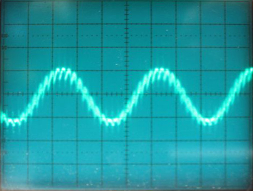

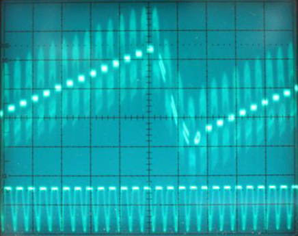

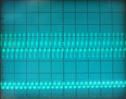

I took a look at the supply rails (at the big caps) with only the negative side conducting.
Here is the positive rail (top) at 50 mV per division.. You can see that when the negative side is conducting, it is oscillating at some very high frequency, and this oscillation also shows up on the supply rail.
I then zoomed in on this, and found that the negative supply rail has a variety of bad juju.. The photo is a bit blurry because there is so much hash that the scope had a hard time syncing.. But you can see there are at least two major oscillations on the supply rail. One is very high frequency, and the other is much lower. The lower sawtooth frequency is 20 times lower than the 1KHz audio signal, so it is going at about 60 Hz. That is almost assuredly AC ripple.. which isn't great, but is probably not my core problem.
The higher frequency oscillations are much higher. Here is a zoom of those..
I didn't try to measure the frequency of these, but they are very high, probably well over 100 KHz...The lower trace is the main output signal (a tiny slice of it in time, which is why it looks relatively flat). The upper trace is the supply line. It has the same high frequency oscillation as the output signal, plus some even higher components.

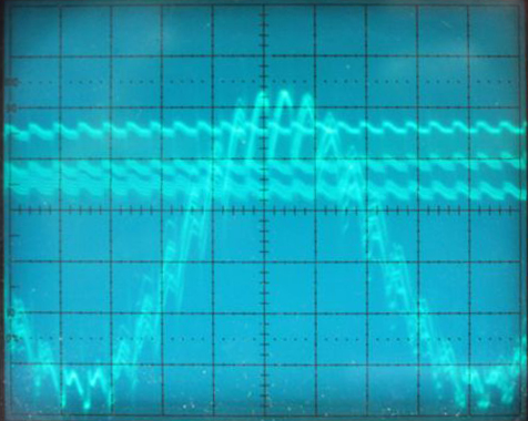

When I attach the other driver signal, I get the full audio waveform, but it has a substantial additional oscillation. This appears to be about 18 times the frequency of the audio signal, so about 18 KHz.
If you look closely at this image, you will see that, while I still have the higher and lower frequency oscillations (the zigzag lines on the power supply rail are just that 60 Hz sawtooth walking past the synced 1 KHz audio signal), but I also have this 18KHz signal which not only has the basic 18 KHz messy signal, but it also has some huge spikes (these are difficult to see because they are very short. I believe these are what is causing the conduction between the stages, and the high current draw. Fortunately they are very fast, or I'd probably have smoked the output stages. Even here I only connected the other side long enough to take the photo..
I am wondering if perhaps my big filter caps, or the main rectifier bridge are producing this..

My issue now is that I still seem to have some very high frequency oscillations in the amp.
This becomes much more noticeable at low signal levels because the amplitude of the oscillations seems pretty constant. So the lower the input signal level, the greater proportion of the signal is affected by this oscillation.
I'll take some photos of this and post them later tonight. It is difficult to tell if this is some artifact from my signal generator, or if it is actually something generated in the amplifier. It shows up on the two half cycles of the output as almost burst of super high frequency signal, and these bursts show up on the power supply lines as well. It disappears when I turn off the amp but leave to generator on, so I am pretty sure the amp is generating it.
