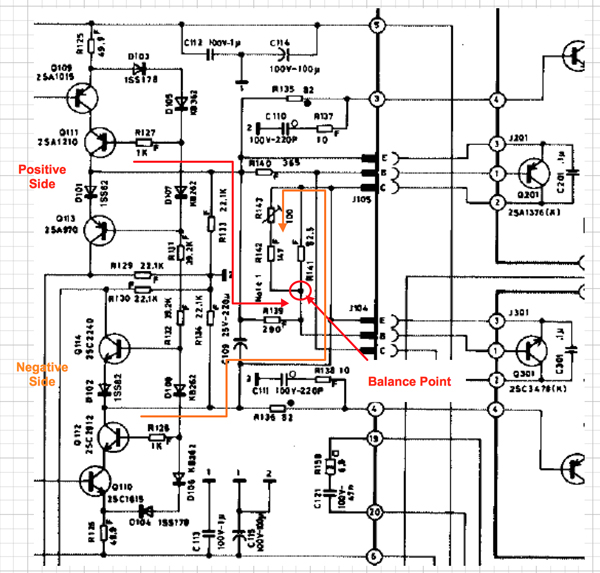

OK, I have been all over this thing. I discovered that D102 was shorted (not SHORTED, but it had 0.1 volts offset in either direction).
I have gain through both sides of the input stage (Q111 and Q112)..
BUT...
I cannot seem to get the DC offsets at the collectors of Q111 and Q112 to behave.
I get about -57 volts at each of the collectors.
I removed C109 and disconnected R139, which is the path between these two sides, and I get +/-80 odd volts on each respectively. So they seem to be behaving properly on their own. The issue is either something in the weird bias network involving Q201 and Q301, or it is some current imbalance which makes the negative side dominate when they are connected together through that bias network.
I am about to toss this thing in the trash...
S
BUT...
S

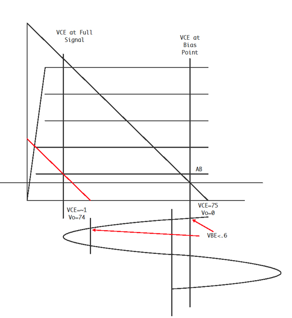

A long technical post....
I went and took some very careful measurements of the system with R139 and C109 removed. This separates the negative and positive signal sides, so I can see how they behave independently. Operating separately, I get about +/-82 volts on the respective collectors of Q111 and Q112. However, I also looked at an audio signal on these stages using my scope. My scope isn't particularly good (I just bought a new one on eBay, so that will be helpful when it arrives), but I was able to get a feel for the signals on each side from this.
The service manual states that the gain stages are "class A". However, this seems to be not quite correct. Obviously the input stages are full Class A. The outputs of each side of the input gain stage circuit swing over the full signal cycle, but it seems like the "driver stage (the one that drives the output stage) needs to be Class AB (maybe they mean the combined set of positive and negative circuits is class A.. Not sure I'd call it that...)
Based on the way the mid gain stage (Q109/Q111) is connected to the output gain stage the mid gain stage should do one of the following:
1) Swing between 0 and full scale (about 75 volts) for the positive or negative half cycle (plus a little bit to make it class AB vs class B). This would be a true AB drive stage for the output stage.
2) Swing between 0 and 75 volts over the full signal period on one side, and between 0 and -75 volts over the full signal period for the other side
If the second of these is the case, then the input stage of the output would be in cutoff over half of the signal period. The problem with this is that the signal would only go between 37.5 and 75 volts on one side and between -37.5 v and -75 volts on the other. So there is a large missing region between -37.5 and +37.5.
A third possibility is that each mid stage swings between +75 and -75 volts. The problem with this is that the topology doesn’t seem to allow for this, since each collector load resistor is grounded.
So it seems like option 1 is the most reasonable. This sort of seems to be what I am seeing on the scope, when the gain blocks are operated separately (i.e. with R139 disconnected, so there is no bias offset between the positive and negative sections of the circuit). I get a sort of half cycle looking waveform.
The question then is why does the negative side overwhelm the positive side?
I think the issue is that the negative side is biased into saturation all the time, so basically only when the input signal pushes the operating point up into the linear region for the device do we start to see the signal at the load resistor fall. I see this in the wave form too, which seems to only get the peak of the signal, so it is basically biased on with no signal applied, and only biased off at the peak of the applied signal (remember, in this circuit the emitter is connected through a resistor to the rail, so lower voltage input at the base means higher current, and a higher voltage on the load resistor (which is connected to ground).
So this appears to be either a stage bias problem (which doesn’t seem right, since the bias there is set by the diode chains (e.g D 103-107), and this seems pretty much the same for both sides), or the input signal (in this case the negative side input signal) is offset too far positive (or not negative enough), causing the driver stage to saturate. When that stage is saturated, then the load resistor will see -82 volts, and the system will deliver enough current to bleed through the output bias network to drive the positive side negative.
So, this seems to be primarily an issue with the offset from the negative side input stage being too low (insufficiently negative).
Looking at the diagram below, it is clear that if the base voltage at the input is too low, then the driver transistor will be biased too high, and VCE will be too low, even with no applied signal.
For this to occur, the current at the input stage would need to be too high, causing the drop across the input load (R106/107) to be too high, thereby lowering the voltage at the base of the driver (Q109/110)/

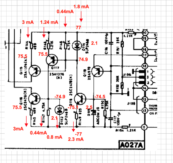

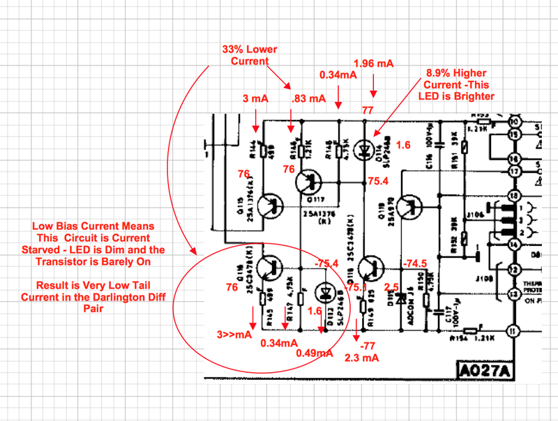

The input stage biases are:
Positive side: 40 mV across 32.2 ohms, or 1.2 mA
Negative side: 50 mV across 32.2 Ohms, or 1.6 mA
Clearly the negative side is higher! 33% higher…
Looking back over this saga, I found that at some point one of the LEDs on the board was dead. I am not sure if it was always dead, or died during troubleshooting. I didn't have a direct replacement, but used a different LED that I had (one that I used when matching the Darlingtons). I suspect that the device has a slightly higher Vf, and this biases the current source for the negative side differential pair at the higher current level. At 1.2 mA, the 1 K load resistor (R106) will drop 1.2 volts. At 1.6 mA the other 1K load resistor (R107) will drop 1.6 volts. Since VBE on the drivers will be the same (assume 0.6 volts), then the base voltage on Q110 will be 85-1.6=83.4v. So the emitter will be 84 volts (83.4+.6). One volt dropped across R126 (which is 49.9 ohms) is 20 mA.
In contrast, the same analysis applied to the positive side (Q111) comes up with: 1.2 V dropped across the 1K load resistor means that the base voltage on Q111 will be 85-1.2=83.8v. So the emitter will be 84.4 volts (83.8+.6). 0.6 volts dropped across R125 (which is 49.9 ohms) is 12 mA.
So the negative side is running 8 Ma more.. Which is 66% higher.. No wonder the output is unbalanced!!
The other corroborating evidence for this is that the waveform on the negative side is goes from about -75 to -70 volts and only covers about 10-15% of the cycle, whereas the waveform on the positive side (with the two sides separated as described above) goes from about 0 to 75 volts and covers at least 1/2 the cycle...
Once my new scope arrives, I'll take some photos..
I must say, that, despite the frustrations with this beast, I have dusted off a lot of circuit theory from 40 years ago..
It is also interesting to note that, while I measured the voltages at various points in the circuit, the higher rail voltages tend to drift around a bit, so it is very difficult to tell that one leg is a few tenths of a volt higher than another. In contrast, the low voltages at the diff pairs are very stable, and it is easy to see a few mV difference.. those small differences get multiplied up in the gain stages and can create big trouble, as we have seen!!
Scott
So I spent some quality time really understanding the Diff pair bias current circuit.
This circuit turns out to be key to the overall performance of this amplifier. If the tail currents are not set up correctly, then the bias current in the two diff pairs (positive side and negative side) will be different, and this will make the drop across the 1K Ohm front section load resistors (R106 and R107) slightly different.
For example, the drive current is supposed to be about 3 mA for the pair, or 1.5 mA for each leg. That would produce a drop of about 1.5 volts at the load resistor. If the currents are mismatched by, say .1 mA, then the load resistor voltages will be off by about 0.1 volts...
Now, this might not seem like much, but the gain of the following stage is about 200..so this offset will get multiplied by a factor of 200, and because the amplifier is DC coupled, that offset will propagate through the gain stage resulting in an output offset of 20 volts!!!
Normally when these are balanced, the voltages in the bias circuit formed by Q201 and Q301 (those odd transistors off on the output boards that are embedded in the heatsinks) are balanced. This means that the voltage at R139 (the balance point in the diagram below) should be about zero...
The servo can adjust some of this out, but the worse the offset, the more it has to do. Essentially what happens is that the Q111/Q112 stages start fighting each other. Whichever one has the higher bias offset will conduct more current, and once the servo runs out of steam (the op AMP output rails), the circuit can't compensate, and the DC offset at the output rises. In my amp, this offset meant that the offset at the balance point was about -55 volts (because the negative side diff pair was biased on higher than the positive side.
In practice, when the offset is large enough, it can drive the collector of Q111 (or Q112 - depending on which side of the diff pairs is biased more) to a high value in the wrong direction.
So bottom line is that the core driver of offset problems in these amplifiers is the diff pair bias circuit formed by Q115 to Q118.
Below is an example of how it is supposed to operate.
Here you can see that everything is in balance. The core issue here is that the LEDs (D113 and D114) must be the same, and they must have a voltage drop that corresponds to the voltage of the zener diode regulator D115 (The Adcom J6 part).
However, if the LED are different, OR if the voltage drop across them is not the proper ratio relative to the drop at D115, then all hell breaks loose!!!
I have not analyzed yet how the relationship between the value of D115 and the LED drops works, but here is an example of how mine changed with the wrong LEDs. Remember it was operating oddly when the LEDs were unequal, and it got even weirder when I made them both the same, but the wrong voltage drop value (in this case 1.6 volts instead of the 2.1 volt value as designed), so this circuit can go wrong in two different ways. An example of the matched but incorrect LED drops is shown below.
Here you can see that the lower LED drop combined with the unchanged value at D115 means that Q117 passes less current. Even though the voltage at the base of Q116 is the same as that at Q115, the current through Q117 is 33% lower than it is supposed to be (See diagram above).
The visible upshot of this was that the LED was barely glowing.. The circuit upshot was that the current in the positive side Diff pair was about 0.2 mA, making the drop across R106 too low, and thus causing Q111 to conduct less current than Q112...
Having done all of this, I am of the opinion that R144 and 145 (the resistors that set these current values) should actually be adjustable, so that you can tune the resulting tail currents fairly precisely. That way the balance can be tuned up front, and the servo and R143 in the output bias circuit can compensate for any minor thermal variations.
Once I get the amp basically working, I'll explore this option. I found a very high quality foil trim pot made by Vishay. It is a multi turn device with a super smooth and well controlled resistance vs position characteristic. The down side to this is that they are $13 each, which explains why Adcom didn't use this approach.
