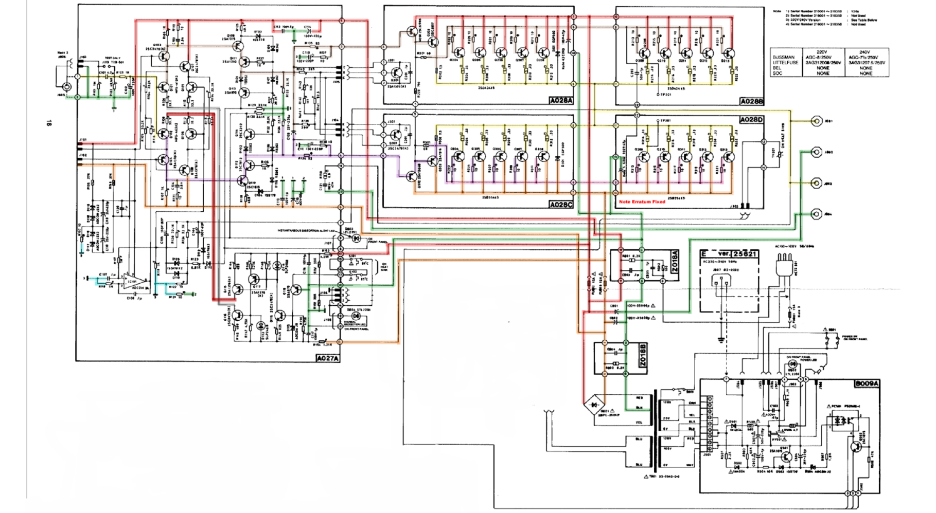

As provided at the other thread, I had found it somewhat difficult to use the schematic in the service manual because it was separated into two pieces, and also had a bunch of fan control stuff that wasn't of any use to me (my unit doesn't have the fan assembly).
So here, for anyone's use, is the schematic from the manual joined up on a single page.
You can also view or download this at:
http://mv-makoto.com/AdcomGFA-565SchematicJoined.jpg
In addition, I found it useful to trace the various parts of the circuit so I could better understand what signals and voltages I should find where, and also separate the various sub sections and functions of the circuit.
Here is the schematic with some of the signal and voltage paths highlighted in different colors. Green is ground, light Red is positive DC, light Orange is negative DC, Yellow is full cycle audio signal (which is found at the input to the amp, and at the output), Purple is negative half cycle audio, Brown is Positive half cycle audio, and Dark Red and Grey are the positive and negative tail current lines for the differential input circuits.

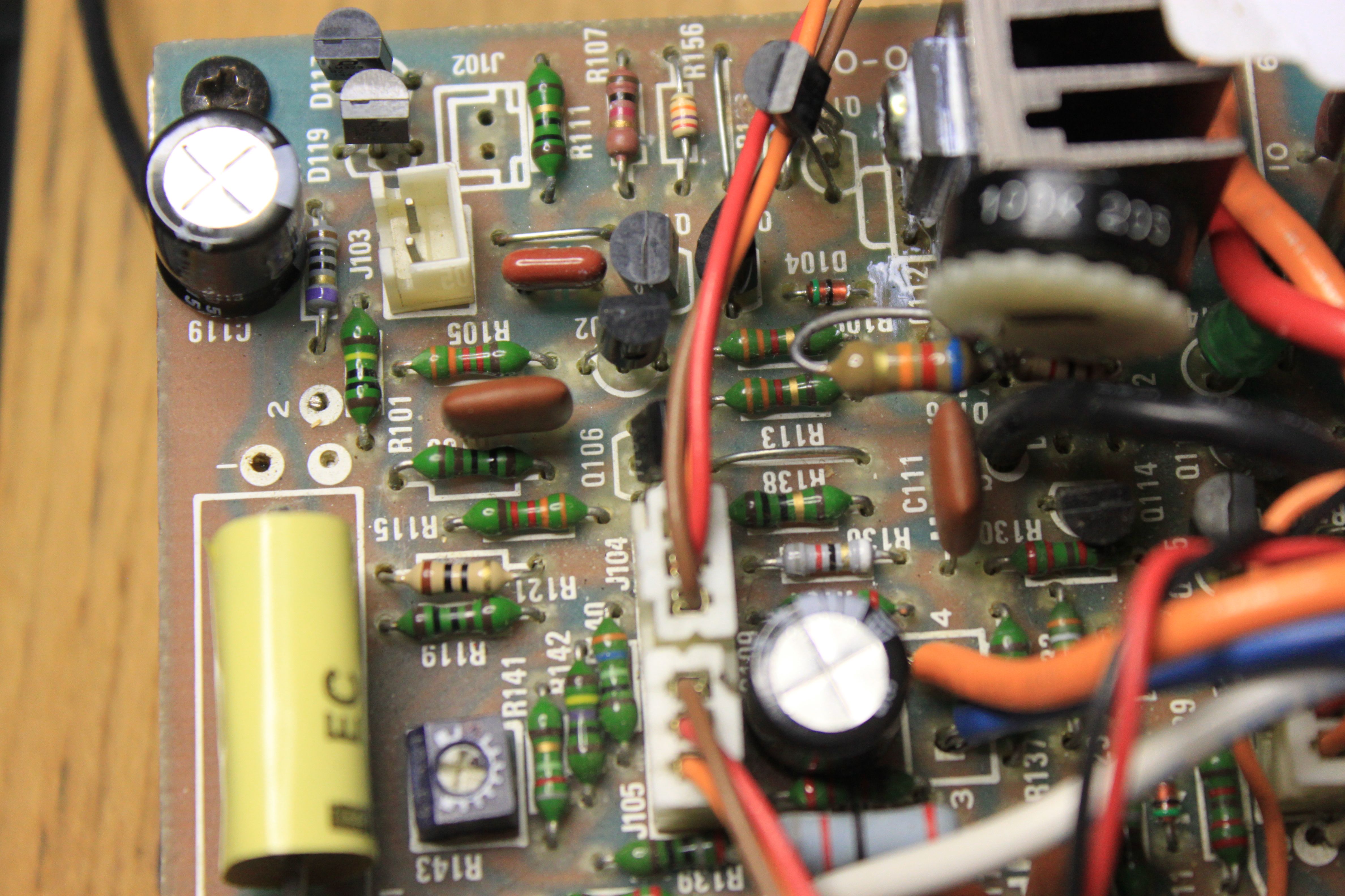

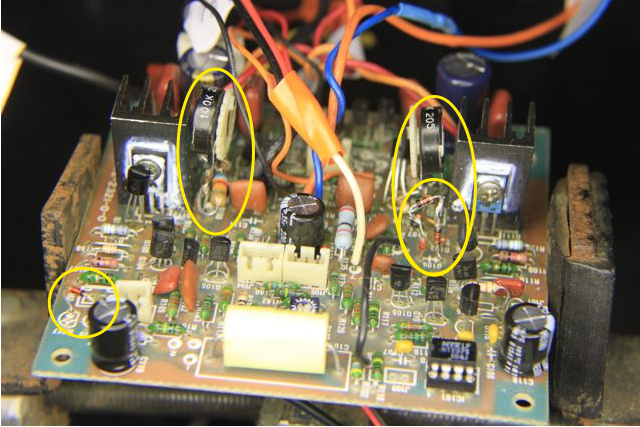

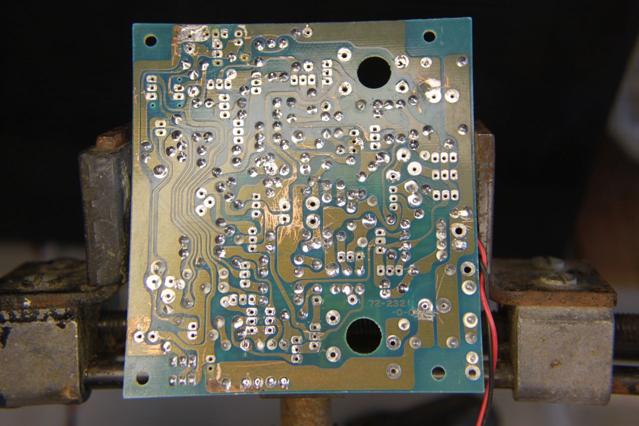

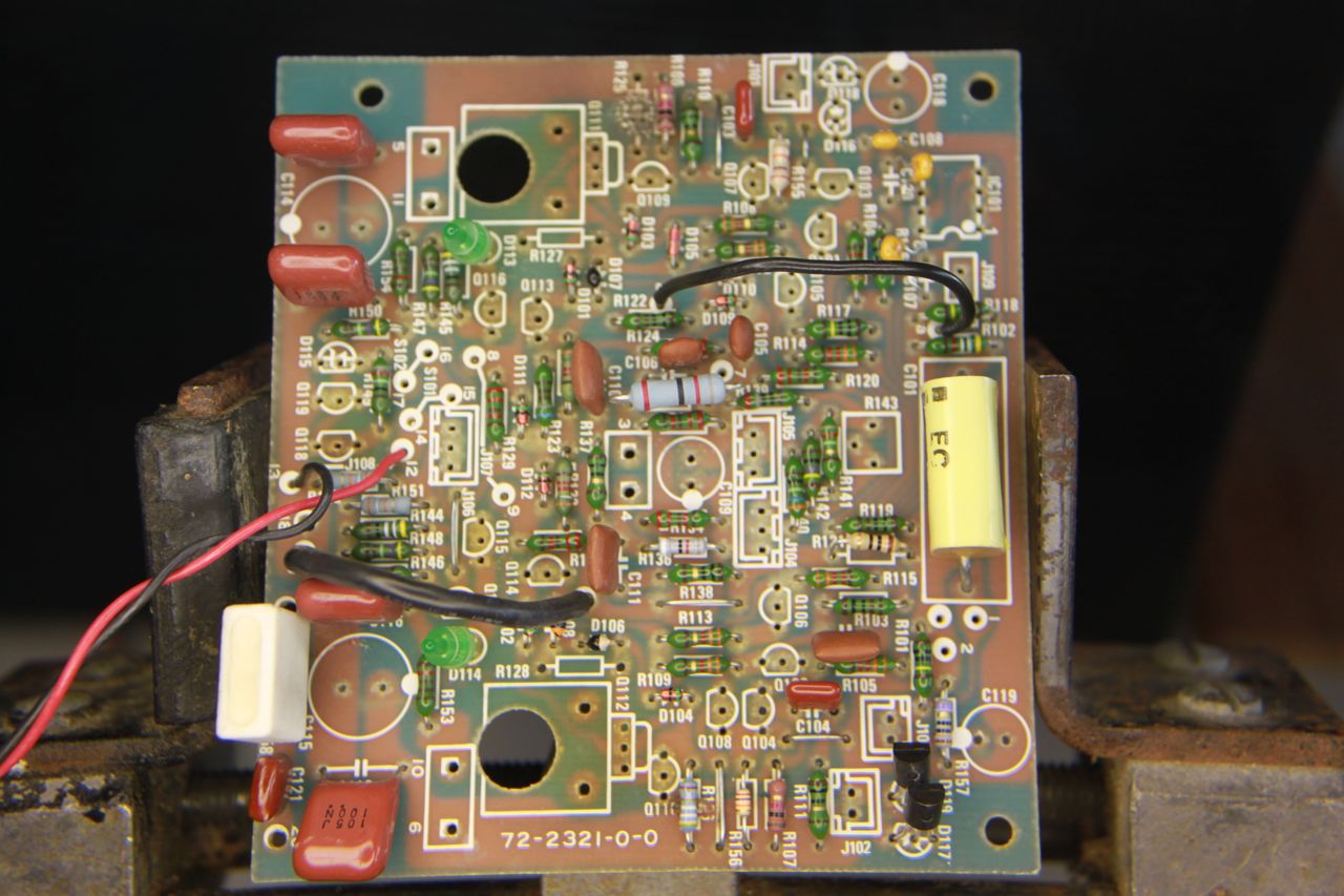

Here is a closeup image of the control board that I have been working on.
I have replaced the electrolytic caps, and cleaned up some amazingly bad soldering on the back side of the board...
In this photo you can see a number of issues. First, the PO seems to have taken matters into his own hands relative to the bias controls. The two trim pots with resistor assemblies under them apparently are meant to replace R127 and R128, which were 1K 1% resistors in the origin. This contraption allows variation between 980 and 36K ohms...Apparently someone didn't do their resistor value homework...
The next issue is that the precision low noise voltage references D116/D117 and D118/D119 have been replaced by single diodes of some unknown type.
The last issue is that the varistor D105 has been replaced by the little trio of flying diodes.. Yikes!!!
I have new diodes and a varistor on order (as well as a full set of other transistors and a fe other parts), and will see how this works once I have put it back to its original form.
Not shown is the fact that at some point the PO decided to add a 100 uf blocking cap on one of the outputs. I'll bet that sounded great..... :-(
Lastly, for some reason the leakage resistors and the mica bypass caps on the big filter caps were also missing. Those probably didn't do much harm (other than the HF noise reduction from the bypass caps), but one wonders who was mucking around in this amp.. It seems they had SOMe understanding of electronics, but not enough to fix it properly!!

Could you please post a high resolution picture of the control PCB as it is right now?

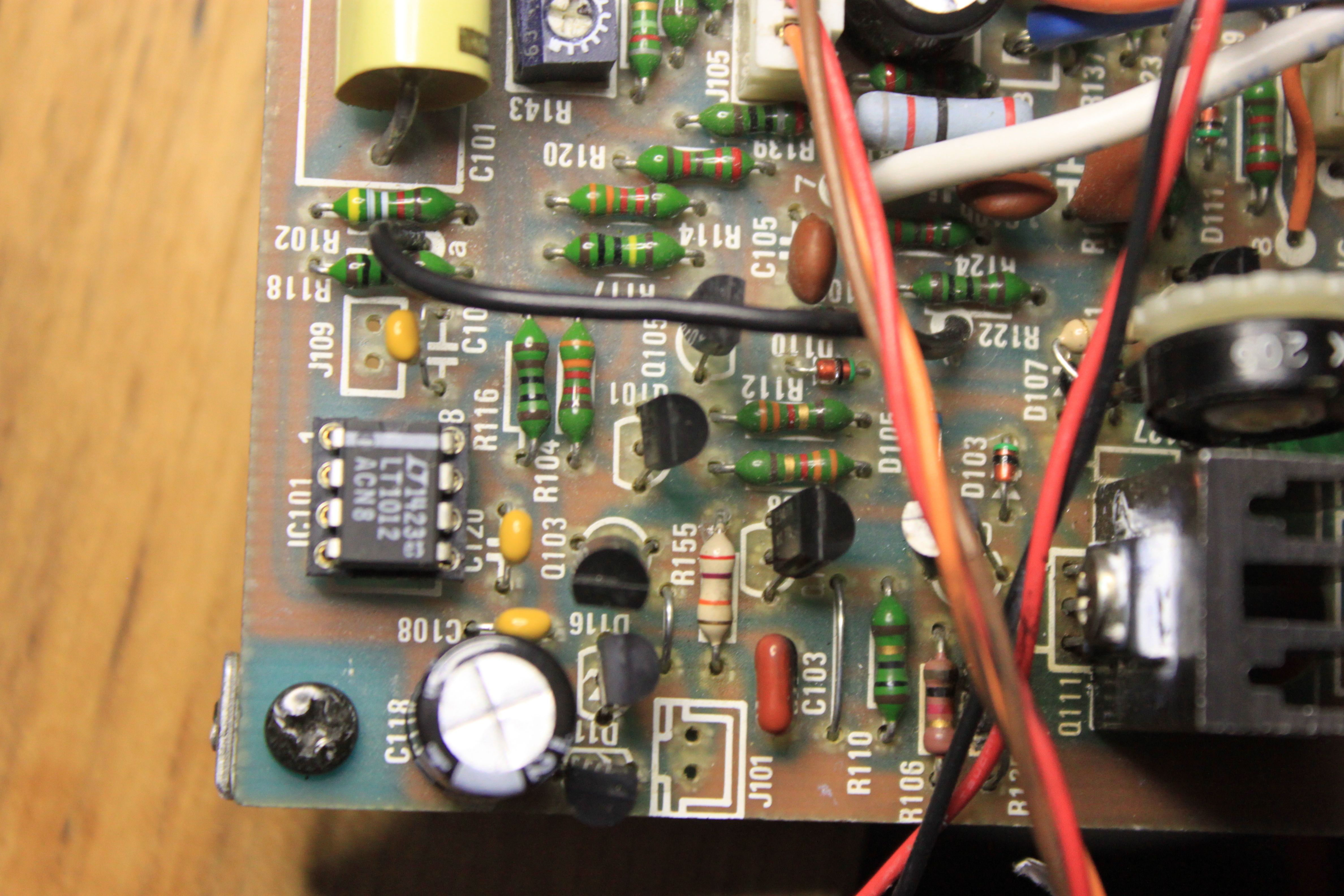

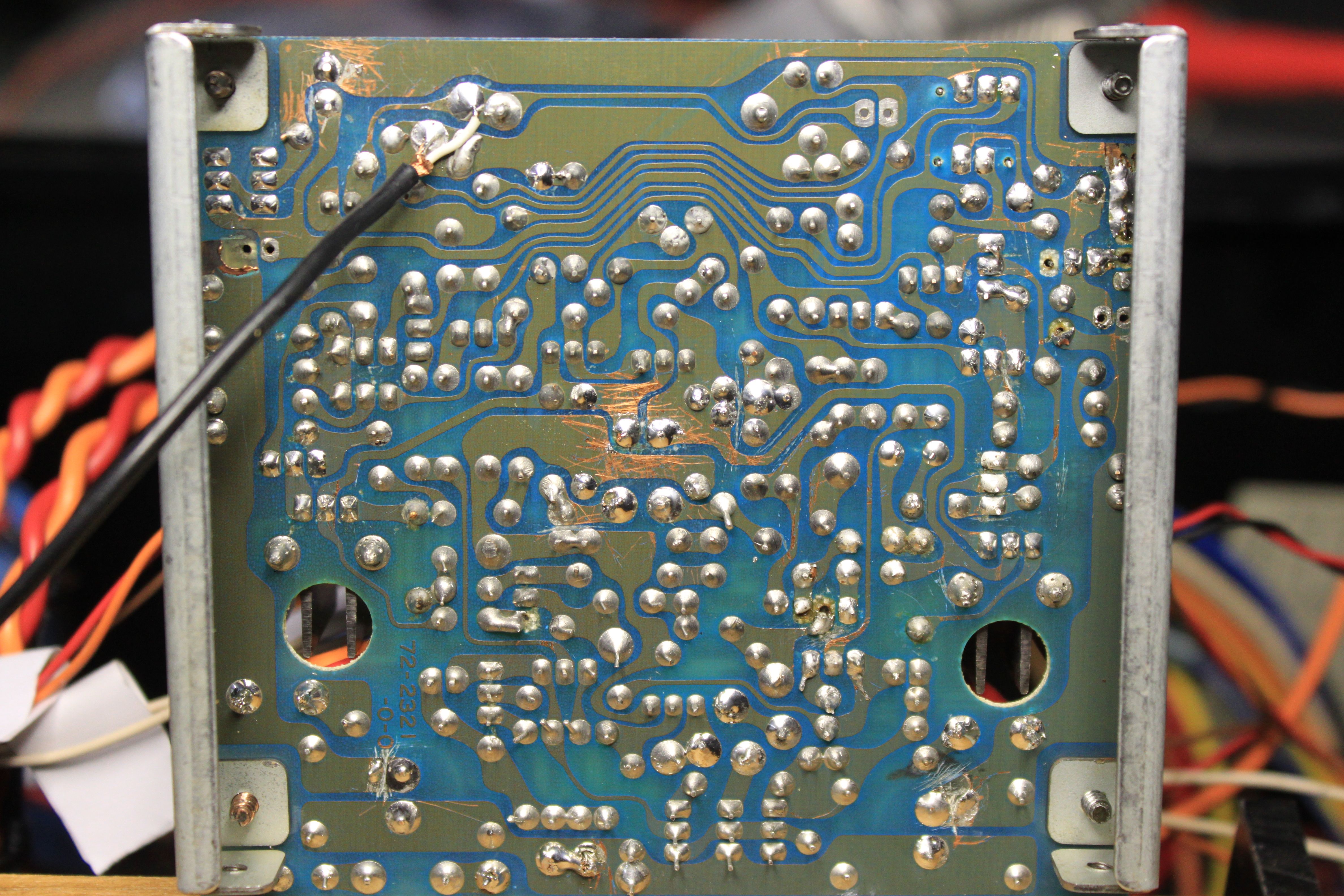

Here are a couple of closeups of the component side of the board around the caps, and one of the solder side There is some foil damage, but nothing too severe. The scratches are from the PO.
I have not yet replaced R127 and 128 but I set the pot networks that replaced them at 1K ohms within about +/-10 ohms. You can also see that the op amp was replaced using a socket. The op amp in there now is one I put in.
It sounds like my next step should be to remove the major components, test them, clean the crap out of the board, and then put the components back in replacing anything that is suspect.

When you rebuild the PCB after cleaning, lose the IC socket for one, also the network of stuff with the trimmer control. It appears that the previous hack artist had some problems with their soldering skills for sure. I would suggest that you use some liquid solder flux before stuffing the board to tin any iffy areas that need solder. One trick that works well is to use some solder wick that has some solder in it already. Use the flux on the area after it has been scraped clean, then rub with the soldering iron with the solder wick between the iron and the board. The mesh will fine rub the copper and deposit the solder in one go. Then you can solder component leads without overheating anything. I hope this makes your life a little easier.
OK, so I disassembled the control board (took the connector jacks, caps and all transistors off). Wicked and reflowed all the remaining solder joints, and then cleaned the board several times.
I used a couple of different very nasty hydrocarbon cleaners with a plastic scrub brush, and gently blow dried the board between cleanings. I used the little nozzle sprayer to thoroughly wash down the board under and around all the components. We used to use nasty stuff like this in heated ultrasonic baths for electronic components, so I was pretty sure it would work.
Here is one of the cleaners I used (the first was an automotive intake cleaner that had acetone, heptane and toluene. It instantly removed all the solder flux, and a good quantity of cloudy residue. I didn't save it because there was a lot of flux in it (I smeared rosin flux all over the board when I was wicking it). The second was this electronic cleaner, which is mostly various hexane compounds. It is super volatile and turns everything icy cold, so cold you get condensation on the parts unless you blow dry them.
Anyway, I was surprised to find that after the intake cleaner freed a bunch of crap (including the flux), the electronics cleaner still ended up with a lot of cloudy crap. Here is the catch bowl after two cycles. I eventually went through this about five times, until the off flow was clean...spraying and scrubbing with the brush, in all different directions, on both sides of the board. I got about three bowl-fulls like this before it came out clean.
Here are a few pics of the board post soldering and cleaning. You can see that at some point in its life R125 got smoked pretty spectacularly...
The board is clearly a LOT cleaner than it was, so good call Chris! And way to go nasty hydrocarbons!
I then checked all the transistors I had removed. Apparently Q112 was replaced at some point with some "equivalent" device. I ordered a new one of that and the mate Q111.
One of the 3478 transistors was shorted (not sure which of Q103, 107, 116 or 118 it was - since they were out of the circuit). I ordered new ones of these
One of the 1376 transistors was open (again, not sure which of Q104, 108, 115 or 117 it was - since they were out of the circuit). I ordered new ones of these

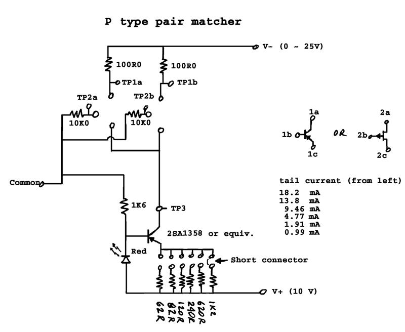

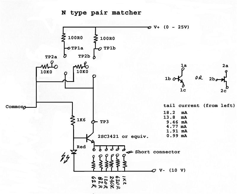

Well, that is how my transistor balancer jig works. You must use a pair of transistors as that eliminates the temperature variable. However, I just discovered something. I was balancing some transistors for an amplifier that runs the diff pair hotter. It runs at 6 mA, and at that current, the transistors balance faster and are more stable. The correlation between the higher current and the lower ones still needs to be confirmed, but doing this at the higher current is less of a PITA.
Resistors. Yes. They should be matched. I used 1% resistors, then ordered 0.1% resistors. 4 100 R and 4 10 K. The 100 R is for collectors (PNP and NPN). The 10 K ones are for the base connections. It works extremely well and completely solves my "transistors matched for beta, are not mated very well some times" issue. Now everything behaves and is predictable.

Hi Scott,
Yes, they generate their own heat to the extent that a simply foam "hood" fits over and is quite enough for isolating them. I drop a box, about 4"square over the matcher to kill air currents. When I designed it, it had to be stable and easy to use, and not take up a lot of space. What came together answered all the requirements. It will work fine at 1 mA tail current or less, but it does take a fair bit longer to settle down. I have nothing else that will allow matches to this level.
I built three of these things. One one perf board that I used so much that I decided to commit it to copper. The next used the header jumpers and the one I just made uses DIP switches. These are switched to select the tail current. It's easy to match a pair, then check the match at various current levels.
All this thing is, is a differential pair that places the transistors in thermal contact and has a built in current source for each polarity. This allows me to accurately measure the differences in current each one draws by simply hanging a meter between the collectors. By making it a stable arrangement, you can also measure across the 10 K base resistors to read base current, then individual collector currents to figure out the real beta under the conditions of operation. Nothing about this is automatic.
I have attached a couple images that show the basic schematic and a picture to show you a detail of how the current source is set up. Notice the foam under the pass transistor to thermally isolate the LED voltage reference. This makes the current source more stable for temperature changes as the LED tracks the transistor temperature.
