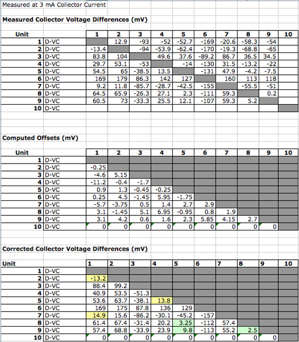

I built up the test circuit per your schematics, and re-tested the NPN Darlingtons.
Here are the results. You can see that the numbers ARE rather different. The really out of bounds transistor (#6) was still out of bounds, and in general the pairs that were close in the last test were close in this test, although the specific matches changed a bit.
The collector voltage differences in this test were higher, and, since I was using 0.1% resistors, the offset voltages were much lower.

Hi Scott,
Yes, your time is about right between tests. Try leaving a close pair in overnight and check them in the morning. If your foam gives good isolation and there is a cover, the pairs will settle down more quickly. I find there is a slight thermal oscillation, sometimes more pronounced than others.
You must have done your single measurements very carefully. That also takes time. Anyway, I'm really happy you find that method helpful. Once I built one up, I began using it constantly. It became obvious that my breadboard creation was being used to death, so I committed the design to copper.

My first measurements were also in pairs. I test the pairs both ways in the circuit: For example #1 in position A and #2 in position B, and then reverse them. Doing this, you can back out any differences in the differential circuit. It doubles the amount of testing, but it gives very good result.
I too saw that thermal oscillation. Often the pair will settle down over about a 2 minute period, and then slightly overshoot the min or max voltage difference, band then settle back by about 0.2 to 0.4 Mv.
I left one pair in while I was off doing something else, and after 4 hours they had drifted about 0.2 mV form what I had measured. So I think the measurements are pretty close.. certainly within a mV or so.

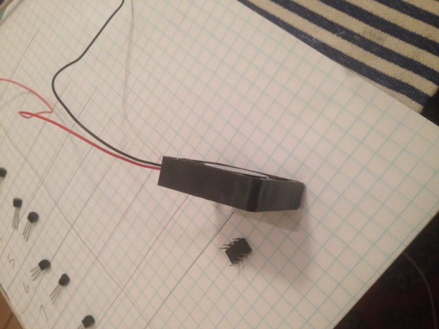

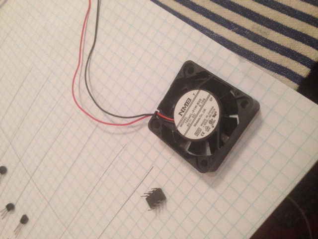

I tested the 12 volt DC fans. They work fine at lower voltages. At 4 volts they are almost imperceptible sound-wise, and they still create a nice stream of air.
http://www.mv-makoto.com/adcom/fan2.jpg
