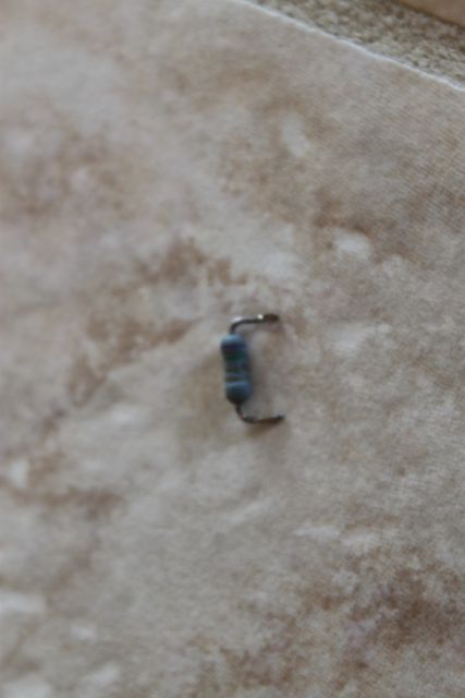

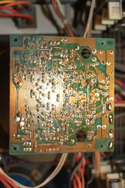

Just scored another 565.. This one is advertised and having a "hum"..I know what that means..... 🙂
So with a little electrolyte scrubbing and resoldering (or maybe a control board replacement), my small collection will be complete!
Scott
Scott

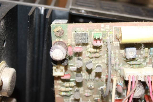

Well, a nice relaxing afternoon of troubleshooting on amp #2...
I have two observations.
First, the soft start board appears to have some sort of issue. I determined this when I found that the LEDs were barely on. Out of the circuit, the forward voltage on the diodes is about 1.7 volts. In the circuit, it is about 1 volt to 1.5 volts. The really weird thing is that the voltages on the connector seem pretty wonky. With the connector unplugged, pin 3 (the middle pin) is about 40 volts. With the connector attached, this drops to 0.5 volts. This line is supposed to bias on Q119, which turns on the input diff amp current sources, so if it is not switched on all the way, the current sources are starved. I see this in a sort of half clipped signal waveform. As an interim solution, I soldered a 330 ohm resistor (I started with 10K and worked down to that) across pins 2 and 3, and it came on fine. It's a little weird now because without the soft start cutout, when you turn the amp off, the waveform takes about 10 minutes to completely die away as the big caps discharge.
I think either the transistor on the soft start board is bad, or the opto coupler is bad. I'll sort that out tomorrow. That silly little board is really hard to work on-being down in the bottom of the amp...
The second issue is a weird slow start on the positive rail. This may be due to the current source/soft start issue (I didn't want to simply short pins 2 and 3, so Q119 may not be switching all the way on yet). . Basically, when you first turn the amp on, no current flows in the positive side bias diode stack. If you give it a minute, it will eventually come on. I have not tried to sort this out. I am thinking it may be either a funky bridge, or possibly a leaky cap (although I would think that would get pretty hot if it was shunting the supply line. I'll put my DVM on the supply rail next time I turn it on. It may also be some quirky bias issue caused by the current source issue. If Q!!! is biased on full blast, I suppose the
Once it is on, everything seems balanced, but the turn-on issue means that the output is way off until the positive side comes up.
I'll do a little more on this tomorrow.
Scott

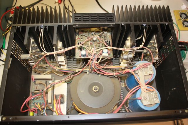

This is a long, but hopefully informative post for folks working on these amplifiers.
I tinkered with the soft start board, and decided that it was OK...Just me not really understanding it.. But the parts seem to be working properly..
So, on the #2 amp, I removed the heat sinks, and TO-126 transistors, and cleaned them and the board some more. It is pretty darn clean at this stage. In testing there are no stray voltages anywhere on the board between the races, even at the mV level.
If you really want to follow this post, I suggest you have ready (or download from the first few posts of this thread) the schematic of the amp (I am sure Chris knows this scenic by heart....)
Since it was still not working properly I decided to isolate the positive and negative side amplifiers, and see what did and didn't work. It's very hard to tell when the + and - sides are linked. They are linked through the bias network that comes after the driver stage. Specifically through R139, and C109 (the electrolytic cap in the center of the board).
Removing Q110 and Q109 also allows you to test just the input diff amp stages.
The findings:
The input diff amps work great.
Connecting Q109 and Q110 results in a weird output on the diff amp output (i.e. at the signal sides of R106 and R107), and a similar, but higher level weird output at the collectors of the driver transistors (the big ones with the heatsinks).
I then experimented with my variable current source resistors (which go from 240 ohms to 1240 ohms). I found that by REDUCING the current levels in the diff amps, I could get the outputs to operate properly. Obviously, this is some sort of bias level issue. The only issue is that you have to reduce it a LOT! Normally each leg of the diff amps runs at about 1.5 mA each, so 3 mA for each pair. The current level that works is only about half that.
I then put the 499 ohm current source resistors back in, and started checking the bias diodes (the ones in the diode "stack" - D103, 105 and 107. These are used to set the operating point for Q111 and Q112 (the drivers). What I found here was that, with the current source set properly, I had to put in larger voltage drop diodes, and even then what I ended up with was a clipped, but not totally weird output waveform.
As an additional experiment, I tried the amp with the pre-drivers installed (Q109 and Q110) but with the drivers removed, and a 1K resistor across the emitter base pads of the drivers. This resulted in the weird waveform again, which tells me that there is some weird issue with the bias on These pre-drivers.
To confirm this, I then tried reducing the current level from the diff amp again, and presto! high signal from the collector of Q110 (I only did this on one side of the amp).
Looking at the circuit, if the current draw on the diff amp is higher, then the voltage drop across the 1K collector resistor (R106) will be higher, and the voltage at the base of Q109 will thus be lower, so that device will be on, and close to saturation. Since we know the amp was designed to operate with about 1 mA of diff amp leg current, the drop across R106 SHOULD be about 1 volt. What this REALLY means is that the EMITTER of Q109 is at the wrong voltage, and this points to the diode stack.
How this can occur depends on some slightly not immediately intuitive (to me) observations.
The drop across these diodes is sort of fixed, but in reality it depends on the forward current of the diodes. Remember the diode turns on at some specific voltage (which varies from about 0.2 volts to about 2 volts, depending on the diode type), but the forward current increases exponentially as that voltage increases beyond the turn on voltage. If you loo closely at the diode stack, you will see that it is never referenced to ground. Instead it passes from R125 to D103 to D105, to D107 and then to R131, where it then picks up and goes to R132, and back up the negative side diode stack to R126. This means that any error in any of the diode drops or R131/132 will propagate to the other bias points, on either side of the power rails. There may be a design reason for this, but this approach also seems to be the root cause of the bias instability of the amp (thus requiring the servo), and is also, I suspect a key element of the tendency to difficult to control DC offsets.
More in the next post.
Scott

Continuing:
The operation of Q109 (and Q110) is a little hard to follow. To understand it, you have to look at how the diff amp generates the signal swing at the base of Q109 (or at the non-rail side of the load resistor R106).
When the output of the Diff amp is at its peak, the current through the conducting leg of the diff amp pair is at its minimum (the diff amp swaps the constant current back and forth between the two mirrored halves of the diff pair over the course of the signal cycle). So, this means the voltage drop across R106 is at its minimum, which means it is as close to the rail as it is designed to be. So, with the constant current sources properly set, the voltage when the Diff amp output clips at the load resistor is the voltage where Q109 should be just past its turn-on point. A transistor is pretty much like a diode in this respect, so, figure on about 1 volt across the emitter base junction at turn-on.
This means that whatever the voltage is at the emitter of Q109 at this point (i.e about 1 volt ABOVE the clipping point at R106) sets the the minimum drop across R125 (the 49.9 ohm emitter resistor at Q109). The drop will get much greater as Q109 and Q111 turn on, since they will draw a lot more current through R125 than the diode stack. I am not sure how the fact that the diode stack voltage will vary, and this will change the operating points of of Q109/111 affects things.
It is either a design feature involving some sort of temp compensating feedback, or it is a source of some small non-linearity. I'll explore this sometime...
Since Q109 is right at cutoff, the emitter current will be nearly zero, so, and this means most of this current is going down the diode stack at this point in the cycle. Since the voltages will only go down from here, this is the maximum current we will expect to see in the diode stack. We can calculate this current, sort of, by assuming some drops for the diodes, and ultimately figuring out what voltage is applied across the R131/R132 resistor pair. If we actually have the current voltage curves for the diodes (which we can get), then we can work our way back up the stack, and correct those drops, and then recompute the current through the resistors, and eventually arrive at a set of drops at some fixed maximum current, and then test the diodes for this.
I'll to this tomorrow.
The next element is to basically reverse engineer the bias design for the driver stage. This is a combination of determining the currents through R125/126 at the turn-on points for Q190/Q110, and making sure the maximum current through the diode stack fits that (plus a little). We can then figure out how the diodes are performing relative to what is expected of them.
This is for the next post an a day or so.
Cheers.
Scott

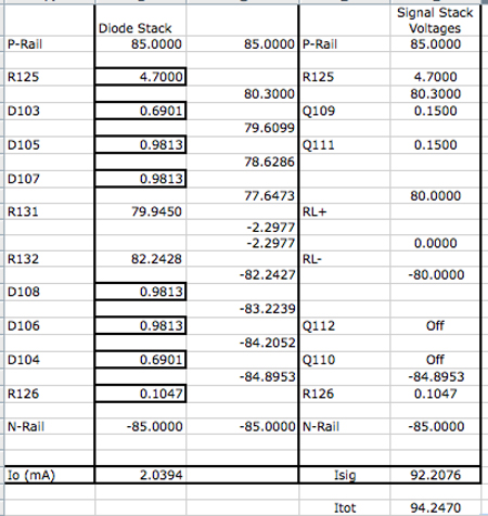

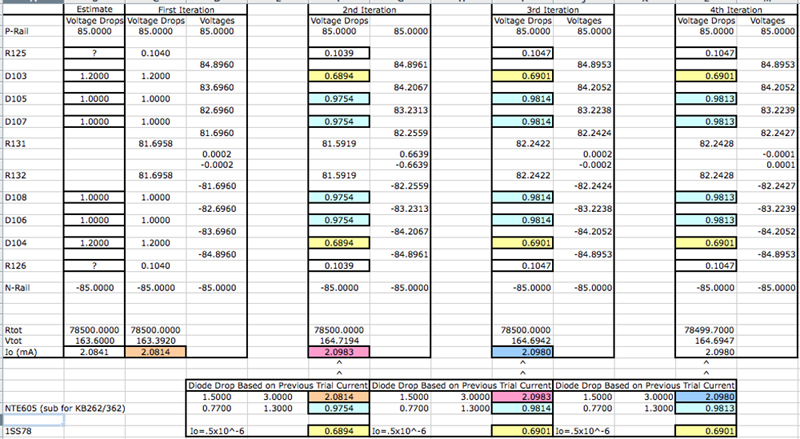

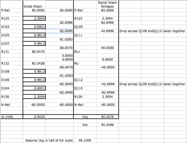

OK, so I modeled the diodes form the data sheets, and did an iterative computation to determine the currents and voltages we should see in the stack at various points in the signal cycle.
Point A: Q111 near cutoff, Q112 near saturation:
Point A: Q111 near saturation, Q112 near cutoff:
Point A: Q111 and Q112 at mid bias (for Class A, this is what we should see with zero input signal.
Here is the basic Diode stack iterative analysis, done assuming no current through Q109 or Q110. I started not knowing the drops across R125/R126, and guessing art the drops across the diodes based on their published specs. I then computed the current that should have flowed through that circuit, and using that, and the diode models, competed new values for the diode drops and the drops across R125/R126.
Using those values, I then recalculated the current. Noe that there is an ambiguity in the voltage value between R131 and R132. If everything is correct, these should be the same. Using the new current value, I then recomputed the diode and resistor drops, and did this a couple of times. YOU can see that in the 3rd and 4th iterations, there is hardly any change. So the values in the 4th iteration column appear to represent what we should expect to see with no conduction in Q109 and Q110 (an obviously synthetic case for a class A amp, but useful later...).
Now, in the real world, the two ends of the amp are working in opposite phase. This means Q109 and Q111 are near cutoff when Q110 and Q112 are nearly fully conducting. TO get a feel for the behavior of the bias circuit in this case I computed the current and drops across the signal chain (starting below with Q110/Q112). I se the target collector voltage for Q112 at -80 volts (See couple of posts above for this). Based on that, and the published Vce-sat voltages (about 0.15 volts) for these devices, I determined that the voltage at R126 shod be about -80.3 volts. This set the current across R126, and also changes the voltages for the negative side of the diode stack.
This is shown below below. Here you can see that the current though the diode stack has changed very slightly (2.03 mA vs 2.2 mA), but this is too small a change to change the voltage drops. So, using this new voltage at D104, we can update all the voltage values for the negative side stack, and we find, interestingly, that the junction between R131 and R132 has a slight voltage change. Form zero to about 2.3 volts. I had originally wondered why the designers had not just set this junction to ground. Now I know.. They didn't want to unbalance the currents in the negative and positive side diode stacks..so this junction floats, and over the signal cycle it is allowed to move up and down.
And here is the corresponding table for the positive peak. You can see they are symmetrical.
And finally, I worked out what we should see when the signal is at zero (either in the midpoint of the cycle, or with no signal applied). Remember, this section of the amp is operating in pure Class A, which means the zero signal bias point needs to be about midday between the two peaks (which was why I bothered to determine what those peaks looked like). Setting the zero point collector voltage ±40 volts, I then used half the signal leg current for the peak values (either of the previous tables), and was able to determine the drops across R125 and R126. I could then work backwards to update the diode table once again. So these diode drops and voltages in the circuit are, to the best of my ability to determine them, the voltages we should see in a properly operating GFA-565 with zero signal applied...
Now, it's back to the lab to see his my amp compares with these..
Scott

Well, that was effective!
Got my #2 amp working perfectly today.
Some useful observations for troubleshooting these amps:
If there is a large output offset, it is probably best to not stress the output stages, so I disconnect the output wires (3, and 4), and shunt those pads with a pair of 330 ohm resistors (across pads 3 and 4). This provides a return path for the currents from the driver output. Using a pair, connected together, you can round the junction between them, and isolate both sides of the amp, or you can let the junction float, which is how the amp actually operates.
I disconnect R139, which is a 280 ohm resistor that ties the two driver outputs together, and I remove C109 (the 220 uF cap in the middle of the board). The cap is only a 25 volt device, and if the driver outputs are whacked, the DC across this device can get quite high (as high as 160 volts!). I noticed the one on my #2 amp bulging slightly while I was troubleshooting it, and, not wanting to get sprayed in the face by an exploding cap, I decided to take it out until I had the outputs stable.
Since the outputs are disconnected, the feedback doesn't work, so when you drive the amp with an input signal, you need to attenuate it about 10:1 from the normal 2 volt line level.
With the two sides disconnected except by the output resistors, you can then see what the signal levels and voltages are on each side without them heavily corrupting each other, and this is very helpful in figuring out what is wrong.
As an example, today I did this so I could compare the bias voltages in my amp to the ones I had worked out a few posts above. I found that, at zero input, and with the junction of the output resistors grounded, the voltage at the collector of Q111 (the positive side driver transistor) was about 10 volts, but the voltage at the collector of Q112 (the negative side driver transistor) was -84 volts. However, inexplicably the voltage at pad 4 (the negative side output was zero. The connection between these is R136, a fusible 82 ohm resistor. Sure enough, it was open (I found nearly every fusible resistor in the #2 amp was open). As soon as I replaced that, the voltage at the collector of Q112 went to -14 volts..
I then replaced R139, and tested it with an input signal. It was prefect, so I hooked up the feedback and the output wires, and tested it with the output stages. It had good output signal, but it was offset. I then remembered that I had the servo Op Amp out, so I put that back in, and tried it. Perfect.
One other observation on these amps is that the current sources are not super well matched. This is unfortunate since any mismatch shows up as a DC offset, and that has tone swamped out by the servo. In the above case (where I had some DC offset until I installed the Op Amp) the positive side was being driven with 1.5 mA, while the negative side was cooking along at 1.8 mA. This may not seem like a big difference, but this means that there is 0.3 volts of DC offset from one side to the other at the driver inputs. The drivers have HUGE gain, so this small DC offset gets amplified significantly. it seems to me a better design would have some sort of compensation to make the two input stage currents the same, or it would include provision for adjusting this parameter.
I tried this by putting one of my precision potentiometers in place of one of the 499 ohm resistors in the current source (R144/R145), and was able to easily adjust the offset to zero with no servo at all. I may think about this a bit, and see if I can devise a better current source that is better matched, temp stable and has fine adjustability. If I do, I'll build that into my new board layout.
On to #3!
Cheers, Scott

So, I decided to open it up.
It was a dusty dirty mess. Clearly never been opened up before, which is probably a good thing, given the chaos my #1 amp had seen.
Here are a few photos of it, just opened.
I then removed the control board, and found, what I suspected.. Corrosion from one leaky cap, and two other caps on the verge of leaking...
Here is the bottom of the board. You can see the corrosion on the upper left corner
The other two caps were wet and goopy on the bottoms, and left wet goopy spots on the board after I removed them.

This is yet another fusible resistor, which clearly has fused.. I have found many of these devices dead in the various instances of these amps. I think I'll replace it with a 10 ohm resistor and see if the output stage works, and if so, I'll then replace it again wight he proper device.
