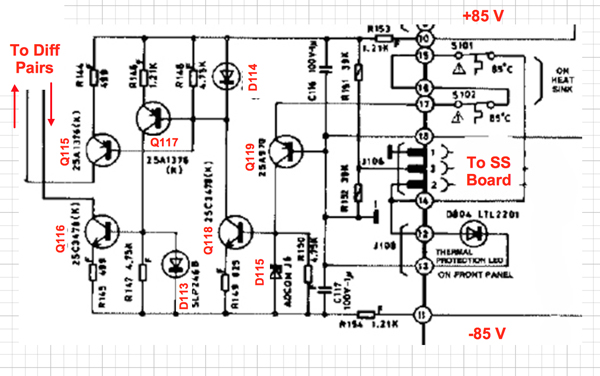

Here is a brief walkthrough of the original current source circuit:
The emitter of Q119 goes through the heatsink thermal switches, and eventually goes out pin 2 of the J106 connector. this leads it to the opto coupler on the soft start board. R151 and R152 form a voltage divider that puts about 42 volts on pin 3 of J106. When the soft start board is energized, the opto-coupler closes the circuit between pins 2 and 3 of J106, thereby allowing current to flow in Q119.
When current is NOT flowing through Q119, R150 bypasses D115 (which is a 2.5 volt reference diode), so the base of Q118 is at about -85 volts and Q118 is off. With Q118 offR146 bypassed the LED D114, putting the bases of Q117, and Q1154 at about +85 volts, and this causes Q117 and Q115 to be off. With Q117 off, the same thing occurs at D113 and Q116. With Q116 and Q115 off, there is no current though the input stage diff pairs, and the amplifier will have no audio signal amplification. Since the emitter of Q119 is also connected in series with the heatsink thermal switches, any excessive heating of the amplifier will open those switches and also cut off the input stage current, thereby shutting down the amp.
When the emitter of Q119 is connected through the opto coupler to the voltage source formed by R151 and R152, then current flows through R150, placing D115 into reverse bias. Since it is basically a zenber, this sets the voltage at the base of Q118 at 2.5 volts.
With the base od Q118 at 2.5 volts, the voltage at the emitter is also fixed (at about 1.9 volts), and this creates a constant current flow across the emitter collector junction of Q118. This current is sourced through R146 and D114, thereby creating a fixed voltage at the base of Q117 and Q115.
With a fixed voltage at the base of Q115, the voltage at the emitter of Q115 is fixed, and this means that the voltage drop across R144 is fixed. the current sourced by Q115 is therefore set by the voltage drop across R144. As the load on this leg changes, the voltage at the collector of Q115 will vary to maintain the current (and the drop across R144) fixed.
The base of Q117 is tied to the base of Q115, and so Q117 operates in the same way, creating a constant current through D113 and R147, which forces the emitter of Q116 to be at a fixed voltage, thereby creating the constant current SINK for the other diff pair.
This works, but as you can see, the current for each did pair is set by the voltages at the emitters of Q115 and Q116. These voltages are related, but they are not necessarily exactly the same. If the current through Q118 is not exactly the same as the current through Q117, then the drops across D114 and D113 will be slightly different and the currents created by Q115 and Q116 will be different.
In the input amplifier, these currents flow through the diff pairs and eventually set the drop across R106 an R107 (both precision 1K resistors). This drop is what sets the bias point for the driver stages (Q110/Q112, and Q109/Q111), and to the extent that these are not perfectly matched, there will be a DC offset at the output. Normally the server then generates a small input offset to compensate for this.
This works, but it relies on the server to iron out any errors, so it is not super stable.

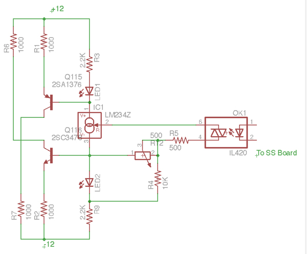

As I noted above, the original current source was powered from the +/- 85 volt rails. I may try to work out a scheme for doing that, but my current approach is actually to run the current sources off the +/-14 volt regulators used for the input stage active load (cascode) bias and the servo. I may decide this is not a good idea, but for now I think it is a better approach.
Here is the circuit.
Other than some value differences, the output stages of the current sources are the same. The loads R6 and R7 represent the diff pair loads, and are not part of the circuit as it would be implemented in the amp.
The key difference in the rest of the circuit is that I have derived the base voltages (and thus the emitter voltages) for Q115 and Q116 from a single source.
I am using an LM 234 constant current source. This device generates a constant current which is set by the resistance between pins 2 and 3 (R5 and R12 in the diagram). R4 is there to provide thermal compensation (as recommended by the maker).
This setup means that the current through the entire chain R3, LED 1, LED2 and R9 is the same. So, to the degree that the resistor pairs R9 and R3, and R2 and R2, and LEDs are matched, the voltage drop across R1 will be the same as the drop across R2, and the currents created by Q115 and Q116 will be the same.
When the resistance between pins 2 and 3 on the LM234 device is large, the current flow drops to about 2 micro amps. You can see that I have used another opto-coupler as a solid state relay in that part of the circuit. This replaces the control function provided by Q119 in the original circuit. So when the soft start board is inactive, the opto-coupler resistance is effectively infinite, and LM234 is off. This shuts down the current sources formed by Q115 and Q116, thereby turning off the input stage of the amplifier. When the Soft Start board is activated, the opto-coupler resistance drops to about 22 ohms, which is much smaller than the 1K resistance that sets the current, and the current source starts working, thus activating Q115 and Q116.
With these values, the currents through Q115 and Q116 can be adjusted between about 1 mA and 6 mA.
Using regular 5% resistors, the voltage drops across the load resistors (R6 and R7) in the two legs are the same for all set point values (1 to 6 mA) within a few millivolts (which corresponds to a current match in the micro-amp range).
Interestingly, the currents do not change at all as the DC supply voltages change (within reason, of course).
What I have seen in these amplifiers is that the basic operating point gets set by the nominal (zero signal) bias point formed by the currents in the diff pairs (i.e the currents provided by this current source). To the extent that this is incorrect, the amplifier will either clip at too low a signal level (because the drivers are biased on too far), or it will simply not produce any voltage gain in the drivers (because they are biased off). IN the extreme case, where both sides are biased on too high, the output starts to operate in Class A, and the current levels are super high, the transformer buzzes, heat pours off the heatsinks, and the lights in my garage dim...
To the extent that these currents are not the same, these effects will show up unequally in the positive and negative sides of the amp. So, for example if one side is biased on more than the other, that side will clip first at high signal levels. What is not quite as apparent though is that in that situation (with no server connected) the output DC level will be offset in the direction corresponding to the driver that is biased on more heavily.
In a nutshell then, the overall signal gain (and thus output power) of the amplifier is set by the overall bias point of the diff pairs, and the DC offset (without the servo) is set by the DIFFERENCE between these current sources.
I have not shown it in the diagram above, but I also plan to include trimmers on R1 and R2, so I can fine tune this balance. This will compensate for any component value mismatches. I am assuming that thermal variations will be the same for all of the components (within reasonable levels anyway), so once any fixed errors are tuned out, the circuit should provide a solid bias point for the input stages. I'll still use the servo, but I am assuming it will be barely doing any work, and real is only there to balance out any drift that creates imbalances in the system.

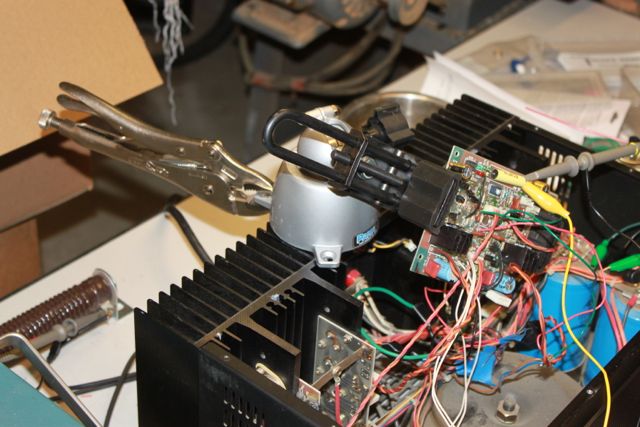

In this post I am going to explain a bit about my process with these amps, so hopefully it will assist others.
The first thing I do is clip the cable ties on the wire going to the board (carefully! so as to not clip any wires).
I then undo the screws on the back panel that hold the board. This allows me to get the board loose, and flip it over.
I carefully slide the thermal switches (the ones with the white wires) out of the heatsinks and save the little copper clips in the same tupperware bowl as the screws for the top.
I then use a solder wick (I have used a LOT of this stuff in these repairs), and release the big ground and signal wires marked 18, 19 and 20. This really loosens up the board (those wires are short and heavy). I then undo the feedback line (#7), and then small wires marked 8,9,12, and 13. I put tape labels on these so I can put them back properly later I then unsolder the pins for the wire-wrapped wires 5/11, 6/10, and 3/4. I keep the wires wrapped, so I don't have to deal with re-wrapping them later. This allows me to remove the board entirely. I then remove the mounting rails, storing them and the screws in the same tupperware bowl.
Every one of the amps I have gotten had bad caps, so I clamp the board in a Panavise, and wick off the solder for those three caps, remove them and throw them away.
On this amp, only the middle one (C109) had started to leak badly. the others were looking "moist". but there was no puddle of goo on the board when I removed them.
On my #2 amp, the electrolyte had corroded the solder all around both of the side caps (C118 and C119) to the point where I think most of the lead was gone. Just getting the solder to flow was nearly impossible, so on that one I wicked all of the corroded joints, removed each part one by one, cleared them, and cleaned the hole in the board and then desoldered them. Not hard work, and not challenging intellectually, just tedious.
All but one of my amps was virgin, in that nobody had done any work on the board, and the board was covered in dust.
I use a combination of CRC Air Intake and throttle body cleaner, and CRC QD Electronic cleaner. Both of these are available at any auto parts store. The throttle body cleaner makes very quick work of the electrolyte. I spray the board, and use a plastic brush to scrub the board, both sides. I rinse it often using the spray with the little tube nozzle. I also use a throw away "chip brush" (a cheap paintbrush), to get the dust off between the parts. Usually about 15 minutes of cleaning yields a nice crisp and clean board. I have not tried Simple Green, nor have I seen any need for an ultrasonic cleaner. I usually use a heat gun to quickly dry out the board after I rinse it. The chemicals include lots of nasty hydrocarbons: acetone, naphtha hexane, xylene, etc. so ventilation is important. The board is also very cold when this stuff evaporates, and then water condenses on it, so the heat gun is very helpful.
I then attach wires to the power inputs 5/11 and 6/10, and connect two 680 ohm resistors to pins 3 and 4. one to each pin with the free ends twisted together to simulate the input resistance of the output board.
On #4 I then attached a power supply to the power wires,,and ran the voltage up to above +/-14 volts. This allows me to check the zener diodes (D116/117/118/and 119). On my #4 amp, running the power supply voltage above 14 volts I found that the supply voltages from the zeners didn't peak out at 14 volts, but just kept going up as I turned the supply up.
I removed the zeners and checked them by connecting them to the supply with a resistor. When they are reverse biased the voltage across the diode should rise as you run the supply voltage up, but once it gets past 6.9 volts the voltage should stop rising. If it is zero, the the diode is shorted. If it keeps rising, then the diode is open. If they are inoperative, I replace them with LM329s.
On my #4 amp, I found that the diodes were all good, so I put them back in. This still begs the question about why I was seeing the supply voltage rise past 14 volts. It turns out that Adcom uses two different "grounds" on this board. There is the actual ground, and then there is the input section ground. These are connected together through two 10 ohm resistors. You can see these in the circuit diagram. One is R157, which provides the ground path for current in the two diode sets. This goes to the input ground labeled "3" on the diagram. Ground 3 is connected to the amplifier ground through R121. I have found R121 open on three of the four amplifiers I have restored.
If either rod these resistors are open, then the zeners have no ground path, so they act as if they are open. Once I replaced this, the supply voltages went right back to +/- 14 volts...
I then hooked up the actual supply voltage lines to the wires I had attached to the board, and fired up the amp. The voltages on the zeners were correct, but for some reason I was seeing some storage voltages on the diff pair tail resistors. It turned out I had forgotten to re-install the plug on J106, and without that the current sources don't come on. Once I remedied that the voltages at R108/R112 were about -1.1 volts, and the voltages at R109/R113 were about +1.1 volts. If these voltages are in this range, then the current source is working, and the input stage is probably working.
I then applied a signal to the input. It is important to point out that with the output stage disconnected there is no feedback, so the gain of the amplifier is very high. I made a little 10:1 voltage divider so I can run the input signal way down, otherwise all hell breaks loose in the amp since it is operating open loop, and the signals at the output become very large, even with very small input signal levels. Once I hooked this up, I then looked at the signal on the two resistors I had soldered to points 3 and 4. That was good. A nice clean sine wave balanced around zero volts.
I then removed the two resistors form points 3 & 4 and hooked up the output stages. I have a 350 watt 8 ohm resistor that I connect the output to. I then connected one scope lead to the input, and one to the resistor, and turn on the amp with the signal level all the way down.
If you hear a loud buzz, then this means the amp is running in class A and it passing a lot of current from one stage to the other (and not rhtpugh the load resistor. This implies a serious bias problem that requires deeper sleuthing. If the amp doesn't make weird noises or smoke, then turn up the signal level.
On my #4 amp it came up perfectly. So, basically the only thing wrong with it was a single 10 ohm resistor was open. Nice amp for 2 hours of work and $150 on eBay! Here is the culprit...
With the big load resistor, you can run the input signal up until you see the output start to clip (the top and bottom flatten out). That clipping point should be about +/-75 volts or so, which corresponds to about 350 watts RMS.
When I am working on the board in the amp, I use the special vise setup shown below. The vise holds the board steady while I probe it, and if I am soldering it. The vise grips hanging off the back form a counterweight so the vise doesn't tip forward.

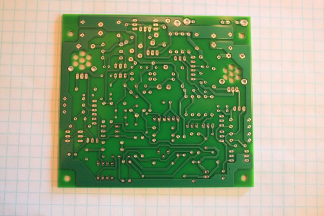

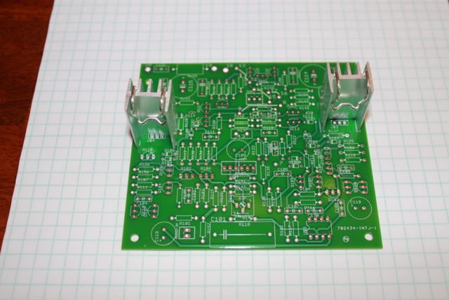

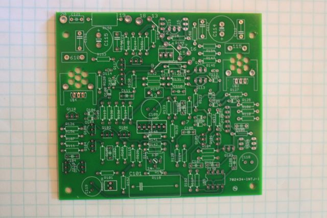

I received the new control boards today.
This is a new layout based mostly on the original, except it is a two sided board that has no jumpers, and the heat sinks are different.
I'll populate this board this weekend and report back on how it works.
The board with the heat sinks in place. These are taller and somewhat more compact than the originals.
The top side of the board.
The bottom of the board. I used the same basic large traces for the two grounds and +V and -V.

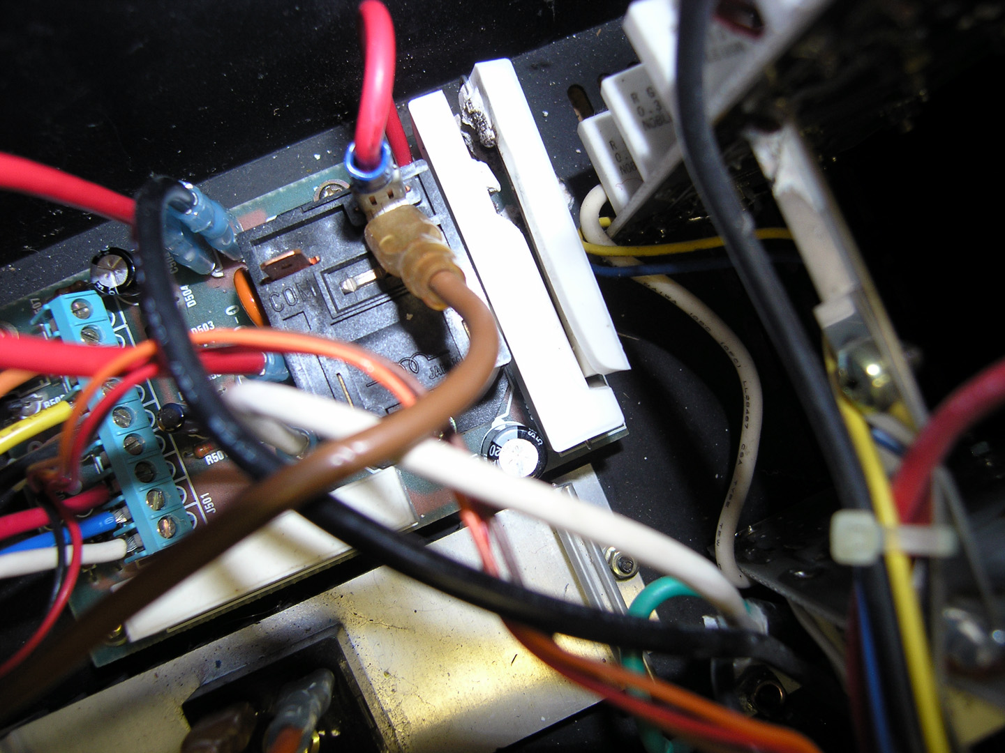

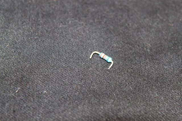

Had quite a setback last night upon power-up of my "amp #1" While diagnosing a no turn-on condition I had found resistor R506 open on the AC input board and replaced it with a Vishay Dale #CP00204R700JE14 along with the electrolytic capacitors on that board. I had previously done the audio input board wash and recap routine but removed the board again and checked every resistor and ended up replacing a few including all the fusible resistors as one or two were open if I remember correctly. Feeling quite good about my diligent efforts, I powered-up the amp and after a few seconds my replacement R506 popped in spectacular fashion! (see pictures) Quite an attention getter!! Obviously there is an issue yet undiscovered since the original R506 failed and now this one. Thoughts or ideas? :bawling:
