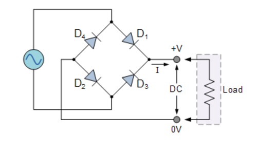

Here is the basic bridge circuit.
The terminal at the angled corner is the +V terminal. the terminal opposite this one is the -V terminal. From the schematic above, you can see that the diodes should conduct as follows:
1. With the positive DVM lead connected to one of the AC inputs you should see conductivity wight he ground lead of the DVM connected to +V. If you reverse the leads there should be no conductivity.
2. With the positive DVM lead connected to the OTHER AC input you should also see conductivity with the ground lead of the DVM connected to +V, and reversing the leads should show open.
3. Re peat this test with the red wire of the DVM connected to the _v terminal and the back wire connected to the AC terminals (on and then the other). Reverse the leads and repeat.
If the bridge shows conductivity in one direction but not the other on each of these tests, it should be OK. If it shows conductivity in both directions it is shorted. You can probably confirm this by testing continuity across the AC terminals.

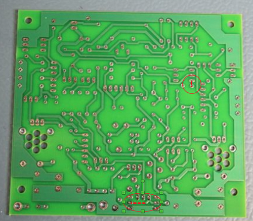

Well, I finally got around to stuffing my new control board, and trying it out.
It had a number of smallish issues..
First, when I was editing the layout to fatten up some of the traces, I inadvertently left two different sets of pads disconnected. The Eagle software I used for the PCB layout shows connections that have no traces as light yellow "air wires", and these just happened to be obscured by other lines on the layout. Once I found these I was able to easily jumper across them.
I managed to install the little KB262 diodes backwards. I should have checked them. They are black on one need and colored on the other..dumb mistake, but easily fixed.
The worst issue was that I had grabbed a T092 package layout from a library in Eagle.. and made versions of the various transistors for the schematic and layout (in Eagle each part has a schematic diagram AND a physical layout..When you do the physical layout, you must connect the pads on the layout to the terminals on the schematic so Eagle will know the logical relationship between the schematic version of the part and the physical version). Of course, while most packages in Eagle have the pins labeled left to right, the one I chose happened to number them right to left..This means that every single T092 device was installed 180 degrees out.. In general this wasn't a disaster because what it meant was that, for every device other than the Darlingtons, the base and emitter pins were swapped. Since the Darlingtons are embedded in the chain, and all the transistors were "off" (because they base emitter junctions were all reverse biased, The Darlingtons were also OK.
This silly error required carefully unsoldering every T092 device and rotating it 180 degrees..
Once that was done (and the diode stacks were fixed), she fired right up. Stable, with zero DC offset. I then hooked up the output stages and took her for a spin. Here are the pics..

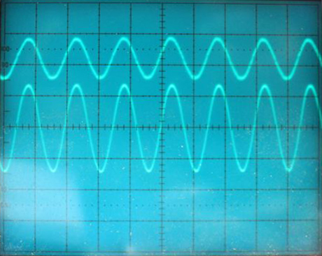

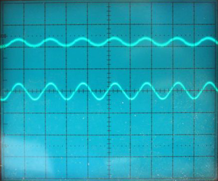

Top Trace: Input at 1 volt/div. Bottom trace (centered on zero volts): 50 volt/div.
Same setup but t full power into 8 ohms

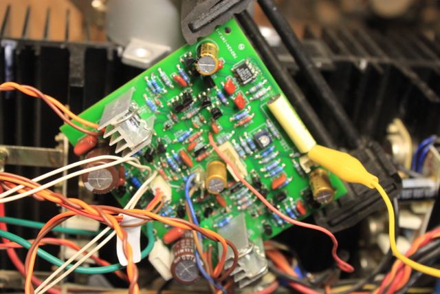

The new board in situ...
And the two trace errors:
I'll correct the board and build up another one sometime in the next few weeks.

Forgot to mention a couple of other issues with the board...
The three three-pin connectors on the board are, inexplicably, numbered 132, instead of 123..So, you need to pull the contacts out of the three connectors and swap pins 2 and 3.. Also, the layout I used puts the J105 and J106 connectors too close together, so you have to shave off about 25 mils from each connector housing so they
will fit.
My new version fixes these issues.
will fit.

One test you should perform is a lower level frequency sweep. What you want to see is a constant output with frequency, then a roll-off to very low output. What you are watching out for is a rise in output level. You may eve provoke some oscillation. If your amplifier looks stable - then you're in the clear for that. Remove the input filter for this test.
-Chris
Very nice work. I think you made a better PCB than the original was - by far! If I had an Adcom on my bench I would be asking you for some.
-Chris

Seems very strange to see that high a voyage cross the big +V cap. That should only be 85 volts. And, your numbers on Chris's test indicate shorts on both sides of the supply.. unless the orange side short is creating some weird flaw isn the red side measurement.
I'd carefully check the wiring to be sure someone hasn't crossed up something. You might want top also check the wiring to the soft start board to be sure that isn't crossed up as well.
Red from the rectifier (angled corner) to the +cap. Black from the transformer to the ground strap between the caps. Orange from the other corner of the rectifier to the -cap. All other non-black wires to the caps disconnected.. These should be a pair of red wires screwed to the top of the rear cap, and a pair of orange wires screwed to the top of the front cap. There should be some set of back wires attached to the cap screws...but no other colored wires.
If the caps are OK, this should power on. If not, then double check the little PC boards on top of the caps, and check all the wiring to be sure there is not some sort of a short.
In doing this you are adding in new sections of the amp one step at a time. Start with just the transformer, the rectifier, and the caps. With no load, this should draw almost no current, and you should see +85 volts at the +cap and -85 volts at the -cap. If that works, then pull the two fuses from the back of the amp, and hook up the red and orange wires to the caps.
With the fuses out, the output stages and the current sources are shut down, and only the control board (minus the current sources) is powered.
If that works, then disconnect the red and orange wires where they skew to the metal straps on the output boards (tape the terminals on the wires so they don't touch anything!!) put the fuses in, and try it. If that works, then the control board has no shorts, and it is the output stages.

Well, I guess I spoke too soon on Amp #4. I put it al back together yesterday, and when I fired it up it was oscillating. It is a fairly low level oscillation at 3MHz.
I had noticed before that at about 3/4 power and up you could hear the power transistors "singing". I have heard this with my other amps, but this one was really loud.
Once it started the oscillation, it was still able to put out significant power, but the "sining" was gone.. I am suspecting one of the power transistors has failed in some odd mode that results in the oscillation. It is worst on the positive side of the waveform.

Chris;
This is exactly what I am seeing. Bursts of oscillation on the positive peak of the waveform.
