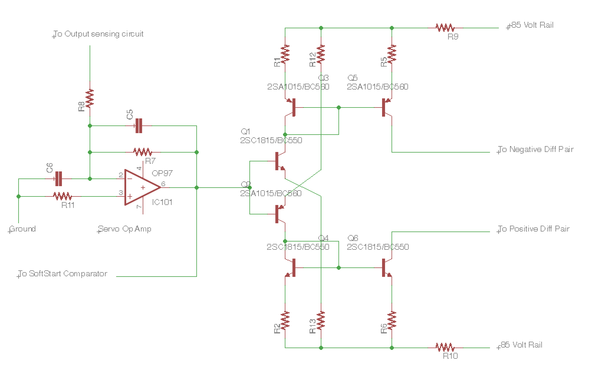

Yeah, I think Anatech is right here. If you null out the offset by adjusting the current sources, the output of the amp will still have some offset, and that will drift around a little, but if it's less than 10 or 20mV, no worries at all. Ditch the servo entirely!
Yep. However, I think the best long term solution is to adjust the current sources for optimal offset, and then use the servo to steer them to get the offset to zero over time and temperature. Ideally it will be doing almost nothing almost all of the time.
If your LPT transistors are going out of balance, the distortion will also be rising. A servo hides this, so is undesirable. Besides, this process takes a very, very long time and often things will actually remain in balance.
Call this normal maintenance. You always want the best performance from your equipment within reason. Normally the LPT will remain in balance for 20 years or more. So, why does it need a servo to begin with?
I guess one way to find out would be to remove the servo (or just short its two inputs together), and adjust R144 and R145 for zero output offset. Then let the amp run for a while to see.
My skepticism though is based on the fact that the imbalance is a result of the two pairs of diff pairs that have fundamentally different physical behaviors. Do PNP diff pairs change their beta more or less rapidly than NPN pairs over time and/or temp? And, being Darlingtons, any variation in the junction Betas over time and temp will essentially be squared. So, suppose the beta of the NPN Darlington is 10K, and the PNP Darlington is 8K, That means that the beta of each NPN junction is 100, and the beta of each PNP junction is about 90. If the PNP beta changes by 10% over temp, an d the NPN beta changes by 5%, the resulting betas will be: NPN: 9025, PNP: 6561. So, what started as a 20% difference changes to a 37% difference. The question is, is this what actually happens. It's an easy test, so I guess we will soon know!
If this does happen, then the servo would track these variations out. That said, if the component variations ARE small, then once the basic balance is established, then these drifts may be very much second order.

OK, so I spent a bit more time thinking about the differential current mirror, and also discovered a bunch of errors in the earlier diagram.
I was intrigued by the concept of a virtual ground that would then be offset by the servo output (I mean it is sooooo 565, right?).
So, I ditched the circuit that had the resistors in the output collector, and decided to use the servo to manipulate the control transistors for the mirrors. For a while I had a true virtual ground between the two mirrors, but then I realized that if I changed that ground, the op amp would have to sink or source the change in current, and to the extent it could not do that, the positive and negative mirrors would not change in opposite directions. So I had to get rid of (or provide) the excess current independently for each leg. That's where the idea for the criss-crossed emitter legs of Q1 and Q2 came from. By referencing these to the opposing supply rail (instead of ground or virtual ground), the current in each mirror can be controlled independently. To get them to track in a complimentary way, the virtual ground is actually in the base circuits, which are connected to the servo op amp. When the op amp output is zero (virtual ground, the bias in the Q1-Q3 leg will set the nominal current for the negative diff pair, and the current in the Q2/Q4 leg will do so for the positive diff pair.
If the offset is not zero, the bases of Q1 and Q2 will be offset positive or negative, causing one to pass more current and the other to pass less. That change will be mirrored in the current in Q5 and Q6, thereby adjusting one diff pair up and the other down in a complimentary way. I plan to breadboard this next week.
What I don't like about op amps determining DC offset in amplifiers without speaker disconnect methods is that power up and down instabilities can cause havoc. Call it experience in seeing what can go wrong after you have a few years on something if you want.
Most transistor LPTs don't do funny things as they come up or down, but they can cause thumps for sure. Anyway, there are so many examples of great power amplifiers that did not use a DC servo that there shouldn't be any question as to whether the servo is even necessary. DC servos shouldn't be required.
Well, we will find out. I built up the latest board without the trimmers, but I think I'll put them in and disconnect the servo.
I may STILL keep the op amp, and use it to drive an automatic shut-down circuit for speaker protection in case of a fault, but not hook it up for feedback.
