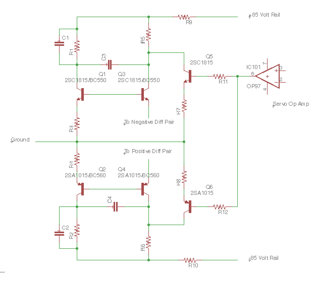

OK, so I did a little research. Looks like we can make a voltage controllable current mirror and control that with the servo output. Obviously this will need to be more thoroughly analyzed to get the component values, but it seems like it should work.
Conceptually, this is a pair of current mirrors, one for the negative side diff pair, and the other for the positive side diff pair. This part is not substantively different from the original circuit, except the current mirror "should" be a little moire stable over temperature than the LED stabilized circuit in the original.
The negative pair current mirror is formed by Q1 and Q3. Q1 fixes the base current in Q3 based on the resistances R1 and R3. These will drift together thereby making the current in Q3 stable over temperature. (this is a typical current mirror circuit).
The servo op amp drives a small voltage across the base of Q5, and this causes some current to flow through Q5. This added current causes a drop across R5 that changes the base current of Q3 slightly. As the voltage goes up, the current in Q5 goes down.
The positive pair side works the same, only with the opposite polarity.
Using this approach, the currents in the two diff pairs will change in the same way but in opposite directions as the servo voltage rises and falls.
I would probably use high quality trimmer pots so R1 and R2 and put a jumper between the output of the Op Amp and the RR11/R12 resistors. The way the offset inherent in the circuit because of the mismatch between the NPN darlington betas and the PNP darlington betas can be adjusts out without tearing up the circuit, and then the servo is there to make up for minor temp and aging changes over the life of the amp.
I thin I may STILL also use the servo output to shut down the amplifier power if the servo output goes too high in one direction or the other.

I don't think you want to do much with a servo, and that is why I think the original design is so bad.
The LPT should be balanced without external help. If you end up with less than 50 mV DC offset, all is good. Most with matched transistors will sit at less than 10 mV. I honestly do not see the need for a DC servo when offsets are that low.

I agree, the idea is to get the circuit to balance without the servo, and then use the servo to keep it balanced as things age.
BTW, I am not suggesting anything for the 545 (other than using a pot for R620 to adjust the offset. I agree that that circuit is inherently offset, and it is hugely dependent on the bias points throughout the circuit. It looks almost like a classic push-pull output stage that is driven by a single ended class-A amplifier. In the olden days we would AC couple most of the class A gain stages, split that signal into two paths, invert one and then AC couple them to the Class B output stages. So no inherent offset because the output stages were basically biased at zero quiescent current. In the 545 it seem like someone was trying to avoid any AC coupling, and so they worked out all the bias points to make that work. The problem is that ANY error anywhere in the circuit can then upset the whole thing, and errors accumulate as you go from the input to the output stage.
The discussion above, about the servo and the current sources is for the 565, which, being double ended seems to have a much more stable bias setup, unless something causes a DC offset up at the front end. Seems to me the biggest thing that causes that (other than something failing, like a leaking cap) is that the PNP and NPN Darlingtons have different betas, so even if the pairs are matched, the collector bias points will be different.
I have had good results adjusting this offset by tweaking R144 and R145, which adjusts the bias current in the two Darlington pairs.

Personally, I strongly believe there is no use for a DC servo if the LPT is matched to begin with. The servo only existed to allow random transistors to be used in manufacture while eliminating an adjustment point. That's all. It was a 100% cost control step.
I watched designs change while doing these products under warranty. There was a strong movement to eliminate the input from technicians to help control warranty program costs. We would list correcting bias and DC offsets in any amplifier we looked at simply because it was the responsible thing to do. Bean counters interpreted that as an added cost when it really wasn't. The reason for the service encounter was sometimes misadjustment, but most often an external issue or baseless complaint. We just avoided future trouble by making certain equipment was properly adjusted. They did the same thing for CD players. Although a fine adjustment often improved a CD player's performance considerably. Often bias currents were way out causing distortion or excessive heat in amplifiers. Offsets could cause a "pop" in preamps and amplifiers.

Yeah, I think Anatech is right here. If you null out the offset by adjusting the current sources, the output of the amp will still have some offset, and that will drift around a little, but if it's less than 10 or 20mV, no worries at all. Ditch the servo entirely!
That's an interesting historical perspective....
I definitely agree that if the input sections are balanced properly, offset should not be an issue. There are two concerns, however.
1) Things age, and that will cause the circuit to become unbalanced over time. And the servo can help compensate for that.
2) If there is a failure, the servo can't help, but some sort of servo driven power supply shutdown can prevent applying 85 volts to your speaker terminals.
ANd, I think you are right, the current source based servo approach seems to be less in-your-ears approach. It basically gets to the real cause of the problem instead of applying a band-aid over it.
