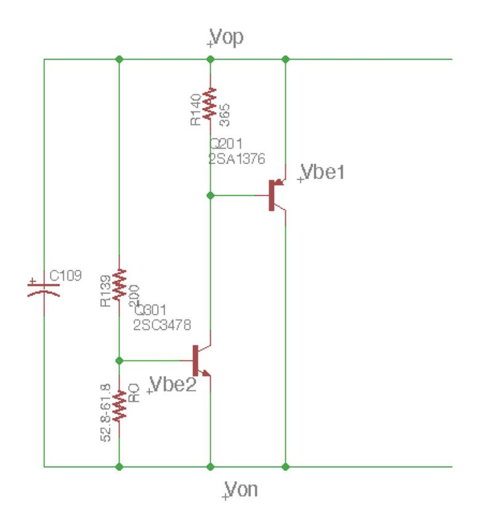

Yeah, I find that interesting. So they are using the Vbe change over temp to adjust the bias. What's odd here is that they only have a partial circuit for this. If you look at posts 381 and 382, I have the bias temp control for the 565. Here the Vbe of the transistors is used to drive the operating points down as the temp rises. Top is the positive bank input signal line, and Von is the negative bank input line. Q201 is on the positive bank heatsink, and Q301 is on the negative bank heatsink. The two transistor circuits are intertwined in an interesting way. Here is the schematic again, and I'll repeat the explanation with some added observations.
From this circuit, you can see that as the temperature of the junction of Q301 goes up, Vbe2 will go down, thereby increasing the current drawn through R139. The current through Ro will actually decrease, because the voltage across Ro (Vbe2) is lower, which means the base current of Q301 will increase. This will cause the collector current of Q301 yo increase, thereby increasing the current through Q201. This increased current will cause Vce of Q201 do decrease, which means Von and Vop will be pulled toward a virtual ground (i.e. each will be pulled toward the other). This lower offset will then reduce the current through the output Darlingtons, thereby lowering the temperature.
Similarly, if Vbe goes down (as the positive heatsink temp rises), the current through R140 will go own (because the drop across it is lower). However, the current the collector of Q301 is fixed by the other elements, and if they have not changed, this reduction in R140 current will increase the base current of Q201 and further pull the inputs lower.
As was noted by Phoodpants, in the 585 amp, they kept one of these transistors on the board, and only one was on a heatsink. I suspect they found that it didn't matter as long as ONE of them was on a heatsink, that temp will lower the bias in BOTH the positive and negative output banks. Thereby keeping them balanced and also reducing the overall current level.
This circuit is also supposedly used, however, to steer the bias between the positive and negative banks.
The resistor Ro in the diagram is actually a series combination of a fixed resisted and a pot, pretty much like VR601 and R643 in the 545 diagram. In this circuit, if Ro is decreased, then the current in the base of Q301 will decrease (because the current in Ro will increase). That decrease will reduce the collector current in Q301, which will cause base current in Q201 to decrease (because the Vbe of Q201 is fixed, and that means the portion of the Q301 collector current flowing through R140 must be fixed, and this means the reduction in Q201 current must be found by reducing the base current in Q201). This will cause Vop and Von to move away from one another (Vop becoming more positive and Von more negative). Moving the pot in the other direction will have the opposite effect.

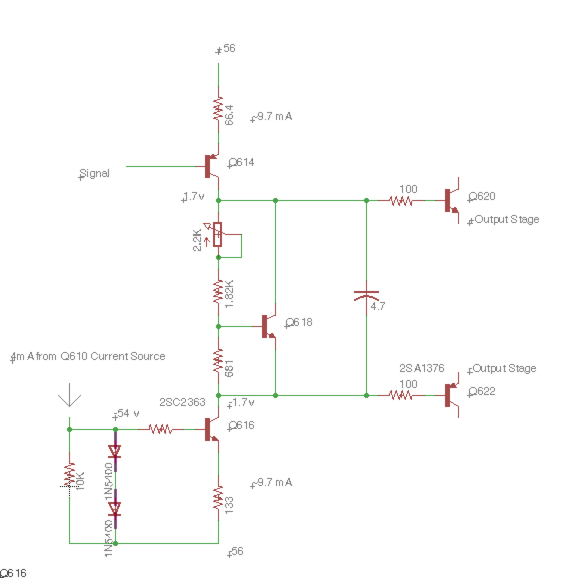

Some additional thoughts on the bias control in the 545. Having re-read my analysis of the 565 bias control, I realized that met assumption about negligible base current is incorrect. Here goes another try at that.
Based on the voltage drops across R636, and the series combination of R640 and R642, the current in the Q616 current source is about 6.7 mA.
The drop across R646 (681 ohms) is .7 volts, so the current through R646 is .7/681=1.02 mA. Since the current in VR601 and R644 is the sum of the base current in Q168 and the 1.02 mA flowing in R646, we can determine the nominal value of VR601 is about 827 Ohms. (odd that it is much bigger than 2x this. Might have just been what was available).
This means that in this nominal situation theQ618 transistor is passing about 5.7 mA.
If we decrease the resistance of VR601, then, in order to keep the 1.02 mA current flowing, the voltage at the collector of Q614 must increase. Since the current has not changed, the voltage on the current source is unchanged, so the voltage at the input of Q622 will not change. This means decreasing the resistance of VR601 will bias the positive side output bank more heavily.
If we increase the resistance of VR601, then the voltage at the collector of Q614 will need to go down to maintain the current flow through R646. So that will then cause the positive side output to be biased less heavily.
So far, we have assumed that the current in the base of Q618 is negligible. If we relax that constraint, I think what happens is that a reduction in the resistance of VR601 will slightly increase the base current of Q6128, thereby increasing the share of current that Q618 conducts. However, since the current source is fixed, it will respond by raising (less negative) the voltage at the collector of Q616. Thus, when VR601 is reduced, the positive output stage bias will increase, and the negative side will decrease. Similarly, if we increase VR601, the base current of Q618 will decrease, thereby reducing the collector current in Q618, and to maintain the proper constant current, the current source will reduce the voltage (more negative) at the collector of Q616. So decreasing the resistance of VR601 will bias the negative output side more heavily and reduce the bias on the positive side.
As the temperature of Q618 increases, its Vbe will decrease, reducing the current flow in R646, and thereby turning on Q618 more heavily. Since this transistor directly connects the two bias points, the reduced effective resistance between them will cause the current source to increase the voltage (less negative) at the output, and since VCE of Q616 will decrease, the current source will drag the positive side down. thus as Q618 heats up, the bias on both sides will go down.
This is really very compact and clever approach to simultaneous bias balance and thermal control. And the trick to it is the use fo the current source.

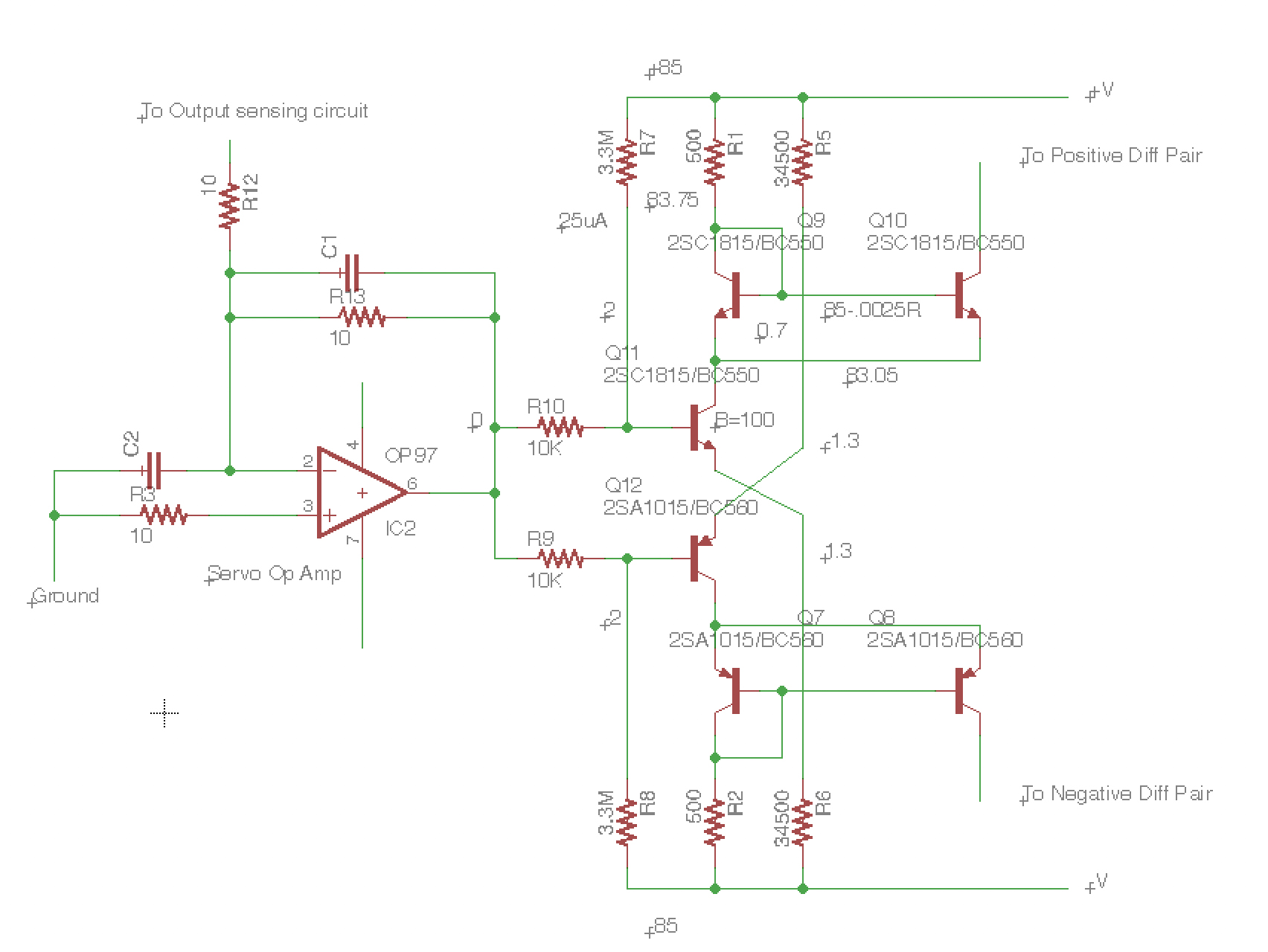

Traveling these past few days to escort my aged (93 YO) dad and his wife from Seattle, (where they live) to Petaluma, CA (where I live) to celebrate what may well be our last big family gathering with him. Fortunately he is lucid and thoughtful, if not a bit frail, and everyone is COVID vaccinated, and all but the kids are boosted... I consider myself very lucky to have had his company for such a long time. He is a good friend, and has taught me so many things over the past 66 years. And now I teach him things.
Anyway, since I have a bit of free time, I decided to fiddle around with the current mirror current source idea. In doing this, I took a long hard look at the original layout of the 565 control board. It seems as if this board was laid out thoughtfully when it came to the signal path, but then they placed the entire input circuit current source on the far side of the board, and put the amplifier output bias circuits right next to the input. A near surefire way to invoke positive feedback. You can appreciate this as in the original layout, the bias control pot (R143), which is smack dab in the middle of the output of the control board circuit, is physically right next to the big 4.7uF input cap. Meanwhile, all of the LEDs and current source components are way over near the power supply input, on the far side of the board from the input devices they serve.
So, after importing the new current mirror current source, where the servo adjusts the current balance between the diff pairs and doesn't impose an offset signal to the diff amp inputs, I decided to try a clean sheet layout. I am part way done with it, but I must say, it is very symmetrical, and embedding the current source in the middle of the board between the two input stages seems to make a lot more sense. instead of being in the middle of the board, the output is now over on the power supply input side (where all the current source components used to be. I'll have to breadboard the current mirror design to be sure it works properly before I run a set of these boards, but I have a feeling they maybe much more stable than the copy of the original layout.

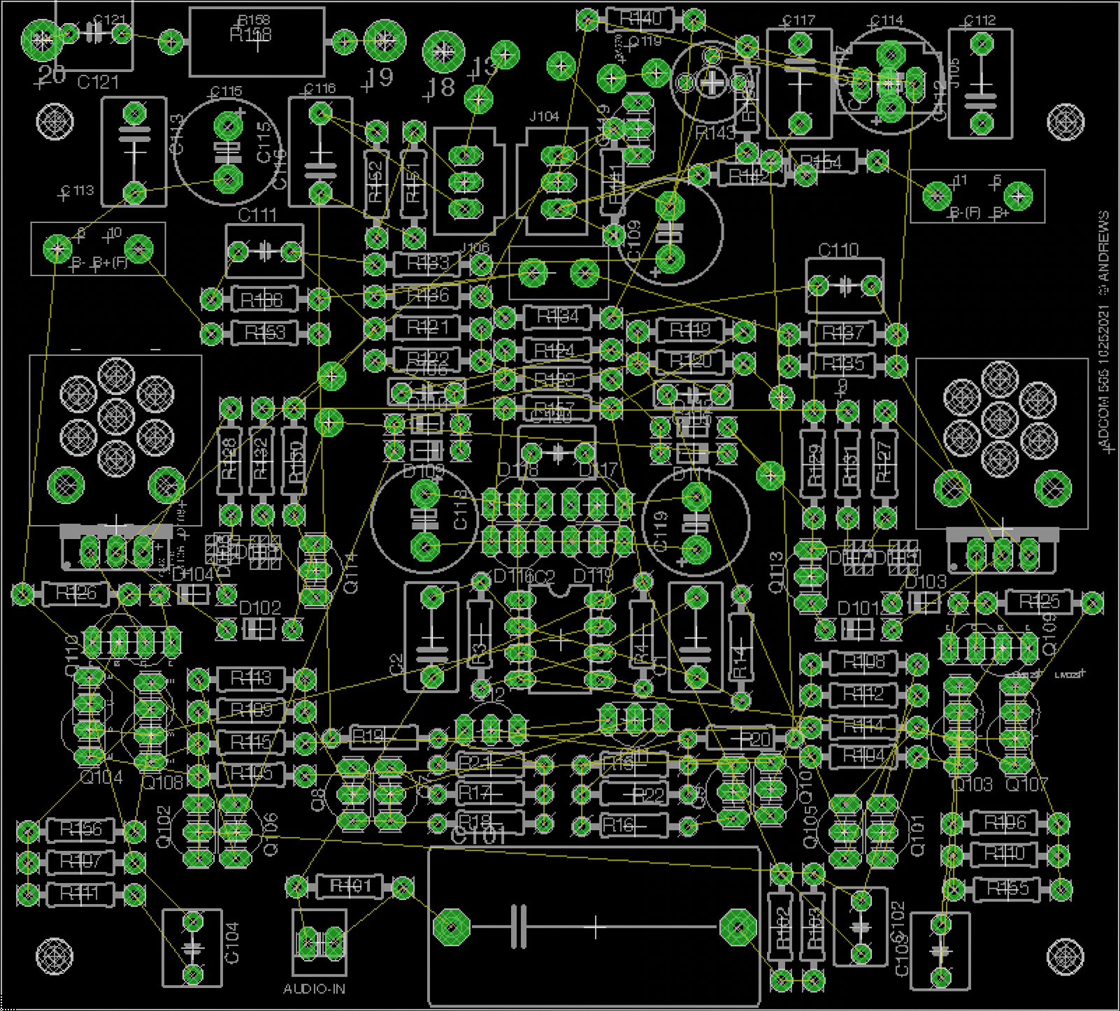

Here's peek at the still in-process board layout...
Since this is a clean sheet design, I'll probably move the Zobel network off-board, just to mark that much more room.

Did some additional thinking about the current mirror. Realized there were some errors in the circuit, and I needed to work out how to bias the control transistors and limit any crosstalk between the bias on each mirror. They will be controlled in sync, but I didn't want the control of one side too influence the control of the other. So It got a bit more complicated, but seems reasonably correct. I'll have to breadboard it to see.
Here is the revised circuit.

Does the voltage swing only occur with the speaker connected? Or does it swing to -6 volts and then go back to near zero? If you turn it on with no speaker connected, then does the output stay near zero when you turn it on? (that is does it not swing too -6 volts at all?). After it has settled down, does it randomly swing negative again, or is the issue just at start up?
The offsets you measured are a bit puzzling. if the collector of Q614 (positive side of the amp) is higher than the collector of Q616 (the negative side of the amp) then I would expect that the offset would be positive, not negative. Double check the polarity of your volt meter.
The offsets at the collectors of Q614 and Q616 should be the same and opposite polarity. If the output offset is only at startup, then I suspect you are seeing the offset from those mismatched collector voltages and then the servo time constant catches up to the output and corrects it (that is, the servo may have a slow time constant - since you do not want it to react to the audio signal, and it may take a few seconds to react.).
Also, does Q618, or the heat sink itself, heat up?
Try this:
- Remove the servo op amp.
- Start up the amp
- Measure the output offset, and the voltages at the collectors of Q614 and 616. Record these.
- If the collector voltages are not equal and opposite, then adjust VR602 (the trim pot).
- If rotating the pot does not make any difference, then test the pot. You can probably do this in-circuit. Rotating the pot should change the resistance between the wiper and the other end of the pot from zero in one direction, to about 2K ohms in the other direction (one side of the pot is connected to the wiper and the other is not, so be sure you are testing the right terminals. If the resistance is zero, then test the other end). If the pot does not change, or if it is open entirely, then it should be replaced.
- If the pot changes as expected (maximum resistance of about 2 K Ohms and a minimum resistance of about zero), then remove and test Q618.
Q618 is supposed to change the bias on both sides up and down with temperature. However, if it is open, then this would probably mess up the balance. More likely though is that the pot is open/shorted or does not change its resistance properly.
If changing the trim pot changes the collector voltages (Q614/616) then adjust the pot until the voltages are equal and opposite polarity.
The other thing you could try is to disconnect Q618 entirely. In this case you will have a resistance of
between 2500 ohms and 4700 ohms between the collectors of Q614 and Q616, and adjusting the trim pot should cause the voltages at the collectors to change in opposing directions.
***What I am looking for here is if the bias offset control is working correctly (or is working at all).

The two things I am suspicious of are these:
1) The bias adjusting resistor VR602 (trim pot) should allow you to control the bias voltages on Q6714 and Q616. If it doesn't then that needs to be remedied.
2) It sounds as if the output offset depends on a load (e.g. speaker) being connected to the output. If this is the case, then drawing current through the amp output is creating the offset, which means the output is not controlling the current through the load. That is probably a problem with Q620 or Q622.
As I noted above the voltage gain from Q620/Q622 through the rest of the amp is unity (no gain), so that section should not be amplifying any offset. Yet you are seeing 6 volts offset with a speaker attached, and the voltage offset at the input tot he unit gain stage (614/616) is only 0.7 volts. SO SOMETHING ELSE is causing that offset.
However, if one of Q622 or Q624 are faulty, that may only show up when current is being drawn through them. In addition, if one of those is faulty, then that fault could distort the bias control circuit, and the combination of low current gain on one side (e.g. the positive side) and some bias offset would cause the output to swing negative when the speaker was attached.
For example, if Q622 has an open collector-emitter junction, then the drive current for the output transistors will be about 100X lower on the positive side. You will still see unity gain but the positive side will be current starved. So when a load is applied any offset in the amplifier gain stage bias (Q614/616) will be amplified by the difference in current flow from the two sides of the output.
I started to respond to a PM from The Prof as a PM, but then realized that this may be helpful to others, so I am responding publicly, including, with his indulgence, a portion of The Prof's PM about his 545 amplifier woes.
This bias offset control (VR602) seems to be working correctly. It is supposed to adjust the offset between the positive and negative sides of the output circuit, and it appears to be doing just that.
Until you get the output working under load, the voltage across the emitter resistor test point is not going to tell you much.
The voltages at the collectors of Q614 and Q616 are a bit low, but that may be a result of whatever is causing the speaker induced offset. If you wanted to adjust that, you could use a pot at R636. This should change the bias on BOTH Q614 and Q616 equally. (the "control for setting the quiescent bias current" you mention above).
The more concerning thing is the speaker induced offset. Clearly that is not correct. Since you are able to get audio output with no load, and since you can adjust Q614/Q616 bias to get equal collector voltages, the issue is in the output stage.
With no load (i.e. speaker disconnected), the output transistors are not actually passing any significant current. As I noted in my last post the entire output section is an "emitter follower" circuit, and that has no VOLTAGE GAIN (or as we say, "unity" voltage gain - a voltage gain of one). So, whatever signal voltage is applied TO the output will be reflected as the voltage AT the output. Instead, the output stage has massive CURRENT GAIN. This is necessary to allow the amp to swing the voltage at the input of the output stage (the collectors of Q614 and Q616) across a low resistance load like an 8 Ohm speaker.
Consider this: If the voltage swing across the speaker load at full volume is, say 49 volts (which corresponds to 150 watts RMS at the output), then the output stage needs to supply 6 Amps of current to an 8 ohm load. Obviously Q614 and Q616 are unable to supply that current, so the output stage simply uses that voltage signal, and adds the ability to drive that voltage across the lower speaker load (i.e. supplying current gain but not voltage gain).
Now, here comes the tricky part. Since the voltage gain of the output is unity, it may be possible for either Q620 or Q624 to be inoperative, and STILL show the full voltage across the output WHEN THERE IS NO LOAD (speaker disconnected). this is because in that situation there is nearly no current flowing in the output stage. If the emitter-collector junction of Q620 is open, but the base-emitter junction is OK (or shorted), that transistor will pass the voltage at the base, to the emitter (which will be about the same as the signal on the collector of Q614). However, since the open emitter-collector junction means that that transistor cannot pass any current, the only current that will flow into the base of the output transistors (Q624-Q636) will be the BASE current of Q620.
The output stage is what is known as a "Darlington" circuit. A Darlington circuit has the emitter of one transistor connected to the base of the next transistor. A transistor is inherently a current gain device, and the current gain is known as "Beta". Beta is the ratio of collector-emitter current to base-emitter current. In a Darlington circuit, the base-emitter current (Ibe) of the first transistor causes a collector emitter current (Ice) of Ice=Beta(Ibe), so the emitter current is Ie=(Ice+Ibe)=Ibe(Beta+1), If Beta is large , say over 100, the +1 hardly matters, so we can write this as Ie=Ibe(Beta) - but remember this, because it is going to come back later.
Note that in the Darlington, the emitter current of Q620, flows directly into the base of Q624. Since the Q624 circuit is set up the same as the Q620 circuit, the emitter current of Q624 is Ie=(Ie'Beta')Beta (where Ie' and Beta' are the current and beta associated with Q620, from the above discussion. Looking at the next stage, the emitter of Q624 feeds into the bases of Q626, Q632, and Q636. These devices are connected in parallel, but the same analysis applies to each of them. The emitter current of Q624 splits into three branches, one for each device, and goes directly into the bases of each of these devices. This means that the emitter current of these devices (Q626, Q632, and Q636) is Ie=(Ie'Beta')Beta''Beta, where Ibe' is the base current of Q620, Beta' is the beta of Q620, Beta'' is the beta of Q624, and Beta is the beta of the output device Q626. Assuming that the Betas of these devices are all about the same, this means that the current gain of this triple Darlington is Beta^3, or Beta cubed!. If the Beta of each device is 100, then the beta of the triple Darlington is one million! So, a 6uA (micro amp) base current at Q620 will produce 6 Amps at the emitters of the output transistors (roughly speaking.. it is a bit more complicated given the three parallel output transistors, but you get the point).
However, let's examine what would happen if the collector emitter junction of either Q620, or Q624 were open, but the emitter base junctions were OK or were shorted. In this case the VOLTAGE at the base would get passed on to the emitter, but the current in the emitter leg would just be the base current. Remember the Beta+1 term we ignored above? Let's write out the actual current equation.
The base current of Q620 is Ibe', so the emitter current is Ibe'(Beta+1), and the overall emitter current at the output of the amplifier is Ie''=Ibe'(Beta+1)(Beta+1)(Beta+1). This is just the Beta cubed relation above, but with the base current terms included.
If either of the collector-emitter junctions of Q620 or Q624 are open, then this changes to
Ie''=Ibe'(Beta+1)(Beta+1)(1), because one of the transistors has no collector current and thus has no beta value.
If one side of the output has a current gain of (Beta+1)(Beta+1)(1), and the other has a current gain of Ibe'(Beta+1)(Beta+1)(Beta+1) then WHEN A LOAD IS APPLIED, one side will be driven with MUCH more (100x) current than the other. HOWEVER, WHEN NO LOAD IS APPLIED to the output, the difference is beta between the two sides will not matter (or at least won't matter very much).
So, I suspect that the collector-emitter junction of either Q620 or Q624 is open, and the base-emitter junctions are either shorted or are OK. When your speaker is disconnected, the current flow is very low, and the difference in current gain has little effect on the output. It probably has SOME effect, but that is adjusted out by the bias control pot (VR602). When the load (speaker) is connected, the current draw increases, and presumably the imbalance between the two sides causes the output to be drawn down by the properly operating negative bank of the output circuit.
Because of the circuit topology, determining which transistor is bad may be a little bit difficult. One thing you MIGHT try is looking at the voltages on both sides of R660 and R662. These should be equal and opposite under load (with the speaker/load attached). If the voltages on either side of of R660 are not the same, the I would suspect the culprit is Q620. If those are OK, but the voltages on either side of R662 are unbalanced, then the problem is Q624.
