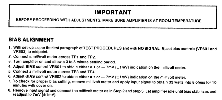

I am still confused about the bias setting pot. It is supposed to set the class AB operating point, and as such should not affect the output offset. But here Adcom advises setting the bias so that it produces about 7mV across the output device emitter resistor. (I have attached the excerpt from the service manual.) But when that control affects the symmetry of the voltages at the collectors of Q614 and Q616, what does one aim for as the best option--symmetry of the +/- voltages, or the recommended bias current indicated by the 7mV level ??

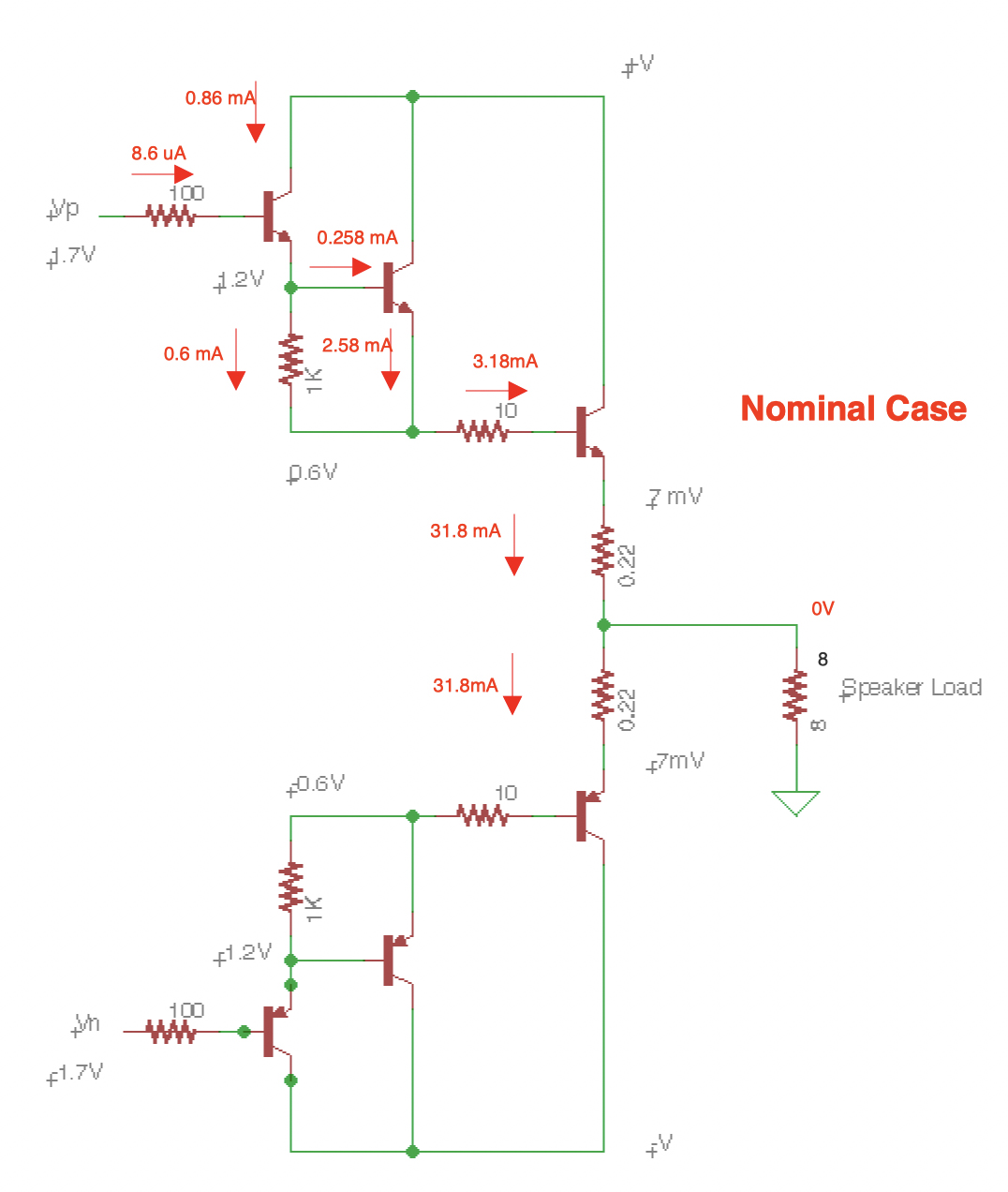

Here is a simplified diagram of the output circuit. with the nominal currents and voltages noted. I would be interested to see what you are measuring both with the load connected and without.
Specifically:
- With no load, and the circuit balanced, what are the voltages across the 0.22 ohm emitter resistors on both sides? This will tell us what the quiescent current is*.
- With no load, and the circuit balanced, what are the voltages at the collectors of Q614 and Q616?
This will tell us if you are compensating for some other offset source using VR602.
As noted in the diagram, the voltage drop on the emitter resistors should be about 7 mV, implying about 32 mA of current flow. If these are significantly different then this would probably be due to some imbalance in the overall currents flowing on either side.
I am not sure how the bias control is supposed to adjust the overall quiescent current. It clearly is designed to control the offset.
Specifically:

I am amused that the Adcom designer's labelling of the bias pot has flummoxed you also. Perhaps we shall explore that angle once the basic issues are solved. As I had stated at the outset, my wish is to disable the DC servo, set the offset manually and then enable the servo as a "belt and braces" ploy. Once the amp behaves well (the present settling time of 2-3 seconds points to the servo correcting the output offset...?), we could perhaps take up exploring the manual setting of the offset. Then we would also need to find a way to set the quiescent bias too. Kindly keep that at the back of your mind, sir.

It remains to be seen if we need to adjust the overall bias level by changing the current source resistor (R636). I suspect that basic bias level is OK, and the offset is what needs to be adjusted.

Soldered up with one pair of output devices for testing. Replaced VR602 with a 2k Bourns trimpot. Both rails at 49.5V (with protection in series to the primary of the transformer, no Rs in the DC rails).

The quiescent current measured across the output device emitter R is very low (just 1 mV or so) with one pair of output transistors, and with and without load connected, and with VR602 adjusted for symmetry of the +/- voltages.

The very low NPN betas were probably your problem. That would unbalance the output and cause it to go negative.
I am guessing that if you let the amp sit for a while with no load, those collector voltages will settle back to being symmetrical. There is no reason if they were set equal before the load was applied, that the balance would change permanently with no change in VR602. I think what you are seeing is that the servo has corrected some offset, and it has a very long time constant.
You might try removing the bulbs in the rails, since the amp is not smoking anything. It is possible that they are not matched, so when a load is applied, one rail falls more than the other, and the servo is compensating for that.
Also, just because it is probably now safe to do so, attach an 8 ohm load, and adjust VR602 for balance WITH the load applied. It is possible that there is some inherent imbalance in the circuit, and setting the balance with a load is different than without a load. Since it is designed to work WITH a load, and it seems to be behaving more or less properly, set it up with a real load and see what it does. I would not be surprised to see, if it was working into a load and was balanced using Vr602, that removing the servo had little effect.
I had clarified about my 'protection'--I use a series bulb rated at 240V/60Watts in series with the primary of the transformer...no Rs in the rails.You might try removing the bulbs in the rails, since the amp is not smoking anything. It is possible that they are not matched...

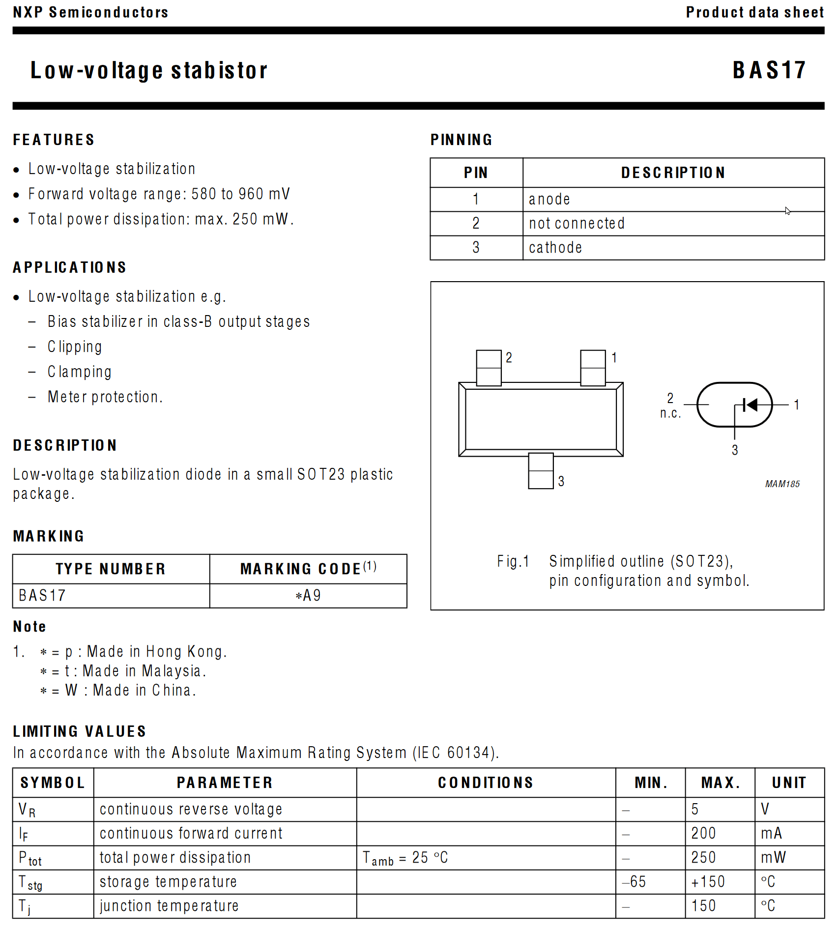

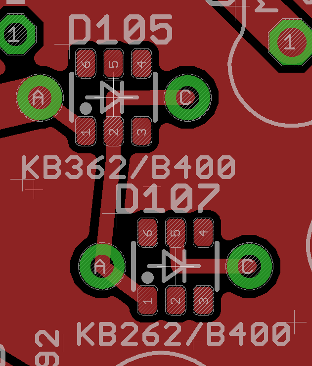

Parts shortages are stressing me out! And threatening my business. 🙁 I'm worried that the Central Semiconductor CMXSTB400 is about to go extinct. Mouser is the only supplier, with 371 in stock and none on order.

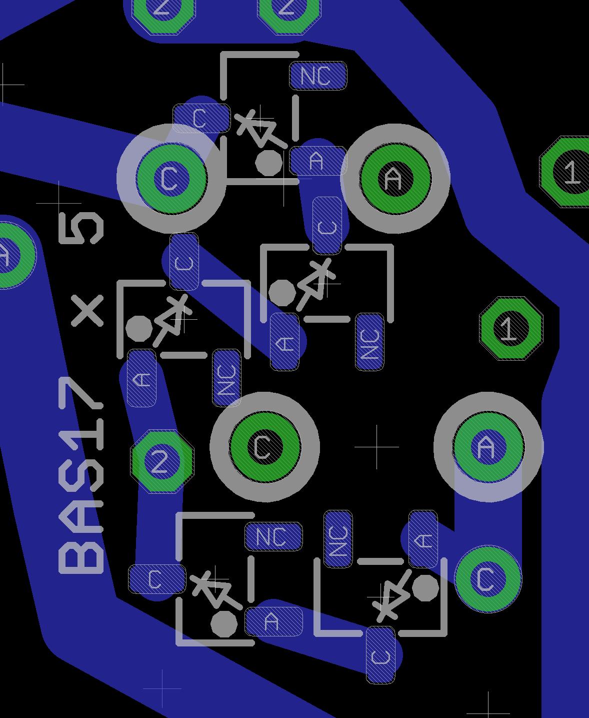

The only other stabistor that I'm aware of, is the Nexperia BAS17, a single stabistor diode in SOT23.
So I've added SOT23 footprints to the bottoms of my BFA-565 boards, so the boards can accept all three kinds; the original through-hole stabistors, the CMXSTB400 or the BAS17. It works out pretty well, and some people may find these SOT23 packages easier to solder than the SOT26.
Top-side accepts original through-hole stabistors, or SOT26 CMXSTB400.

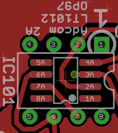

Also LT1012's and OP97's in DIP-8 are currently nowhere to be found, and I'm running out of stock.
So I've added dual DIP-8/SO08 footprints.

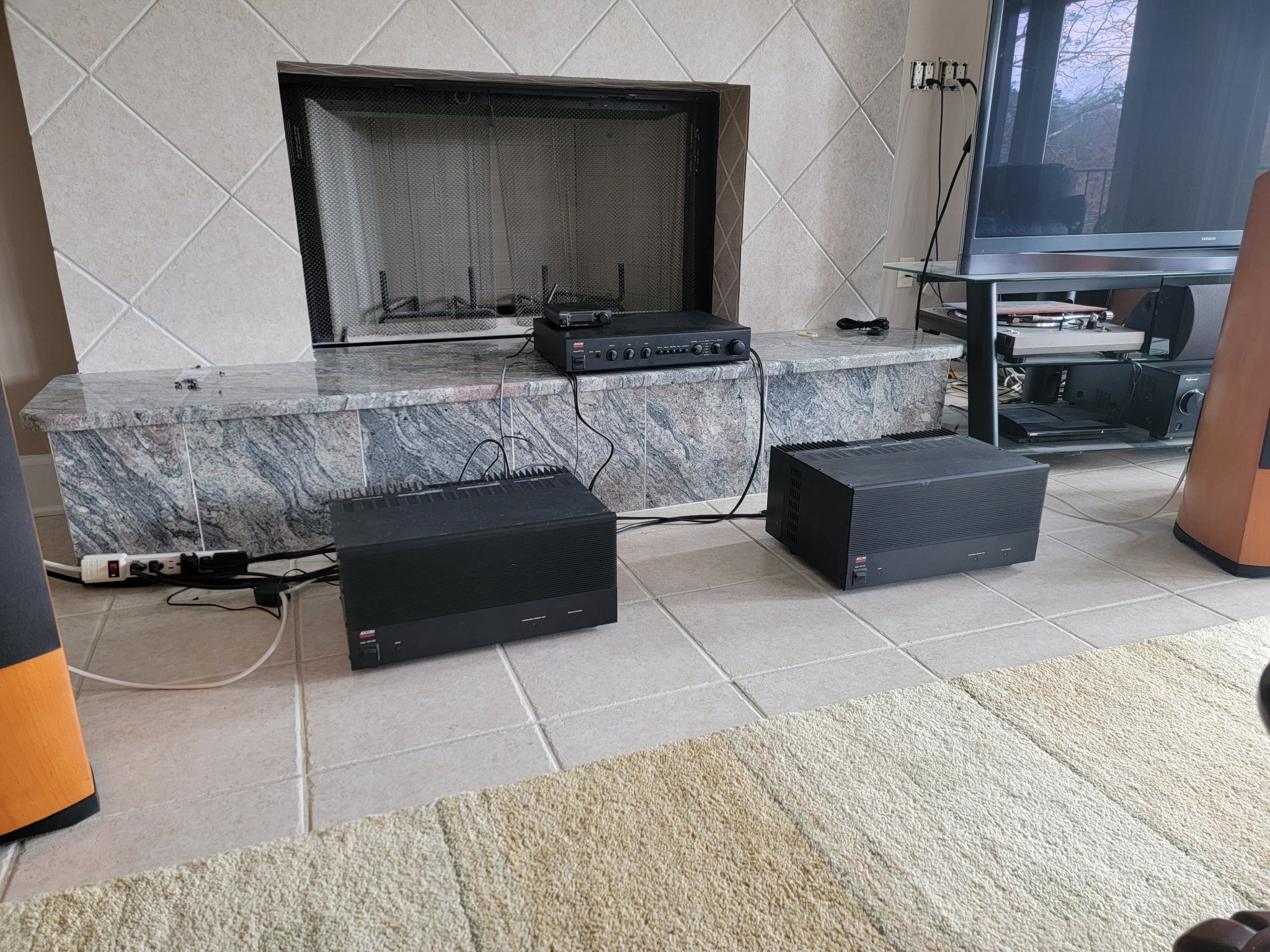

My Adcom 545 has been going strong all these weeks... one more "Thank you" to you and the others who helped with the detailed troubleshooting info.
