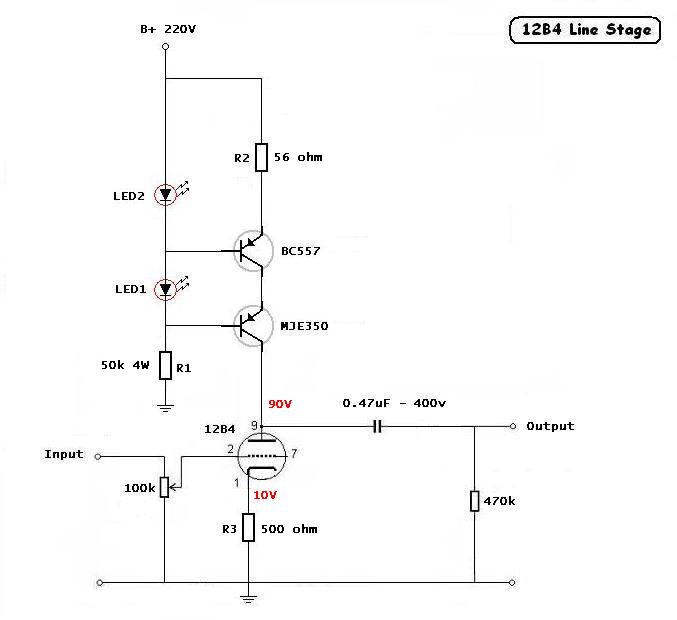

I now use a 56ohm emitter resistor, 50k on the LED string, no bypass on the cathode, no gridstopper and put the CCS's on seperate heatsinks. Hisss is much less, heat is only 32°C on the heatsinks. Previously the resistors on the end of the LED strings went directly to each other then to ground, now they go seperately to star ground. I cannot think of something else I would like to change, it is almost perfect - I say "almost" only because I do not know what perfect sounds like 😉
Thank you to all who contributed and helped designed this linestage, great job

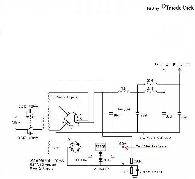

This is the PSU I am using, with compliments of Triode Dick :
No humm, very clean, very stable.

I am having a lot of problems with the 12b4 bias falling from +10 volts or even dropping to zero volts within about 2 to 24 hours after firing up the circuit.
My B+ is about anywhere from 250 to +300v depending on the PS I am using.
RL is anywhere from 5k to 7k, RK is 500 ohms.
I have never had so many tubes go bad with other tube pres I've built, so I wonder if anybody else out there has had problems with defective 12b4s. I've gone thru about 2 dozen of them so far, and I'm desperate to build a consistently working 12b4 preamp.
Any and all feedback is welcome.

About 15 years ago we already regarded a 12B4 or 6S4A as something that needed handpicking by careful testing and matching.
I.e. buy 20, use 2....
Those were originally TV tubes so you can expect specs that matter for audio use to vary wildly from source to source.
Nowadays I'd rather consider a tube such as a 6C19S for similar service and still run it through the same selection process.

notleon said:Hi,
I am having a lot of problems .........
use variant with CCS in cathode
Hi
Same problems with me.I've used may be 20 tubes and all giving the same problem.It seems that the operating point is affecting the situation.Haven't tryed other tubes but with a pair of Jan Sylvania is working good with Ra 7,5K, Rk 1,5K bypassed with 470uf cerafine and B+ 340V.This gives around 18ma and pretty linear load line.

So some respond by confirming that they have had problems getting good 12b4s (and caveat emptor), also one person says try using CCS in the cathode.
I'll keep plugging away at the 12b4, because I think it's hands down the best extractor of audio I have ever heard.
Another question: the 12b4 is a single triode, with pins 2 and 7 as grid connections. Does this mean I should connect BOTH 2 and 7, or can I get away with connecting the grid at 2 OR 7? I suddenly thought that if one grid pin is unconnected, that could be a source of problems(?). I've been connecting the grid only at pin 2 up thru now.

notleon said:......
connecting ALL grid pins is obligatory ;
also - either grid stopper resistors or ferite beads , ditto on base .
Right, I've got 200ohm grid resistors connected already. Thanks a lot for the tip to make ALL grid connections. Hope it works out. Maybe that was the problem all along.
