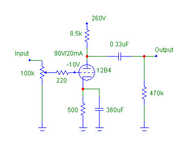

This is the basic 12B4 that I found. Hopefully I'm not stepping on anyones toes posting this here..... note that I used 220 UF for the cathode bypass caps. That is the only deviation from this drawing that I did.
Mark
Hi first of all thank you very much for this very nice thread.
At the cost to be banned i have to ask. I am attaching your schematic.
I understand that the plate load resistor (8.5k) should be not smaller than tube plate resistance (i.e. 1030 ohm from datasheet) ?
As i am looking for as low as possible Zout could be possible to decrease the 8.5k resistor and consequently the 260V supply ? should not this lower the Zout ?
like using a 2kohm vs. 8.5kohm resistor and 130V vs. 260V ? 😱
Thanks a lot again

@ginetto61
Good engineering practice makes the net load a triode works into at least 3X said triode's plate resistance (RP). Remember, the driven downstream load is in parallel with whatever device is between B+ and the tube's anode, insofar as AC is concerned.

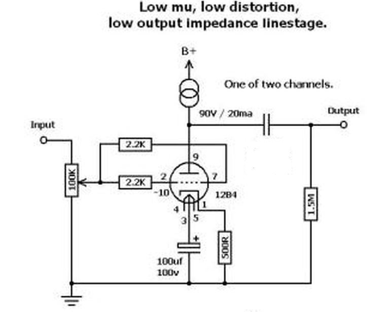

I'm providing the signal schematic of the 12B4 line stage variant I'm associated with. A 130 VDC B+ rail should work. How high the quality of the CCS used depends on how difficult the downstream load is. If the downstream load is not especially awkward, a 10M45S integrated circuit is adequate.

Properly functioning tube HIFI circuits don't significantly distort. A correctly setup cathode follower is very linear and transparent.
The IHF "standard" load is 10 Kohms. Most common cathode triode voltage amplifiers can't handle that. The 12B4 can, as its RP is quite small at (sic) 1030 Ω. 😀
What harmonic distortion linear triodes wired common cathode produce is primarily 2nd order and that's euphonic.
Use the common cathode 12B4 and "pad" the level control, if you get a "hair trigger" situation.
