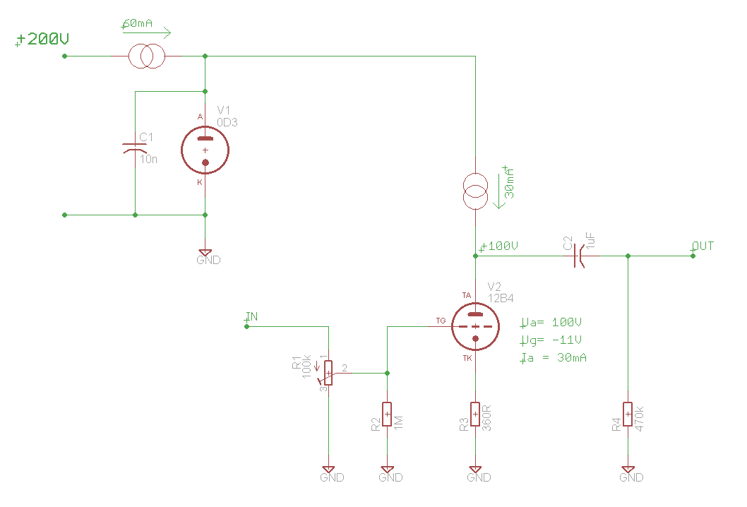

Here are my thoughts on 12B4 preamp. Does the picture look right?
You will have a hiss problem with this circuit. Go to my published design:
Amplifiers and select
"My Favorite Line Stage Amp" to see my recommended solution for this problem. You will note that the regulator is isolated through a small buffer resistor, and that final filtering for the 12B4 is done on the load side of the buffer.

2x60H is overkill. At that Rp (about 1k) one could go just fine with say 40H. No need to add excess capacitance (from the chokes) and limit your upper bandwidth. Same goes for the extra resistance(thus higher B+ required). With just one 60H choke u get F3 = 3Hz @ Rp = 1k.
For the record 40H choke gives F3=4Hz @ Rp = 1k.
Venci.
What you say is true, but if you are trying to feed a subwoofer that goes to 15Hz, you need an F(-3dB) at about 1 Hz. But your point is good--I'm going to make the second choke an option. I did have a few people complain about the low freq. end not being low enough with a 60H choke, (my guess is for movies) which is why the second one was added. With two chokes it is flat to 20Hz.

Some thoughts
One point to note on the 12B4 power. It really helps drive the baseline noise floor to zero if you use a separate power supply. DC heaters are also a good idie.
The plan is CRCLC with a 20H choke and lots of capacitance.

I think there is an error in the Vmax out on your report, such large difference between the + and - swing suggests relatively high distortion.
That scenario would require approx 25v input: not a very likely condition to be encountered in reality. At normal input levels around 2v the swing would be confined to an area of the plate curves where the +ve and -ve negative excursions would be far closer.
We must have missed school that day, the whole thread is about using the 12B4 as a line amp...😀
