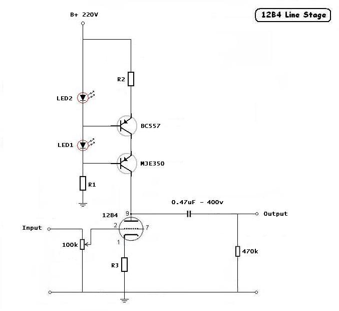

Can somebody please assist with some calculations for me?
I want to use the attached circuit, but only with 17mA anode current. How do I calculate all the R values?
I only got B+ of 220V.

An extensive explanation on the calculations of CCS's is given in a PDF available at the thread on the DIYaudio CCS's boards. Although you will not be using the boards (I imagine) the explanations are still useful and will help you to get to the 17mA!

R1 is simple and is dependent on the total hfe of your transistors. The calculations in the PDF for that one doesn't always work. A value to give 500uA for 17mA is reasonable to get the LED's going and let the transistors beta do the rest.
Have a variable in series with R2 because you'll need it. Getting a fixed value to work consistently amongst different transistors will be next to impossible. Been there 😉

O.K., let me try: (With ref. to my circuit above)
For R1: I=5mA
R1=220/0.005=44k P=220x0.005=1.1W
For R2: I=17mA
R2=1/0.017=58.8ohm P=1x0.017=0.017W
For R3:
A ha, the manual does not say what voltage I will get after the cathode, how do I do this one ?

For a 20mA plate current, what would be a good cathode resistor to use? I'm looking at the curves and it seems like grid-cathode of -20v is quite linear, but the curves only show in 10v resolution.
I am now using a 500ohm on cathode, 100k for LED current and 50ohm on emitter of BC557. This gives me 20mA on the cathode. The sound is just mindblowing, never heard my equipment sound like this before. I got only one concern, the CCS is build on a heatsink, not too small -still it is getting extremely hot, cannot keep finger on the heatsink for more then 5seconds, is this normal?
I also get quit alot of "hisss" on the speakers and if I tap the volume knob or the chassis , I can can hear it on the speakers.
How can I solve these problems? I did fit a 500ohm between POT and grid, did make no differance.
Before this circuit I tried just normal resistors on anode and cathode, did not get these problems then.

JDeV said:...the CCS is build on a heatsink, not too small -still it is getting extremely hot, cannot keep finger on the heatsink for more then 5seconds, is this normal?

Do you guys expose the heatsink on top of the chassis? I did that and mine is not that hot, I could probably leave my hand on it for a couple of minutes (if not indefinitely)... 🙂
Both my MJE350's are on the same heatsink.
Heatsink are: 50mm long, 20mm high and 20mm wide. It is inside enclosure.
Maybe I must put a small fan on it.

JDeV said:I am now using a 500ohm on cathode, 100k for LED current and 50ohm on emitter of BC557.......
Hi JDeV,
The heat dissipation of the MJE350 depends on the voltage drop across it. I use almost the same settings for the constant current source as you with a B+ of 220V DC. The anode voltage is 150V.
I chose a cathode resistor (not bypassed) of 975 Ohm, made out of four 3K9 (0,6W) good quality metal film resitors in parallel.
The interesting thing is, that I also experienced hiss when I only used one single carbon film resitor of 1k. The voltage drop across the cathode resitor is 19V.
The 12B4 tends to be quite microphonic, I had to selected two quiet tubes. The use of (expensive) teflon tube sockets might reduce the problem even more.
