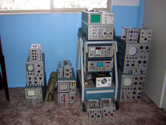

So what’s this about a Tek display room?
I do need to get it organized a little better but..... at least they are all restored and working. Note the very rare 1K20 spectrum analyzer living in the 535a🙂. There is also a 465B and 2XX series storage scope in the van and a 7603a at work on the audio bench.

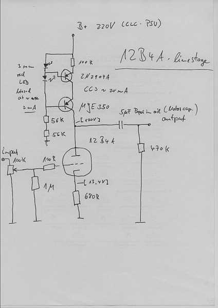

CCS plate loaded 12B4 linestage
I modified my 12B4-linestage, substituted the 6K-resistive anode load I used before with a Current source.
I like very much what I am hearing! Much smoother than before, better channel separation.
I did not like an elctrolytic cap as Cathode bypass (I tried it), it is not neccesary though.
sorry one mistake in the diagramm!
there are two 100 Ohm resistors at the top end of the current source connected in parallel = 50 Ohm, setting the current to 20mA!
