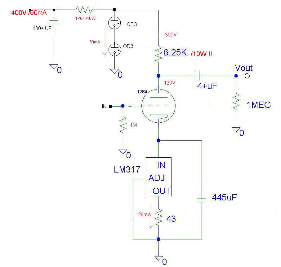

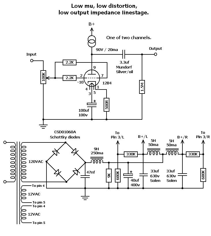

korneluk said:
So Mark, which version of the gas-regulated power supply did you end up using on this version of the linestage?
TIA,
-- josé k.
I believe this one
nota bene - that's one channel schmtc
I'm jumping on board!
I needed a new project to keep me sane. I'm thinking I'll build a 12b4 pre and then maybe a Baby-Huey or el-cheapo after that... I'm using a schematic I found elsewhere, I was suprised it wasn't posted here, that I could find. Here is a picture and a parts list. Other notes, it was suggested in another thread to change the first choke to a 20H and the following resistor to a 20k resistor, other than that no changes. I'm using the Bottlehead CCS because it was the easiest to find prepackaged. I was also thinking that maybe a Hammond 262F12 might get the power and filament done in one shot... Any advice would be appreciated!
You might prefer the sound without the cathode bypass cap. Rig up a switch and try both.
Output impedance increases by (mu + 1) * 500 = approx 3500R.
Depending on input impedance of the amp you are driving, this may or may not be significant.

CCS plate loaded 12B4 linestage
have a look a few posts up, you will find my ugly handdrawing ;-)).
This is exactly the circuit that I am using.
To load the plate with a CCS, has a lot of advantages over a current sink at the cathode, the most important is the better PS-rejection.
I do not use a cathode resistor bypass cap because for my feeling it sounds much better without and the amplification factor is not affected much anyway.
I used standard good quality parts, no esoteric stuff, the preamp sounds very good and is very quite...you might have to select the tubes for low microphony.
have fun
pieroh

I had a look at the parts list.
You could save some money, if you use motor run (paper in oil) caps or some nice PIO caps from Russia (ebay!) as coupling caps and only use one choke in the power supply.
Although I love to use chokes in audio circuits, even a simple CRC filter will also do the job because of the high PS-rejection of the current source.
pieroh

would it be possible in your schematic with an anode CCS, to substitute the cathode resistor by a string of leds, to obtain the same grid/cathode voltage?
R.C.
I'm not pieroh , but - yes
you must use adequate number of LEDs for needed voltage , and adequate No of paraleled strings ; you don't need more than 5mA through one string
SY will advise you regarding exact current through led string

yes, I have nothing to add to Zenmod´s suggestion.....but why dont you stick to he KISS (keep it short and simple) approach.
A simple good qualitity resistor on the cathode, done!
The 12B4 is a very linear, low µ tube and will give a low output impedance, there is realy no need for another stage with cathode follower output.
The B+ is not critical at all, but the higher your B+ is, the higher heat dissipation at the MJ350 transistor will be. This part needs a heat sink in any case! A voltage drop of 40V- 50V across the CCS will be fine.
The PSU caps should be rated 250V at least.
happy building
pieroh
