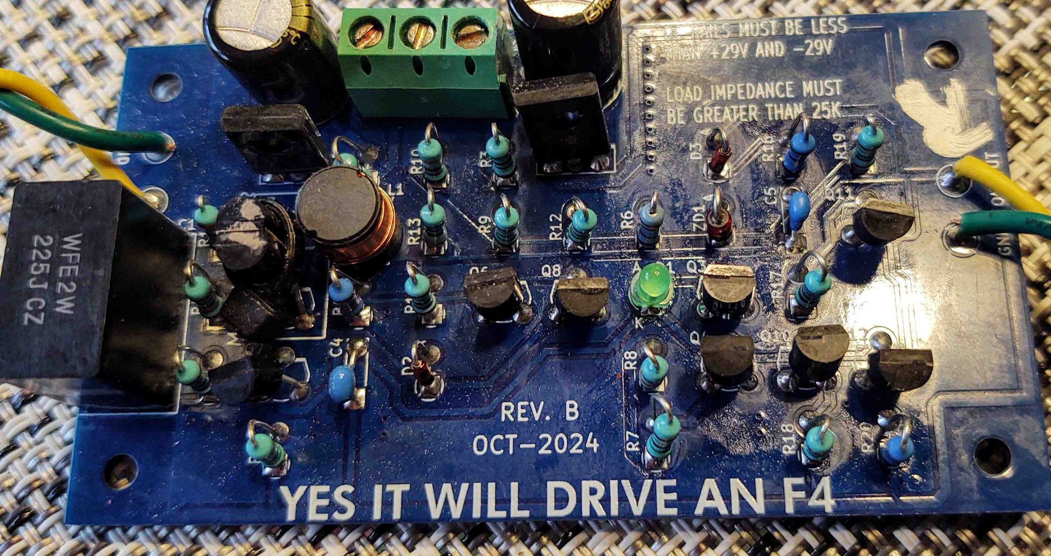

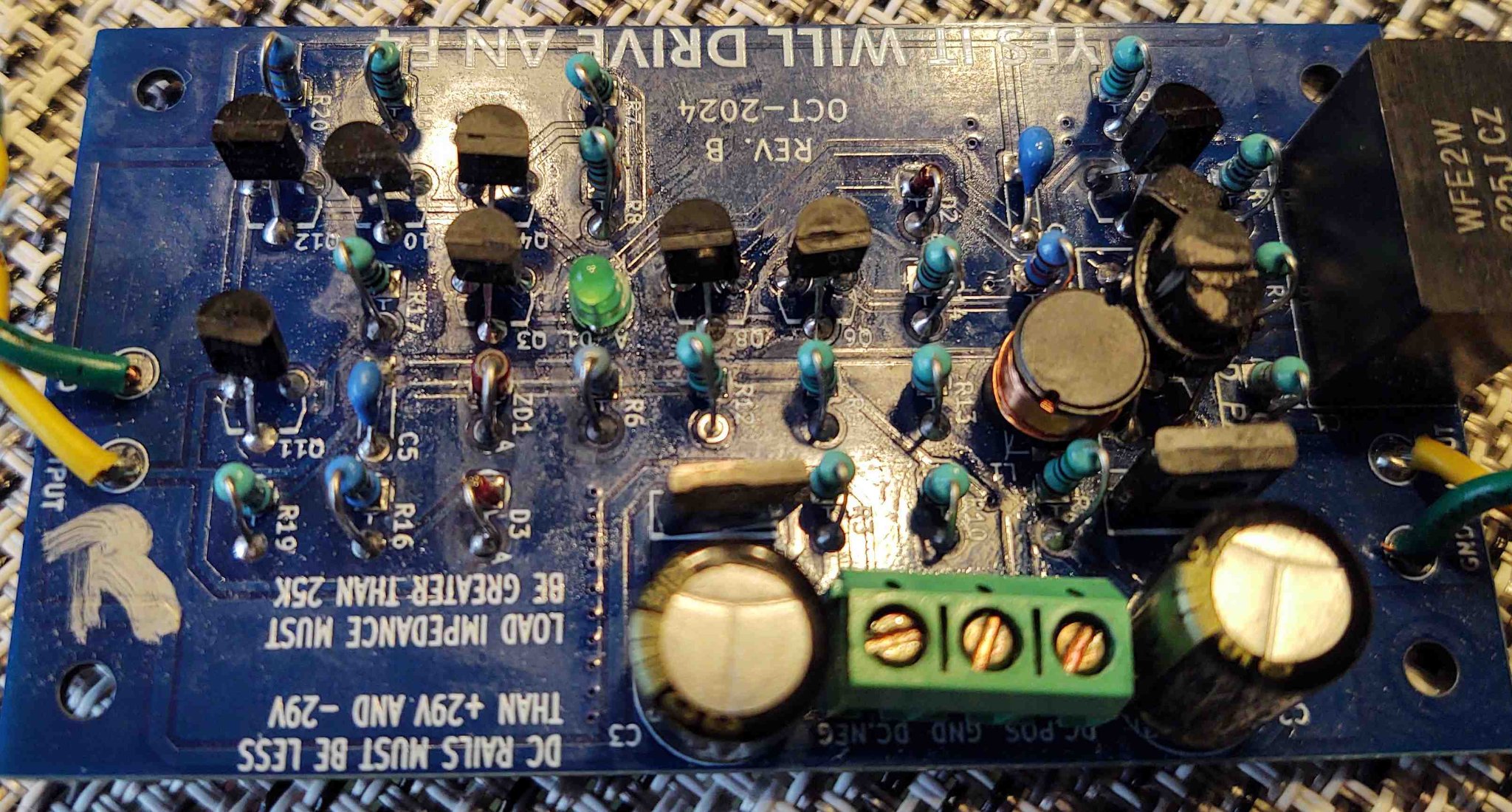

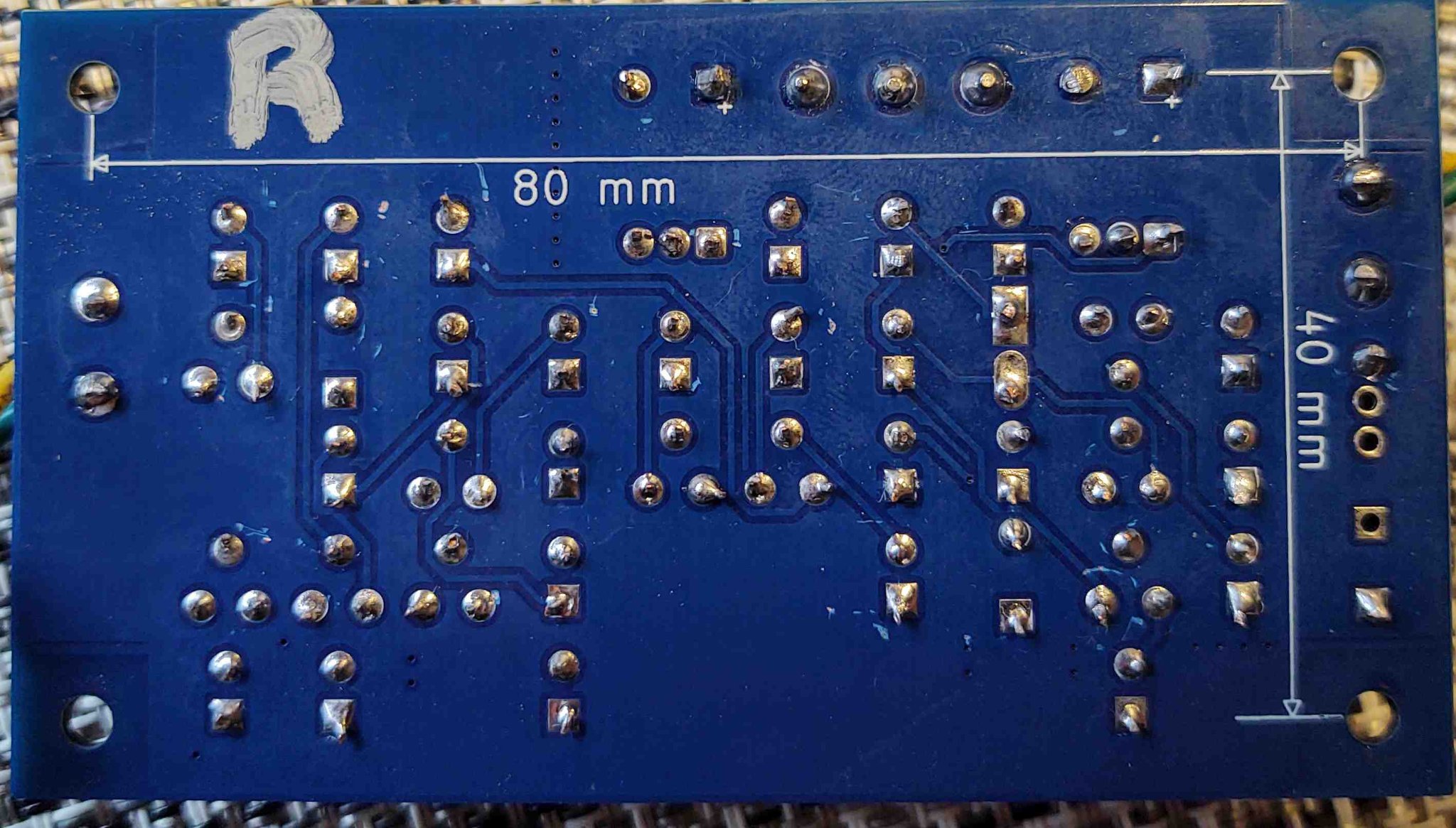

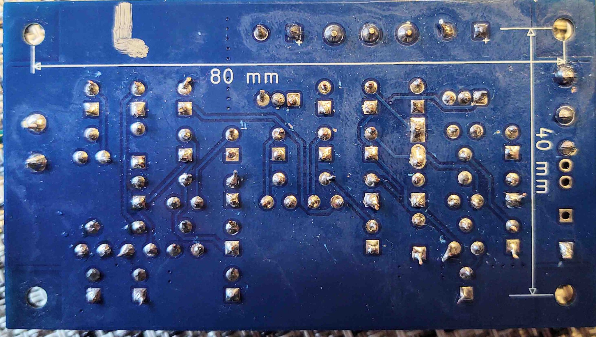

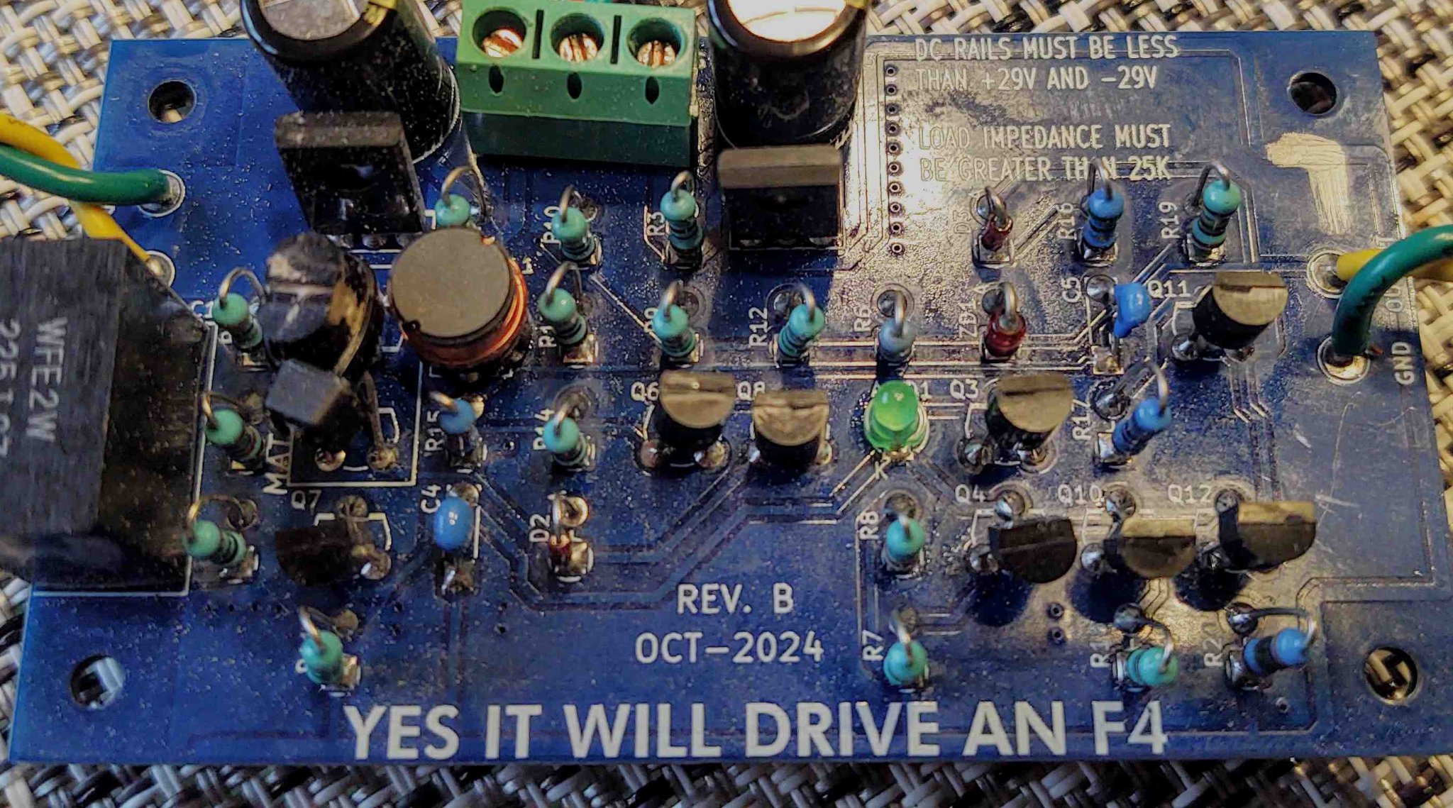

Update on progress. Thanks to the great generosity of Dan (birdbox) I got a replacement BC546C for Q12 that I had installed backwards and fried on my left channel board. Today I replaced Q12 in the correct orientation and did some power on tests using a =/- 24 VDC psu from an existing preamp. No magic smoke this time but the dc offset is not good on either channel. I getting -437mV on the right channel, and 22V on the left (board I smoked Q12 on).
  • I have double checked and measured all resistors on both boards, all match schematic.
  • Checked all transistors, all are in correct orientation and match the schematic.
  • The orientations of ZD1, D2, and D3 match pics posted on this thread.
I'm guessing installing Q12 backwards has wrecked more parts, but the I'm no EE so I'm not sure what the cause of the high offset on the right board is. I have attached some pictures. I would greatly appreciate any insights or guidance.
Many Thanks,
Paul

If the LED on the repaired board doesn't glow at the same level of brightness as the LED on the always-worked board, the repaired board has a fatal disease, and the best option is probably to build a brand new replacement board with new PCB and all new components.
If the LEDs glow identically that probably indicates that the supply filters Q1 and Q2 are OK, the master current source Q3-Q4 is okay, and the tail source Q7 is okay. I'd suggest you replace all four of the upper signal PNP transistors Q6, Q8, Q10, and Q11 and cross your fingers that one of them was the culprit. However if it's just as expensive or time consuming to buy a brand new group-buy 1-board kit, as to buy these transistors, then absolutely replace everything. Now you're very sure you've put the bad part(s) into the trash can.
Reactions: 6L6
The LEDs seem to be at an equal brightness, but it would be easier just to populate a new board than go through the hassle of resoldering the old one. Good advice, thanks Mark. Any idea why the offset is so high (-437 mV) on the right channel ?

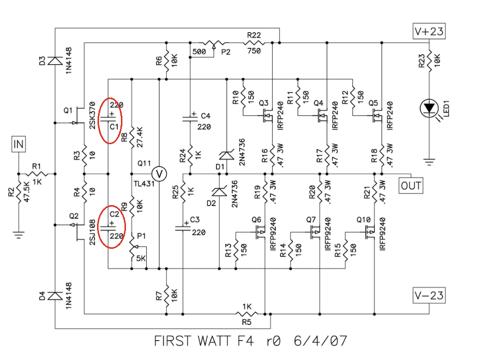

437mV output offset isn't going to be harmful to either the YICDF4 board or to the F4 itself. The F4 is AC coupled between the input JFETs and the output push-pull followers, so the 437mV offset gets blocked by C1,C2 (in red) and does not propagate to the final loudspeaker output.
The only detriment is that your maximum unclipped sine wave amplitude won't be +20V to -20V; instead it will be +19.563V to -19.563V . With an 8 ohm load that's 25 watts with no offset and 23.9 watts with 437mV of offset. I suggest you not worry about it.

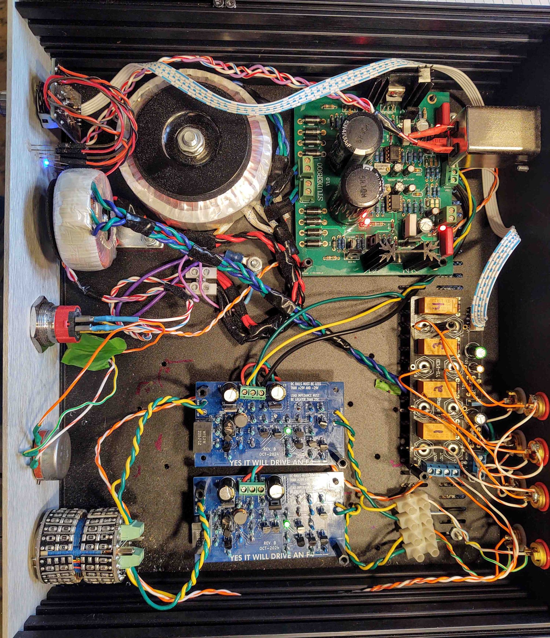

Build complete and my impressions. I built my copy as a stand alone preamp using a VDRN psu (great PSU) and a bunch of scavenged parts from old projects. I have a F4 and have driven it with a high gain Aikido tube pre, and a BA3 FE. The Aikido is a nice combo, but is ever so slightly veiled compared to the BA3 FE. Besides that the overall presentation is pretty equivalent. I kept going back and forth between the two. But in my opinion the preamp design gifted by Mark is a step up from both. The dynamics, clarity, and base resolution are better and it not a subtle difference. A really great match for the F4. Really brought mine alive. Congratulations and thanks to Mark for a great design. And thanks to Dan (birdbox) for the kits and all of his help.
Oh hey, @PJN , did you install the output caps recommended in post #113 above? If not, I strongly recommend you do. You've got a standalone preamp that someone else, or forgetful you, might someday connect to another piece of gear. And if that gear happens not to be AC coupled like F4 is AC coupled, there could be a disaster. Honestly I didn't imagine that anyone would put YICDF4 boards anywhere else except inside an F4 chassis and I didn't plan for that. Literally you "thought outside the box" enormously better than I did; protect yourself please.
For paranoid safety, use one of those label printers to make sticky labels which say "DO NOT CONNECT TO ANYTHING BUT AN F4" and attach the stickers to the rear panel and bottom panel of your 2 x YICDF4 preamp. Otherwise well-meaning people may connect it to something else and then you'll WISH you had installed the output caps.
