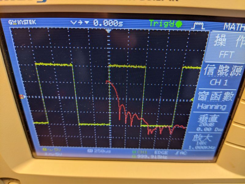

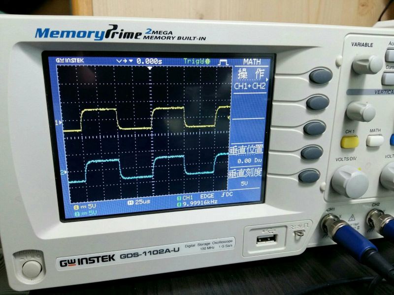

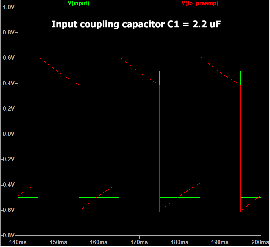

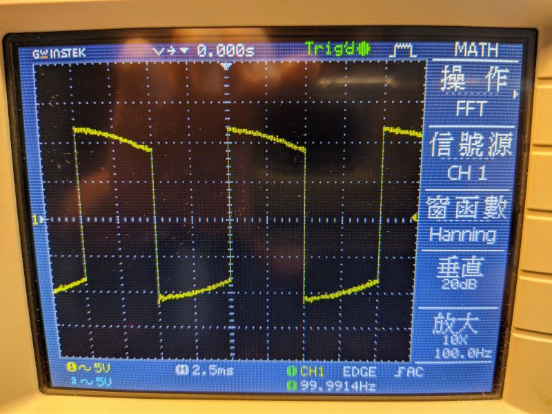

Congratulations @r580808 , on building and bench testing a pair of "Yes It Can Drive an F4" boards! Very nice job.
Even before you complete the experiment suggested by @thimios in post #139, I'd like to mention a few facts about your square-wave-in, big-slope-and-not-very-square-wave out at 50 Hertz, which is shown in your final photo of post #136.

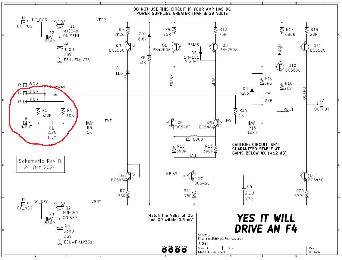

The input square wave in your photo has a flat top and a flat bottom, while the output slopes diagonally. The slope is expected and entirely normal. It happens because the AC coupling capacitor "C1" (2.2 microfarad polypropylene film) at the input, is sloooooowly discharged through bias resistor R4. Usually the sloooooow discharge is completely negligible; it only matters with signals that resemble DC --- like the flat tops and flat bottoms of looooooow frequency square waves.

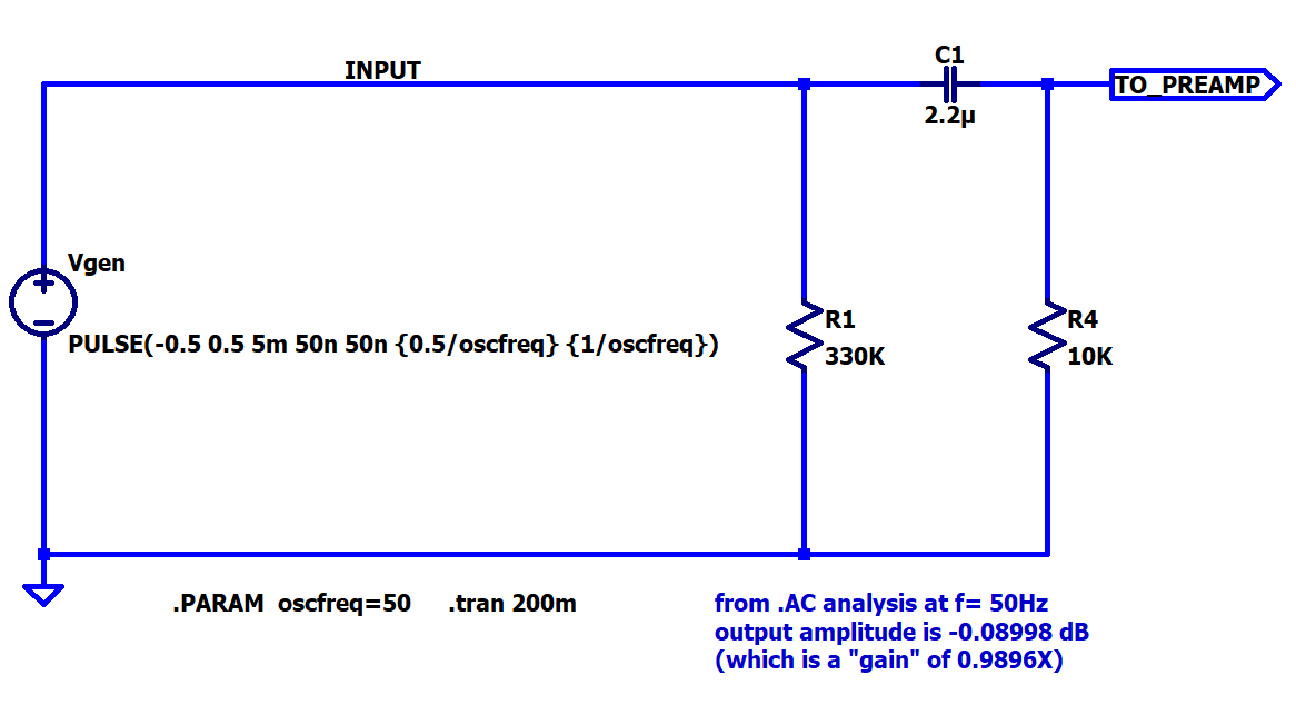

Not only is it visible in real life amplifiers; this phenomenon also appears in circuit simulations. I've circled the part of YICDAF4 which creates this slopey-ness, with a red circle on the schematic. R1=330K doesn't actually do anything because it's in parallel with a voltage source, but I left it in the simulation anyway. Just in case skeptical people feel it MUST be included in the simulation.
Figure 2 shows the question I asked LTSPICE. "When I attach a square wave to these two resistors and one capacitor, what do the output look like?"
Figure 3 is LTSPICE's answer. The parts of the input square wave which resemble DC, namely the flat top and flat bottom, allow R4 to slooooooowly discharge C1 and the output slopes.

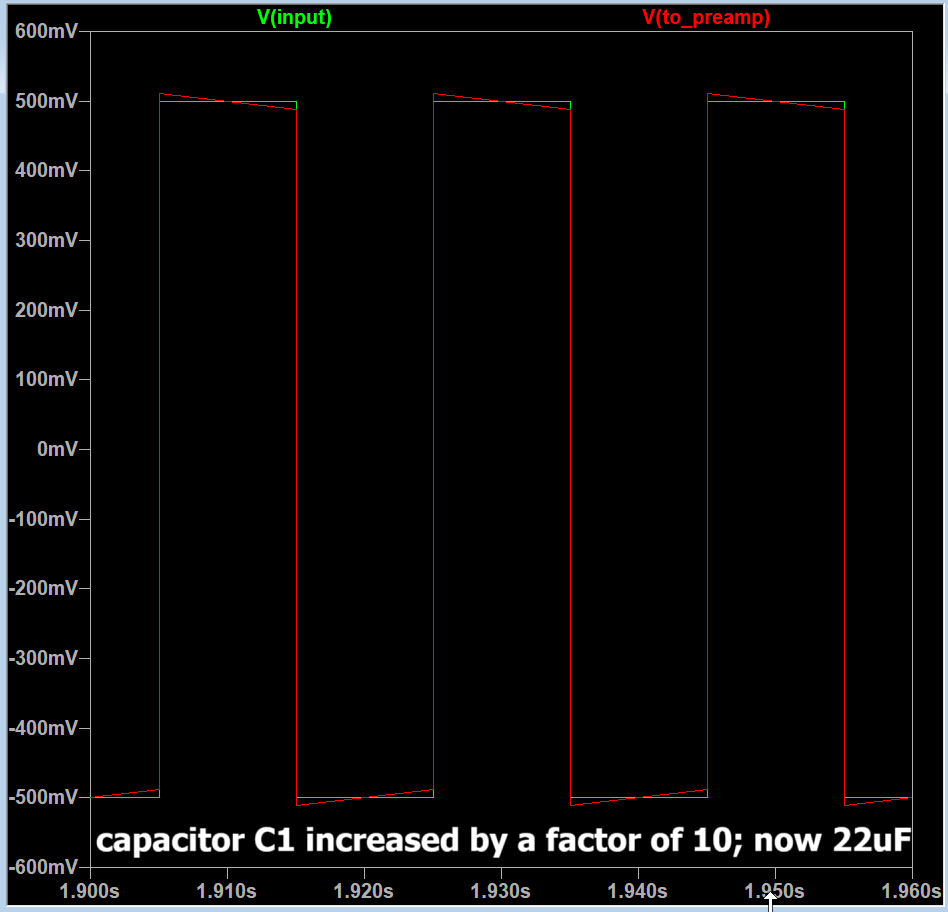

Figure 4 is the answer to a different question: "What if I increase C1, from 2.2uF to 22uF? Does the slope change?" LTSPICE's answer is Yes. The slope is reduced by a factor of ten. When the capacitance increases by 10x , the slope decreases by 10x. If that's very important to you, please feel free to find a 22uF polypropylene film capacitor which fits the PCB footprint, and replace C1. Be sure to get one whose DC voltage rating is comfortably greater than 30V.
I realize this is not the main thrust of @r580808 's inquiry, but rather a side quest. When the ground clip placement experiment has been completed, we'll deal with the other scope photos.

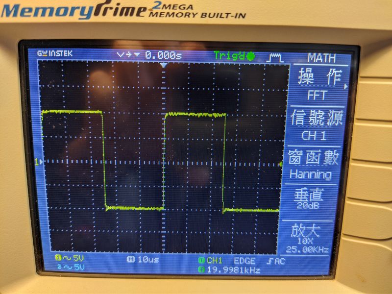

This is the waveform I got after inputting a square wave signal (10kHz) when I made the preamplifier (B1 with Korg Nutube, B1K). Please refer to it.

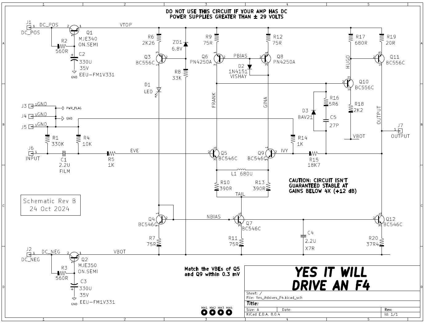

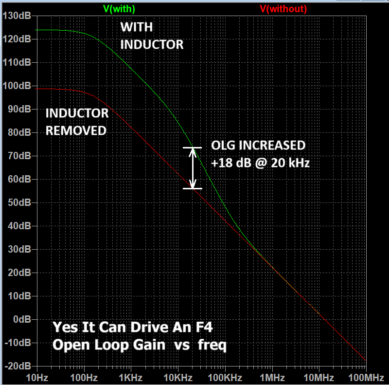

I've attached a plot of Open Loop Gain versus frequency, for Yes It Can Drive An F4 (abbrev YICDAF4) with inductor L1 present (green trace) and again with inductor L1 removed (red trace). It illustrates some of the ideas discussed back in post #1 of this thread:
Pause for a moment and think about that. Adding one small and inexpensive component, increased the gain bandwidth product by a factor of twenty. Doesn't that sound almost too good to be true? Surely there's got to be some kind of a tradeoff, or hidden cost, or unhappy side effect? As Milton Friedman and Robert Heinlein preach: There Aint No Such Thing As A Free Lunch . . . . however this inductor may appear to be a counterexample (?)

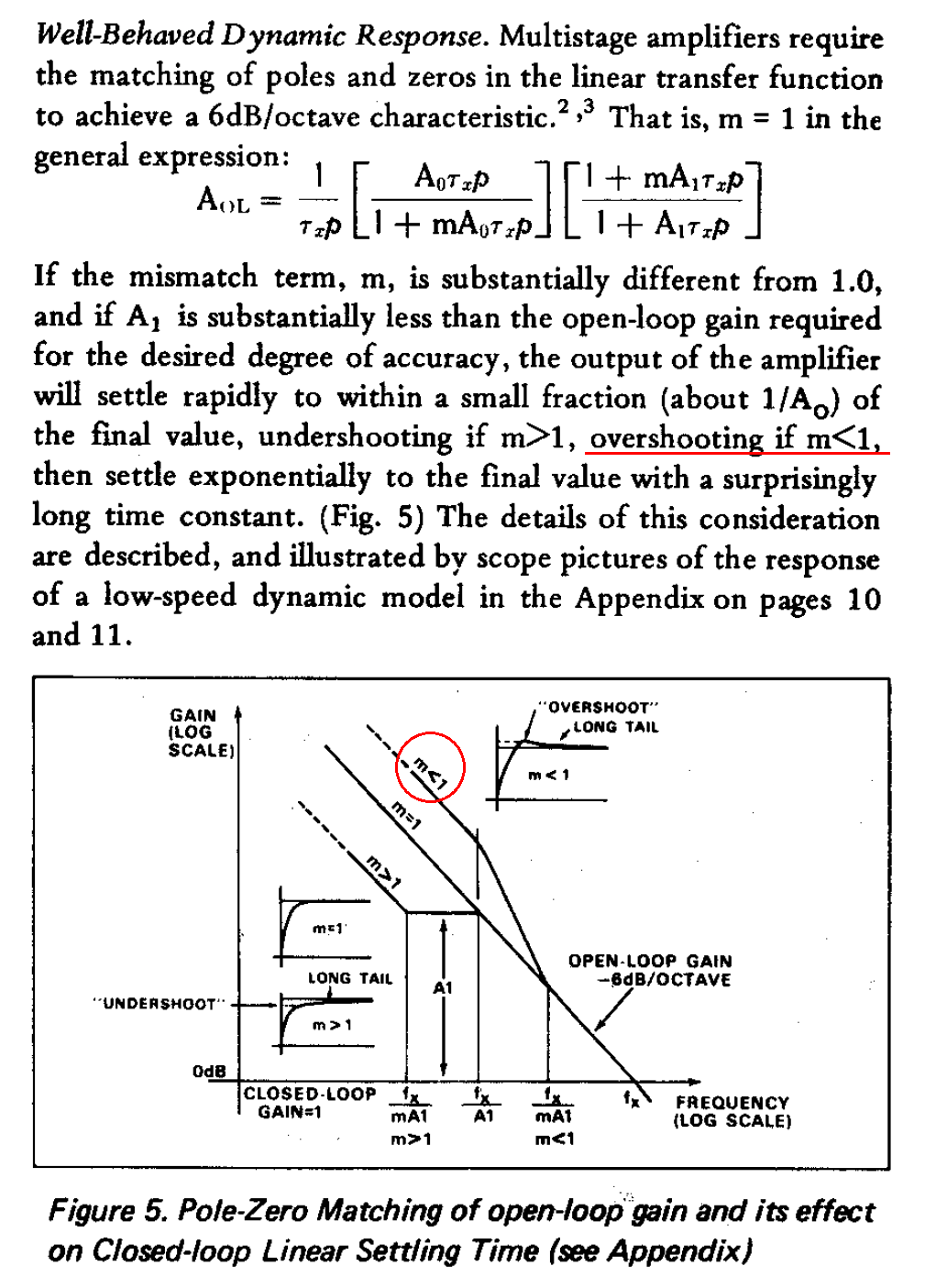

Indeed TANSTAAFL , you are right to be skeptical. The hidden tradeoff, the downside of adding the inductor, is an increase in the amplifier's Settling Time. Scott Wurcer pointed this out, here on these Forums, more than 17 years ago:
In (this post), Scott Wurcer wrote
The analysis of this phenomena requires a fairly deep dive into control systems theory, but fortunately the kind people at Analog Devices have summarized it very nicely in their application note AN359, which I attach below. In particular, Figure 5 of the app note (snipped and attached), shows that when the open loop gain hinges upward near the gain crossover frequency (labeled "m < 1"), the settling time increases and the output waveform has transient overshoot.

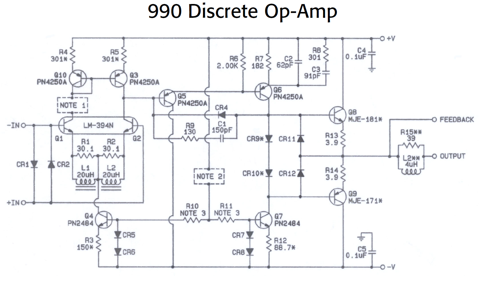

And that's exactly what we have in YICDAF4: an open loop gain curve that hinges upward (see green trace on the OLG vs freq curve), and a transient overshoot. AN359 predicted it beautifully.
It's worth considering: is this kind of overshoot / settling time , actually detrimental? Is it anything to worry about? After all, the JE990 discrete opamp has been manufactured and sold in the professional audio market for more than 40 years. JE990 contains Long Tailed Pair inductors which produce "nasty settling time", yet the pro audio folks keep buying JE990s and using them. Maybe settling time is crucially important for D-to-A uses, but perhaps not so important for continuous time, continuous signal, linear circuits. Maybe the pro audio people who buy and use JE990s (and Burwen's ADI121 before then), aren't complete dunces?
Thanks to Analog Devices we now have a theoretical understanding of the settling time and overshoot of YICDAF4. It's a side effect of the 20X increase in gain bandwidth product (and 18 dB more feedback where distortion is worst: at 20 kHz). I also did some lab measurements of my own, on YICDAF4 boards with the called-for inductor, and again with modified inductors. I'll post those results after I've gathered everything together.

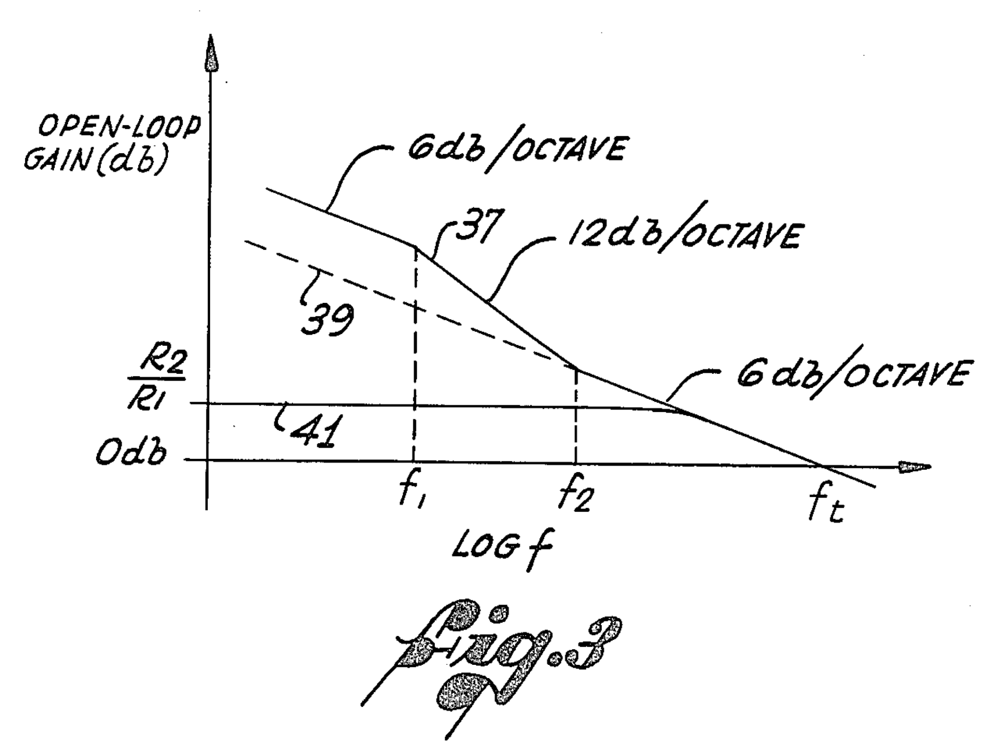

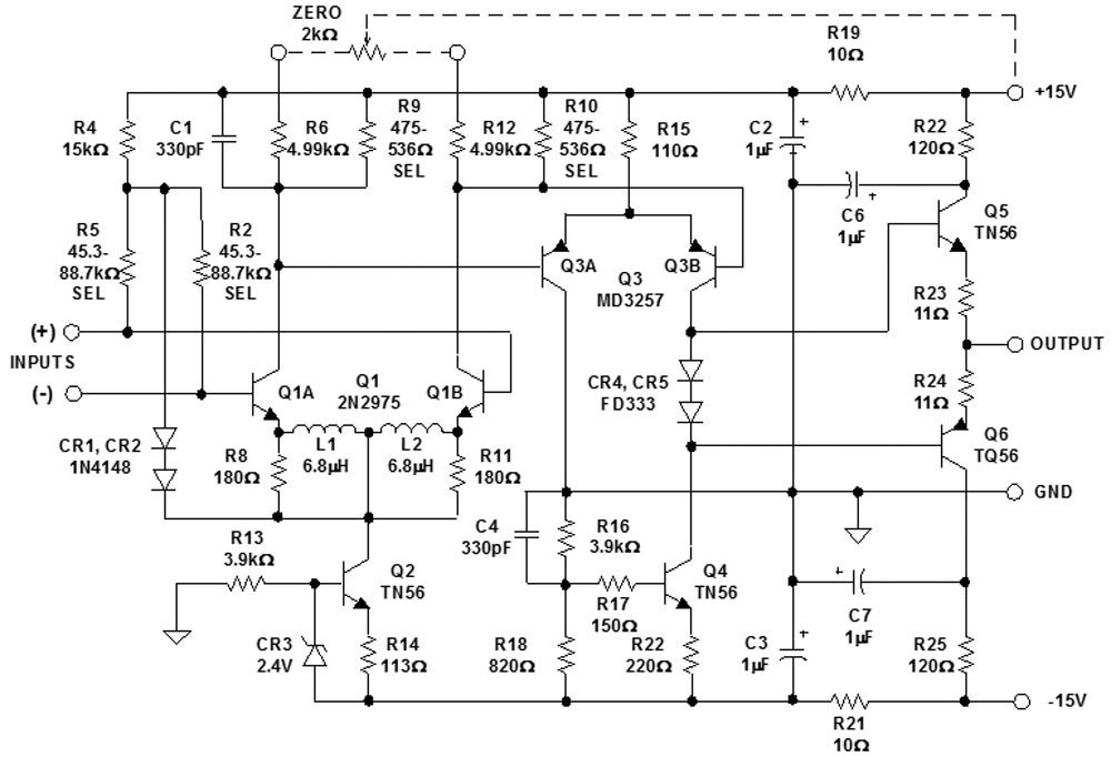

Now let's consider the effect of the inductor L1 in the "tail" region of the Long Tailed Pair, Q5-Q9. This turns out to be quite an old idea; according to Scott Wurcer here on the DIYA Forums, Richard Burwen of Analog Devices used it in 1966(!) on the hybrid discrete opamp "ADI121", shown in the attachments below. Later, Deane Jensen was able to take out a patent (US 4,287,479) on the same circuit. I've snipped out "Figure 3" of Jensen's patent and attached it below.
At very low frequencies, the inductor acts like a short circuit, so the emitter degeneration resistors R10,R13 are removed from the circuit at low frequencies. This has two benefits: (i) the noise contributed by R10 and R13 is eliminated at low frequencies; and (ii) the effective transconductance of the long tailed pair stage is greatly increased. In this circuit, gm rises from 2.4 millisiemens to 52 millisiemens -- a growth of 20X (26 dB). There is 26 dB more gain available at low frequencies, thanks to the inductor. That's 26 dB more negative feedback for distortion reduction. And, oh by the way, the Gain-Bandwidth Product increases by this same factor of 20X at low frequencies. It rises from 14 MHz to 280 MHz. Cowabunga. [as we can see on the plot, the open loop gain increases by 18 dB at 20 kHz. That's 18 dB more feedback, to reduce distortion further.]

Dick Burwen still claims he co-founded ADI just to make op-amps for his stereo. I think it was the AD211 circa 1966 that turned into the JE-990. The inductors across the input degeneration are a give away. This trick gives even more OLG at audio, and does nasty things to settling time

Thanks for the explanation. Is it possible to add a diode to eliminate the side effects of the inductor? As this YouTube video explains.
If this were a DC motor drive attached to a switch, sure. The circuit works in the video because the springy thing's energy (coil) needs a place to go when the DC current stops, and the diode acts as a one-way relief valve.
However this is an (AC) amplifier, which is using the "springiness" of the coil to boost the gain and voltage swing in a way that has a lot of advantages, with the side effect of a little bit of overshoot. I.E., it's part of the circuit as designed.

Provides the experimental results after removing the inductor, the input signal is a square wave of 1 volt. To me, it feels better than adding an inductor, and the output is still 20 volts.
The cost is 18 dB less open loop gain at 20 kHz , i.e. 18 dB (8X) less feedback for distortion reduction.
Richard Burwen, one of the founders of Analog Devices, preferred to include the inductor. You, on the other hand, are free to leave it out if you wish.
