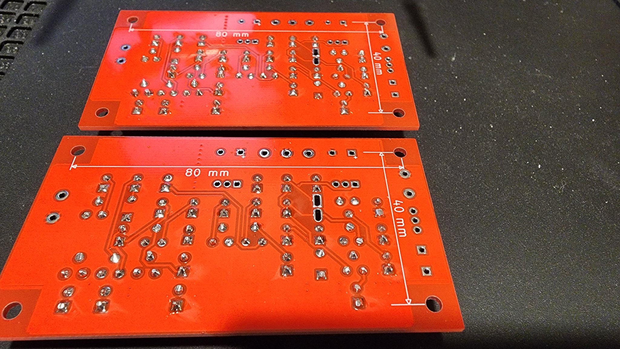

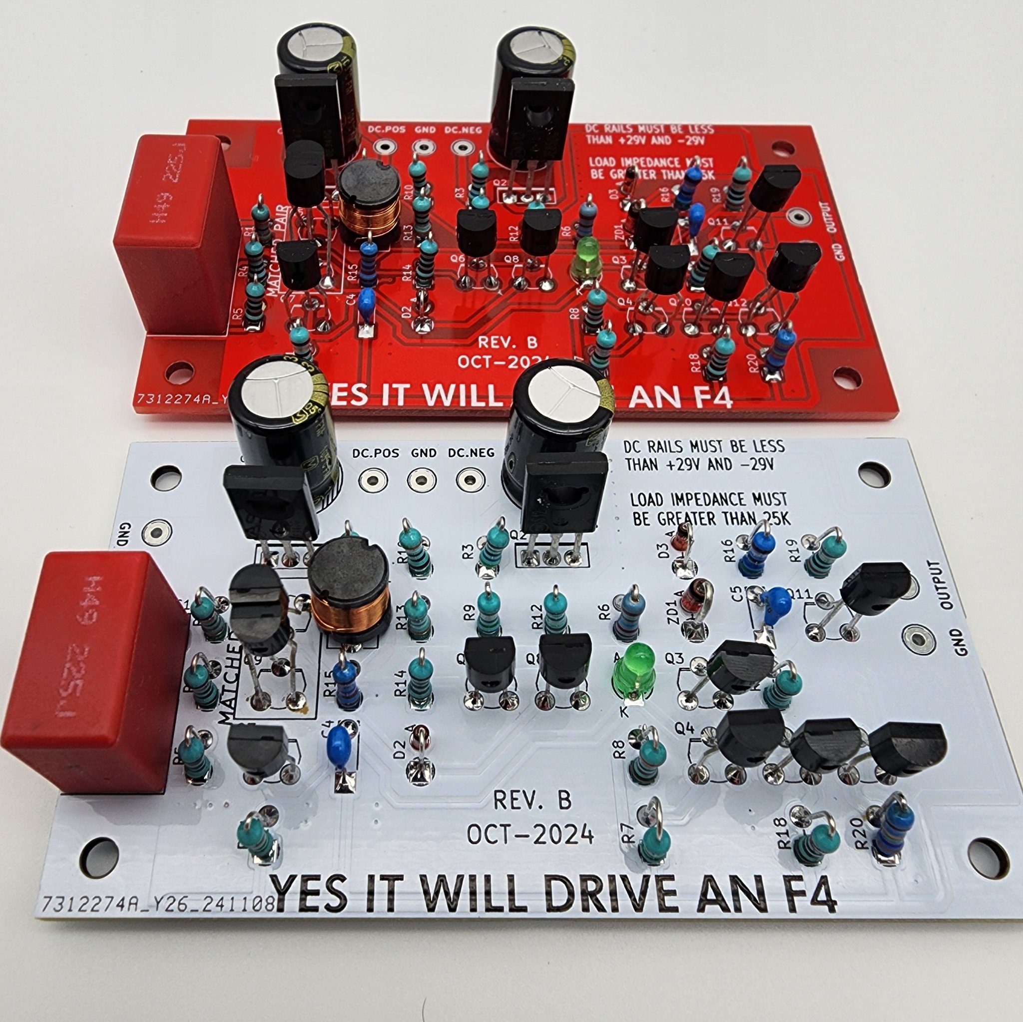

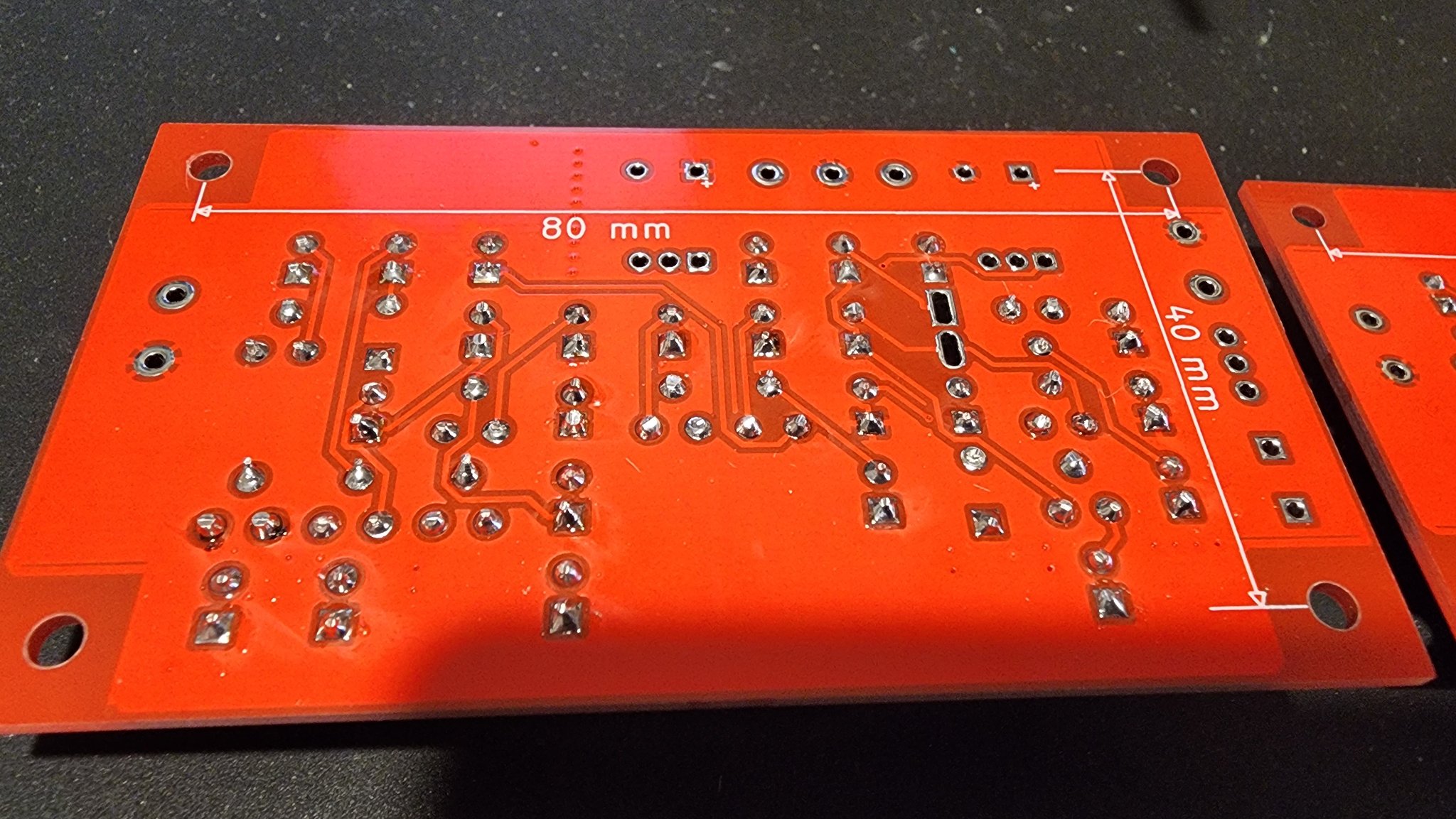

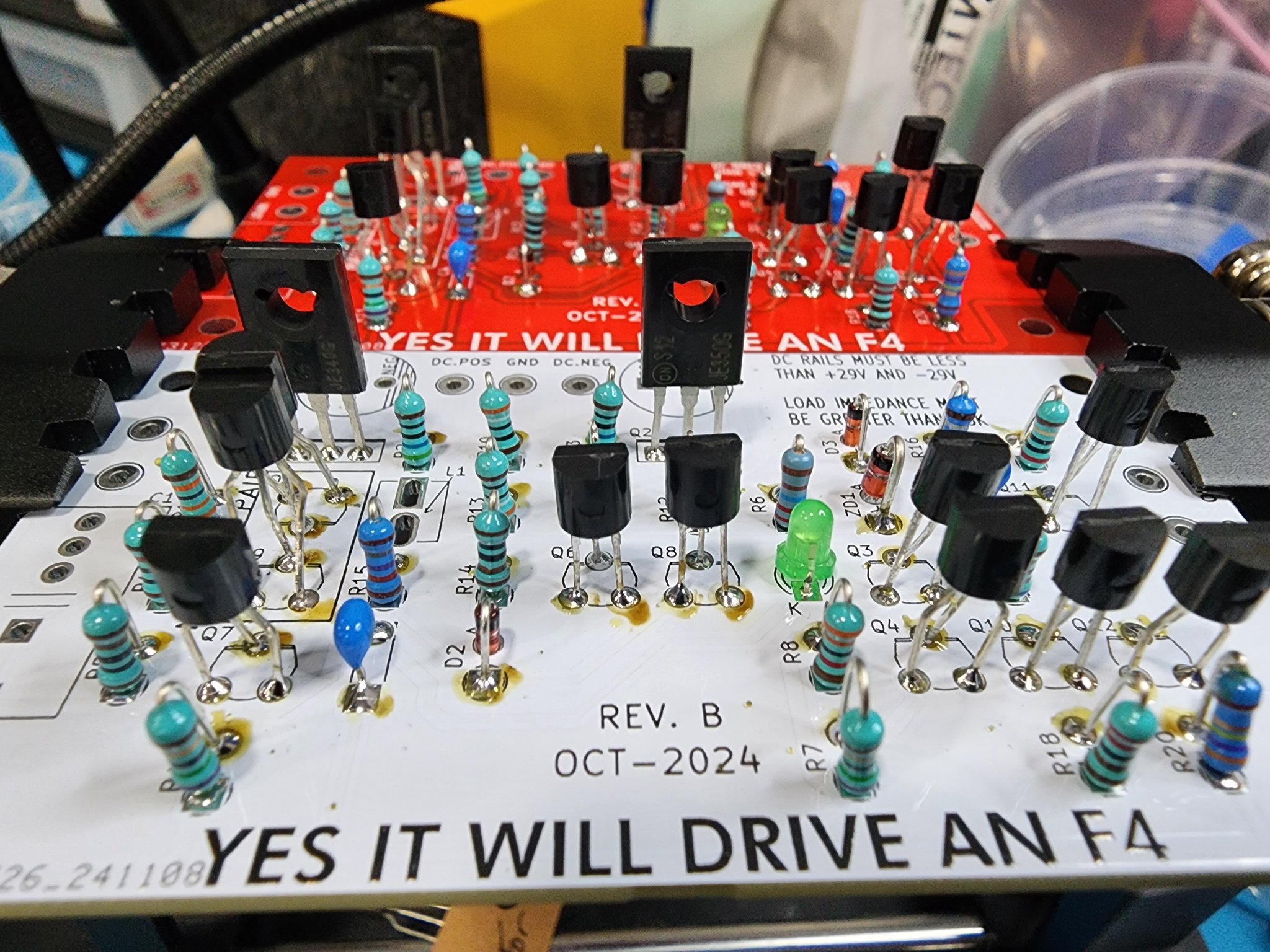

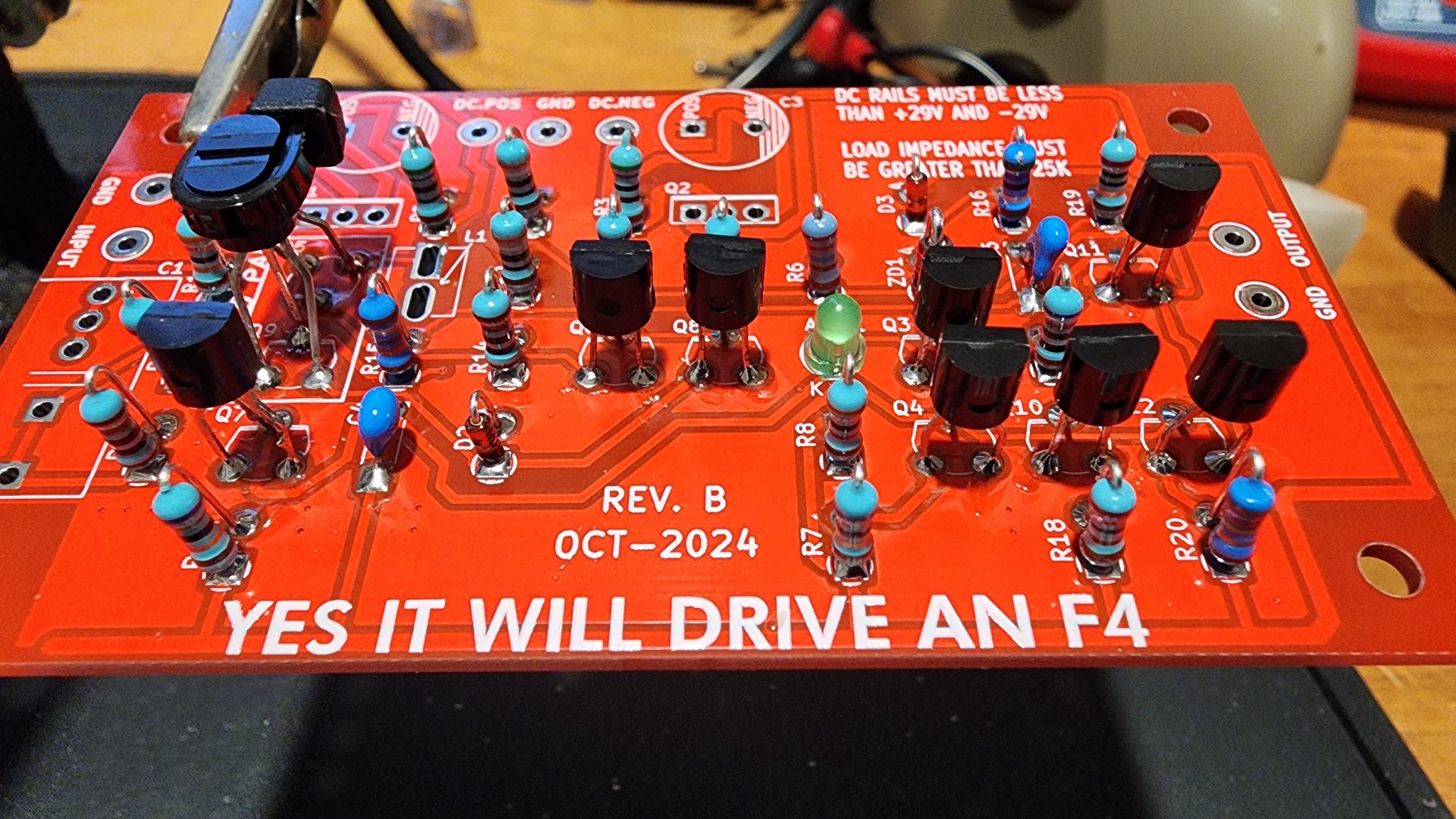

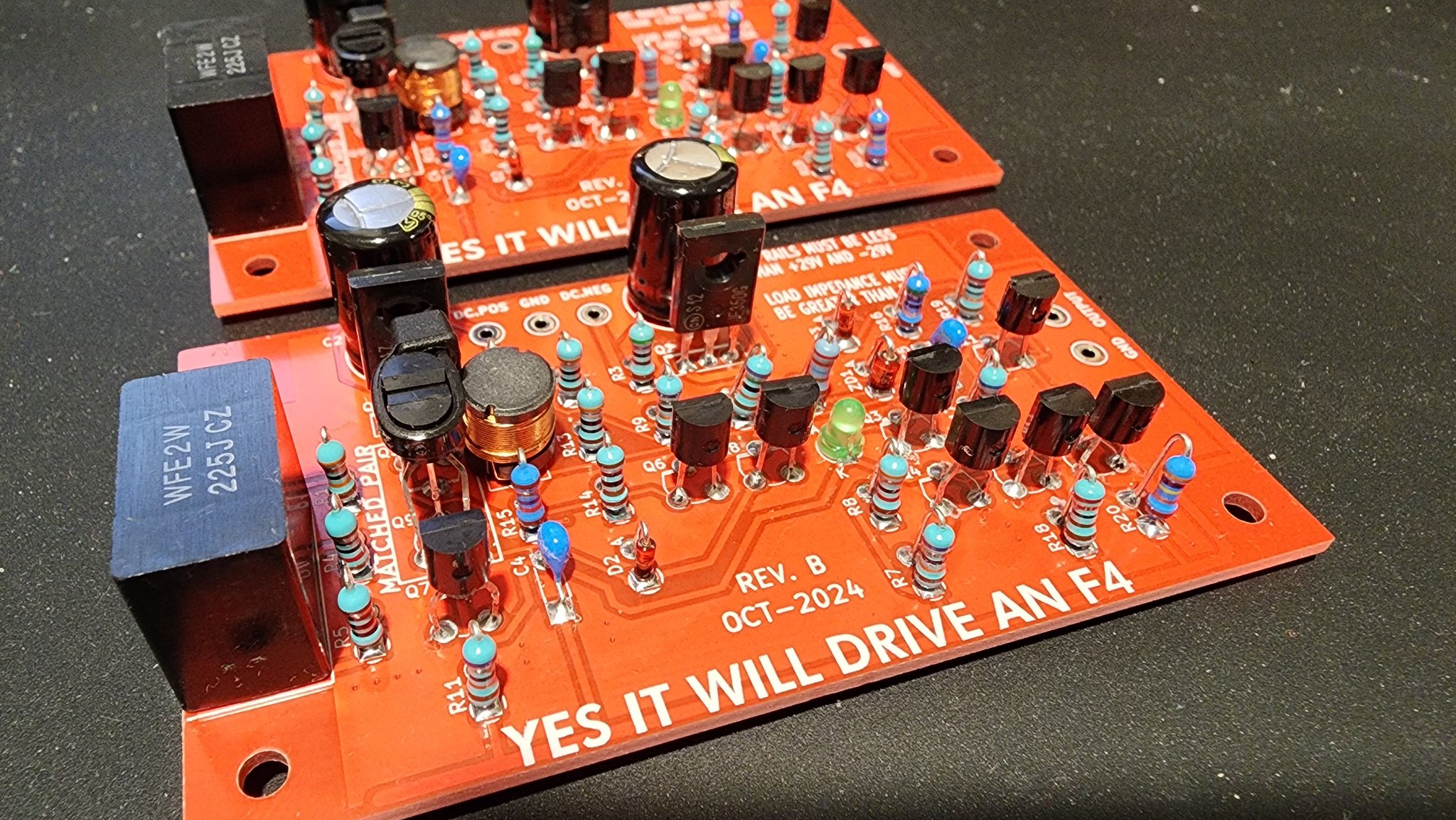

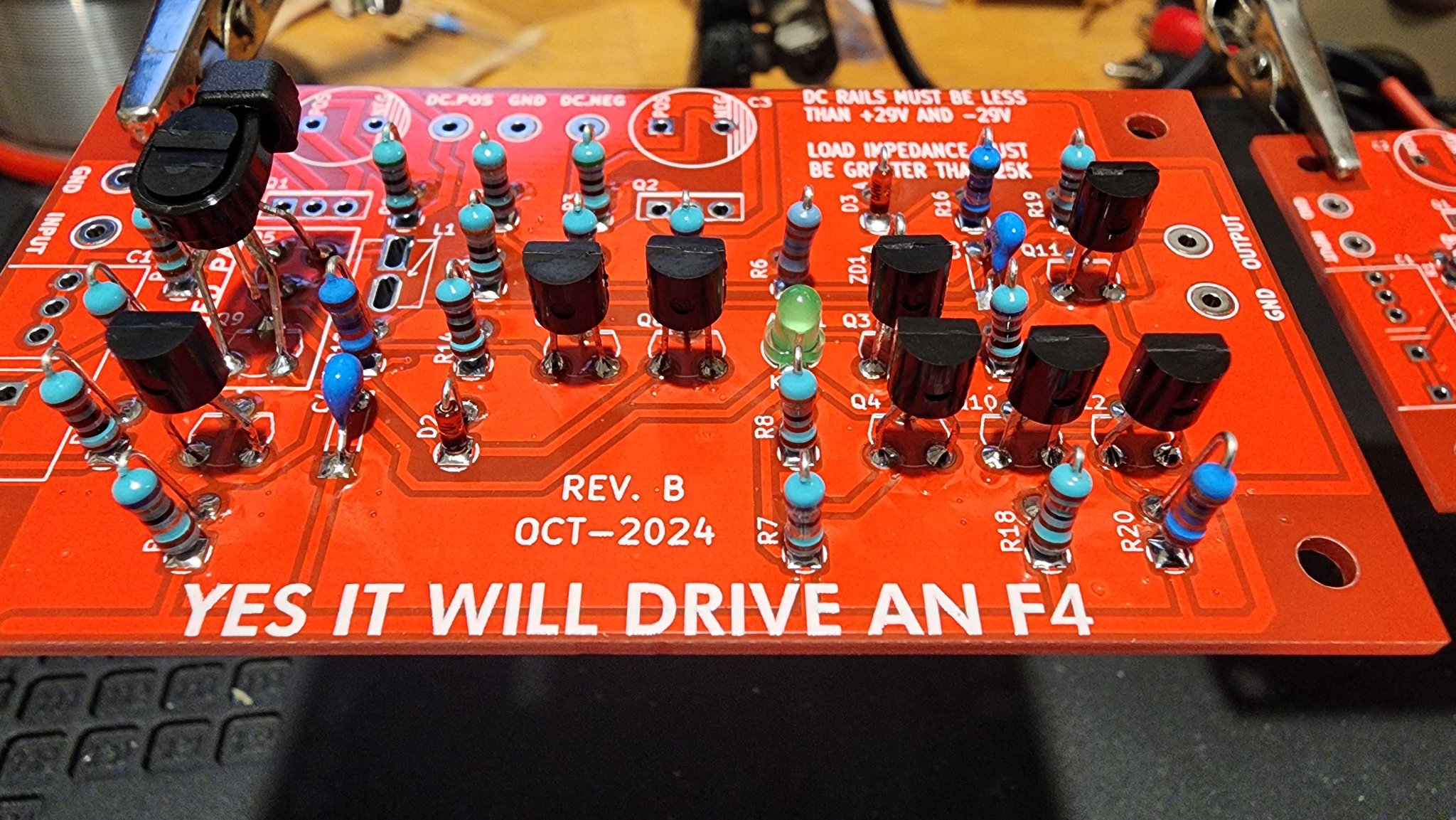

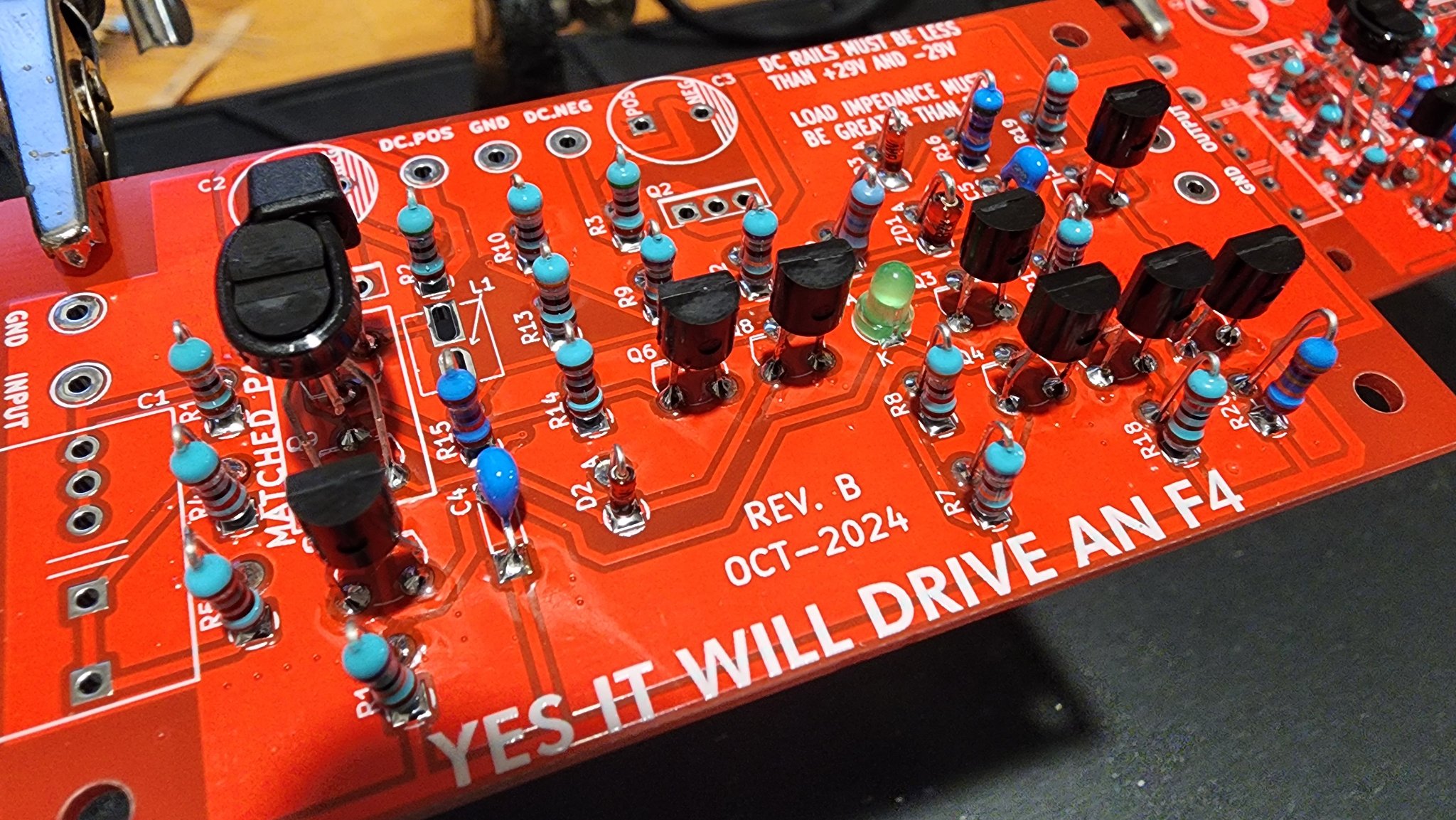

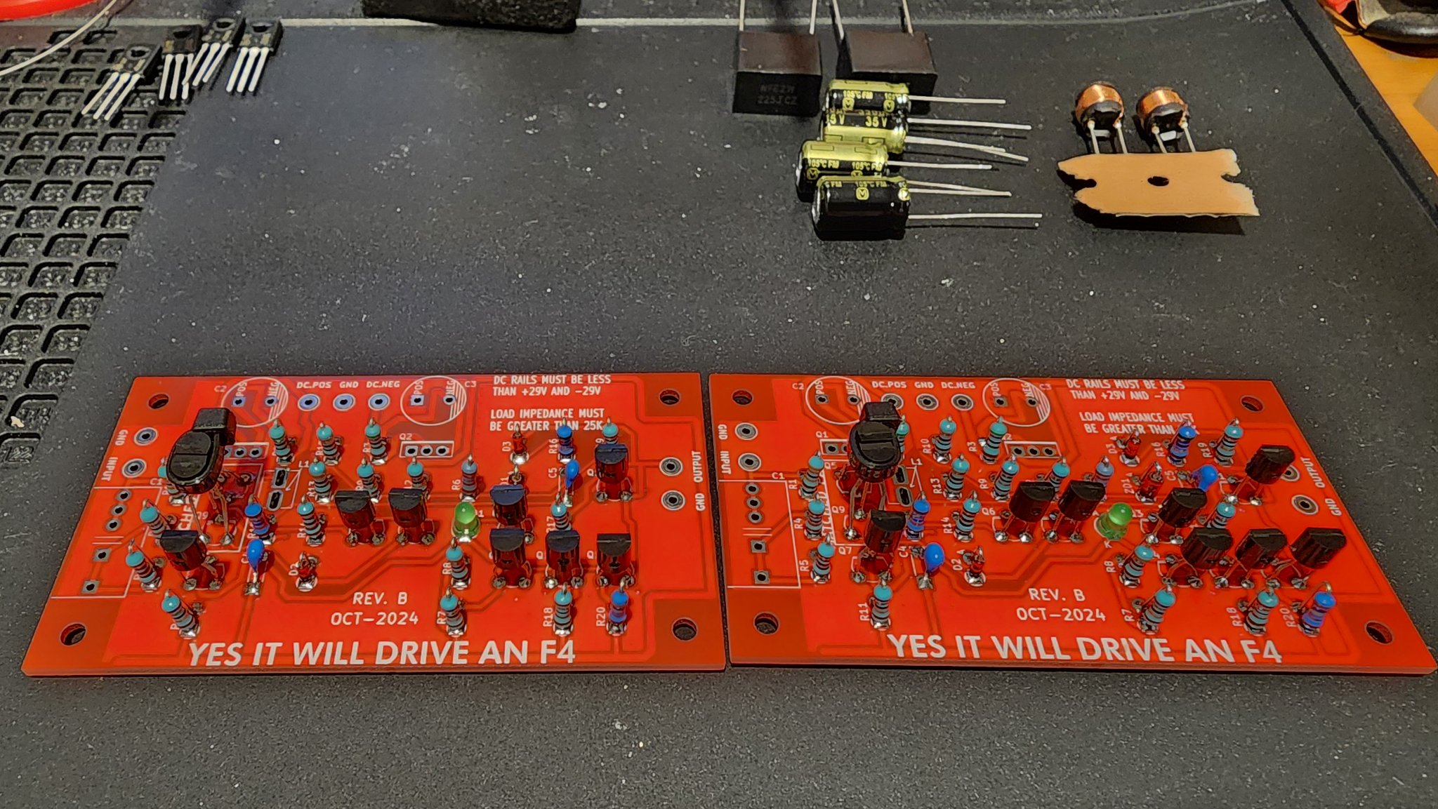

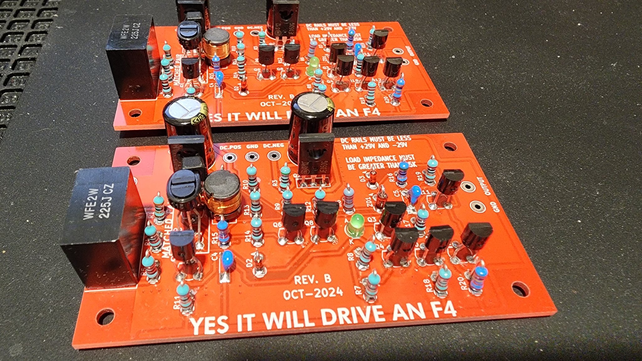

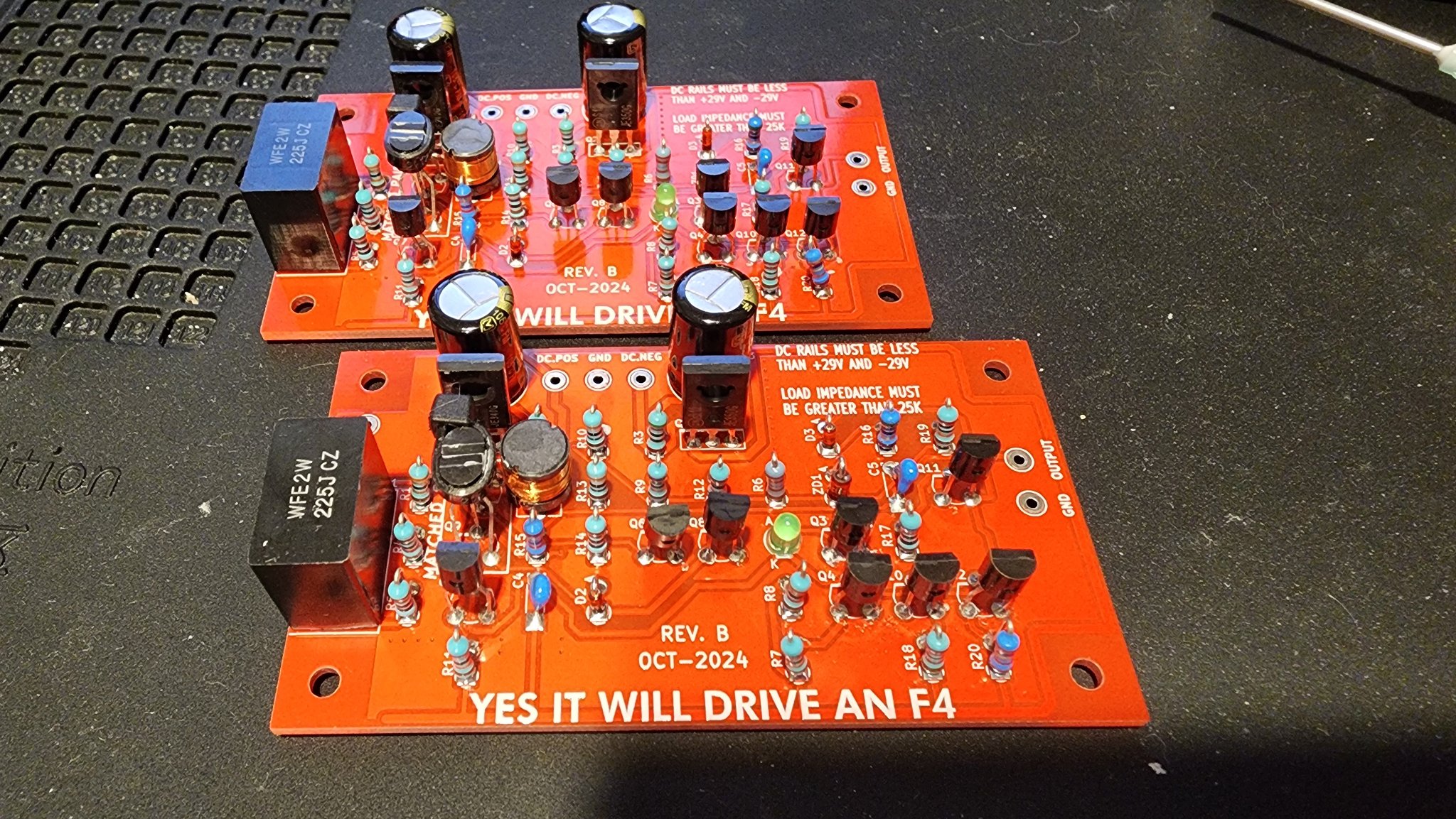

Built up a second set of "Yes It Will Dive An F4" boards for F4 number two. Waiting for F4 parts from Mouser now to complete the main boards.
I populated all the parts starting with the middle of the board first to maximize access with the soldering iron. I was careful to install in an order that maximized soldering tip access, which I highly recommend.
Of course, I left the big parts off until the very end. For the matched BJTs (got 0.1mV matches!), I zip tied them together before installing on the board. I was able to clean the board with the zip tie in place, so I didn't have to cut it off and reinstall a new zip tie after cleaning. Prior to installing the Electrolytic caps, inductors, and film caps, I cleaned the entire board top and bottom thoroughly (many times) with 91% Iso-P (I didn't have 99% on hand) and an old tooth brush, then finished the last big boy parts, and one final bottom cleaning after that.

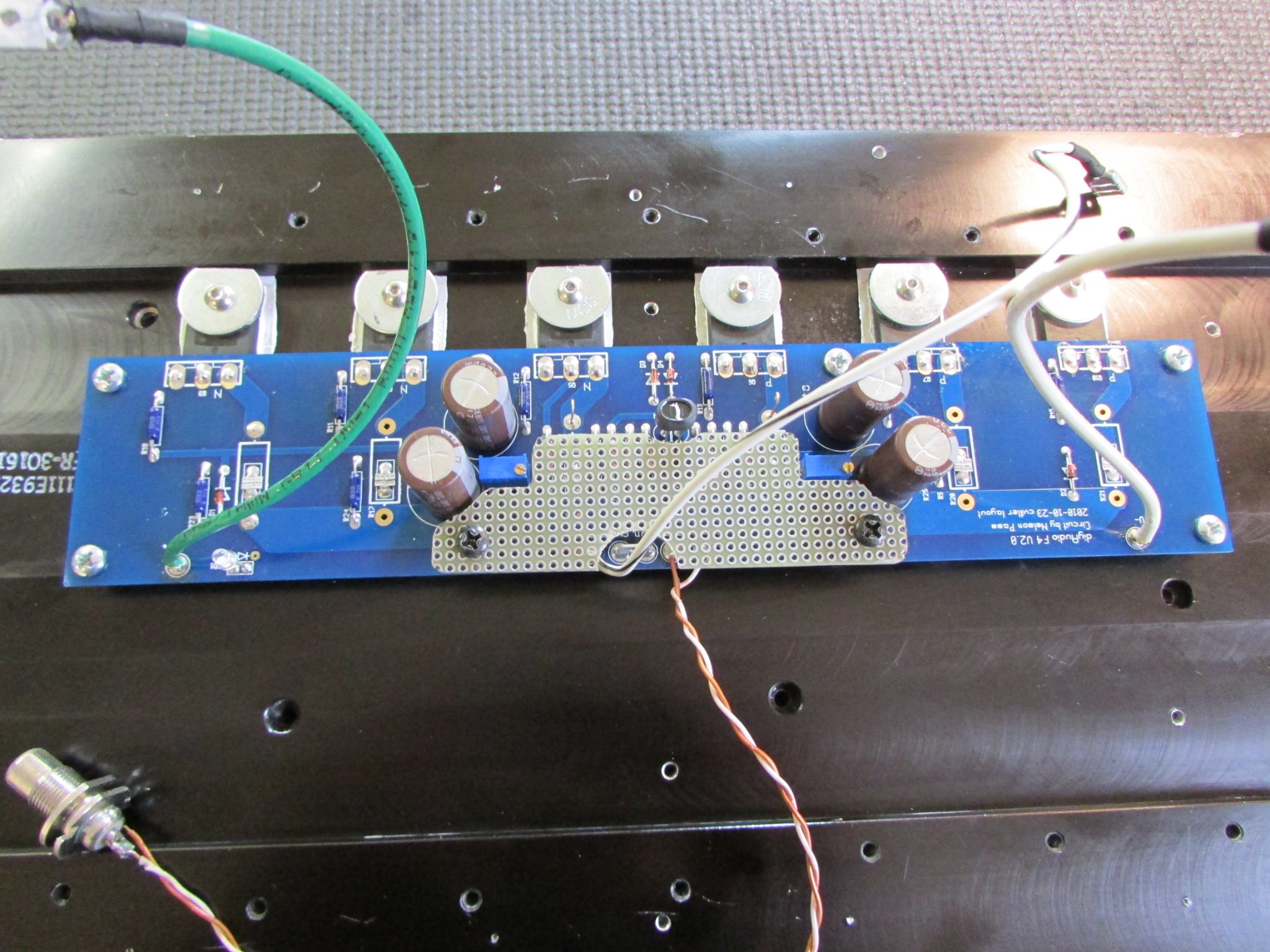

Looks great birdbox! Don't forget just a small dab of thermal grease between those two guys with the zipties. Maybe you have some there already, but usually you can see a little squish out when it's there. You can see a hint of it on my old F4 boards here. Also showing a piggyback idea I didn't quite complete that was going to hold lhquam's "Curly-F4", a folded cascode gain stage similar to the LSK pre presented at BAF 2013.
Beautiful job, @birdbox !! Have a high-five for stuffing the diodes with abutted cathode & flywire anode. And a second high-five for managing to get all of the TO-92's perfectly vertical and exactly the same height, that's not easy. Btw I like to do one final IPA flood/rinse, followed immediately by a pistol grip hair dryer on maximum blowing speed. It prevents slow evaporation that can leave a powdery haze behind.
Excellent catch! That had totally slipped my mind last night around midnight. I ordered some MX-4 thermal grease from the big bookstore and will have to cut the ziptie to apply, then re-ziptie. Keen eyes good sir! Thank you.
I did hold the boards in front of a little electric blowing heater for that purpose after final rinse, however, I'm going to use your method and take advantage of my heat gun on "high flow/low heat" going forward as I like your idea of direct rapid convective heating to maximize evaporation. I've ordered some 99% IsoP from the big bookstore so when it arrives Saturday (hopefully same day the Mouser order for F4 parts shows up), I'll do a few more rinsing cycles of the PCBs. Thanks again for the wonderful design and expert advice!

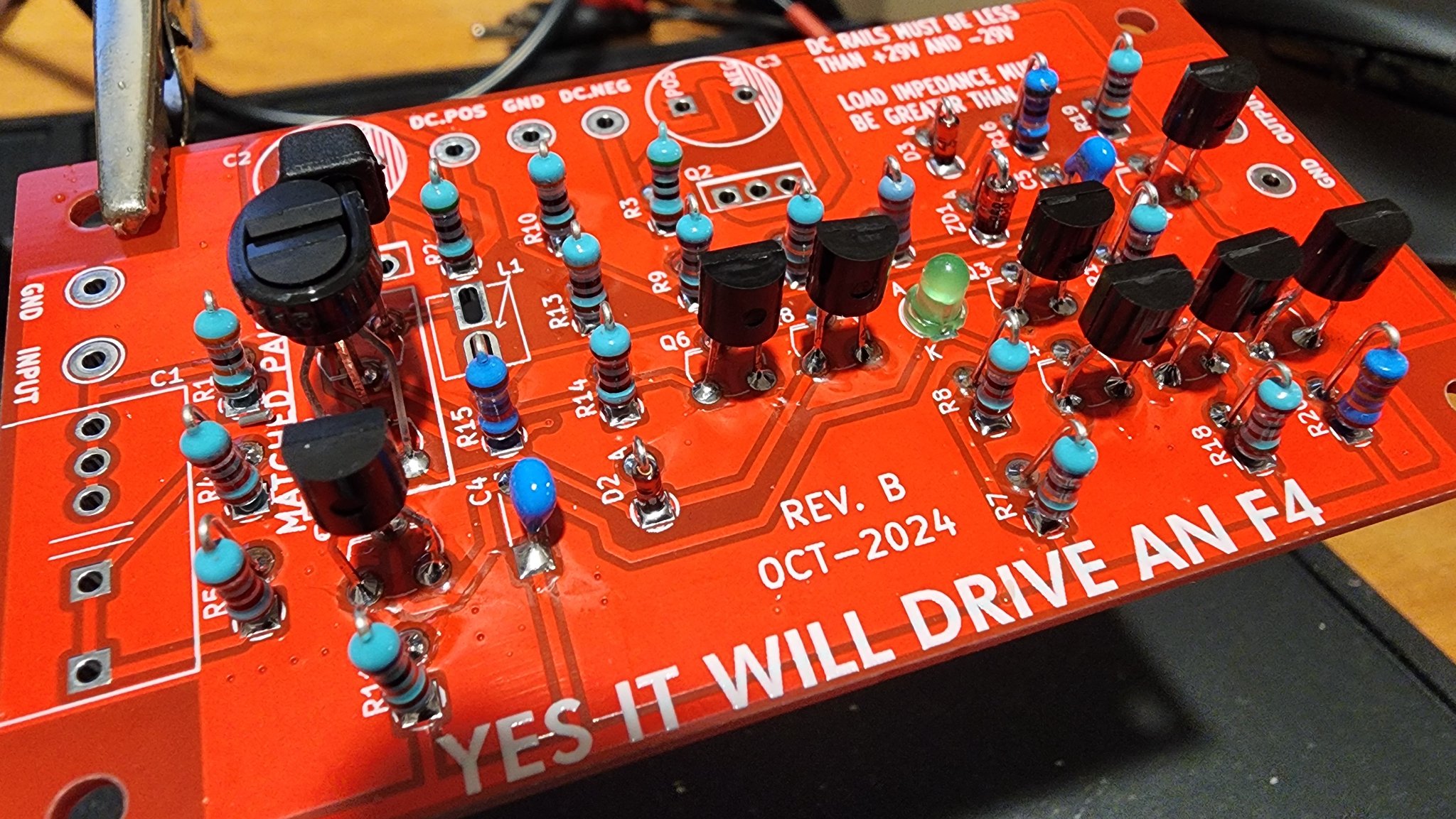

Cleaned up the board further using 99% IsoP and the heat gun technique. Also added Arctic MX-4 thermal grease between the Q5 & Q9 matched BC546C BJTs.
Thanks to @Mark Johnson , @william2001 , and @poseidonsvoice for the guidance!

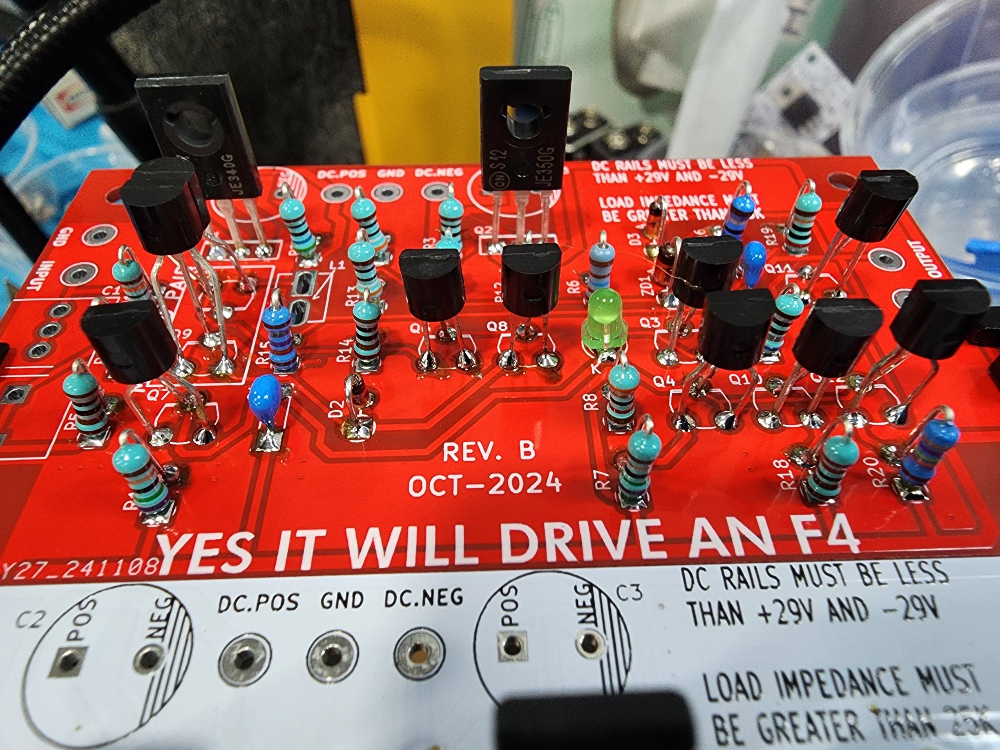

I got my "Yes It Will Drive An F4" boards all populated and ready to install this weekend in my dual mono F4.
I'm posting pics before and after cleaning (99% IsoP with a cheap sonic toothbrush) to see if anyone notices an error before they go into the amp.
I was able to get really good matching of the BC546C pairs using a meticulous matching method (sub 0.1mV!!!) I will share as a "how to" video in the future. I will zip tie the matched pairs together before install.
I'll use DBT for first power up and then variac as a backup mitigation.
Thanks in advance for the keen eyes of the hive diyaudio mind.

Red and White... Right and Left. Yikes... when asked I just requested both blue.
NOTE: the picture above with the boards built into the F4 has them backwards? The red board is on the left channel and the white on the right!

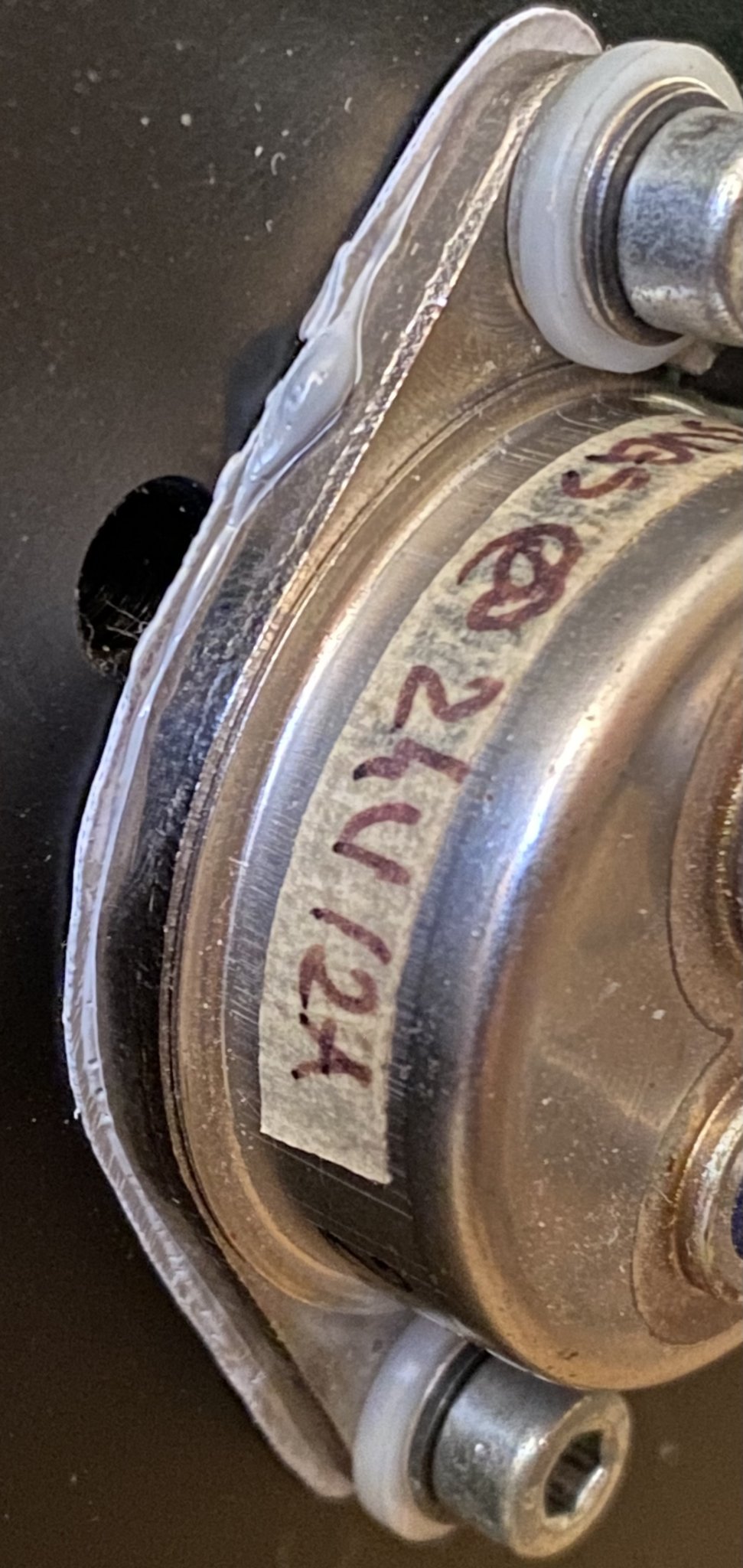

Arctic MX-4
These days I had to up the power dissipation on some sits and it wasn’t working anymore without thermal paste so I added some (exactly like yours) between the sit and its insulator, left it without between insulator and heatsink.
At 75w of dissipation on the sit the capsule was getting at 77C without the grease and now it stays at 63C.
So I can say the MX-4 is quite good.
