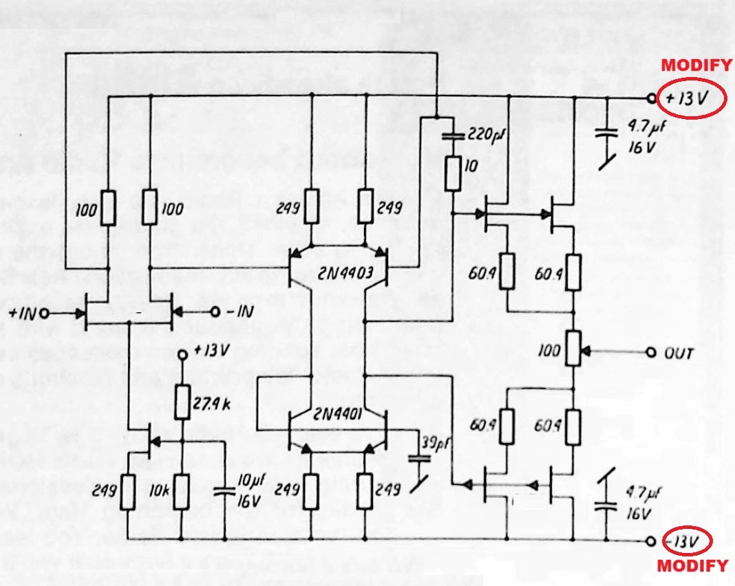

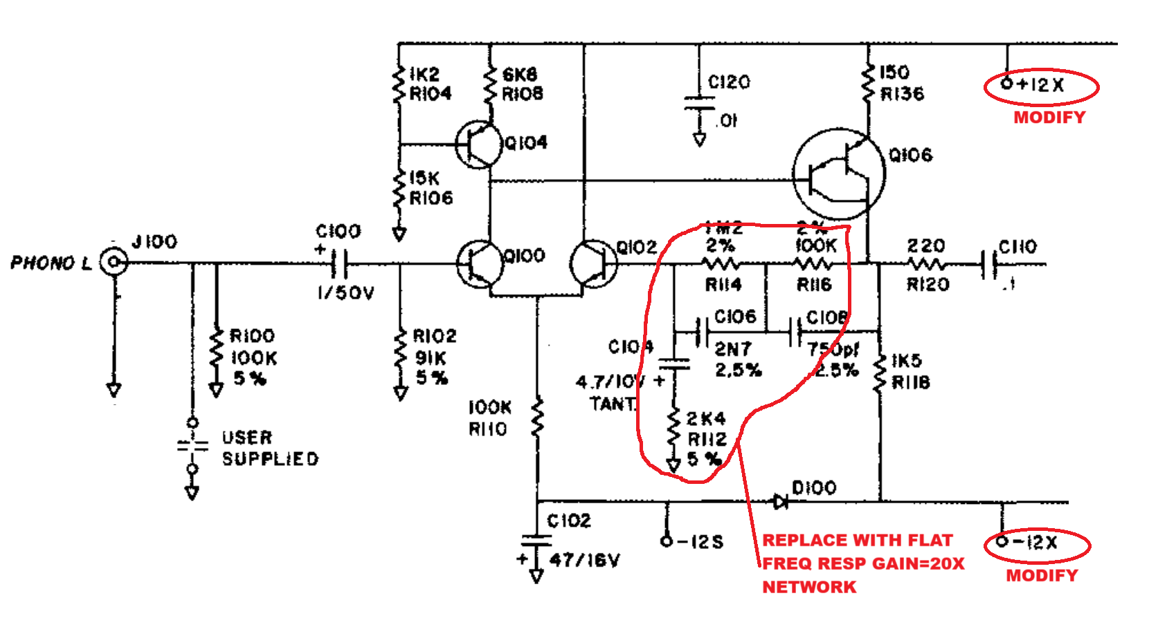

Obviously there are LOTS of different ways to drive an F4 power amp from a 50mm X 90mm piggy backed PCB; the one in this thread is just the design I happened to show at Burning Amp 2024. All you need to do is devise a way to amplify the input signal and make it swing the front end's output at least ±20V (peak), using ±23V power supplies. Do that and you have succeeded.
Here are a few; I'm sure diyAudio members can think of several more. These are NOT finished and complete, polished circuits ready for immediate implementation; instead, they are preliminary ideas to be explored by ambitious and talented DIYers

* Adapt Tomlinson Holman's famous "Advent Receiver Phono Stage" to ±23V power supplies and rip out all the RIAA frequency equalizer stuff; make it a flat frequency response amp. See attached image below
* Adapt John Curl's extremely famous "Levinson JC-2 discrete opamp" to ±23V power supplies, image below. See whether you can get it to swing the output at least ±20V (peak)
