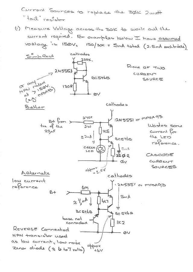

More complex mods:
Make up a little "matrix" board with a cascode transistor current source (or ring of two transistor current source) to replace the 30K/2W tail resistor in the driver stage and make the 2 anode loads the same - both 47K would be good.
Use separate cathode bias resistors and bypass caps for each 5881.
Ian [/B]
Hi Ian, can you explain more of the above? Is there any schematics? Thanks.
Did'nt have time to do much but have scribbled some current sources on a piece of paper which would suit.
Ian

The NPN transistors I've labelled as BC546B can be any general purpose NPN transistor. There are no special voltage or current requirements. If you are buying 2N5551 or MPSA93 anyway just use them in both places in the circuits.
Ian
