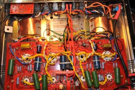

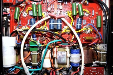

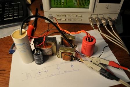

I forgot to mention another two changes:
8. I have shielded the output transformers with copper foil
9. I have changed the way filament are connected using a star topology because I've noticed an important loss of voltage on the provided yellow wires. Now all filaments are around 6.3V AC.
10. Here are some pictures:

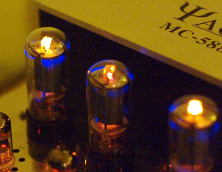

I just bought 6L6GC = 6P3S tubes from ebay to replace the 5881A that is provided with the Yaqin 5881A amplifier.
Now I get a blue cloud at the top of the new output tubes I bought. Is this bad for the tube life?
Drtails: I have ensured that the heater voltage is 6.2 AC volts. And Vb to be 360V. The current is 30 mA per tube (10 W anode) and the tube is changed from ultra-lineair to pseudo triode. The 5881 did not give the blue color.
Any suggestions what I should do, anyone?
Just listen to some music 🙂
Or you may be able to point your finger at the tubes and play with the fluorescent blue glow.
This dark blue glow is normal in some makes of tubes.
SveinB
It looks to me that you are fortunate enough to have another visual effect added to the initial one, "magic eyes"... 🙂
I've tried 6P3C-E (military grade and shorter than 6P3C) and worked like a charm with no blue effect.
Thanks for your responses.
Salas, your link is very good to understand the problem. My concerns have gone now!🙂
Interesting is that I have Shuguang 300B tubes too that have blue glass (and I have always suspected the manufacturer to make it blue to avoid seeing such a glow!).
SveinB, the tubes sound like a marvel. Details, crispness, low stage sound.
They measure very well on my test bench too. I had them in my tubetester, all four I bought have the same transconductance like 2100-2150.
All four had this out of the box, so it seems normal for the make.
I had this also on 6550 tubes in the past in another amplifier, and reduced the anode current (fixed bias) until the colour disappeared; but in this amplifier I have auto bias, hard to play around with.

My friend told me, there are some amps made to have blue glow and that should be no problem for lifetime expectations of tubes.
Blue Glow in Tubes, Tube Getters, and other Tube Info
