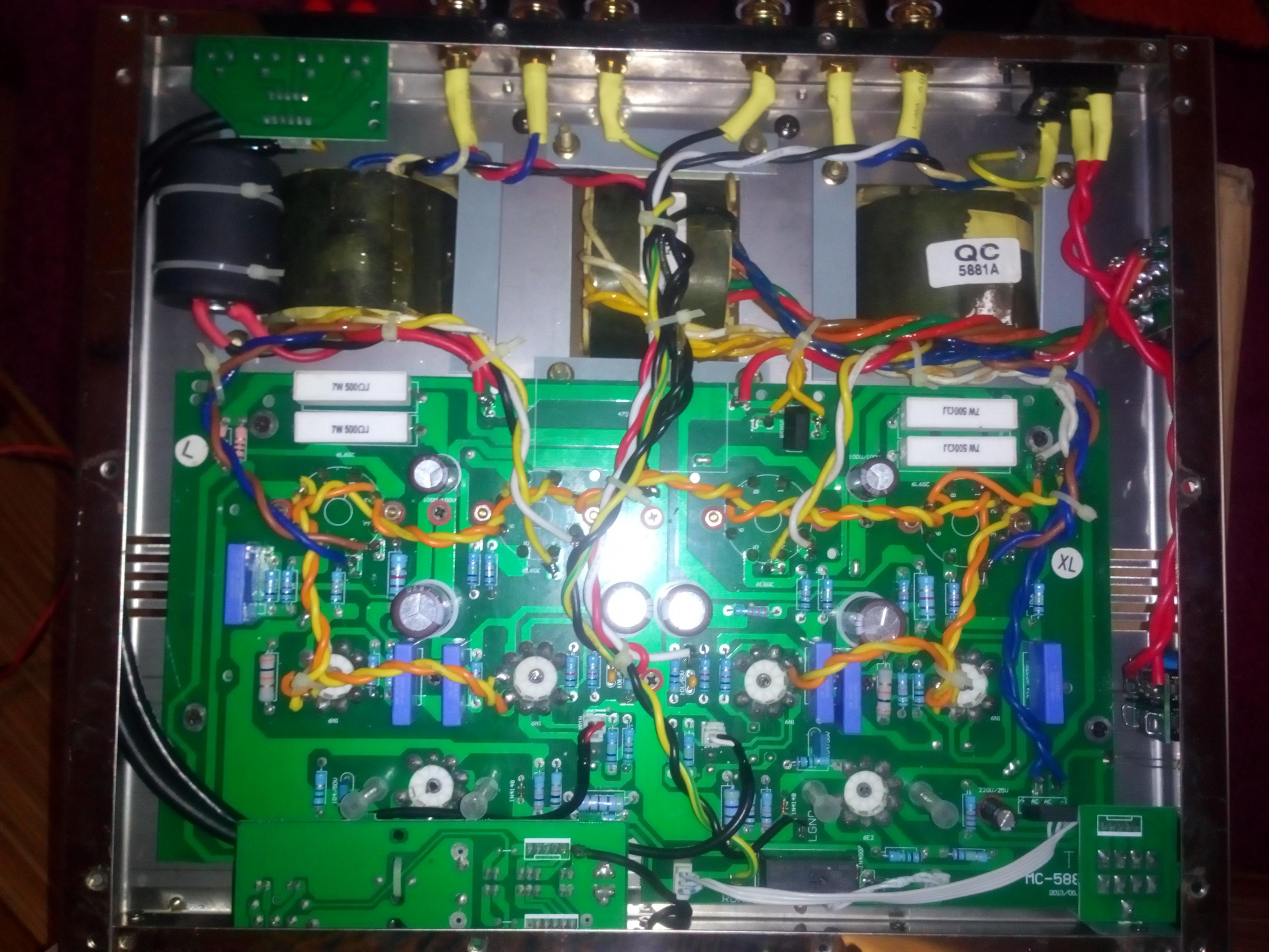

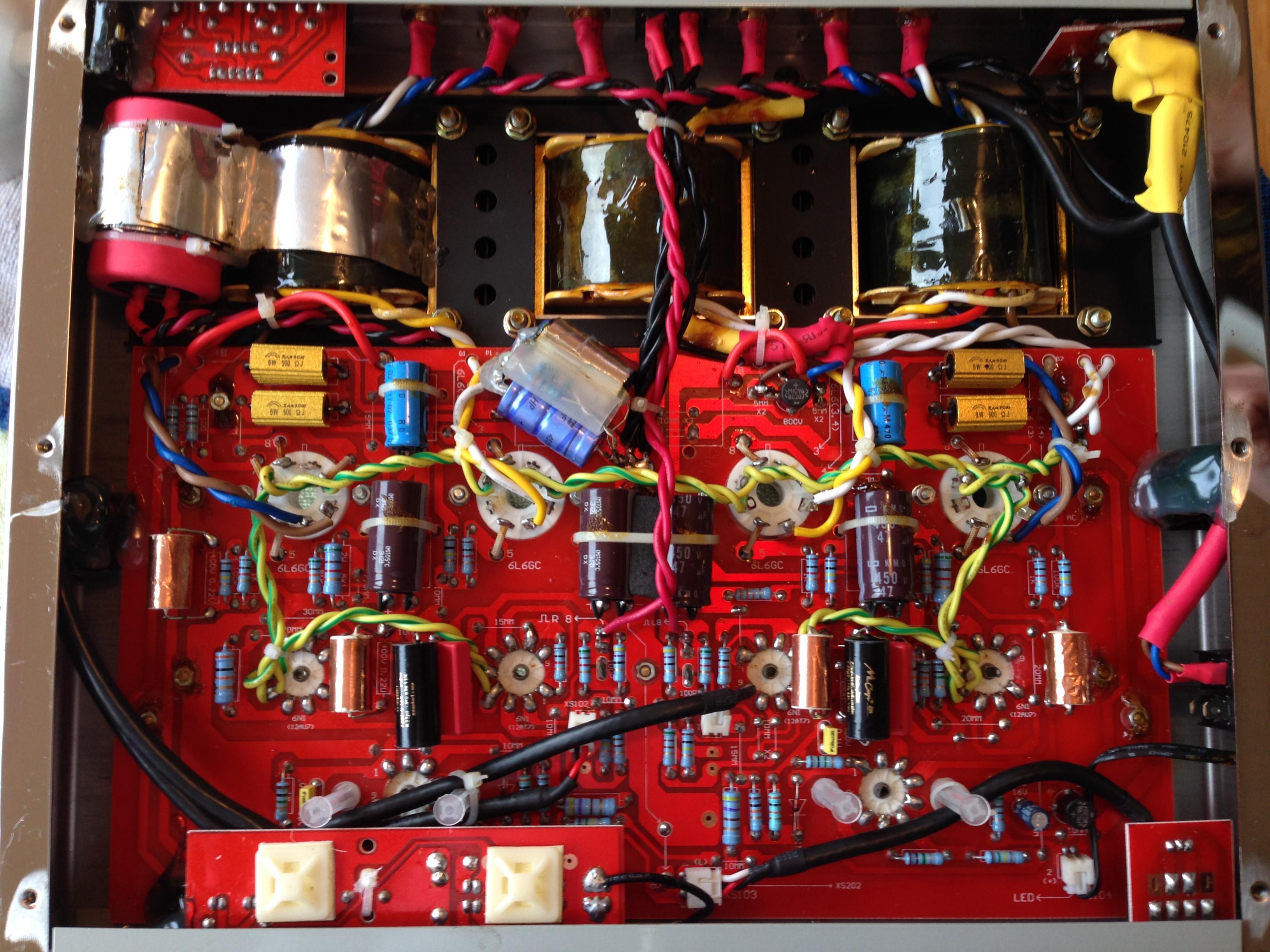

Here are some improvements I received via Ballad Audio.
Yaquin 5881
Sir i have this tube amp that is oveheating and i read your revision on it and i want it to apply in my 5881 amp if you dont mind sharing it in diagram(drawing) im new in troubleshooting amplifier and just want to calm it. Thanks junb
I realise this is an old thread, but I just purchased one of these. They must have changed the design somewhat as there is no sign of hum or hiss even at high volume. This was tested with my DUNE HD Smart H1 connected and with nothing connected. The valves heaters do look like they a running a bit hot, so maybe they are still a bit over voltage, I'll check at the weekend. Overall I'm pleased with the way it performs for the price, but although it has less power, I still think I prefer the sound from my Lafayette LA-224B with its Russian gold grid quad set. I'm not going to use it again until I have checked the heater voltage. When I do I will take some pics to compare the build to those already posted.
Question:
When testing transformer heater voltage output, do you test it with all the valves in or out? I ask because pulling one of the 6E2 magic eye tubes and testing pins 4 & 5 only shows 2.9V with all the other valves in place, despite this low reading all the valves glow somewhat brighter than they do in my Lafayette LA-224B and the amp seems to work okay.
As I'm not working today, I decided to investigate further. On removing the bottom cover it became clear that the 6E2 valve heaters were fed from the PCB not directly from the transformer as the other valves are. That low voltage may be by design for some reason. On removing the valve guard and pulling one of the 6N1 valves, I got 6.94V which is just about 10% over, should I try to bring this down to 6.3?
The first difference I noticed to the O/P picture is the change in the valve guard design. Looking inside, they have changed the orientation of the centre transformer by 90 degrees and added stiffeners. They have also done away with (though still mentioned in the manual) the Speaker/Headphone changeover switch. The Output valve bases now mount above the board not through it as before. There is also a 110/240V changeover switch, I'm not sure if this was in the original design?

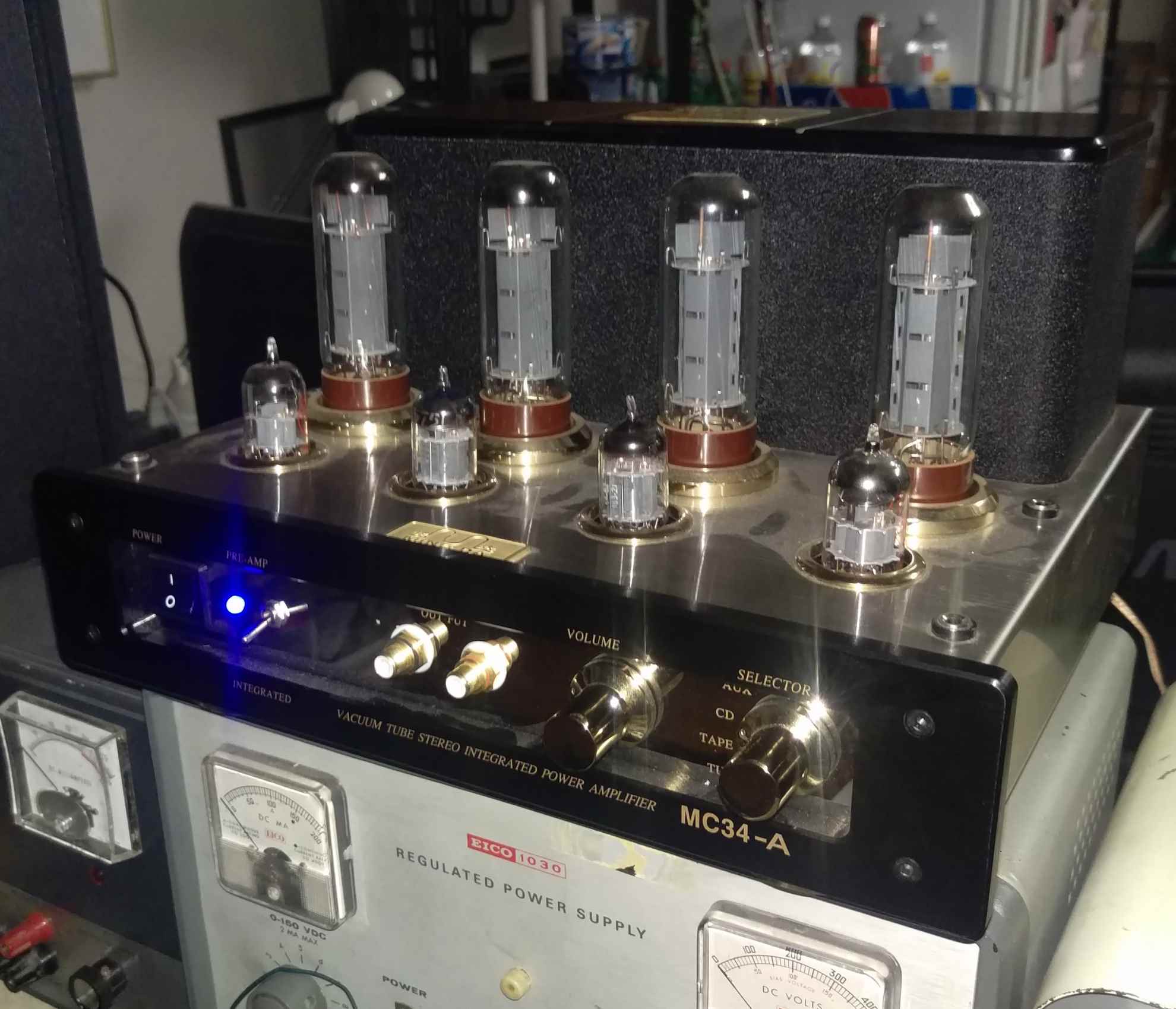

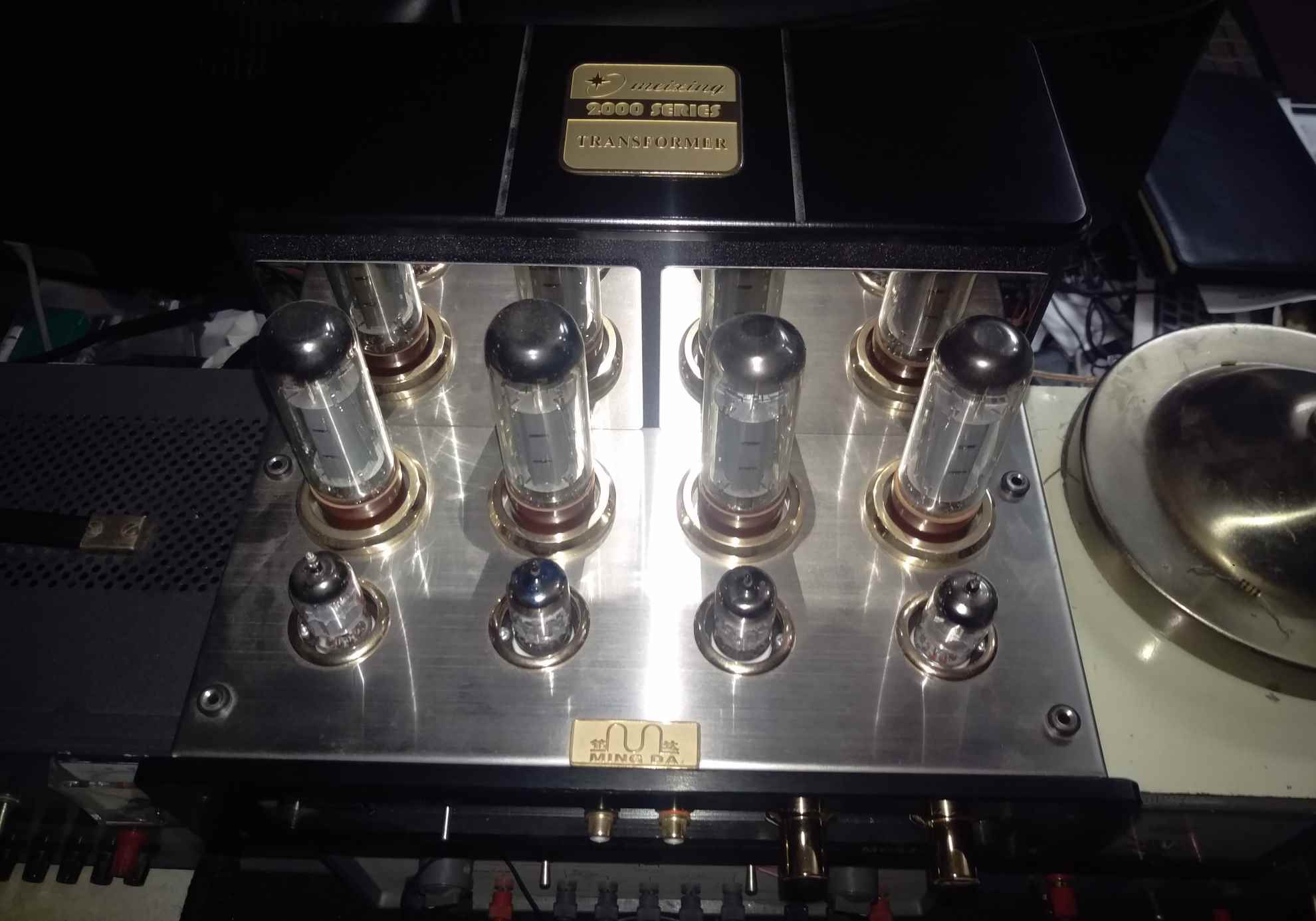

Transformer Cover Overheating
For what it is worth I have a Mingda MC34-A that has a physical layout similar to the Yaqin.
The transformer covers would get too hot to touch. I too assumed that it was a problem with the transformers or circuitry.
I contacted Anatoliy (Wavebourn) and he told me the tubes were too close to the covers. I put a fan on the side of the amp, turned it on, let it run for an hour and the transformer covers were cool to the touch.
He told me to put stainless steel mirrors between the tubes and the covers. I got the mirrors from Amazon and fixed them to the covers using 1/4 inch thick cork rounds.
That solved the heating problem. The mirrors get too hot to touch and the transformer covers remain cool to the touch even after many hours of operation.

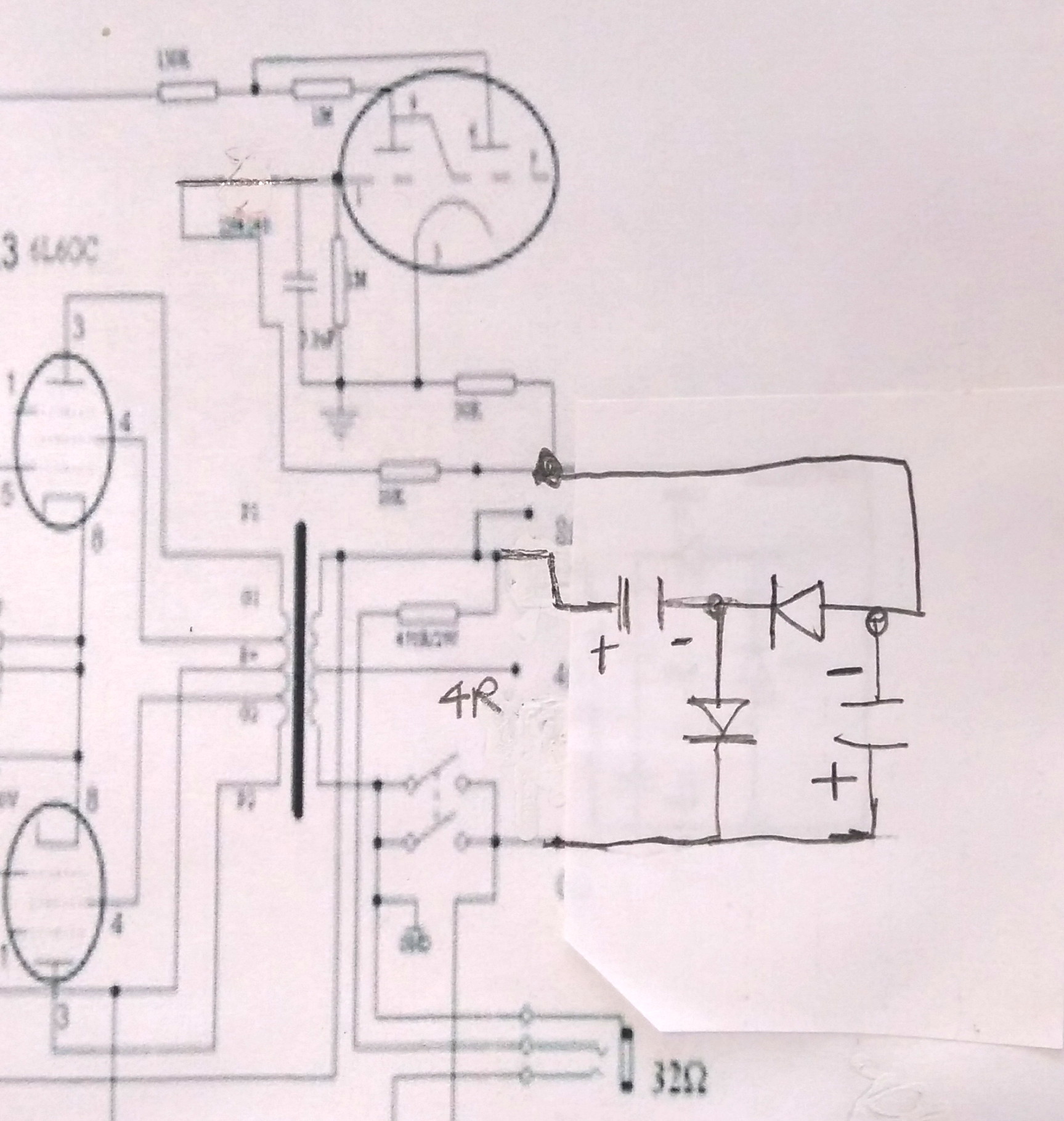

I am trying to make the two 6E2 level indicator valves work at a lower volume output by adding a voltage doubler.
Can anyone tell me if this should work, also is the location I have placed them correct? I have attached the original and modified schematic for comparison.
