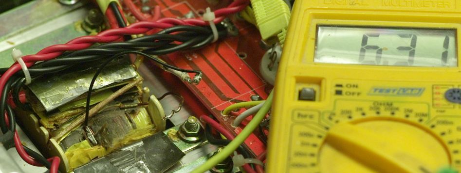

and the picture
You can see the heater supply,
I scraped the isolation over 1 cm. for soldering
- I did not cut the wire, which is a good option too.
The result is: the amplifier does not get hot even after some 5 hours of running[/]
This repair objective was thus very good.

Hi Triode Al
I am impressed with your results on the modification to the power transformer. I have a few questions before I attempt the mod since the power transformer on my amp is overheating.
1) Is the mod easy to do?
2) Does the power transformer still run hot
3) Do you re-seal the tranformer after the mod, or leave the it open without the isolation?
Cheers Bing
Cheers Bing
bbbing said:Hi Triode Al
Cheers Bing
Dear Bing,
It is easy, though you need a sharp knife and scissor. The paper of the isolation has to becut, it is very good isolation paper, several layers exist and it takes quite some time before you have gotten through to the windings.
The last winding in the outer layer (see my picture) is 7,3 volt, and each winding takes off 0,455 volt AC, fully operational. So the third winding is the one I tapped by
- 1 first moving the windings apart (at least a half a mm apart, using a screwdriver)
- 2 Lifting it a bit (screwdriver again,)
- 3 scraping the isolation and soldering a new output wire
- - note that you could cut it and be ready too
Afterwards the heating of the transformer is very much reduced. Still after hours the housing is warm. I think of a slitted opening on the housing: on the back there are these small slits for ventilation, but there is no way i can go. An extra slit could be made on that housing cust below the top alu plate to let the air out again: that might be enough to reduce it.
Anyway, reducing the heater voltage from 7.3 to 6.3 volt already reduces the heat: the power reduces from somewhere around 125 watt to maybe 60 watt (in the suggested class A triaode configuration).
But really, it is a no-brainer, no problem. It saves many tubes too.
albert

5. I have replaced the signal capacitors with Russian paper in oil 0.22uF/ 500V. After this change first word coming to my mind was “silk”.
6. I have added a 6A/380V relay to high voltage branch for delay purposes.
7. I have replaced the rectifier bridge with BYT54M avalanche diodes (thanks Dietmar!)
These diodes are 300 times faster than 1N4007.
I won’t say it’s easy, but the result is high-end, not bad at all for 180 Euros I’ve paid.
Have fun, take care, enjoy life and don’t forget any (mili)second that you’re playing with lethal voltages!
Dorin
This is my tribute to a beautifully made amplifier.
I’ve bought this machine from eBay for 30 Euros about three years ago and the transport from China put me back another 150 Euros. I was very happy when I received it in one piece. Playing this amp at half of the volume doesn’t sound so bad but it’s still far from what you can get. This amp has a very poor power supply, unfortunately. In fact, that single capacitor pollutes so badly the entire system with 4V ripple, which is far from sinusoidal having filthy harmonics.
Another major flaw is the position of the main transformer, aligned with the output transformers. This induces the noise that you can’t get rid of it, no matter how many capacitors and chokes you add.
So, what I did? Here’s the list of improvements:
1. I had the main transformer rewound conservatively for 230V, period. You deserve better than messing around with the resistors which will emit heat and will not correct the nasty ripple (thanks Radu!)
2. I have lifted the main transformer 90 degrees. In fact I tried 3 toroids before and with all of them I had noise and excessive heat. The new main transformer, double shielded, is sitting now on plastic, does not make contact with the metal. You have this way enough room to add chokes and capacitors.
3. I have added 3 chokes and 2 capacitors in the power supply. The initial capacitor remained in the “first line of fire” because it has a 125 degrees Celsius written on it (don’t know if it’s truth or not). Then I’ve added 1.7H choke, 330uF capacitor, another 2 chokes of 0.4H and the final capacitor which is a 20uF motor-run polypropylene having 25V/us. Now I have about 5mV SINUSOIDAL ripple on 5881 tubes, good enough for single-ended designs. I’ve added also polypropylenes in driver section.
4. I have modified the reaction with 3k3 resistor and 325pF mica capacitor, using coaxial cable to transport the signal.
Dorin
