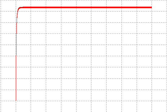

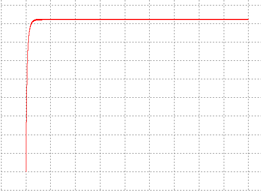

Right, after some fiddling with the grounds I discovered that most of the noise is coming from the input select and volume module. When this is disconnected from earth - it pretty much shuts up. You can see in the picture that there is (was) a wire soldered to this module and screwed to the chassis, but it is also earthed through the bodies of the switch and pot where they physically touch the chassis.
If you look at the scope pic with the earth connected:
...and without:
..you'll see the difference. There is still some noise (as shown in the pic!) but a LOT less.
I think I'll try it like this for a while and consider the other mods as a next step. Overall it really doens't sound bad and now runs much cooler. It's interesting that the manufacturers specifically earthed this if it creates this problem.
Thanks for all the help!

Bravo Dan! They have created a loop within the GND circuit and you have broken it. If you try breaking with a resistor in other places like the one I mentioned earlier, you may probably kill hum even more. But you don't run extra sensitive speakers so maybe its futile. I am happy that we did a fruitful step by step problem solving with no back and forth. Well worthed the effort.

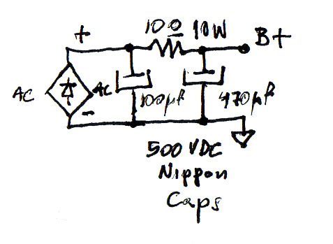

Another idea is to use an extra 100uF 450V cap before the 470uF that is already there, and link them with a 10R 10W. CRC will cut somehow on your PSU ripple, and you will lose just 10V B+. A no space for 2 good chokes situation can benefit somehow from the CRC alternative suggestion. Appreciably better than the single cap you have there now. [/B]
I'm unsure of the layout you mean. You obviously want the caps in parallel but can you draw the circuit with the resistor in so it makes sense to me?
Thanks again...
In the attached scan you can see what I meant, graphically.
I spec the caps for 500VDC since you have a 'wild' secondary on British mains. Nippon Chemicon caps are obtainable, logically priced, reliable, and will sound better anyway than the soon to dry from over voltage stock one in your amp.

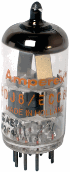

Hello again. My suggestion for output valves would be =C= 6L6Gs. I would be skeptical about substituting the stock Sino 6N1s with just any 6922 because 6N1s are generally smoother. I would discard the blocky gray coupling caps and put Auricaps. I would tweak the PSU to the CRC suggestion I made earlier, discarding the stock cap. I would use Nippon or even better, RIFA. (The initial additional hum, is the sound of the only PSU cap roaring with ripple as it charges). If I could fit it somehow, I would use a choke! CLC instead of CRC. L in the position of the R element in the schematic I posted above. I would trace the GND layout and try to break the ground loops with resistors. Last but not least, I would smack the living daylights out of those luna park 6E2s! 😀
P.S. I attach a picture of the best valves you can use for drivers. Amperex 6DJ8-ECC88. Since 4 of them NOS are going to cost more than the amp itself, just keep em in mind in case you bump on them in some used old circuit or get them for peanuts from some non audiophile ex TV service old man.
