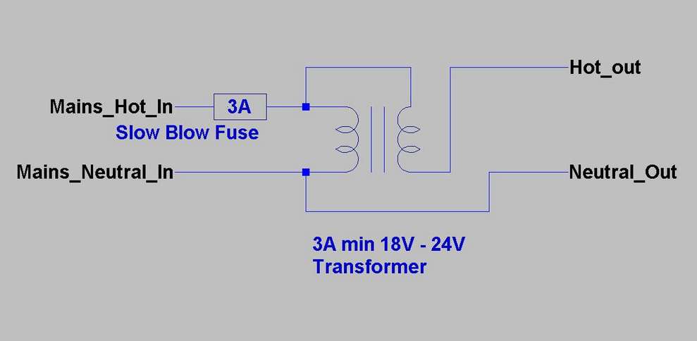

One other thing you might consider since this thing has a 220V power transformer is to use a small external transformer to buck the mains voltage. You have a 50% chance of phasing it correctly to buck the mains voltage the first time around, if it is boosted just reverse either (not both) the primary or secondary - whichever is easiest.
Mount the transformer and mains socket in a small metal box.
Ground the box through the mains cordset, and also connect mains socket ground connection to safety ground on your cordset. Install a 3A (or whatever the transformer is rated for) fuse in the fuse holder in the mains plug.
This or a variac will greatly reduce the losses in the amplifier's power transformer core which at ~10% high line probably have the transformer approaching saturation. Should you be in an area of the British Isles where mains voltages approach 250V this could be a real problem. (Harmonization indicates 230V, but I have heard that it can still be much higher in parts of the UK.)
Note that you can also use a transformer with taps and switch between them to get a closer match. (24VCT gives you both 12V and 24V bucking.)
If you choose a mechanically quiet transformer for the "buck box" you won't even know it is there, far quieter in a lot of instances than the typical variac, and if acquired ex stock, far cheaper too.
One other thought if the power transformer in this amp is approaching core saturation due to load and a high mains voltage it may be spewing harmonics in its magnetic field all over the amplifier. It may quiet down significantly..
See the schematic below:
Thanks for the suggestion Kevin. I have just picked up a variac in need of some repair and once done I can test on a lower voltage.
