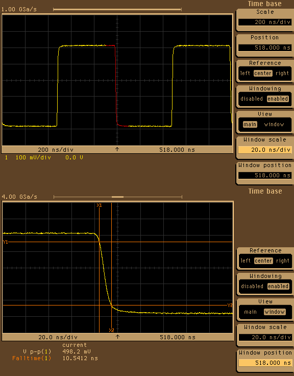

Slew rate
I was finally able, using my digital scope, to capture the (small signal) slew rate of the YAP 2.1 amp. The amp is non slewing, so it is now obvious that the input RF filter and the output coil is defining the rise/fall times.
I removed the imput cap, the output coil and zobel network and applied a 1MHz signal from a PM5193 50MHz pulse generator, with rise time around 1nS. The 50 ohm impedance output level was about 40mVpp, set to give a 500mVpp output (1MHz is slightly beyond the -3dB point, so the gain was lower than 28dB). A 50ohm resistor was placed at the YAP input to match the cable impedance.
The results are shown in the picture below. Rise and fall times are symmetrical and about 10nS, yelding a small signal slew rate (10% - 90%) of about 400V/uS. Doubling the signal input (not shown) approximately doubles the rise/fall times.

Re: Slew rate
