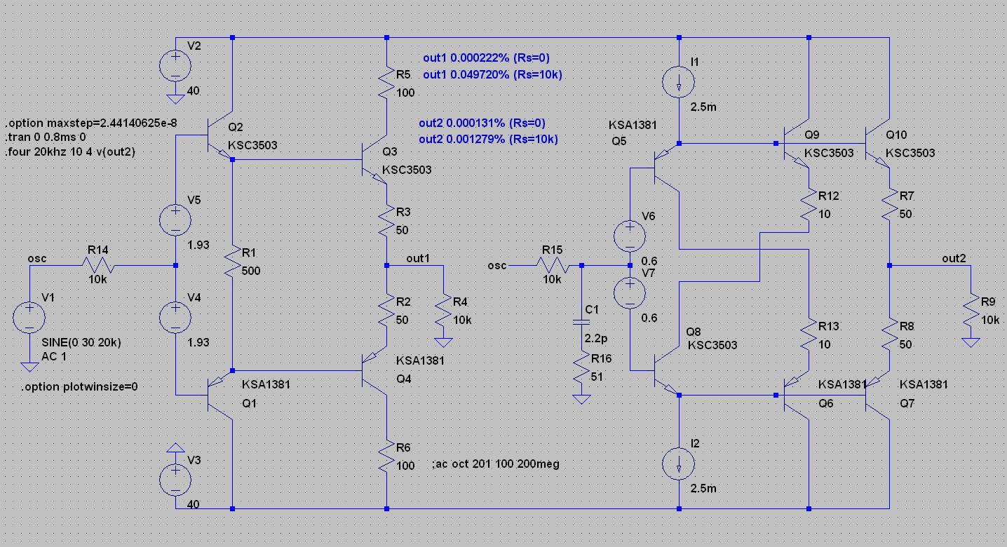

May be it would be interesting. This amp uses Tektronix cascode (about 5-10dB or more better than Hawksford) and the same OPS input stage.
Here is the schematic:

Measured THD 10kHz 25Vp-p 7Ohm with no feedback (top graph):
http://www.vegalab.ru/forum/attachment.php?attachmentid=51265&d=1240574419
Measured THD 1kHz 25Vp-p 7Ohm with no feedback (top graph):
http://www.vegalab.ru/forum/attachment.php?attachmentid=51262&d=1240574364
There are some measurements with no output transistors (Q30-31), but only for 1kHz (about -100dB).

I think it should be ok for not very high feedback-loop unity-gain frequency (depends on type of transistors).This thing seems to be designed having in mind open loop only.
Still doesn’t outperform a basic double EF input stage.
Total Harmonic Distortion: 0.084865%
Total Harmonic Distortion: 0.123628%
Ok Glen, it seems like you need a lesson in simulation and how much you may rely on that.
I did something I rarely do, that is I tried to reproduce your results and get some further conclusions. The schematic is attached. Of course, I am using PSpice, which is different (I guess) to your toy but not that much different in the core to Edmond's toy.
Here are my results. Ro stands for R14=R15 in the schematics.

As you see, my results are completely different to yours. While at Ro=0 both approaches (OUT1 is the double EF, OUT2 is the bootstrap version) are delivering very low THD20 (2.1ppm vs. 1.3ppm), as Ro increases, and as expected, the distortions increase dramatically; at Ro=10kohm it's 57ppm vs. 14ppm while at Ro=100kohm it's 0.53% vs. 0.013%.
This is an expected result, and you would of course notice that the bootstraped version always outperforms the double EF, by a significant margin. Is this true in the real life? I don't have the foggiest idea...
Conclusions?
- I don't know if my results are correct, and I have no intention to further pursue this matter, experimentally of simulation wise.
- What I know is that the THD20 simulation in PSpice is correct and that the 2SA/2SC models are the ones from Fairchild, which seem to be pretty accurate.
- This example confirms and re-confirms that simulation results, at least the way you are using them, are not worth the electrons required to post a message on this forum.
- You would of course notice that I stubbornly refuse to present simulation results, although I simulate my stuff carefully and throughly. Why? Because I refuse to let out something that usually can't be objectively checked and crosschecked by others, see the above example. That's simply because an out-of-the-box comparison of any fairly complex stuff (in particular distortions and nonlinear transient stuff) is usually flat wrong, and those relying on such comparisons are simmy-fools.
- Now, comparing simulations is nowhere easier than comparing and reproducing measurements; simulators have to be tested, compared and calibrated, models have to be crosschecked, common benchmarks have to be defined, etc... I did this in the past as a professional, and trust me, it's hell on earth, no less than a full time job. I would kindly remind you that I used to work with Cadence while they took over the Orcad products. I know pretty well the PSpice code, and if there's anybody around knowing "a little" about Spice and in particular PSpice, that would be yours truly.
These are the reasons why I usually strongly dislike posts like yours. You gave no resoning, no analysis, no attempt to understand the problem(s). Jump in with something like "your input stage is worse because the nonlinear capacitances are exposed to twice the voltage swing, hence more distortions in the large signal response" and we can talk about; but posting a half baked schematic, with little to no connection to the real world, and a bunch of number straight out of the number cruncher, without any crosschecking or analysis, that's something that qualifies simply as.... you guessed... :bs: You successfully delivered a "mine is longer" approach example, that's all.

And seriously, this beauty of yours:
“I don't know if my results are correct, and I have no intention to further pursue this matter, experimentally of simulation wise………..is usually flat wrong, and those relying on such comparisons are simmy-fools.”
besides pretty much negating your whole post, is pretty much summed up by this:
“You gave no resoning, no analysis, no attempt to understand the problem(s).”
Isn't it?

Two simulators, running on the same schematic, using the same models, delivering three orders of magnitude different results.
Double EF: 848ppm vs. 2.1ppm
Bootstrap: 1236ppm vs. 1.1ppm
I couldn't care less what/where is the problem (although I most likely could figure it out), I have better things to do than splicing and dicing the number crunchers, models, parameters, etc... Point is, isolated simulations are not worth a dime and should not be brought alone as arguments in any discussion that pretends to be intelligent.

I've just run my sims again and have had a look at your schematic, and I can see one glaring issue.
However, I’d now like permission to reciprocate your ennui on this topic. Instead I’ve got some new Miles Davis, Cassandra Wilson and Anita Baker CD’s and a pair of Taslima Nasrin novels that I'd prefer to absorb.

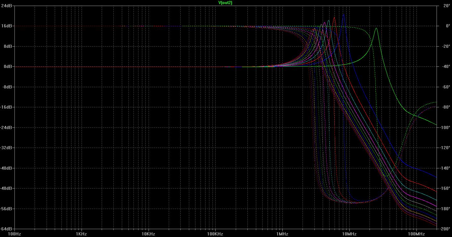

I simmed these buffers in LTSpice and got practically the same figures as syn08 in PSpice.
What is confusing me is the peaking and sharp phase shift when you run AC analysis of bootstrapped buffer from high impedance source. When bootstrapping transistors are removed everything goes fine, but distortion perfomance becomes definitely worse.
Driving bootstrapped buffer from high impedance VAS looks somewhat problematic.

Usually Ccomp capacitor makes the VAS output impedance at high frequencies really low.What is confusing me is the peaking and sharp phase shift when you run AC analysis of bootstrapped buffer from high impedance source. ... Driving bootstrapped buffer from high impedance VAS looks somewhat problematic. ...
That's encouraging. Looks like Glen was looking at the distortion of the collector current of a single device, while syn08 was looking at the output voltage. Due to the complementary design, I'd expect some cancellation of even-order components in the output voltage that wouldn't happen looking at collector current of one device. Also, I'm not sure the collector current AC component in the actual circuit would be as large as the 1.5 mA peak shown in Glen's analysis, since the CFB in the actual circuit is trying to keep that low. Once the subcircuit is taken out of the rest of the design and placed in isolation, it becomes difficult to reproduce what's going on in the larger circuit at the subcircuit level.
I'd expect the output impedance of the VAS to not be too large, due to the local Miller feedback around the VAS.
Edit: Oops, I see Nickolay beat me to it while I was posting.
Hi Andy
I was looking at the collector current instead as this relates to how the input stage/buffer actually operates in a CFB amp.
The 1.5mA peak test current is high, but the distortion ratio between the two circuits is pretty much constant as this is lowered anyway - even at a couple of hundred uA or so (the double EF still wins
What is interesting though, is that at low-level signal currents, the overall linearity of both input stages is surprisingly poor; keeping the voltage input at a fixed amplitude, the linearity gets progressively worse as the current swing is reduced (by increasing the value of the load resistor).
This is obviously because the collector-base current flowing through Ccb is an increasing proportion of the total collector current as the signal current swing is reduced. I hope I've worded that in a comprehensible way
Attached is my *.asc file - have a play.
