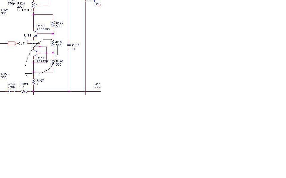

PHEONIX said:I noticed that Q114 on the schematic you posted (YAP 2.1 output) is effectively shorted out e-b-c are all connected to one another on the 2SA1381 is this correct.
Look at first post (below second image):
"Q114 is shorted for 2SK1530/2SJ201 only"

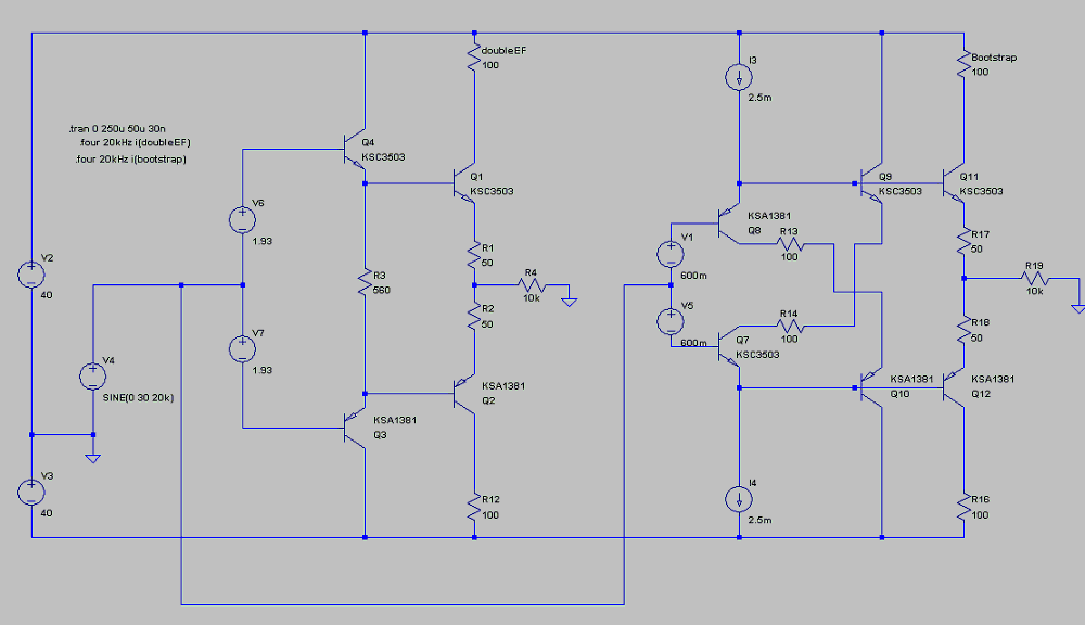

Revisited YAP v2.1
- Improved OPS input stage (following an idea by Andy).
Still doesn’t outperform a basic double EF input stage.
Fourier components of I(doubleef)

Maybe
Now, before into going to further details, try to estimate a) The IPS tempco and b) the impact of the 4 volts lost in the double EF IPS bias circuit.
Maybe
The double EF actually swings closer to the rails as the biasing CCS's are done away with.
With a decent amount of emitter degeneration (1.2V in this case) I don't think that the temperature coefficent is much of an issue; the bias current isn't very critical.

Here's the history of this thing. It began with this post by Edmond in the original YAP thread. He was saying that the nonlinear capacitive load on the VAS by the input stage of the OPS was a significant contributor to the distortion. He proposed a change like the circuit on the right in your schematic above, except that Q9 and Q10 were dispensed with, and the collectors of Q7 and Q8 were connected to the emitters of Q11 and Q12 respectively. I tried this out in the simulator and got some strange results under high-slew conditions (though it looked fine otherwise). I tracked it down to the bootstrapping configuration I just described. The addition of Q9 and Q10 fixed that.
Maybe it just comes down to whether it's an issue of nonlinear input capacitance, or just the need for more current gain. If it's the former, a sim with voltage drive won't show that effect. If it's the latter, it sounds like your circuit would be best. I honestly don't know what the right answer is in the context of this circuit.

About the swing - the current sources need certainly less than 0.7V per leg. Compare to 2V per leg you are spending.
About tempco, if you think the board installed on the heatsink, reaching 80 degrees centigrades before the fans kick in, you won't neglect the IPS tempco even with degeneration.
And now, to the fine things 🙂 Try to feed the two schematics from a relatively high impedance source. Is it still a significant distortion gap between the two approaches?
You've got 600mV + the vbe of the pre-drivers + the voltage headroom for the CCS = more than 2V in your case. Anyway, arguing about this is silly as an extra volt or two here is irrelevant with a little gain in the OPS.
As for the tempo, it's still irrelevant. If the input stage standing current changes 20% or so as the amp reaches operating temperature, so what?
Hi Andy.
I agree, but if I get around to it I'll try to post some further sims later. I've been playing around with this (fancy input stages) a bit for my own CFB OPS build and have been unable to achieve better linearity results (in a complete amp simulation) with anything more complicated than the simple double EF (with the exception of an "Alison buffer" input stage, but the class A-B transition when slewing is a pain to tame).
