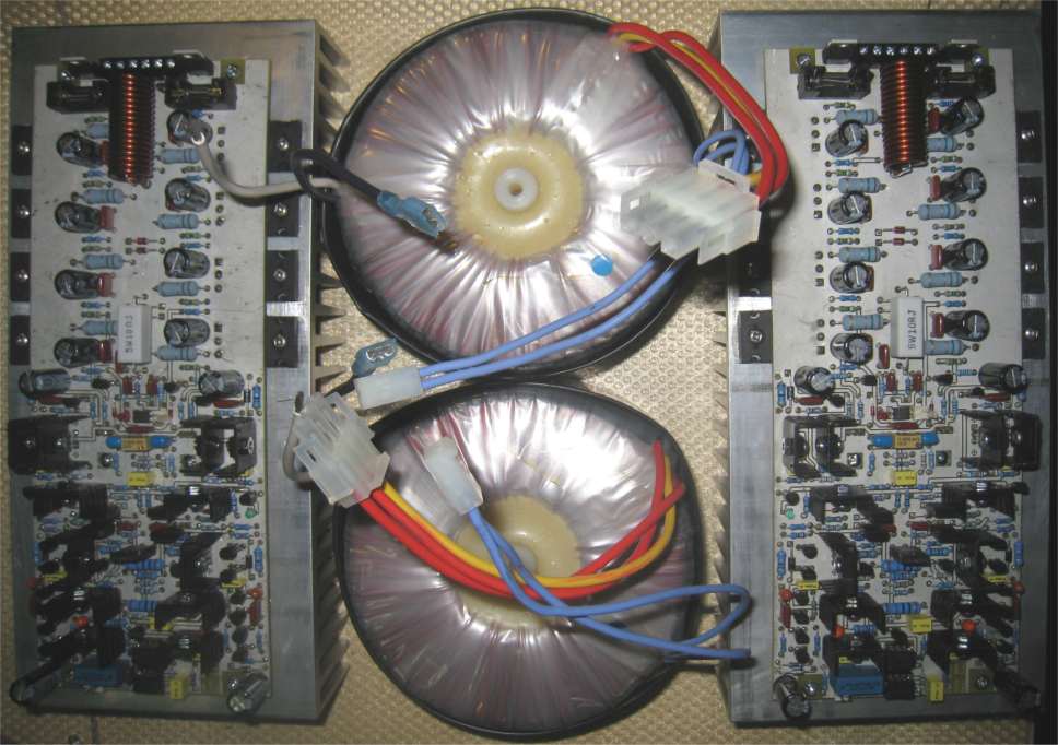

I received today from Plitron two 800W toroids providing +/-80V supplies under full load.
http://www.plitron.com/shopping/specs/508434.pdf
Under this circumstances, there is a small change is required in the OPS posted here:
http://www.diyaudio.com/forums/showthread.php?postid=1883792#post1883792
Q104, Q106, Q122, Q119 (2SC2240/2SA970) have to be replaced with higher breakdown voltage devices. I chosed 2SA1207/2SC2909 with a Vce>160V, but it's still at the very limit. You may want to replace all these with 2SA1381/2SC3503 (or the Fairchild KSA/KSC pair) having Vce>300V. Fortunately all these have the same pinout, so no changes are required in the PCB layout.
If you don't plan to go with such high supplies, and stay with worst case voltages less than +/-60V, 2SC2240/2SA970 with Vce>120V are your best bet.
Other devices like the 2N5551/2N5401 are pretty safe, they'll take easily over 160V.
I can confirm under 25ppm THD20 and IMD 19+20KHz at 600W (for a short time) into 4ohm ( 140Vpp ), mostly 2nd harmonic. Not sure if I'm measuring the amp, though, or some magnetic effect (peak currents through the supply lines are around 18A and average supply current is around 5.8A). Only the final construction will tell.
I will update the schematic to reflect this change.

Re: An update
I see you put only about 400uF on output stage power supply rails. From my experience it is not enough exactly from magnetic fields point of view (even with 4 layers PCB, with very low power planes induction). You should see mainly even harmonics (second of course is strongest).
Also there is no sense to add the small shunt capacitors (C108-C111, C124-C127), because for modern Low-ESR capacitors (for example Panasonic FM) ESL is equal to induction of copper wire with length about distance between capacitor's pins and 1mm in dia (3-7nH). This paralleling sometimes rings on high frequencies (depends on C, ESL, ESR of capacitors).
What really wonders me, it's an output filter coil very close to the output stage. I thought it is a well known problem, that currents from output stage power lines can induce distorted current in it. As I see you take feedback only before the output filter, so these distortions will not be reduce by feedback. Are you sure you measure THD on the load, not in the point before filter ?
PS. Don't you have simulated loop gain and phase frequency responses graphics ?
Best regards, Nick
Hello syn08!Not sure if I'm measuring the amp, though, or some magnetic effect (peak currents through the supply lines are around 18A and average supply current is around 5.8A). Only the final construction will tell.
Best regards, Nick

Re: Re: An update
As I already said, indeed 2nd harmonics are dominant.
The idea of placing the big filter caps on the board was and still can be debated ad nauseam; for certain practical reasons, I am not supporting this solution. Of course it would be nice to resolve all high currents locally, but then how would you place 2 x 50,000uF/100V cans on the PCB? Paralleling 2 x 50 x 1000uF/100V? Those 100uF are only a last defense against potential local instabilities, aka decouplings.
I haven't noticed any ringings and those 100nF caps in parallel is something I always automatically add. They are probably an overkill, but I don't think they'll ever harm.
Yes, the output coil should be placed as much as possible away from the supply lines to avoid any magnetic couplings. I am sure this has a contribution to the increasing THD20 with the output power (reaching 25ppm @ 600W/4ohm). Though, to my experience, placing the output coil away from the OPS output is actually worse. One of the reasons is that the capacity between the load ground return wire (which always runs parallel to the load "hot" wire) loads the amp output before the output coil. Now this can potentially generate some significant ringing. It may not be the case for this amp, but generally I see placing the output coil away from the feedback connection as not a great idea.
I agree that the layout is critical in such an amp. I usually stick with what is known as working for me; I would love to have a chance to further experiment and optimize layouts, however this is a very expensive and time consuming process that I can't afford to go through. And after all, 25ppm at 600W output is something that can be certainly tolerated 😉 And certainly that number will go down after finishing the construction, with short supply wiring, etc...
I have measured the open loop gains for both the output stage loop and the global loop, using both the injection and the reference techiques described in the HP Application Note AN 243-2 and got pretty consistent results in between and with simulations, I'll post the results after cleaning up a little.
Mykola said:I see you put only about 400uF on output stage power supply rails. From my experience it is not enough exactly from magnetic fields point of view (even with 4 layers PCB, with very low power planes induction). You should see mainly even harmonics (second of course is strongest).

'can potentially generate some significant ringing'
I wonder how large might the capacitance between those two wires be. I guess something between 10...100pF. An amplifier that can't handle such a low capacitance and starts ringing is certainly not the most stable amp on earth - to put it mildly.
Anyhow, placing the output coil on the OPS-PCB or in the direct vicinity of other metal objects is not a good idea.
syn08 said:[snip]
[snip]
Re: Re: Re: An update
I think 2 x 4...8 x 4700uF may be enough.Of course it would be nice to resolve all high currents locally, but then how would you place 2 x 50,000uF/100V cans on the PCB? Paralleling 2 x 50 x 1000uF/100V?
I guess it's very unlikely (in appropriate design). But if you like to leave it on OPS-PCB, I think you may consider the idea of putting the output filter in the feedback loop...Now this can potentially generate some significant ringing. It may not be the case for this amp, but generally I see placing the output coil away from the feedback connection as not a great idea.
how about air core toroidal output inductor winding to cut some external field coupling? - still need surrounding air space but it should be less of an antenna than the cylindrical coil
Hi,syn08 said:Two channels on 0.4 C/W heatsinks and two monster toroids going to the 5RU chassis, for 2 x 400W/4ohm.
what is the quiescent power (Pq)?
What is the predicted heatsink temperature (Ts)
