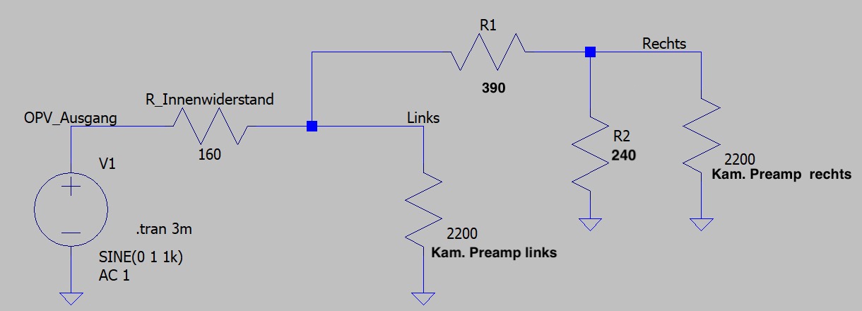

anyway in an adapter box , minus to GND and voltage divider, R1 270ohms R2 160ohms. This adapter box will be always needed
so that I can alternitavely plug in a field mixer. All the best, Salar
That only works for floating balanced outputs, that is, outputs with a high common-mode impedance. My simple two op-amp circuits have a low common-mode output impedance. You are essentially using the positive and shorting the negative output then.

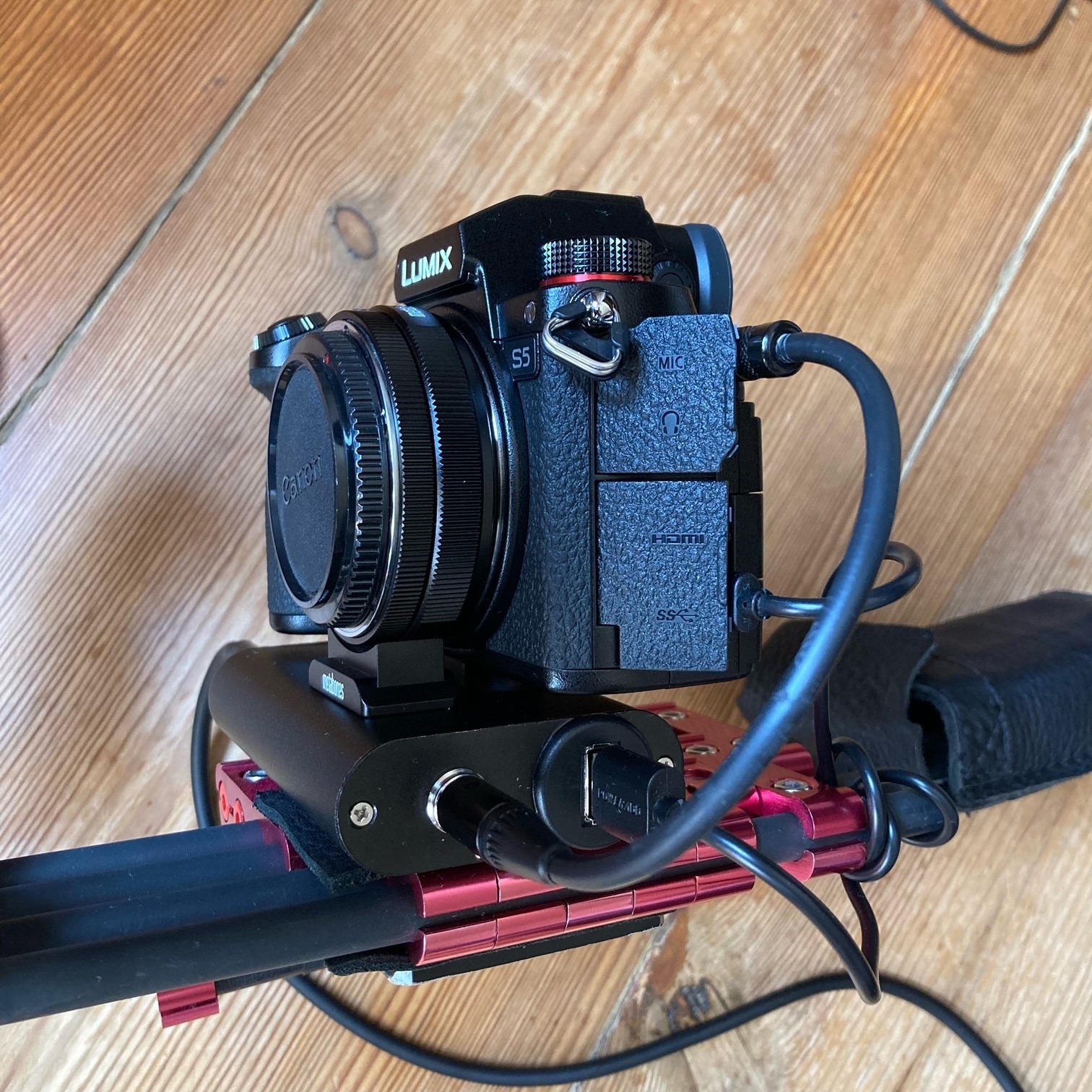

Was that adapter box also in the signal path when you recorded with the MKH-416?
Yes always.
It is fixed beneath the camera and adapts from Mono Balanced XLR / Din to single ended "Stereo",
(3.5mm plug) using the voltage divider to attenuate -9dB on the right channel.
So the right channel acts as safety backup when clipping occurs.

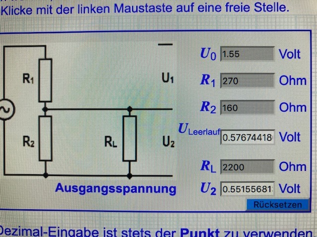

Theoretically 352.0740309 ohm when the voltage divider is loaded with 2200 ohm and there is another 2200 ohm connected to its input. With two 5.4 uF capacitors that are effectively in series, the cut-off frequency should be 167.425797 Hz. With only one channel and no attenuator, you would have had 5.4 uF/2 with 2200 ohm -> 26.79376146 Hz.

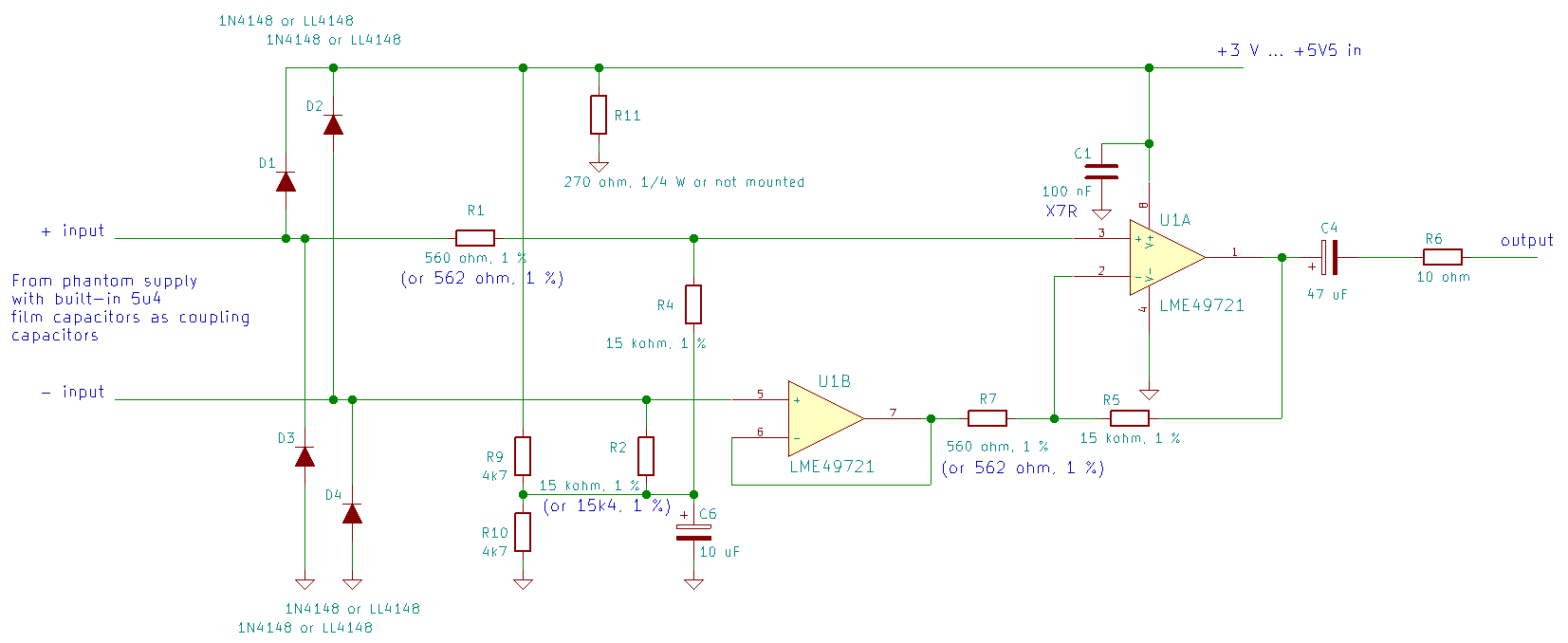

As you already noted, the noise floor of the line input doesn't change much with the gain setting, when you look at it with respect to the maximum level: 1.05 dB left and 1.22 dB right. There is therefore no reason not to record with the +6 dB gain setting when you use the line input.
At maximum gain, the noise of the microphone with the noise of the built-in microphone amplifier subtracted is -61.47 dB(A) - (-81.22 dB(A)) = 19.75 dB above the noise of the line input. 5.87 dB suffices when you want to keep the noise increase due to the line input noise below 1 dB, or 0.02 dB if you are willing to accept a 3 dB increase due to the line input noise.
The setting that you are actually using now (-12 dB), amplifies the microphone's noise to -79.16 dB(A) - (-82.17 dB(A)) = 3.01 dB above the line input noise, meaning that the microphone noise and line input noise together are 1.76 dB above the microphone's noise. Taking this as the criterion when the line input gain is set to maximum, the gain of the microphone amplifier could therefore be reduced by 19.75 dB - 3.01 dB = 16.74 dB. Instead of 45 dB voltage gain (from differential input voltage to single-ended output voltage, 6 dB more when you measure voltages with respect to ground), the gain would then be:
28.26 dB from the differential input voltage to the single-ended output voltage.
This circuit should do. It would be nice if you could increase the impedance of your voltage divider somewhat, that makes it easier to drive for U1A and you can then use a smaller value for C4.

Values of the voltage divider were wrong.Theoretically 352.0740309 ohm when the voltage divider is loaded with 2200 ohm and there is another 2200 ohm connected to its input. With two 5.4 uF capacitors that are effectively in series, the cut-off frequency should be 167.425797 Hz. With only one channel and no attenuator, you would have had 5.4 uF/2 with 2200 ohm -> 26.79376146 Hz.
Anyway, with big electrolytic capacitors you still had bass loss due to the camera.
I did put in 390Ω/240Ω.

Dear Marcel,If it does, you shorted the lower half of the signal source when measuring without transformer, halving the signal. The transformer behaves as a floating source, so then you don't short half the signal.
This is what the adapter box does, when being connected to XLR, see the graphics in post#89.
"R_Innenwiderstand" "160" on the Left is not part of the circuit, it means the output impedance of the field mixer.
So it is the other way round?
The "true" noise level is the MKH416 with floating balanced input, as measured in post#75?

You can adjust the gain by changing R4, R5 and R2. The gain is proportional to R4 = R5. Besides, R2 = R1 + R4 rounded to the nearest standard value.
You could use a ceramic multilayer X5R SMD capacitor for C6, but preferably not for capacitor C4.
6.3 V working voltage is enough, or 5 V if the supply remains below 5 V.

With the indicated values, the gain of the circuit of post #88 is close to 28.26 dB, the gain proposed in post #88.
Regarding leaving out C4: if your camera uses the same connector for line input and microphone input with PiP, chances are it is designed to handle a DC voltage of a few volts. Leaving out C4 will then only lead to a somewhat increased supply current, no other ill effects.

need to buy a new one, so I can start soldering not before Tuesday...
I would like to put 220µF/6.3V or 100uF/16V after the output of LME49721.
Is 220µF overkill? Is 390Ω/240Ω (See post#89) ok for you as voltage divider?
All the best, Salar
