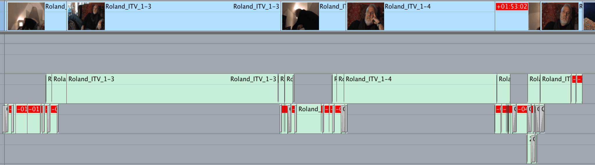

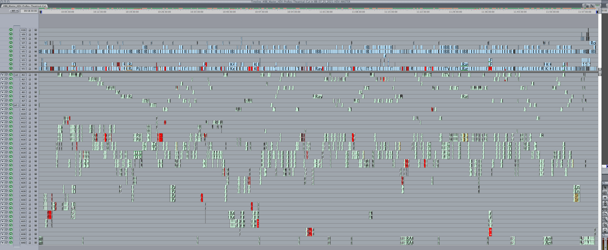

Everyone has this reason. This is the final timeline of the edit my last documentary, prior before mixing, blue is image, green is sound,So you have a reason not related to sound quality why you have to record whispers loudly, the reason being that large level differences are inconvenient for whoever does the editing, and using volume normalization before doing anything else is impossible or inconvenient. Fair enough.
assembled from 130 hours of footage that had to be catalogued, transcripted, etc. Editing took 6 months, mixing about three weeks.
also heavily edited.
When you zoom in, you´ll find sometimes 46 edits in sound but only 7 edits in image, during 136 seconds:
