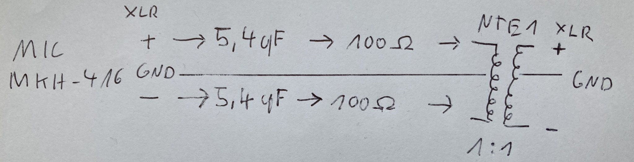

This is how the signal path looks like now*:

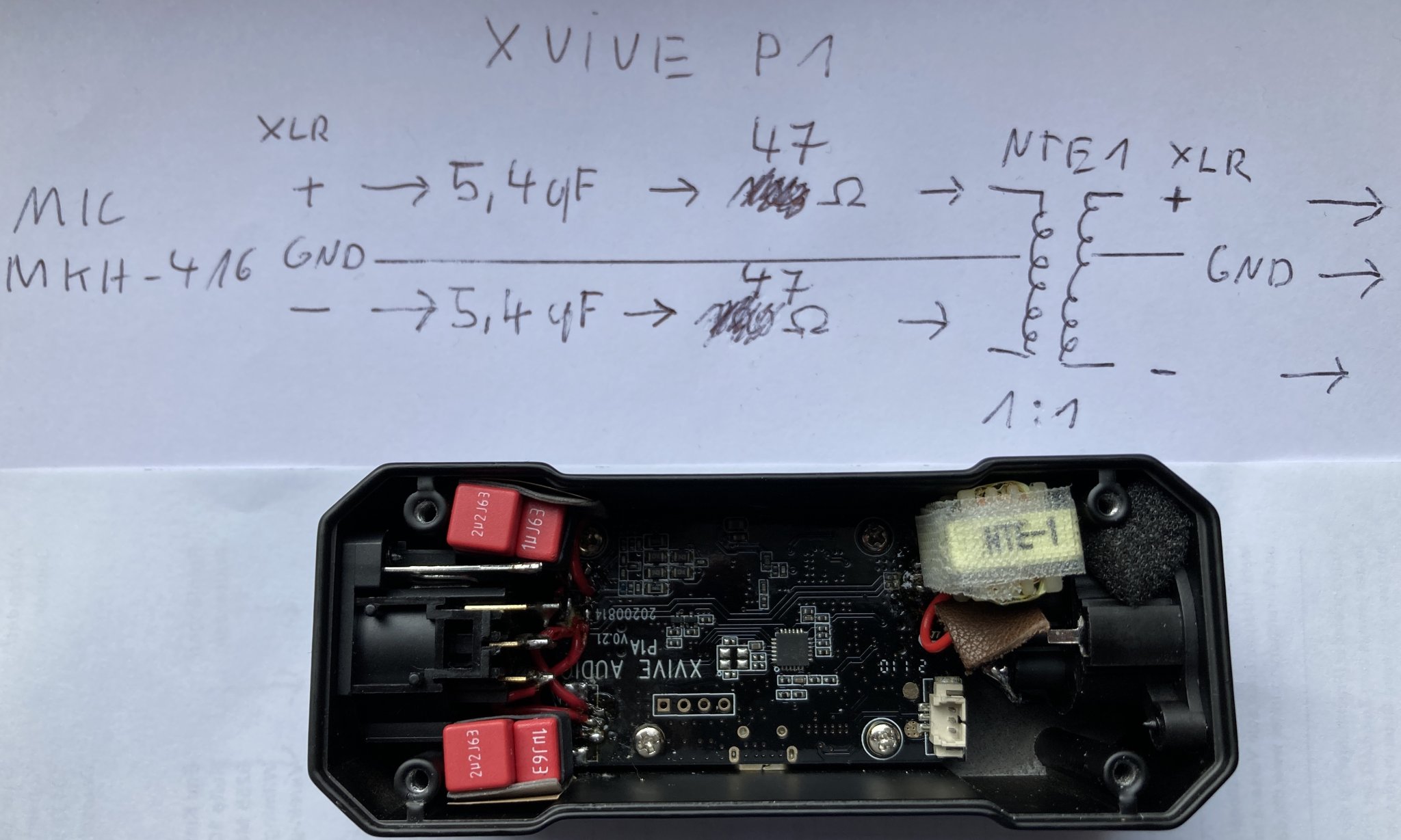

So, the only original parts are the 100ohm resistors. Please compare the drawing to "image1.jpeg" in the first post:
The original capacitors, probably between 0.47µF and 1µF, replaced by 5.4µF, are to be found in the upper right,
above the number 20200814. There are even +/- markings next to them for electrolytics Xvive did not use.
The 100Ω resistors can be found in the lower right, above the right connector. The audio transformer is not on the photo.
*I think I can see on the photo a resistor/capacitor combo to drain noise to ground from the audio lines, but have to check.
I thought consensus was not to omit/short the capacitors and keep DC from the transformer?I think your idea of shorting the capacitors and using the transformer should work fine.

You draw it as if there is a grounded centre tap on each side, but the NTE1 has only four wires.
No, there is no center tap. GND goes straight from one end to the other.
Conversion from balanced to unbalanced happens elsewhere, so that that the modded Xvive can be used in
a balanced setup as well.

For the case with shorted capacitors, the two outputs of the modified Xvive phantom supply circuit should ideally be at the same DC potential, so you would ideally get no DC current through the primary winding. In practice, there will be some DC offset. If that offset is big enough to drive the transformer core close to or into saturation, then you need a capacitor. There is not enough information to calculate if this is the case, but I suspect that the offset is small enough, because schematics where transformers are connected directly to phantom supplied microphones are not unusual.
The two 5.4 uF capacitors are effectively in series in this circuit. To completely block DC current from the transformer primary, it suffices to have a capacitor in one branch and a short in the other. If you put all the capacitors in one branch and a short in the other, you effectively go from 2.7 uF to 10.8 uF.
Checked the signal path again, there do not seem to be resistors to drain the signal to ground.
As far as I understand I should insert some when replacing the Foils with electrolytics.
The resistors in the signal path are not 100Ω but 47Ω.

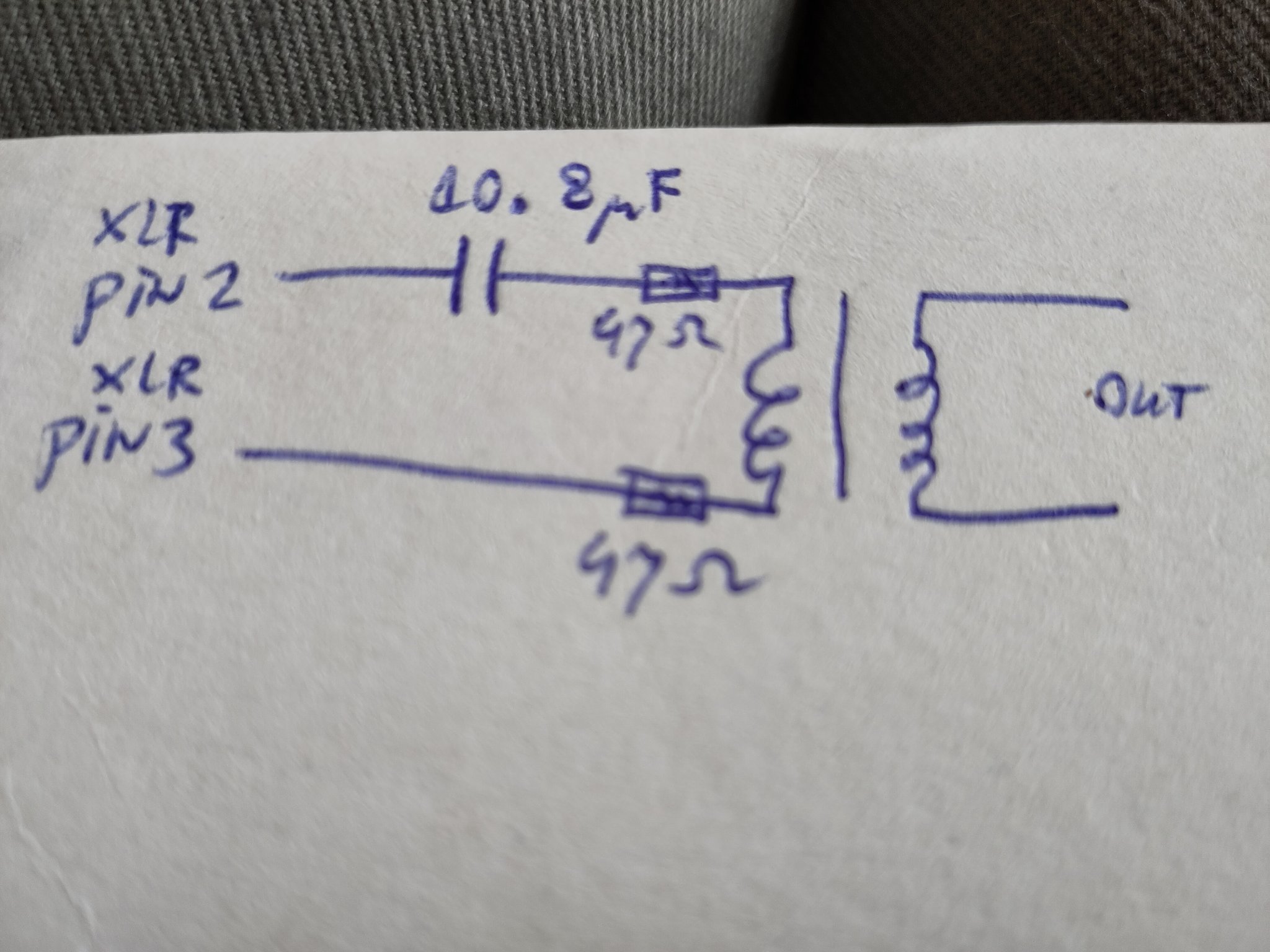

As you might guess, soldering is unnerving. What happens when I put a 10K resistor between the right windings of the NTE-1?
Impedance rises on the left side, correct. But output impedance will be too high for the camera?
I would not bet XVIVE took care of that...For the case with shorted capacitors, the two outputs of the modified Xvive phantom supply circuit should ideally be at the same DC potential, so you would ideally get no DC current through the primary winding.
You mean shorting to ground, not bridging? Like I would run the mic unbalanced?The two 5.4 uF capacitors are effectively in series in this circuit. To completely block DC current from the transformer primary, it suffices to have a capacitor in one branch and a short in the other. If you put all the capacitors in one branch and a short in the other, you effectively go from 2.7 uF to 10.8 uF.
No, I meant shorting the two terminals of one of the capacitors and using all the available film capacitors for the other capacitor. This circuit looks asymmetrical, but it has no DC path through the primary winding of the transformer.
You can also just replace the film capacitors with 47 uF, 63 V electrolytics and leave everything else as is.

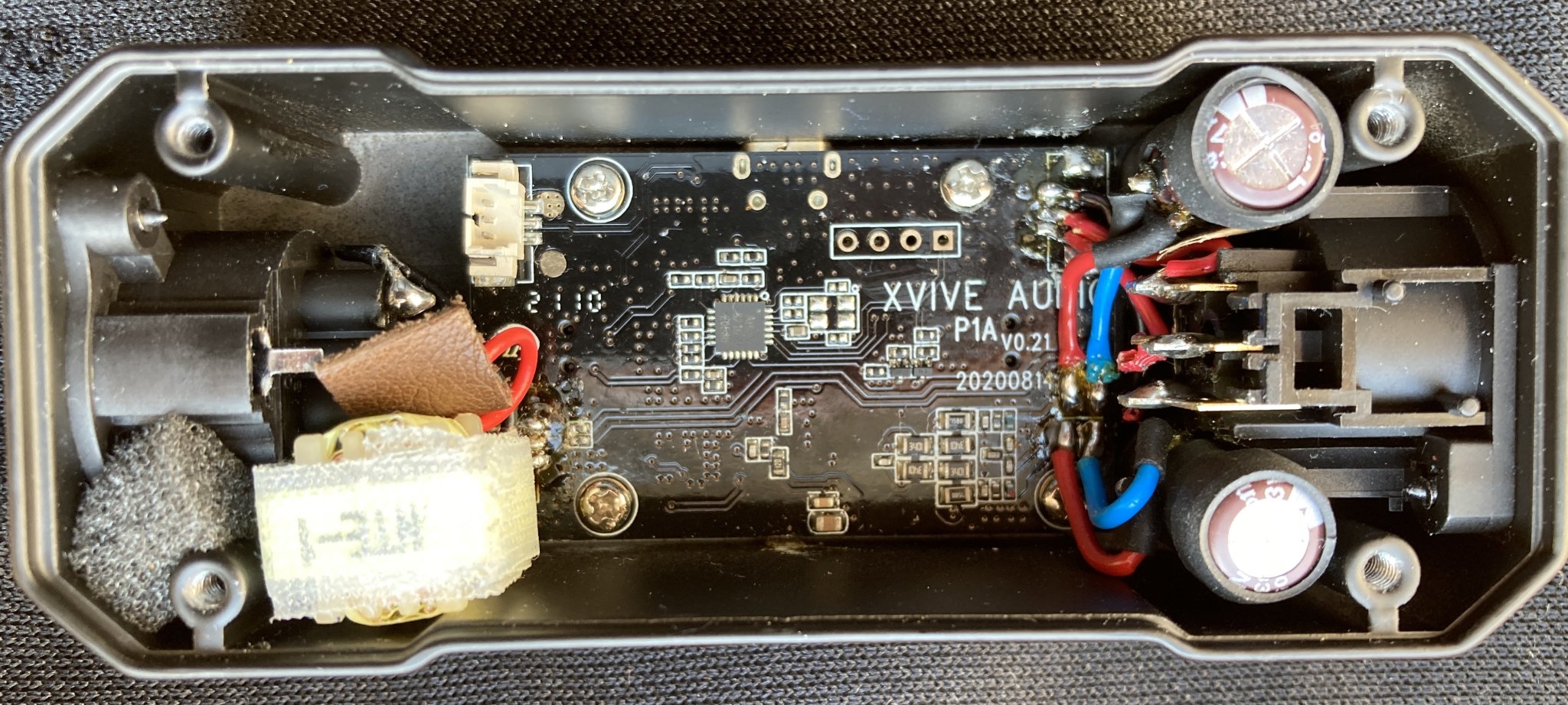

I was able to buy the parts very quickly and already replaced the Wima foils with electrolytics.

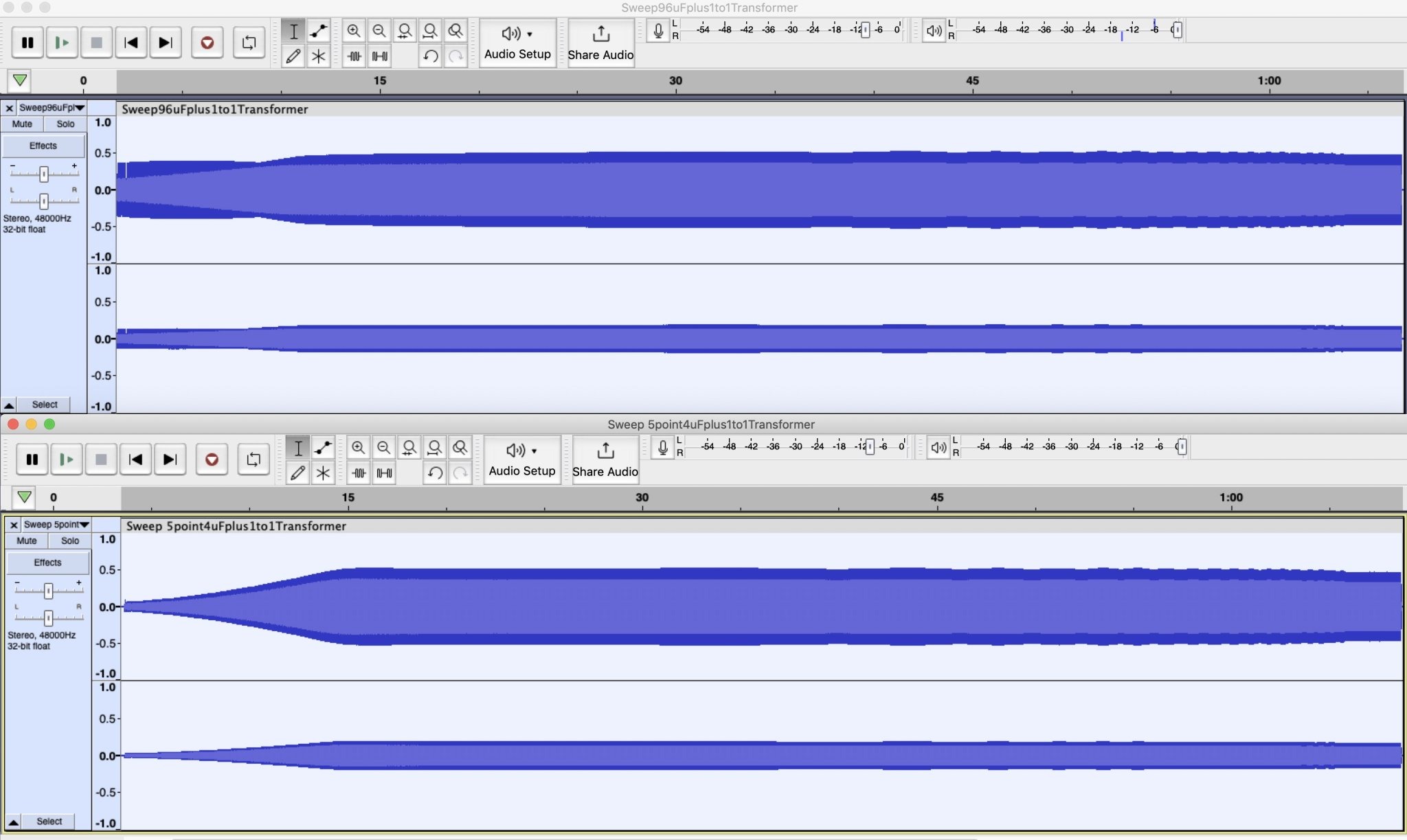

It is even two 47µF/63V Caps in parallel for each signal, so 94µF each line.
There is however some heavy distortion in the lower frequencies of the sweep,
I assume due to the transformer? I think it vanishes @60Hz.
BUT: The level is line, not mic.
The mic will never get that hot. Also with pink noise, I do not hear
distortion. Attached are the waveforms, how the Xvive looks like now (looks awful, hand-soldered) and both soundfiles,
with 5.4µF and with 94µF.

Great that it did the trick! The distortion very probably comes from the transformer; the datasheet you linked to shows that it can't handle line level at low frequencies.
By the way, if you should ever unintentionally magnetize the transformer core, a sweep like this should fix it.

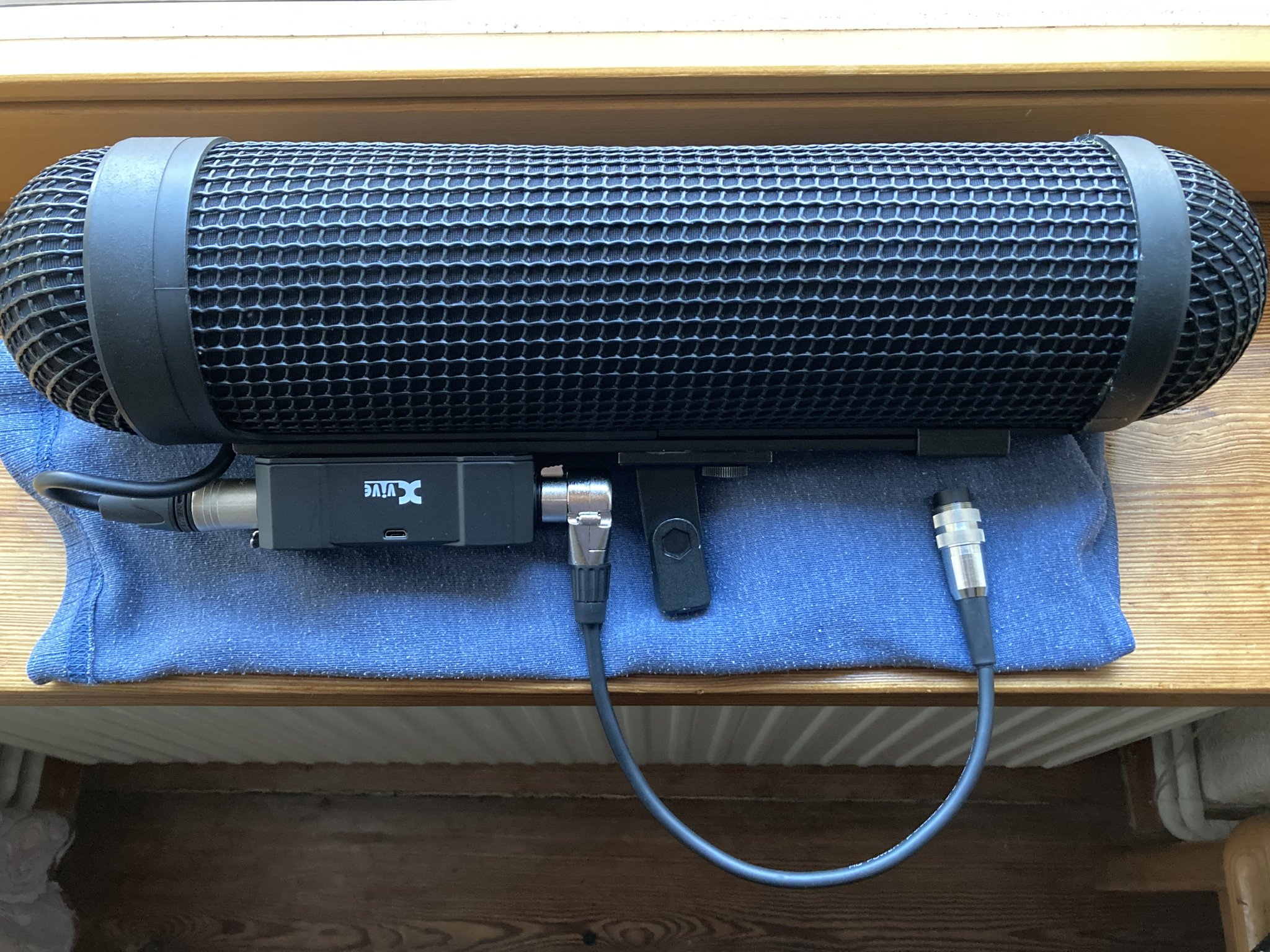

Well, happy to energize - this is how the finished setup looks like.
Can be mounted on the camera rig or on a boom pole.

It sounds like aliasing, but with the Xvive inserted it is more audible.
Best to be heard when played back from 37 seconds.
The two wav mono files you can see in the image are linked below:
https://filetransfer.io/data-package/DzbOV9Ty#link
Still distortion? If so, of what kind?
