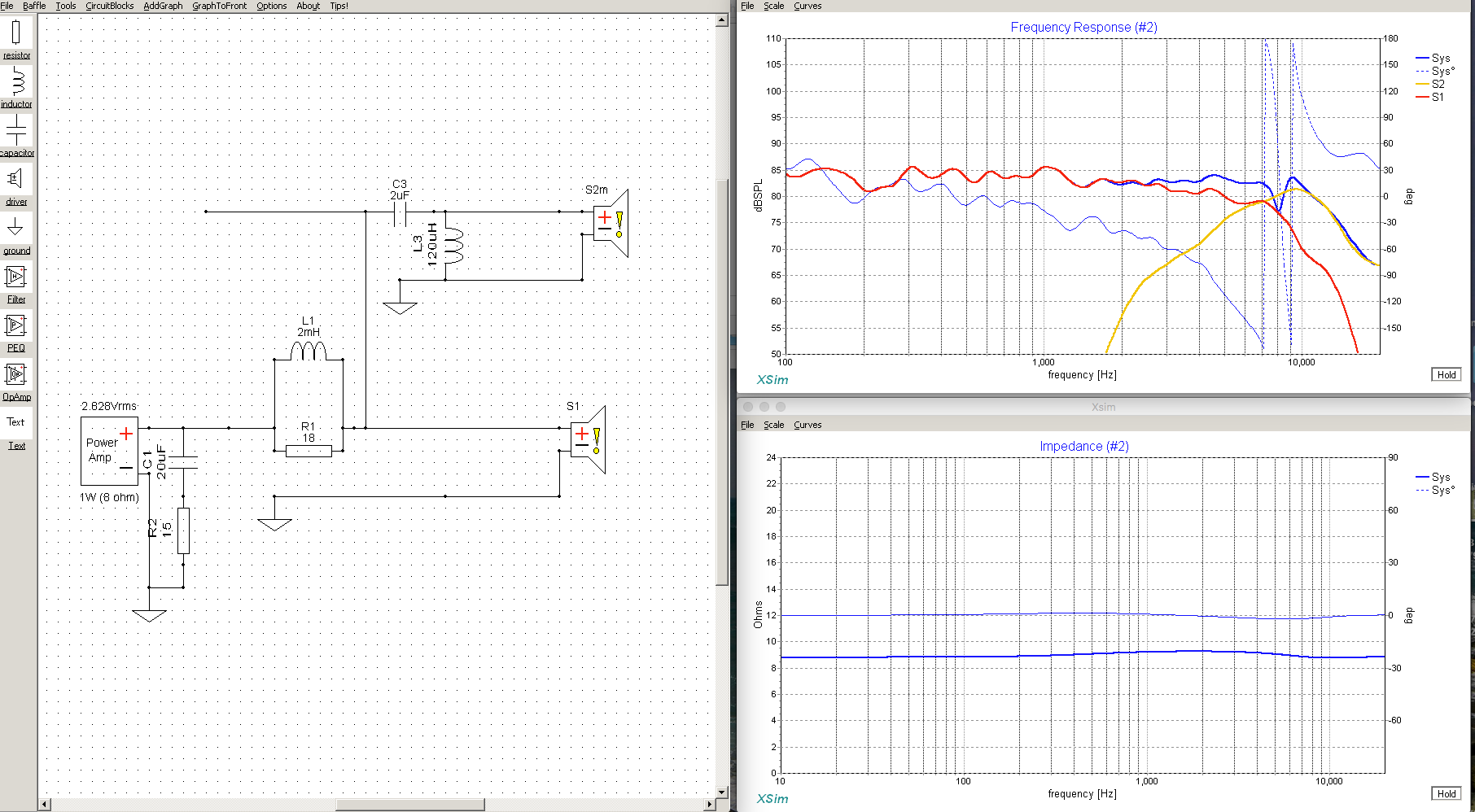

I have a question, and if I don't ask, I'll stay dumb forever!
All the XO designs I've seen separate the power at the source to send to each driver's own circuit.
Thing is... I've been trying to find a good and simple solution for some drivers I have, I tried something and it looks a lot better than all my previous designs.
It's a woofer (actually a full range drivers, but it dies after 9kHz) and a tweeter to bring life into it.
The tweeter circuit is connected AFTER the woofer circuit.
Is it a bad thing or is it ok?

Hi perceval,
Think in diy there are no rules so if its fun and sound good to you and its enviroment or purpose thats great isn't : ) that said if that phase is truth i will call it a difuse all over spectre effect and long way from any reference but is not meant as a critic if you happen like it, amplitude response comes first but we use phase to pin point stuff, for example if you hear sirene from a rescue car strenght (amplitude) help how far it is and phase help estimate the direction, at that mic position if that speaker play a sirene it should come from all over shouldn't it : )
Also bwaslo said before that he use no stardards for circuit or wire rules from the start up, he rather looks at what need attention and happens in the various graph windows when connecting stuff, he shared some of them selfmade real builds into "File/Examples", even some linear phase sytems are there .

Thanks for the answer... so, no rules in DIY, eh? cool! 🙂

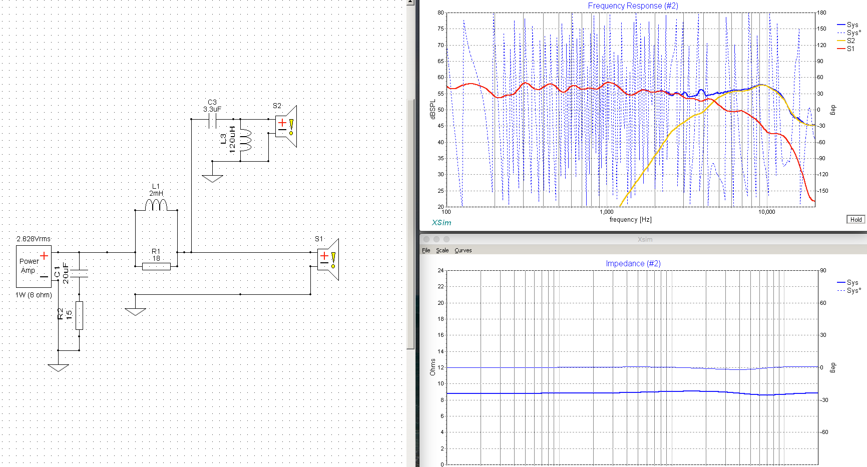

By the way, I had the wrong files loaded. Here's with the right frd files.
And the two very different results by either splitting the source between the drivers, or mounting the circuits in series.
No there is no rules if one don't want them but if we wonna improve on past then ha ha i can think of a bunch in acoustic domain to take care at after power amp probably spit out a very high quality of played recording material, now one can choose correct for predicted or in situation with reverse curves for example baffle step and diffration/room boundary reinforcement/room pressurization gain/JBL study or own prefered house curve/wife and furniture curves and etc : )
BTW the new graphs looks much more normal and effect pedal is gone, up high except few models its hard to get most woofers cooperate because phase is havoc up there and they ab fabric not engineered to be used so high, funny enough in same relation stumbled over below 5x8 incher SBA that looks over avarage hold its off axis up into high frq area but lets see at release time in below datasheet is still in proto type level claimed as a year 2018 rev 2.
Hey Perceval, looks ok to me (dunno what it will look like off-axis though, might want to model that before you cut wood). Also, for the 2mH inductor, try to use air-core. Otherwise if it gets saturated while driving the woofer that might modulate the tweeter output which wouldn't be a good thing.
Also it looks like you maybe aren't using actual impedance data? Result looks suspiciously flat and those yellow exclamation marks on the schematic is trying to tell you that something is missing...
Hey Byrtt,

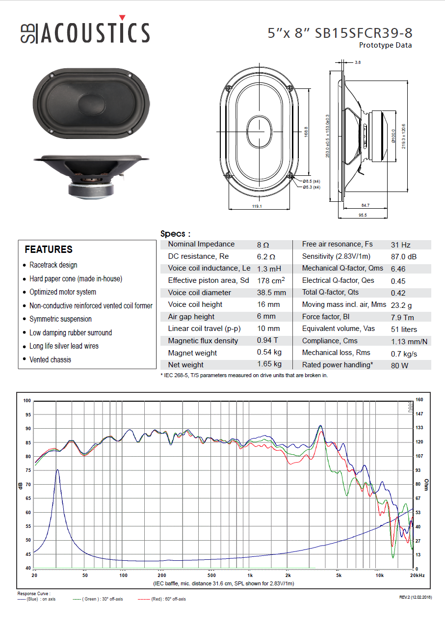

That SBA woofer looks quite nice, and 10mm Xmax! I just hate trying to rebate an oval driver into a baffle... round is so much easier!
Bill,
the tweeter has it's own impedance file and working, it is ruler flat at 8 Ohms and figured I didn't need a zma file. I have since added a zma file and it looks the same up high. I've been having trouble with the woofer zma file... XSim doesn't want to accept it. Been trying a few times... did the exact same thing as the tweeter to measure, but unlike the tweeter zma file which works fine, the woofer doesn't want to load. I'll be working on it again...
Also, in the baffle designer, offset looks ok until about 20 degrees off axis, where a dip develops at 6.5kHz.

...I've been having trouble with the woofer zma file... XSim doesn't want to accept it. Been trying a few times... did the exact same thing as the tweeter to measure, but unlike the tweeter zma file which works fine, the woofer doesn't want to load...
When that happens REW is often our good helping friend, ask REW to import that woofer file with the error and it would most probably tell you under load that there's a mistake in say line 1580 and also often the reason, then open zma file in a raw txt editor of some kind and edit that line and wupti XSim probably read it now, if not import once again into REW and it tells of next line with a error or if it happen open it up with no errors then simply export with REW standard settings and XSiM gets happy again.
