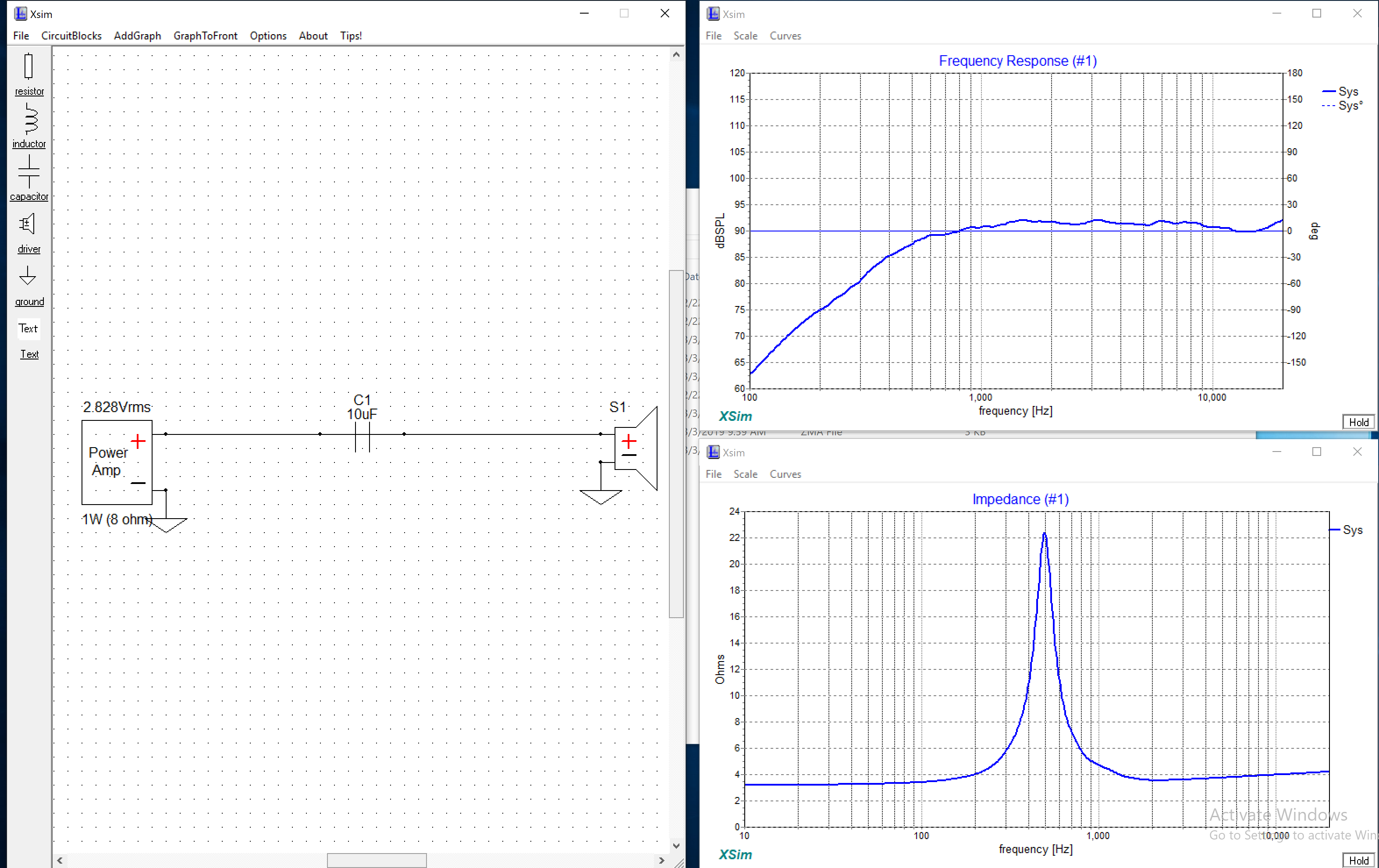

Your capacitor is not connected. Just delete the 'big' wire and draw two separate ones, one between the power and the cap and the other between the cap and the speaker.
