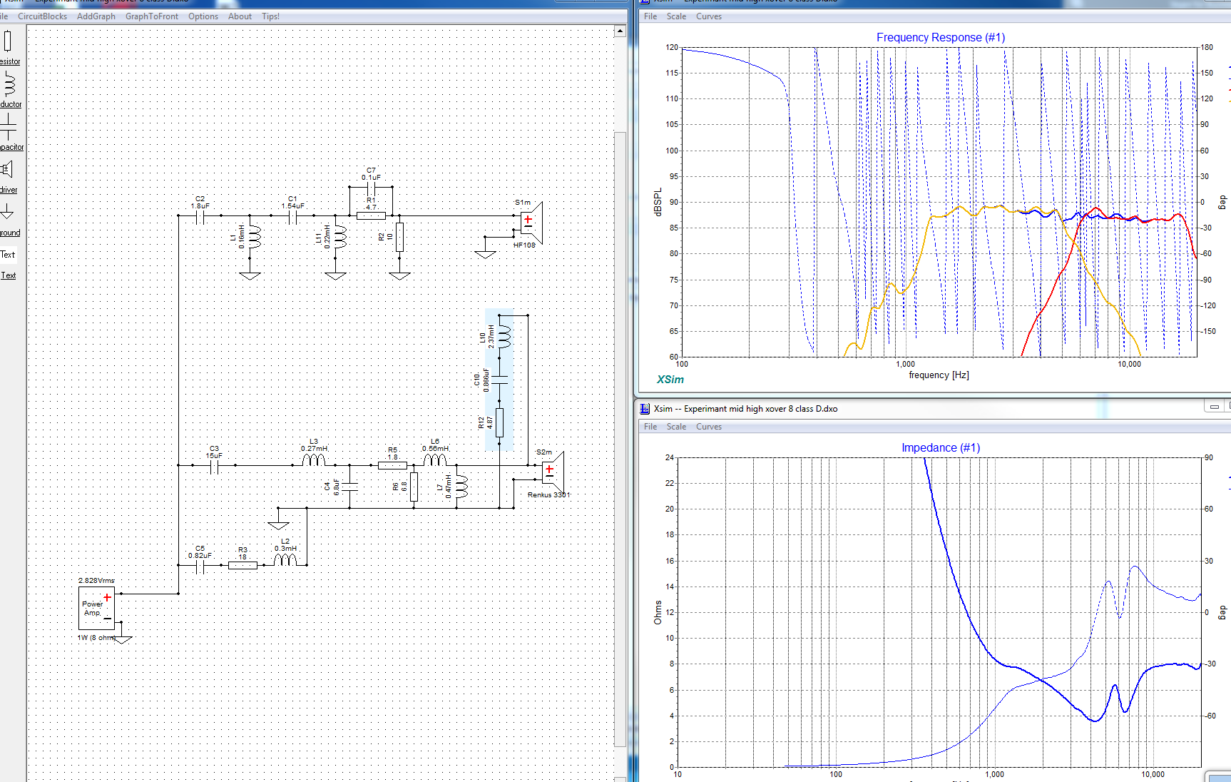

I am in the middle of my first passive crossover design and would like to ask for some advice. My system i a 3-way speaker with a 15" midbas driver, 2" CD on a horn for midrange (Renkus Heinz 3301) and a 1" CD on a horn (Faital HF108). The system is somewhat inspired by Klipsch Cornwall or so.
The system will be biamped, a class D amp for the woofer and another SET amp for mid and tweeter. So my task is to design a passive crossover network for the two horns.
So now I have assembled the cabinets, put all drivers on and made measurements of each driver, both frequency responses and impedance. From REW I managed to generate .frd and .zma. Then I did my best to model a network in Xsim somewhat inspired by Klipsch or JBL networks. In attachments there are pictures of the two simulations, in one case I aimed for the flat frequency response while keeping "not too bad" impedance, while the other represents a fairly good impedance with "not too bad" frequency response. Unfortunately I struggle to achieve good results for both curves in the same time. I assume it is because the two horns have different depth and the drivers are some 5" out of phase between each other.
I would like to ask some opinions and advice maybe which way to go and whether the graphs look reasonable to do some prototyping.

I'll take a look at it and see if I can add anything to improve the circuit topology.
edit: I suggest you first improve on the phase data of each driver by incorporating the minimum phase and then try your crossover again. I tried to do that myself but excel spreadsheet response modeler would not load it. I can feed the XSim with it and then export it to RM, which then again gets smoothed too much once in XSim again.

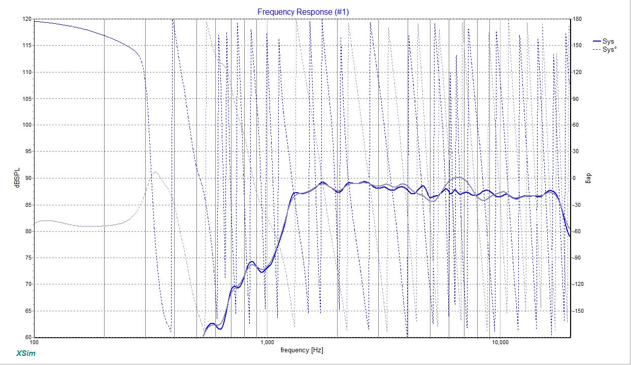

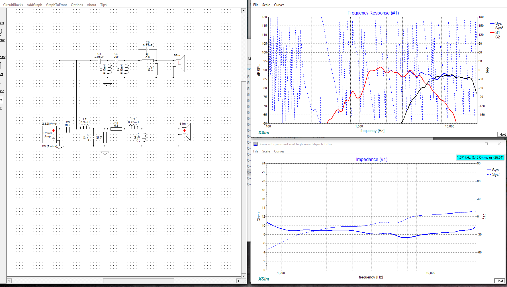

So I made new measurements, found the precise acoustic center and derived phase sources. Then I tried playing with crossover a bit. Here is the result:
Calibrated 1 1.dxo - Google Drive
How does it look now?

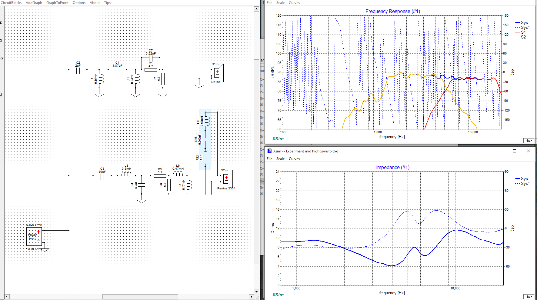

Phase looks better. There is room for making the rh3301 filter simpler by taking out shunt notch and L5, and modifying the rest of the network to compensate.
Lojzek, I really appreciate your help.
I followed your advice and did as you recommended. To compensate for the impedance peak I also added an LCR loop across the amp out. It does not affect the frequency response, but whether it is a good idea to have it in reality is a question mark. What do you think?
Here is the latest simulation:
Calibrated 1 2.dxo - Google Drive
I want to share one observation. When I measured a physical distance between driver diagrams it was about 4 inches. When I measured it however, it showed 5.12 inches instead, which is interesting. This is why mainly the crossover changed somewhat.
Impedance flattening circuits can be useful with amps of high output resistance but you would need to measure the whole speaker, woofer included. Simulation is just a step to figure out ball park values, this should be confirmed with actual parts and then modified if necessary, to be on the safe side. Latest xo version appears ok.
