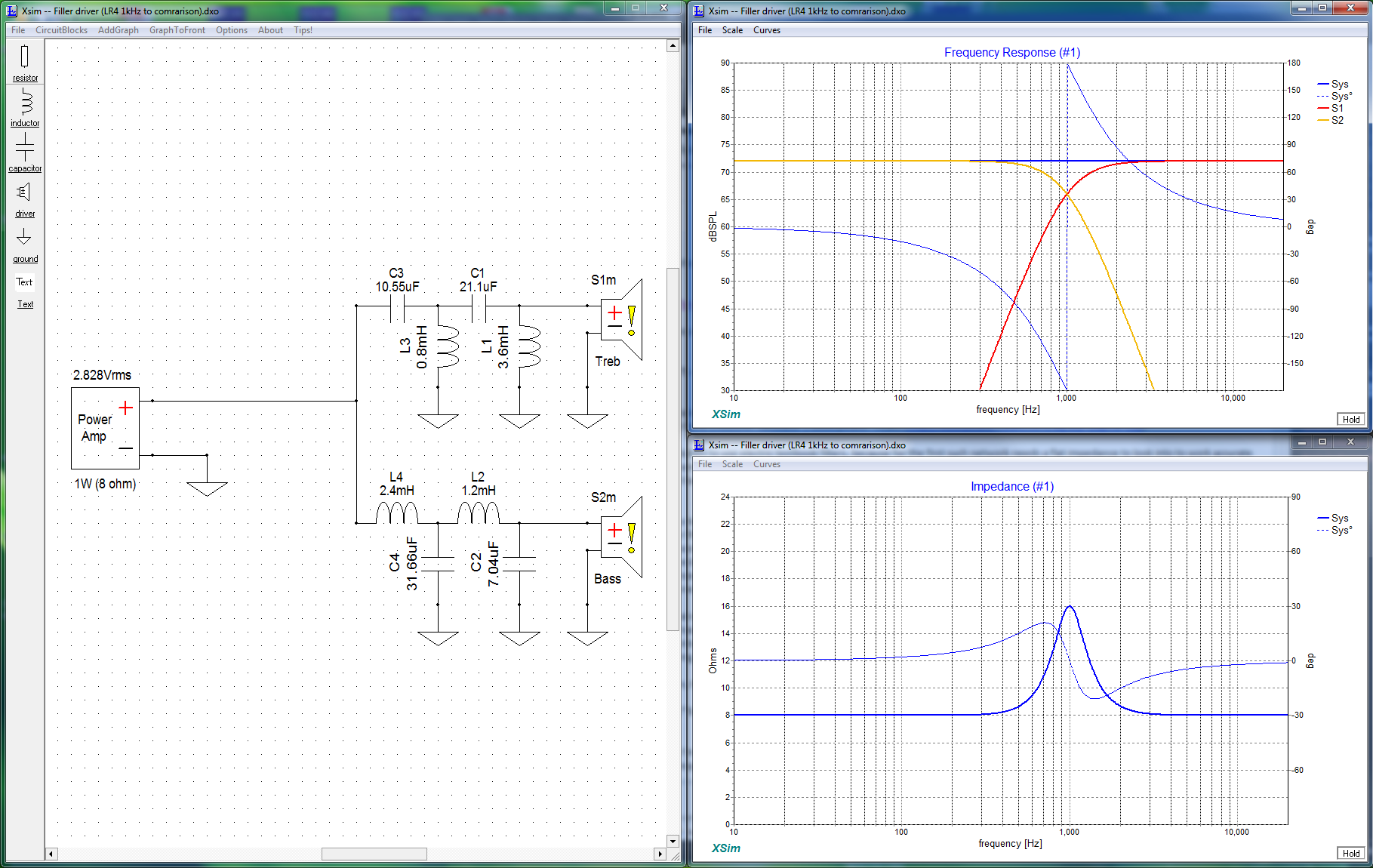

I just can’t understand why i’m getting different results with different calculators
For example i choose Linkwitz-Riley 2 order 2-way crossover for two 8 ohm speakers with cutoff frequency 800hz and i’m getting different capacitors values for the same configuration on xsim and other online calc
Welcome, can think about it will give different capacitors values if that online calculator expect and use a pure flat impedance for driver load and in XSim you feed it a zma-file with the real world resonance and inductance ripple.
For example in below all component values for LR4 XO point are calculated and taken from the second link into post 518 and works by the book when set up into XSim using its standard textbook flat impedance 8 ohms driver (using no real world zma-file). Suggest you could try setup exactly the same as below and see if it outputs as expected.
The difference between XSim and your other program's generated "idealized, imaginary, never-really-correct" crossover circuit could be where it declares the break point. Some use the -3dB point (though the -6dB point is the useful one for a Linkwitz-Reilly). XSim circuit blocks also rounds off values to standardized capacitor values (2%, I think, is used as standard component values in the built-in Circuit Blocks). BTW, you can design your own circuit blocks if you have formulae for the component values of a circuit type. 'File->Change Mode' will let you change to circuit-block design mode. Not easy, but not too hard either.

Circuit blocks in xsim are linkwitz-riley based?
How close you are trying to get to calculated values for capacitors?
No, they're just blocks of circuit components tied to other parameter values (like, say, specify Q and corner frequency instead of specifying the Ls and Cs). They just run the equations to calculate the component values. I don't think there is a LR model in the circuit blocks at the moment.Circuit blocks in xsim are linkwitz-riley based?
The component value selector for parts made with a circuit block moves in 2% standard steps, which is what the circuit block will round to after parameters are configured for. You can change the selector to 5%, 10%, or 20% after "change block to separate parts" if you want more realistic values when tweaking (right-click on the little up/down arrows at the right on the related numeric control).How close you are trying to get to calculated values for capacitors?
If you want more precise component values (which you can enter into component value selectors) you can type them into the Tune component values for an L, R or C and hit enter. Then it won't round to standardized values. But the circuit blocks will always round the values, being intended for engineering rather than mathematical use. The filter curve generator in XSim3D is very precise, though, if you're after textbooks curves to import.
