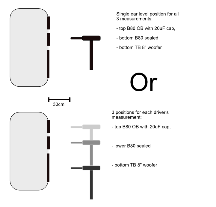

Which is the best way to measure the drivers being used in XSim to visualize the XO regarding FR and phase?
A single position, at intended ear level for all measurements of the drivers?
Or
Each driver's measurement at the same distance, but with the mic moved vertically to be centered on the driver being measured?

the top one, but if the tweeter isn't a ribbon or something super-fragile, don't use the 20uF cap (but keep the test level moderately low, as you'll want to anyway because the sound can be kind of annoying!).
Also, see Jeff Bagby's instruction on how to get the correct acoustic offset between drivers at IIS 7.5 Detailed Error - 404.0 - Not Found . The instructions are for use with PCD, but they work with Xsim, too. But that website seems to be down at the moment -- presumably Techtalk will get it sorted out soon...
To make things nice and confusing, the second (lower) method along with offset control is what you'd use with the "Xsim 3D beta" in 3D mode, though. I probably need to write up some brief instructions, but use the 3D thing for figuring out how to arrange the drivers, what kind of crossover topology might be needed, and a preview of how off-axis and boundary effects will change the response. Xsim3D will only give an estimate at that point, so don't build the actual crossover yet. When you decide on the drivers and baffle arrangement, then build the box and measure the drivers, as mounted in the box using the top method and without the 3D features of Xsim3D -- results from that, because they will contain all the baffle effects and actual off axis response will be nearly exact.

Here's a more general description of the procedure from my article in the old SpeakerBuilder magazine. It will work with any software that does 3D spatial positioning.
Finding Relative Acoustic Offsets Empricially
Dave
