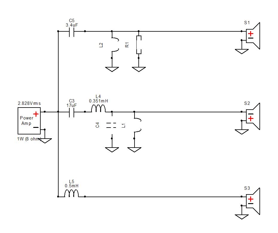

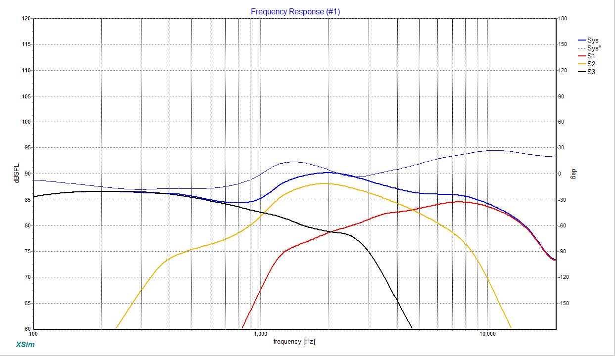

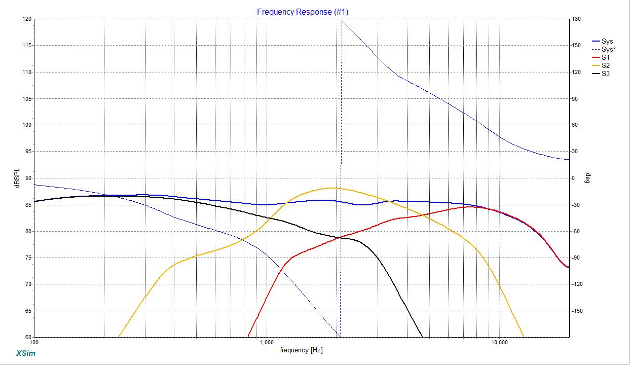

Okay, no zobel is fine. What I'm practicing on is an old pair of Sansui SP-2500. What I did on claim was bypassed several components and changed the value of the tweeter and midrange capacitor to simulate a 1st order. The graph is showing a nice flat frequency response with a standard deviation of 1.7 debt between 50-17k. To get this flat line I reversed the polarity on the midrange. Looks good on the screen but the system phase line is perfectly vertical and intersects way down where the woofer and tweeter lines intersects. The woofer and tweeter lines intersect in the middle of the bandpass range though several decimals down. Is this alignment a good thing or bad thing?
The attachments would be more helpful. The original crossover has a 2nd order HF and Bandpass. There is no filter to the woofer on the OEM crossover. Basically, I turned into a three way 1st order. I'm wondering about the one with the phase line right down the middle. Is this normal or bad?
Not sure (would help if you added pictures).
One possible issue -- phase response plots are "periodic", in that when you get to +180degrees and go one degree higher, you end up at -179 degree (then -178, -177, etc) not at +181 degrees. Or rather +181degrees is the same thing as -179degrees. The "curve" isn't actually vertical, it's that -180degrees is the same as +180degrees and drawing something there looks like a vertical line.
Also phase is related to time, and time is proportional to distance (because of the speed of sound). So the phase response will be different depending on how much delay (time) there is included in the graph -- or how far the mic is from the speaker, at least in a time-locked measurement. As a result of all that, it's not always easy to judge how the phase response is by looking at it. You can add or subtract delay to the simulation to see how flat you can get it -- delay will affect phase at higher frequencies much faster than at lower frequencies. It gets even more complicated with so little agreement about how audible phase response anomalies really are (you'll see opinions all the way from "a few degrees will make or break a speaker" to "phase response is totally inconsequential"). At least ideally, a response that can be delay-adjusted to look like a flat line at 0degrees would be perfect (but not really reachable), but I find that even 3 or more phase rollovers (crossings over the +/-180 degree line) when delay is adjusted for most flat display, doesn't seem to have an marked effect on sound to me. YMMMV
You're ahead of me!. That is a VERY mild phase curve. Some would call that "virtually linear phase". Is that from measured data?
Based on phase alone, that second curve would be great. Not many drivers are very happy with such a simple crossover. though (excess LF energy into tweeters. too much breakup radiating from LF drivers).
The data for the tweeters and midrange are measured and the woofer data was traced from the manufacturer spec sheet. The two tweeters are a sort of a tonsuale column between two angled midranges. The OEM crossover is on a real PCB and well made. Sansui really choked up the bandpass and tweeters for some reason. I replaced the original woofers with cheap MCM 8 ohms ones. The tweeters are rated at 14 ohms each and the "squakers" at 12. Each pair is wired in parallel. The OEM woofer was 6 ohms.
I used SPLCopy. I extracted the graphs as images and enlarged them a little. Somebody over on AudioKarma sent me the measured FRD and ZMA for the tweeters and midranges. He used REW.
I also measured how deep the horns are and the diaphragms grills are 4" behind the front of the baffle. They also have a weird horizontal diffuser in front of them.
Golden Age Of Audio: Sansui SP-2500 Vintage Speakers
I have two pairs but the one I'm working on here is built in 1971. The midranges and tweeters have to be heard to be appreciated. It is like some sort of Kabuki Bose Heresy hybrid.
The crossovers are weird too. Unusual component values with two transformer inductors. They change the left slope of the midrange and tweeters. What they really did was change the upper and lower crossover points. They each have three settings Clear, Natural, Soft. with Soft having the deepest slope. The only original inductor on my test graphs is the .351mH on the midrange.
