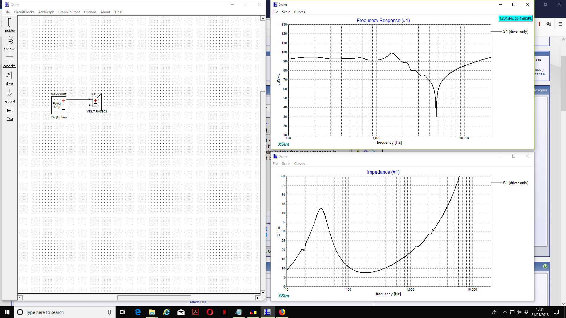

Why does Xsim extend response curves?
I created frd and zma data for a Volt RM3863 woofer from Volt's published curves using GraphTracer. Opening both files with Notepad confirmed the data is correct. Both load OK into Xsim but the frequency response is extended beyond the loaded data. It looks like Xsim has created an additional response curve from the cut-off at just under 5KHz. There is no data in the frd file after that cut-off.
Screenshot attached. Can anyone help?

That's interesting. There is no data point beyond 5K? Nothing at the very top? I've seen other programs, like PCD do that if there is one data point at the top end.
I'll edit an FRD to 5K to see what I get.
Just checked. I see the same curve you have after tracing the Volt RV3863. There is an added curve at the top end.
My FRD file tops out at:
3704.840549 70.434904 0
which is where to published graph ends.
These are captured with VituixCAD which has automatic extrapolation. Manual editing is not always needed.

That one plots down at an angle after 3.7K. It should, as you can see that Vituix has added the data above that point.

Thanks for the two files. They upload fine to Xsim and look right.
I have the drivers on order to build a 3-way TL with Volt VM752 and scanspeak D2904/710003. I will use Omnimic to create the frd and zma files "in the box" but I wanted to do some crossover simulations first.
Any idea why Xsim does this?

^bwaslo can give exact answer, but looks that there is extrapolation with last two data points with linear magnitude scale (not dB). That could work, but it's not very reliable in practice. Program expects that captured magnitude data covers whole 20..20000 Hz, or you have added single data point to >=20 kHz for guiding interpolation. Composed data point eliminates need of extrapolation.
Automatic extrapolation with slope detection by the last 1/3...2 octaves would read responses without nagging, but we can't expect perfect result because original data is unknown. Extrapolation with manual slope setting wouldn't change that. Fortunately manual editing is not a problem with standard XSim because is doesn't use tens...hundreds of response measurements. Some other simulators such as VituixCAD need stable automatic extrapolation with slope detection because projects could include hundreds of responses.

Thanks Kimmo. So if I edit the files to add data points at 20Hz and 20KHz Xsim won't interpolate higher levels?

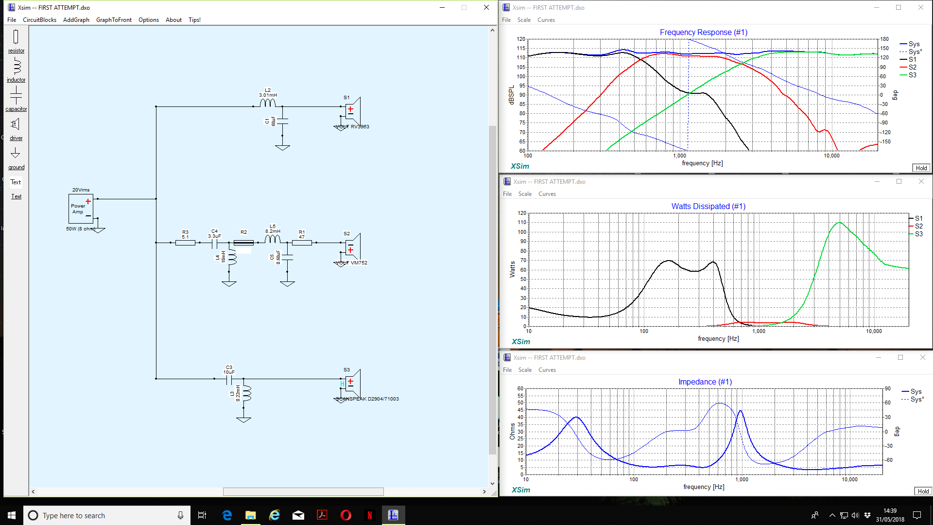

Will I burn out my tweeter?
Just tried my first 3-way X/O using Xsim and it looks OK with a level response and reasonable impedance curve. Problem is if the amplifier is producing 50 watts the woofer is dissipating 70 watts over a broad band and the tweeter is hitting 110 watts at 5KHz.
Have I done something wrong or discovered a perpetual motion power source?😕
😀 Do not mind too much about power reading you see in the amplifier block because it is theoretical value if the load would be constant resistive 8 (or 4) Ohms. Amplifier's output signal is voltage which causes power dissipation in components of simulated network (which plays reality).
Another challenge is that spectrum of music is not flat. It's more like pink noise above ca. 2 kHz. Therefore simulation with flat spectrum needs some interpretation and assumptions.
Biggish series cap for tweeter causes part of power dissipation jump at lower treble. Normally any response hump above crossover area is not a good thing. Power response simulation would help choosing final value. Fortunately this is just preliminary simulation with virtual data, and you'll have several opportunities to select more suitable values.
Well, if you're going to simulate at those frequencies (and you care about them), then the data there has to be something, right? Whether you defined it's response there or not, the driver doesn't just cease to exist there (and "undefined" does not =0). XSim always works with a frequency set across the whole band so if your data goes into lala land before getting there, XSim can only try to infer from what it's given. The assumption is you'll provide at least one data point at 20kHz or higher so it can log-interpolate. If you don't, then XSim has to either extrapolate or just use the highest frequency value you gave all the way up to 20kHz. So I went with extrapolate. If you prefer it use the last value all the way across, just edit in one extra point at say, 21kHz with same value as your highest known point. If you want it to drop to minus infinity dB there, then put that in the file.I created frd and zma data for a Volt RM3863 woofer from Volt's published curves using GraphTracer. Opening both files with Notepad confirmed the data is correct. Both load OK into Xsim but the frequency response is extended beyond the loaded data. It looks like Xsim has created an additional response curve from the cut-off at just under 5KHz. There is no data in the frd file after that cut-off.
XSim actually does a "constrained spline" curve fit to any points you give it, mapped onto its 500 point frequency values. That's so you can enter in any points you have. But insufficient information is.... insufficient. Probably no one would prefer to get a lot of error messages when frequency data doesn't cover the whole band.
kimmo, thanks for jumping in on the "power" question.
That impedance curve drops well below 8 ohms and the power amp source is set for 8 ohm (resistive) loads, hence "creating power", same as a 100W 8ohm power amp ideally doubles power out into 4 ohms.
