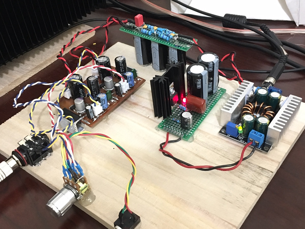

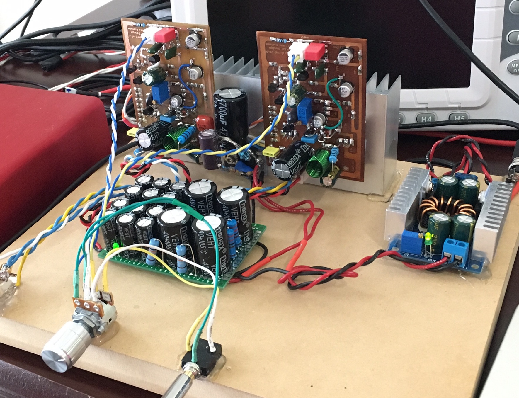

In a collaboration with Aksa, I have built a prototype in all SMT (except or electrolytic caps) and it is quite compact, almost as small as the PCA, not including power supply - which could be two 9v batteries.
Closeup of stereo amp in SMT:
With PSU and cap multiplier (the black heatsink in middle) and DC step up:

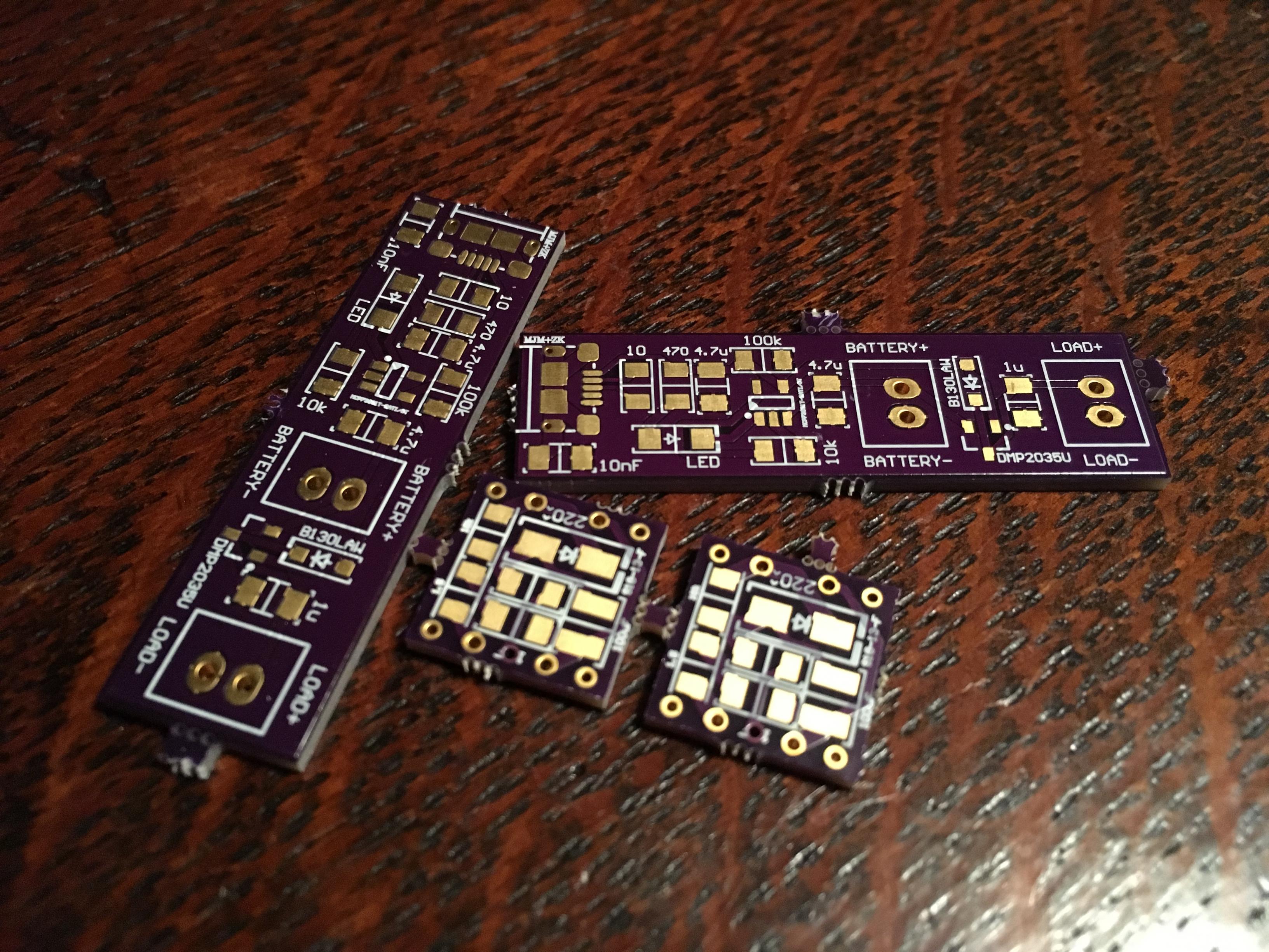

just placed an order with elecrow for raptor's PCBs - total is ~$16 ($5 for 10 PCBs + $6 shipping). Based on X's comments this seems cheaper than other manufacturers if anyone else is interested.
Here is the 25V 47uF 1210 ceramic cap for the RL mod.

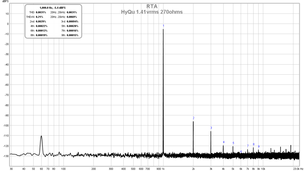

X, have you measured the amp with the Cap MX installed? I have considered buying a few parts to put a little CRC filter between it and the PCA board...to see if i could get it silent even with noisy USB power. 🙂 Will have to see what can fit alongside the Raptor boards. Do you think that a filter with much smaller caps than what you described in post #1010 (like 3x 330uF for instance) would be worthwhile?
I have measured other amps with the cap Mx and CRCRC installed - I just have not used a cap Mx on the PCA. If you look the measurement from the HyQu it looks very nice.

my order from elecrow just arrived, ordered 10x of each board, but received 22 of the load share and almost 40 of the cap Mx board - if anyone in Aus wants a set of the boards happy to send for the cost of postage - pm me.
Would recommend elecrow 😉 $5 for an order of 10 PCBs and ~$5 for shipping. (and receiving way more lol

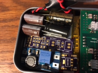

So I did a quick test fit with all three RL mod boards in the tin. Looks like there will be room left for up to four 10x20mm caps to add a power filter.
I am thinking 4 x 25V 1000uF with five 0.47R 1W resistors (X's recommended value) between/around them. So it would go RCRCRCRCR, correct?? That way the rail caps on the PCA become the final "C" in the filter? It would help a lot if somebody would kindly critique this idea. Is it overkill, or is more always better? 🙂
