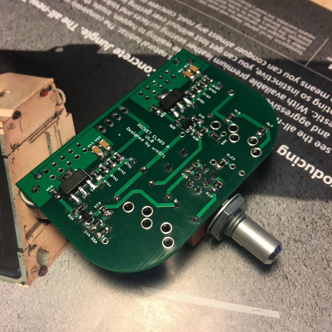

here's the board, do not judge the soldering it was my first time soldering SMTs,

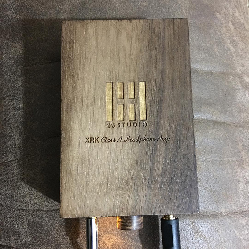

I did not settled down for Altoids box, i m making my own, but since i m in the middle of moving , it's gonna take a while until i can finish the box 😉

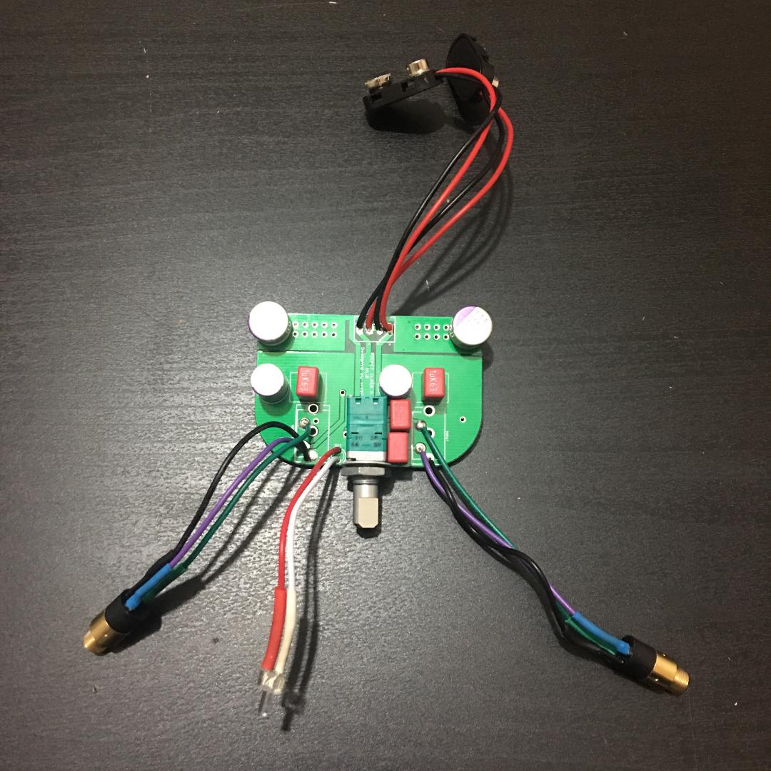

Thanks for sharing photos. In case you did not see the revised BOM, replace the 100uF rail caps with 2200uF caps (25v since you can afford the size) and that will improve stereo separation/imaging and improve bass response. Also, if you are using headphones lower than 250ohms, use 1000uF 16v oscons x 2 as output caps, or a single 1000uF Panasonic FR.

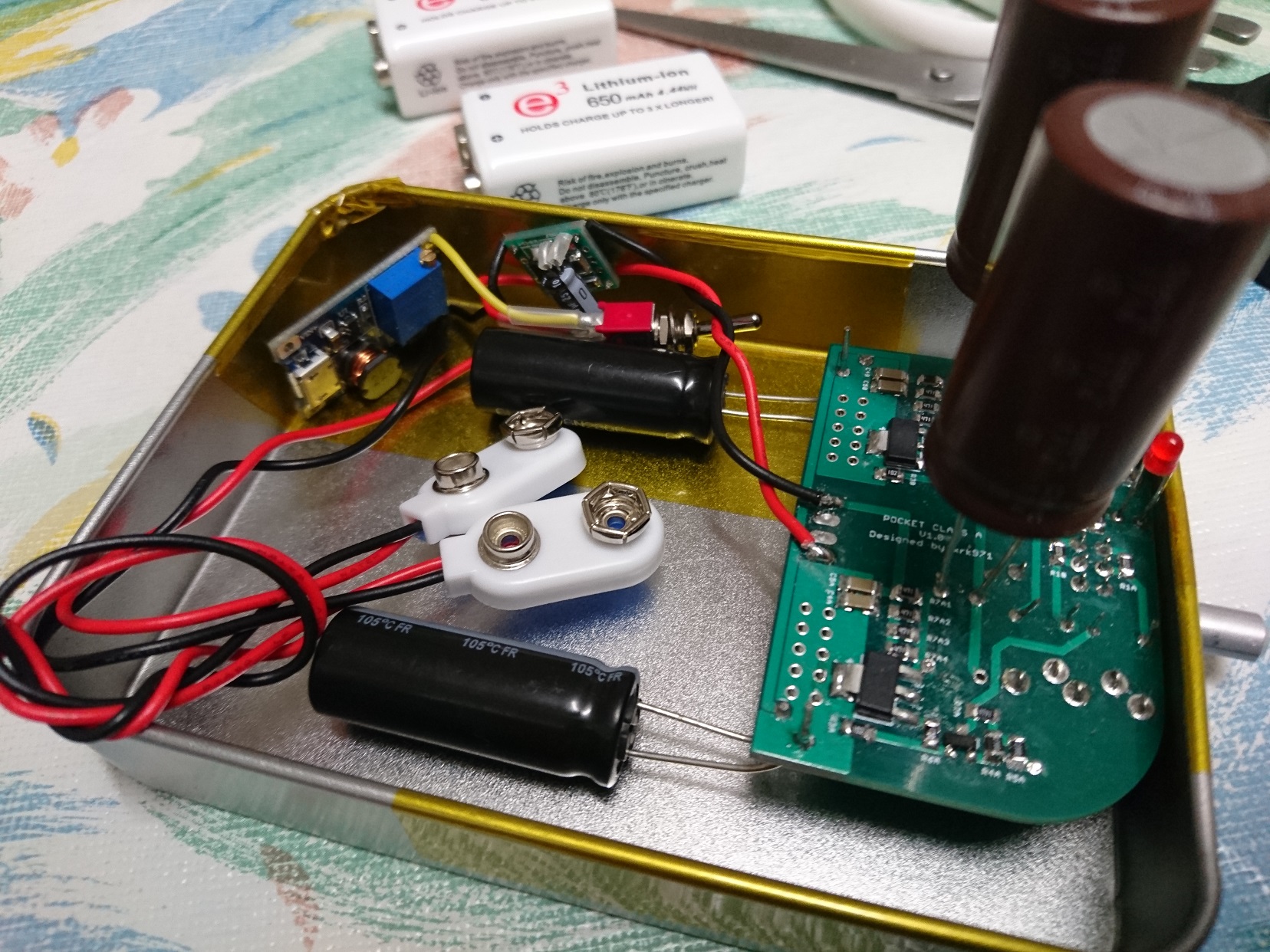

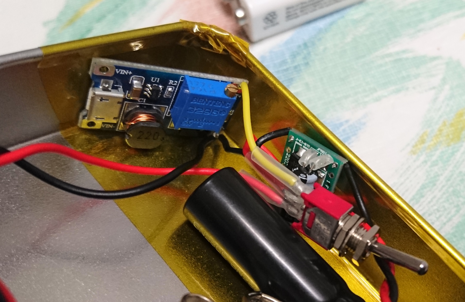

So this is what I did with the cap multiplier board and the step up converter:
Now there is a choice of running it off batteries or off USB (via step up converter board). I used a leaded cap for the 100uF on the cap mx instead.
Haven't figured out an elegant way to mount the step up so the USB port is accessible from outside, but then again this particular build just sits on my desk/around the house. Will have to work something out for the one in an actual altoids tin.

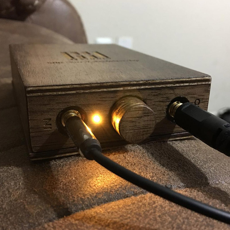

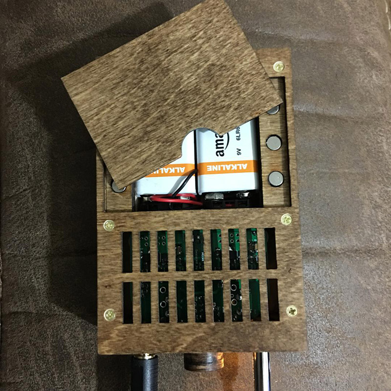

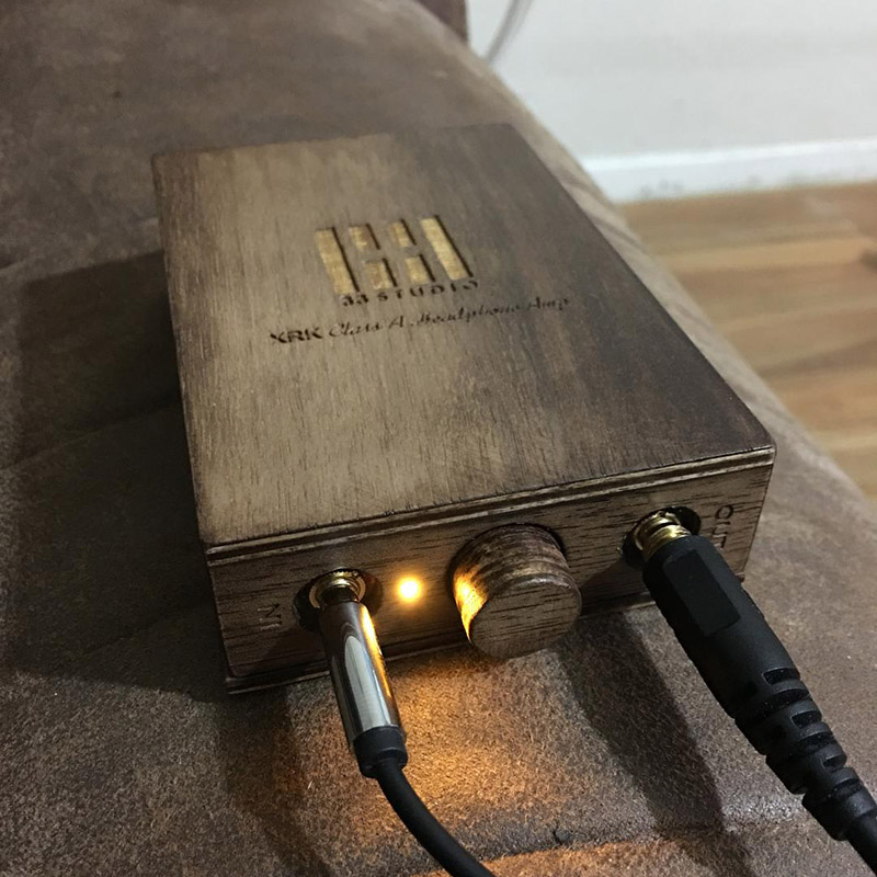

Aatto,

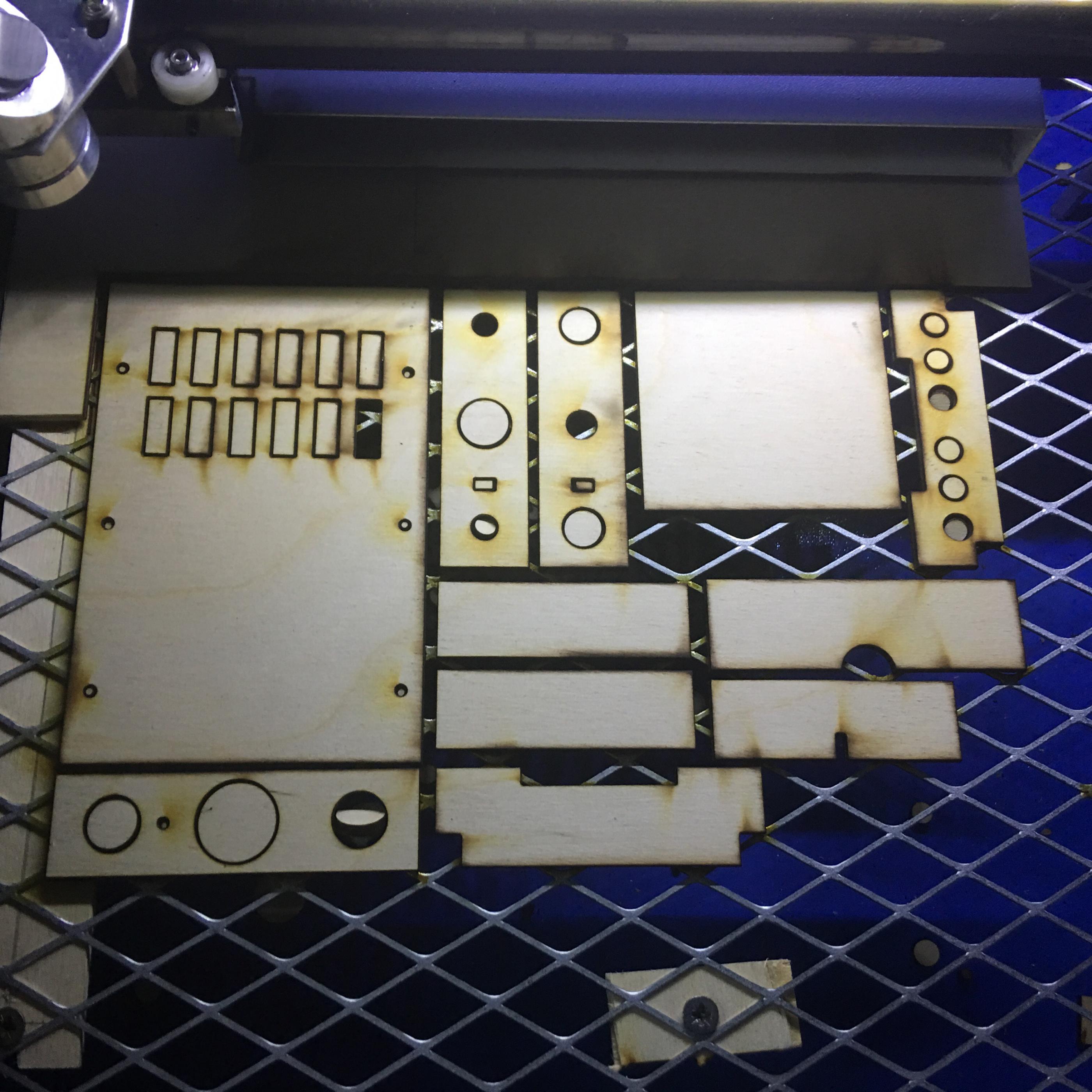

Wow! That's a beautiful case - truly unique. So you have a laser engraver? How is the box held together all screws or some glue? I see magnets holding the battery lid in place. Nice touch. Great job!
X
X
Thanks 🙂 it's just a quick project since i want to listen to this amp and i do not like it hanging on a piece of scrap wood or something.
yeah i do have a laser engraver. the box needs a little more work but i ll probably let this one go as it is and use what i learned for the next one using the good veneer, lol.
the box held together by glue, the bottom is removable ( held by screws ) to have access to the board and yeah as you see the battery compartment has removable cover held by magnets, wanted to make it like drawer but it would make the box a little larger.

Hey stellar - don't hear any noise from the step up, and this was running it off a powerbank as well
X, fwiw those big slimic caps seem to make it quite bassy so might be changing that soon
Yes Aatto - great looking box you made! - worthy of a great amp and very unique too.
Aatto, you have raised the bar, sir.![]()
